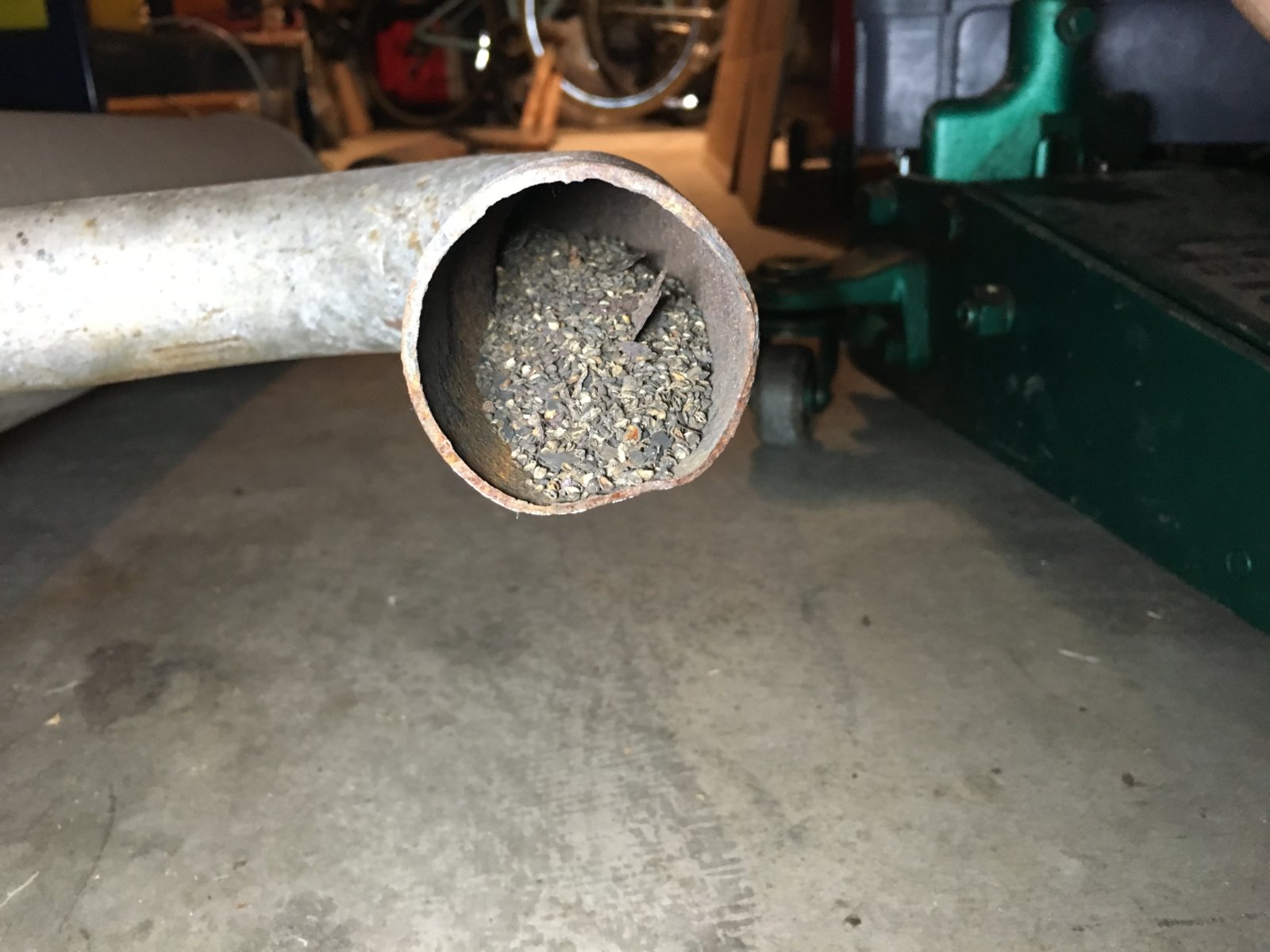

Good progress sans pics (yet); after soaking all the exhaust fasteners, they actually came loose pretty easily. I took off the metal shield (later made using a fiber material), and was able to remove al but the really tough ones. There are still the 6 manifold nuts, buried in the underside, and a couple from the manifold to the downpipe. The cooper looked good, and the studs pulled out of the head without much effort. Looking forward to removing the valve cover and intake next. Pics soon.
I have to remember to take pics(!). I removed the radiator with no trouble, and the coolant looked green and new. The hoses even came off without too much trouble. Placed an order with Ireland Engineering for an all aluminum radiator, silicone hose set, exhaust nut and stud set, fuel filter, exhaust heat shield (fiber type), and a pair of stock engine mounts. Hard to believe their all aluminum radiator is only $375- seems like a great deal. So does the silicone coolant hose set; $110 for all.
Looks like I'll have to replace all the fuel lines (right?). The lines actually look decent but won't play well with the modern gas. Fitted the e38(?) Style 5 wheels and they seem to fit fine. Several threads clear the nuts, but I haven't tried turning them lock-to-lock. Haven't tried cracking the bleeders on the calipers yet, but I'm reeeealy hoping they're cooperative.
Finally got the exhaust extracted, and it actually came out relatively easily. The Pacific Northwest really is kind to it’s cars. Could it be possible the exhaust (manifold to tip) is all original? Half the rubber hanger donuts were pliable (but will be replaced). Haven’t found a hole anywhere. Removed the 5 blade fan and it looks good, too. Is there a source I can buy a stock OEM fit exhaust? I’ve found places that sell parts of it, but not all the pieces.

Have you considered attempting to salvage the existing exhaust? Looks to be in good shape and you may be able to separate the sections and blow out any junk that has come to collect in there. You may be able to remove the scale and then paint with some black high temp rattle-can. If the baffles in the muffler section are too far gone, an exhaust shop should be able to find something that will suit your needs with minor modification if you can't get an affordable replacement. The picture of the tailpipe brought back a memory of a 308 at the shop that we had a hell of a time getting to start--when it finally started I was nearly in tears from laughter as a torrent of peanuts projected from the pipes and across the parking lot.

My exhaust system looks exactly like yours so I would assume it's at least OEM. Mine also looked original except for maybe the muffler, it had a little to much gray paint on it to be 50 years old. I heard my car run with the exhaust on it and it sounded pretty good so I'm planning on putting it back on as-is.

I'd love to retain as much of the original exhaust as possible for now, but will probably let my local exhaust shop install a newer muffler and tips (mimicking the OEM). I'll wire brush as much of the surface rust as possible, brush on some Evaporust, then spray some silver/gray exhaust paint. I'll try using my new ShopVac to blow through whatever crap *must* be inside.
