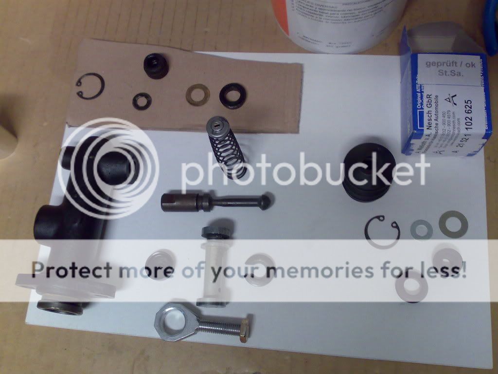

3- the third possible source for that "pop" is the rubber flexible cover of the rear end of the master cyl, mine was broken, and I do not remember any noise, but considering that if the years had made the rubber rigid I assume that you can produce a "pop" everytime you push the rod into the cyl
that rubber cover is available in the repair kit from walloth&nesch, see: (top right area are the contents of the kit)
4- the last point is some internal problem inside the cyl, but I am not really considering it as you have not mentioned any issue in the clutch performance
