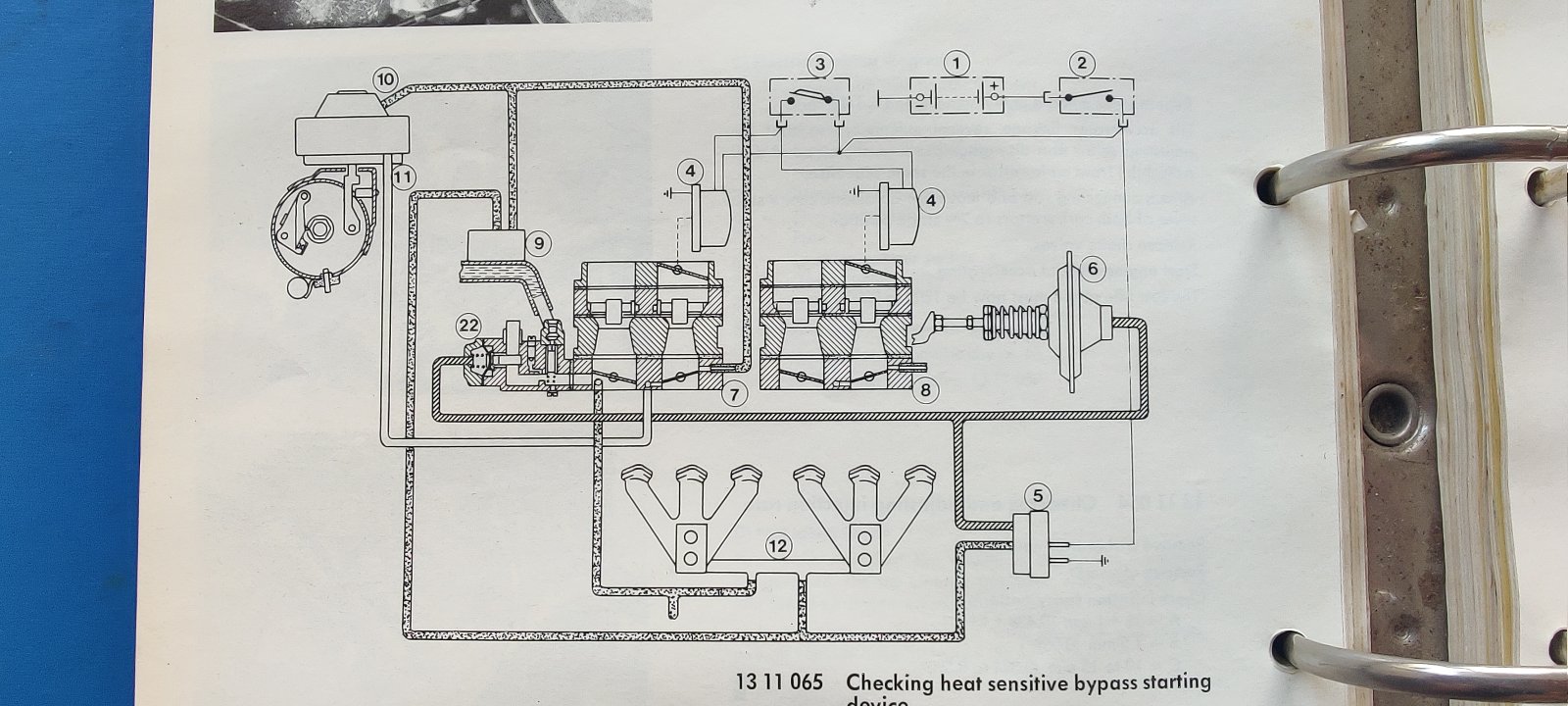

According to my blue books (Section 13), a '71 Bav/2800 (M30B32V engine) came with twin Zenith INAT 35/40's. However, the previous owner swapped the Zeniths for Webers.

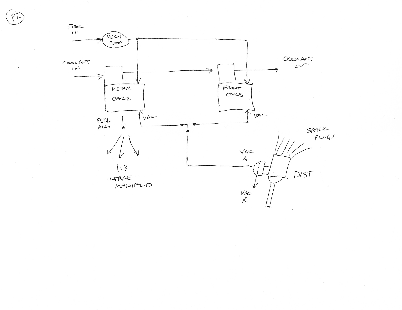

  • The first image is the vacuum feedback system for Zenith carbs (blue book pg 13-11/6). It shows dual vacuum connections between the distributor and Zeniths.
  • The second image has additional details of the advance / retard vacuum hookups between the Zenith and distributor (blue book pg 12-11/2). As best I can tell, Webers only have 1 vacuum port, whereas the Zeniths have two.. one before and after the Zenith carb vane.

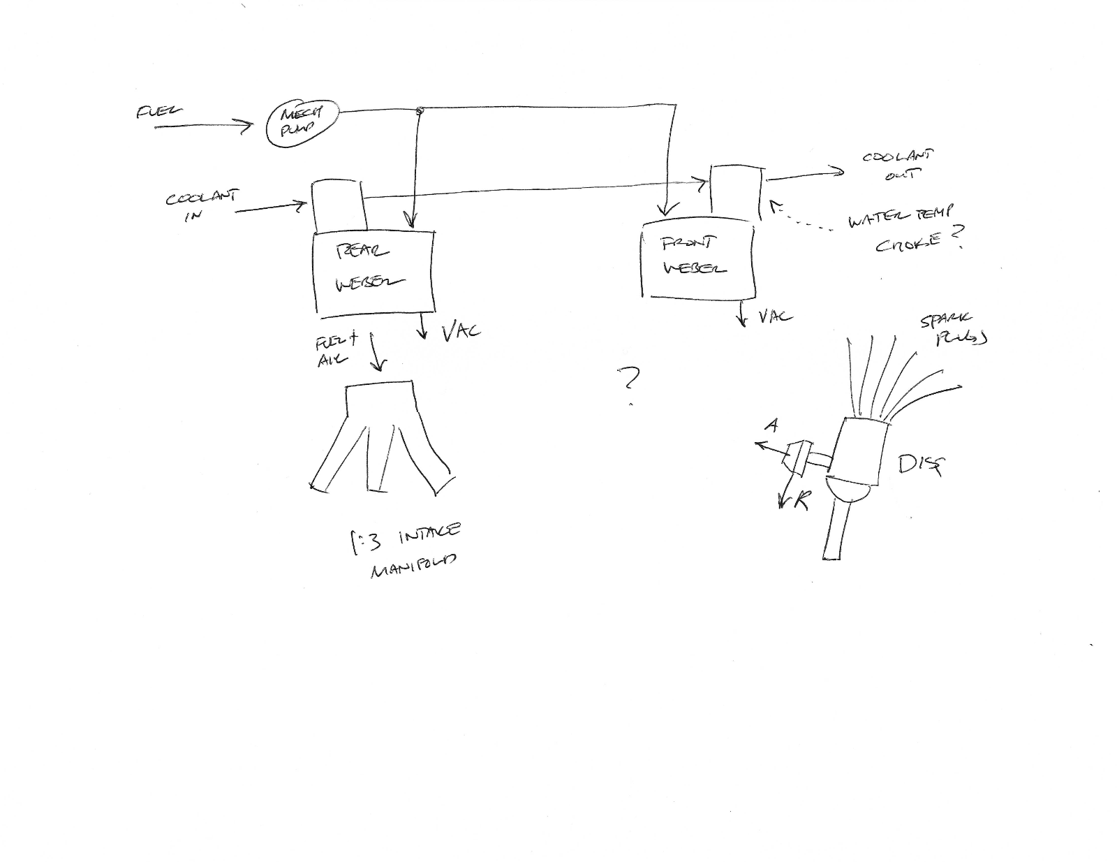

What are the proper vacuum connections between this distributor and the Webers? (I drew out a quick diagram.. the webers have a coolant feed which I believe is a cold-start choke.)

Vacuum advance comes from cone shaped side of dizzy diaphragm and goes to Weber port above the main throttle plate. Don’t worry about retard yet but it goes below throttle plate from the manifold. Plug any unused carb ports or split the vacuum lines to each carb.
Diagram 2 based on your comments.
  • As an alternate, I could remove the vacuum tee, and simply plug the vacuum port on the rear carb.
I haven't found a vacuum port on the manifold yet... will pick that up tomorrow...

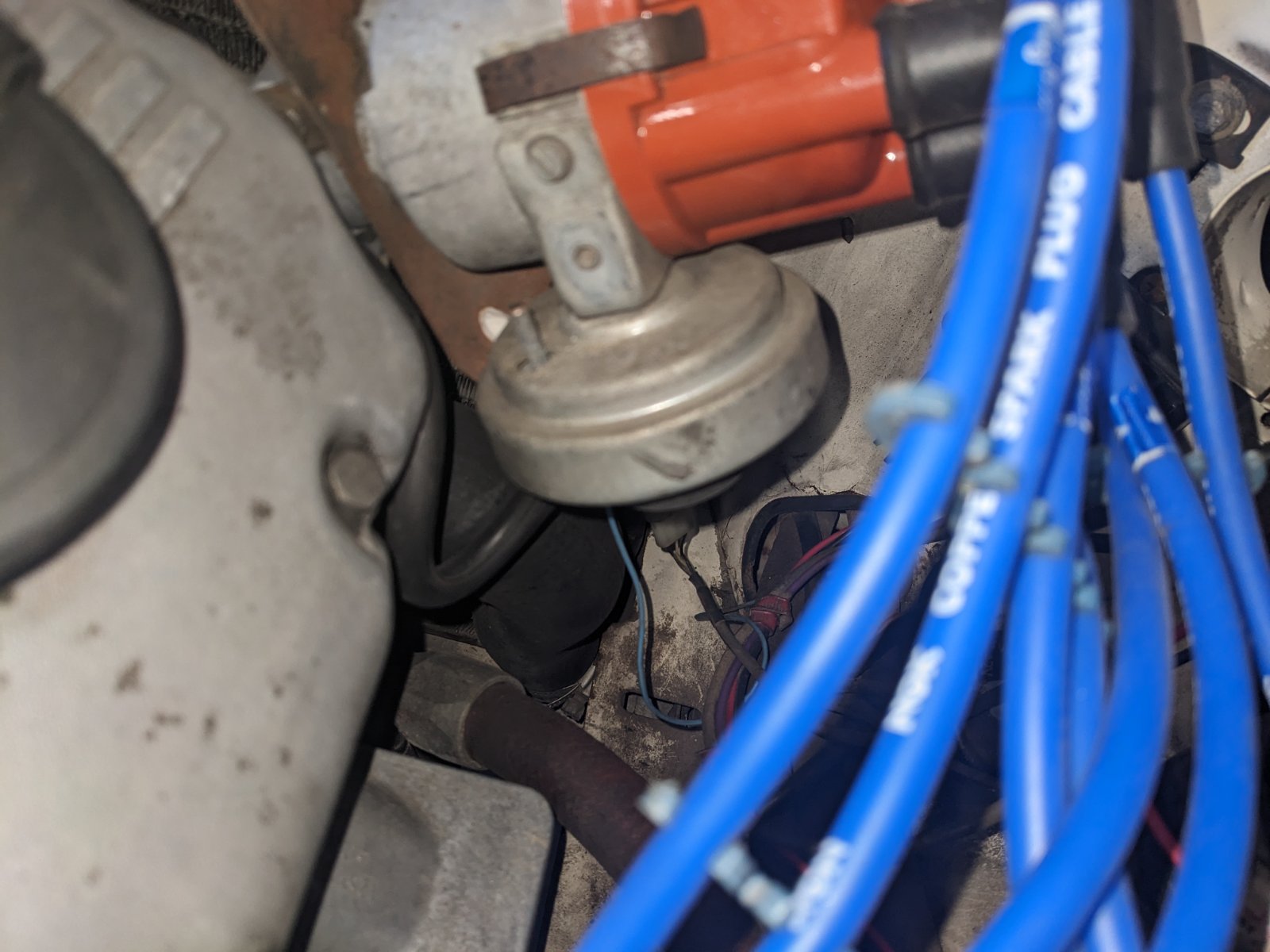

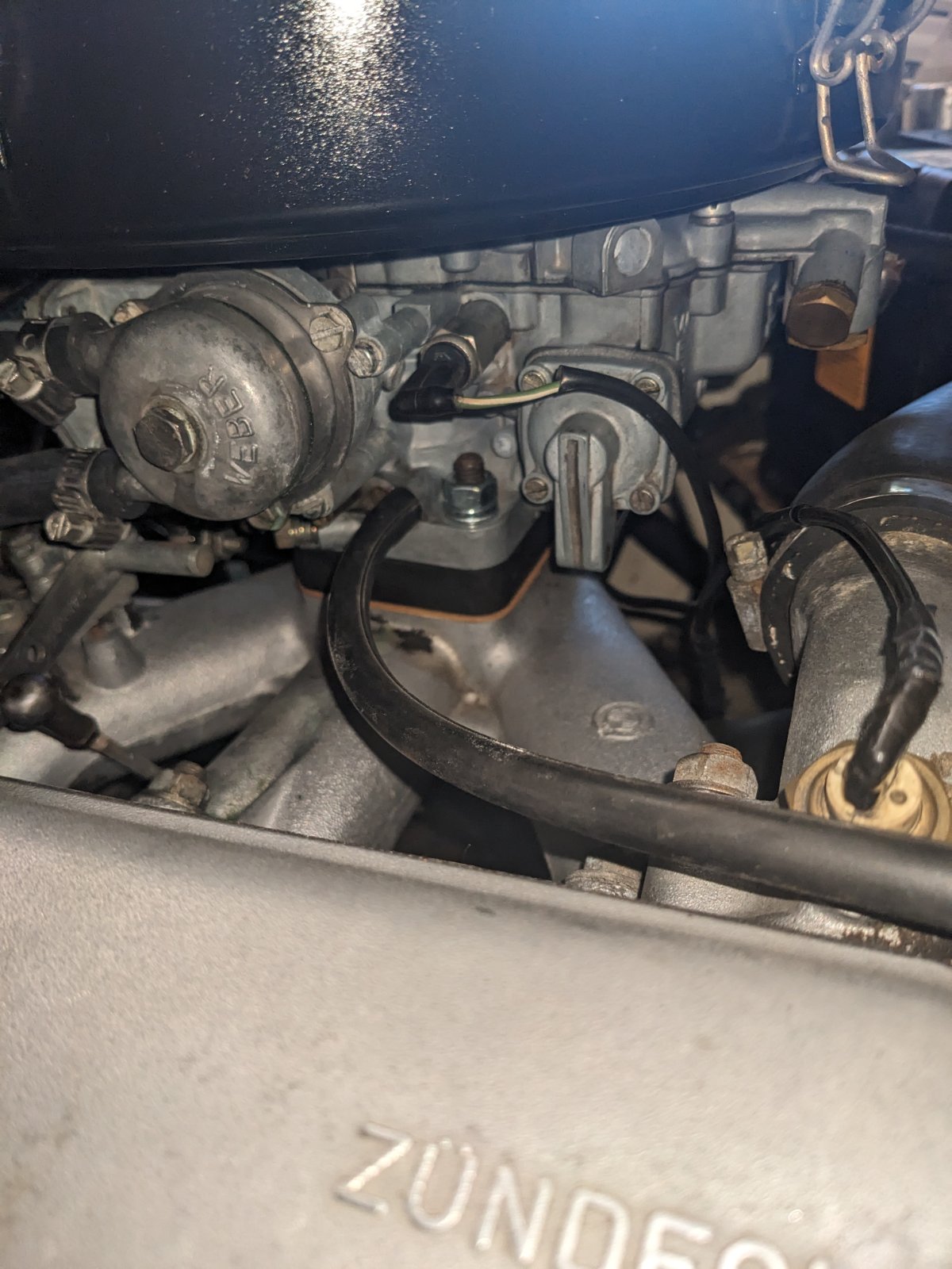

Regarding your vacuum question here is a pic of my vacuum advance as @HB Chris described. No retard hooked up.
