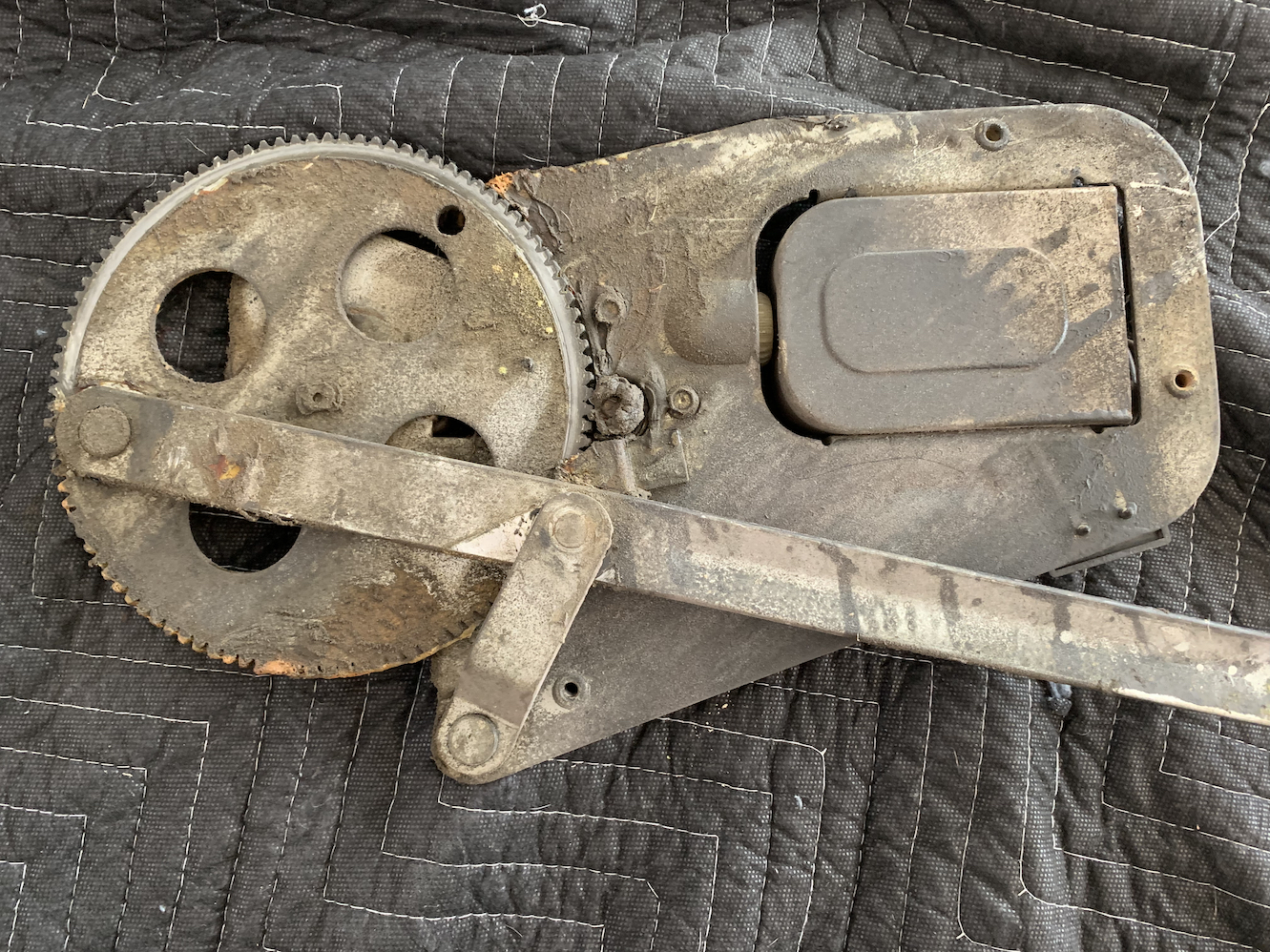

Pulled the pax side regulator today. Absolutely caked!
Don't think so. I think it's just 46 years of dust and grease. I don't think that grease had seen the light since its days in Bavaria.

Where I may have a problem and was looking for a little insight is on the mechanism. At first I put it in a vise to see if I can move it. Not a chance so I have it soaking in PBB. Should I be able to move it by hand? Also without the mechanism on the door it is still somewhat hard to move the window. Any tips on grease to use for lube?
You should be able to move this gear and arm by hand as long as the motor gear and big gear are not engaged. Some times you have to push the arm near the gear in the direction it should go to get it past a middle balance point.
The windows are heavy and not easy to move in the door. With that said you need to check the roller mechanism closest to the latch end of the door, that holds the glass and make sure it's not all gummed up with hardened grease.
