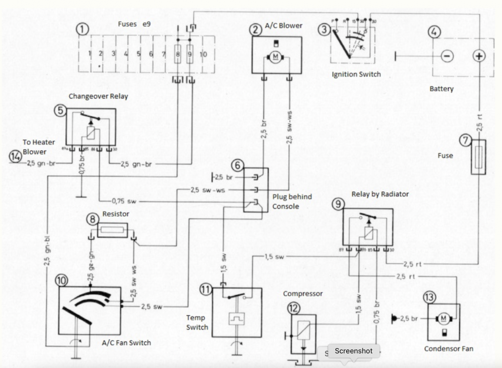

If it is stock, the AC electrical system looks like this...

Wayne - random thoughts. You mention shorting, and that your blower fan no longer works. Is fuse 8 intact?
Assuming it is, you indicate you have power on both ends of fuse number 8, but no power on any of the terminals at the fan switch. This indicates to me that you may have a problem in the blue/green wire that runs from the fuse block to the switch. This seems odd, since there are no connectors, but next step here is to check the blue/green wire for continuity.
The fan switch provides power to the blower fan, activates the relay that shuts off the heater fan, and provides power to the temp switch for both the compressor and condensor fan. If your blower fan doesn't run, and you don't have power at the fan switch, your compresson and condensor fan won't run. In other words, you need to address the upstream problem of power to the fan switch before moving downstream. Impossible to say right now if the switch is ok. Get power to it first, then address the blower fan, then move on to the temp switch and the rest of the circuit.

.. This indicates to me that you may have a problem in the blue/green wire that runs from the fuse block to the switch. This seems odd, since there are no connectors, but next step here is to check the blue/green wire for continuity.
Exactly, there is mention of electrical shorting happening, if said shorting was determined the hard way (not by measuring continuity but by rather energizing the circuit) the wire may have overheated and be compromised (either open or short to another one).
I agree on checking continuity of that circuit.
Usually voltmeters don't distinguish between an open circuit (zero voltage with high impedance) vs. a short to ground (zero voltage with very low impedance) so it is best to measure continuity.

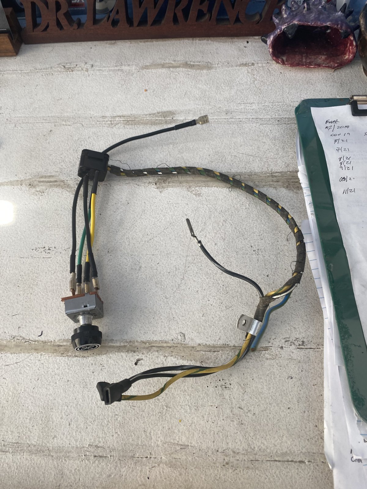

Happy ending, guys. Don just wrapped troubleshooting and repair. The AC fan switch green wire had a blown undersized 15 amp fuse put in by someone before me. And there was a loose ground wire too. After putting the console trim and shifter back, I enjoyed a nice drive down the street and I'd swear the AC has never blown more forcefully or cold (admitted 52 degrees here in Virginia today). So Bluebelle is back in action and ready for Sharkfest and Saratoga, at the least this year. And I'm hoping the Apple Series she got to star in 2022 will be coming out this year - it's called The Big Cigar. I'm hoping there are some good scenes with my car for all E9 fans to enjoy. What a saga of repairs and issues since the movie shoot, though! Thanks Don and Chris!

How fortuitous!. I was cleaning out my basement and I came across a small harness from my E3, could not recall what it was but it is identical to Don's picture above. 10 years ago I needed a new AC switch and Koopman hunted one down for me that also came with all the wiring. I blame it on having too many cars rather than age.
