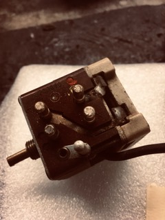

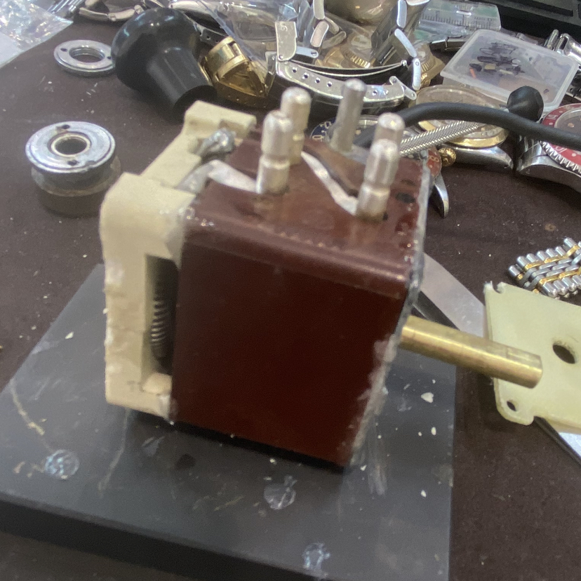

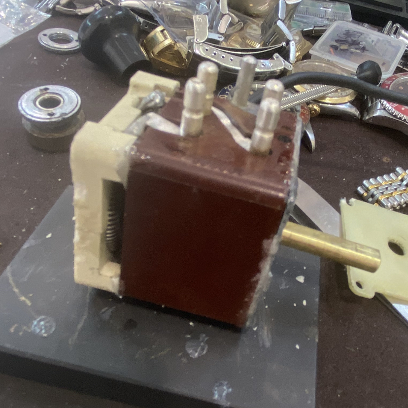

It actually looks as though there are 5 terminals, look closely.

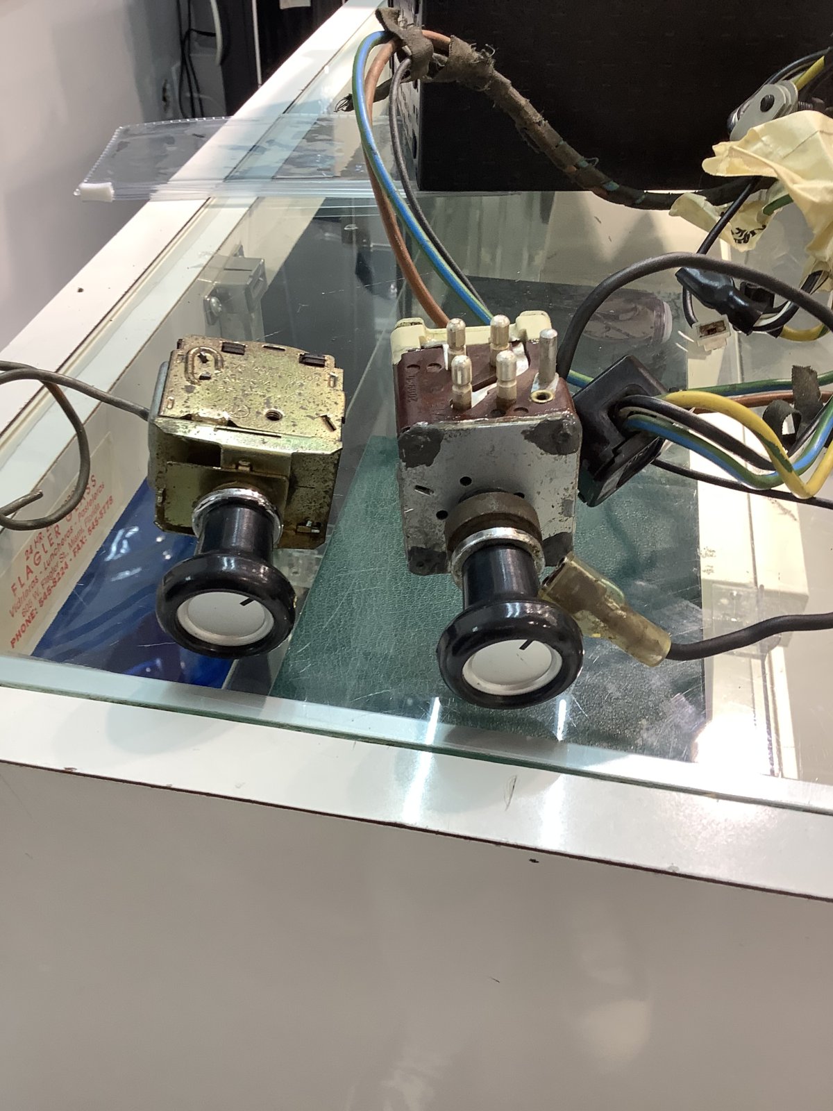

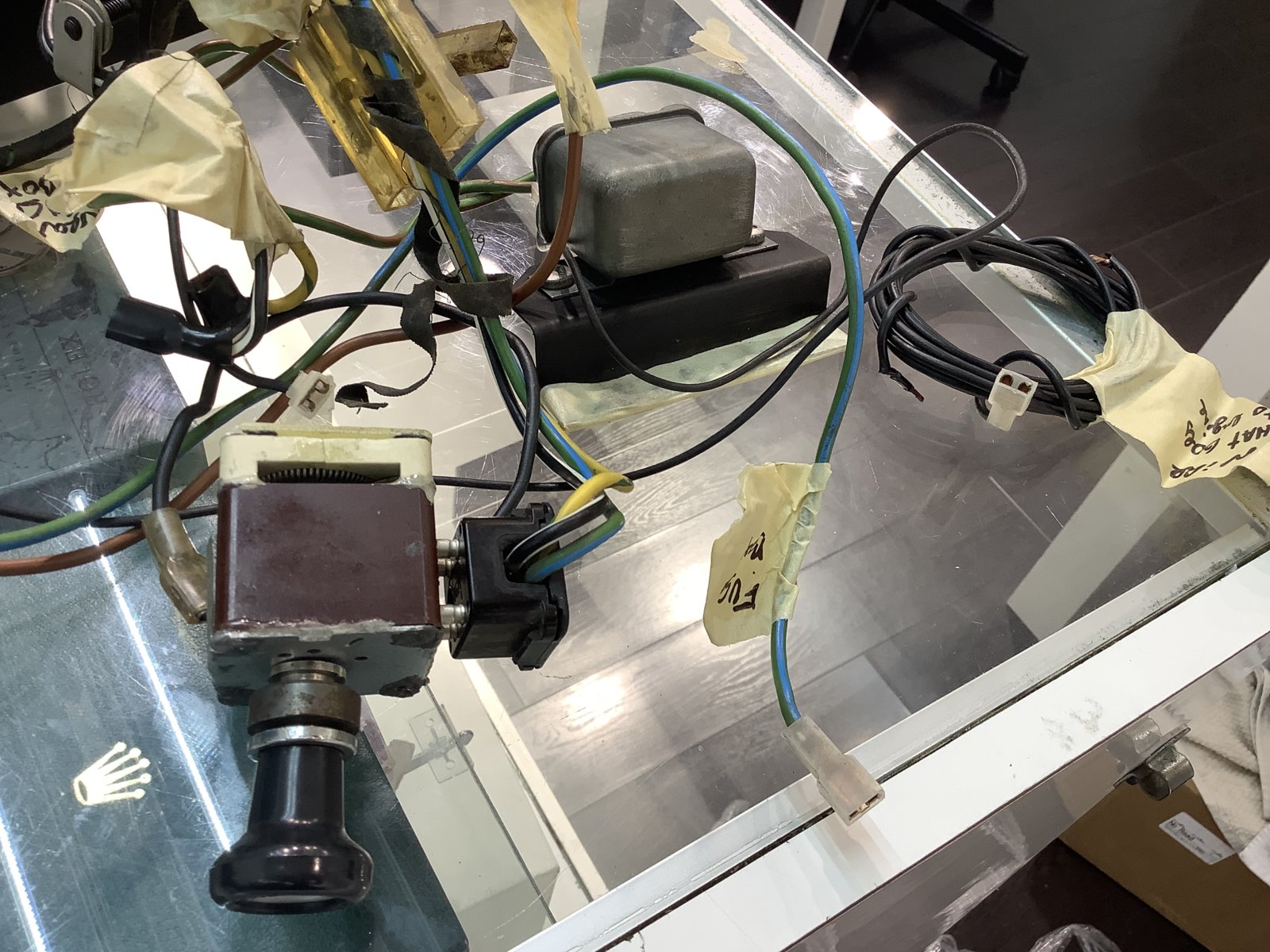

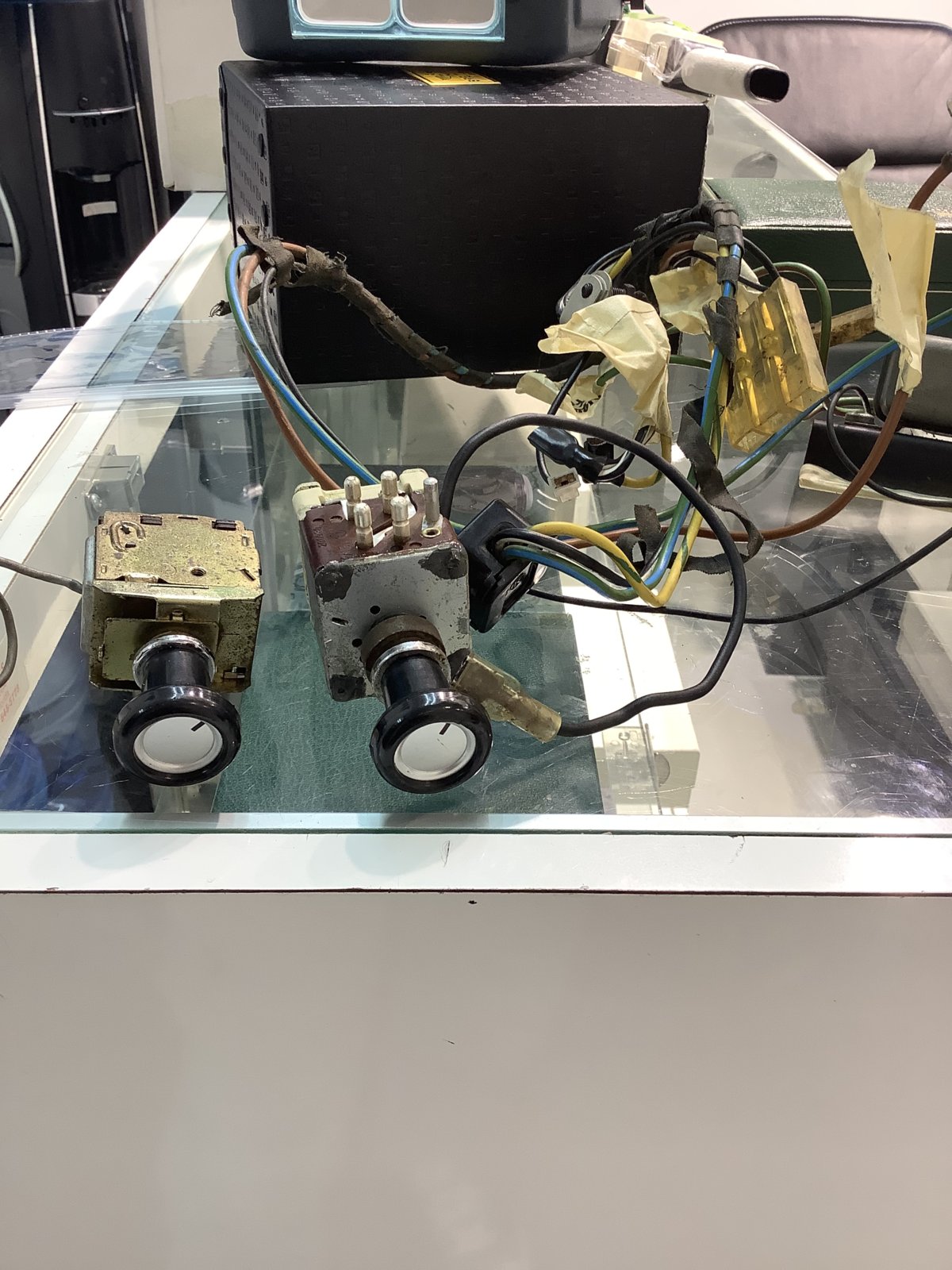

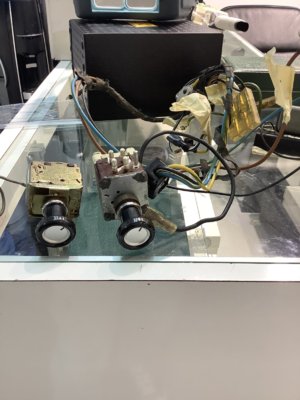

sounds like you have a 72 car with a 74 AC system so will need the later switch.

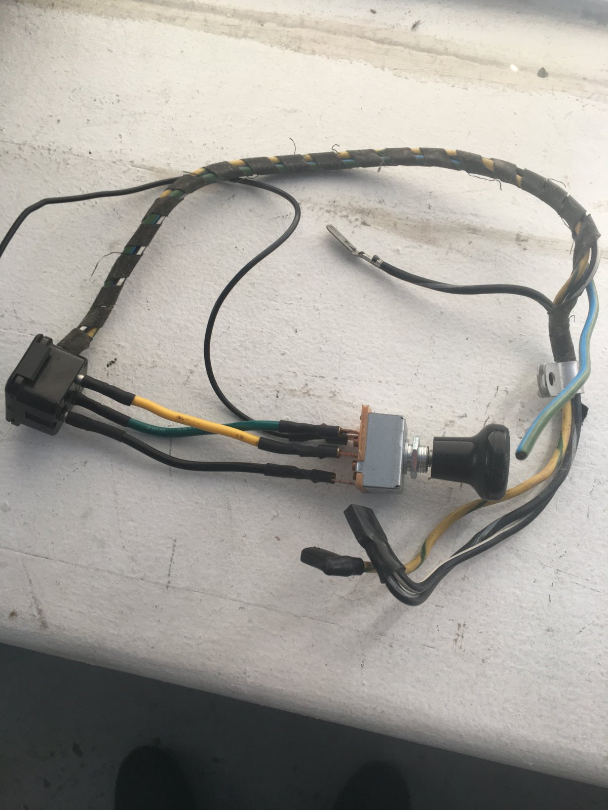

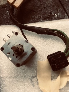

Clearer photos…I do have a 72csi and the person who sold me the complete E9 AC system said he removed it from a later car which I believe was a 73-74cs. I purchased the whole system very complete with all original hardware. Thanks @bavbob for posting the switch I need. I just PM’d you.

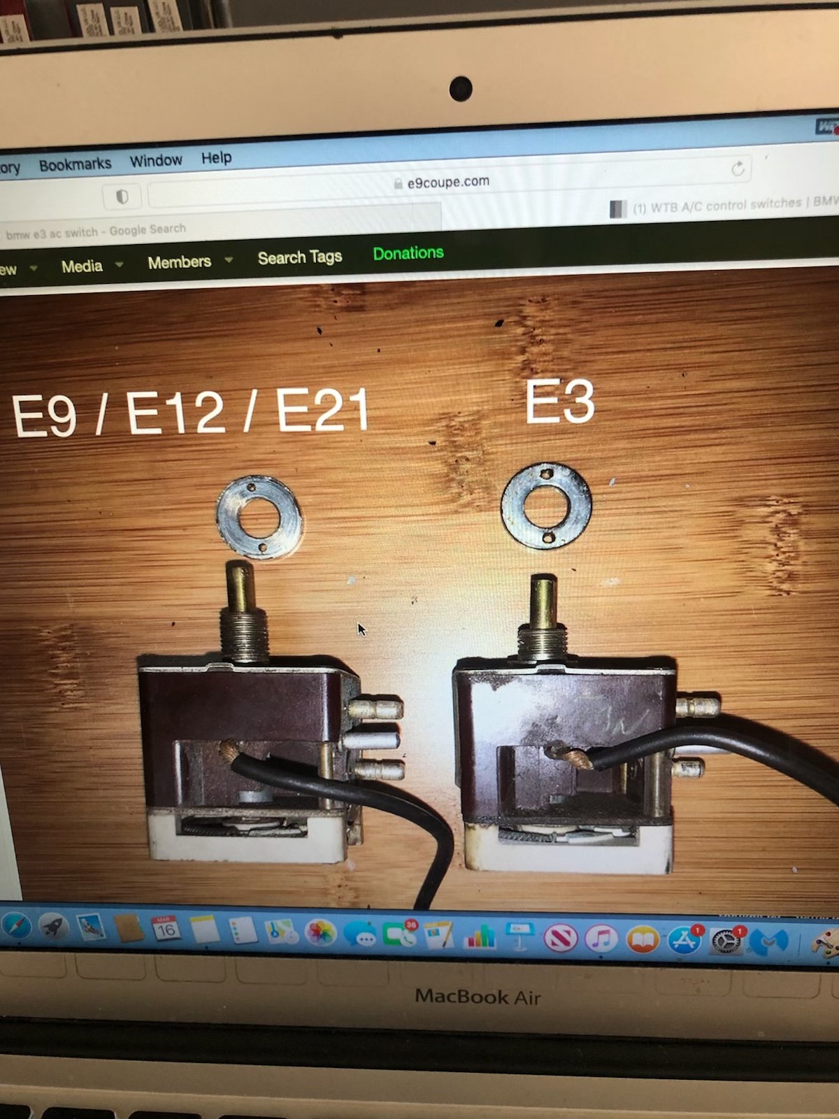

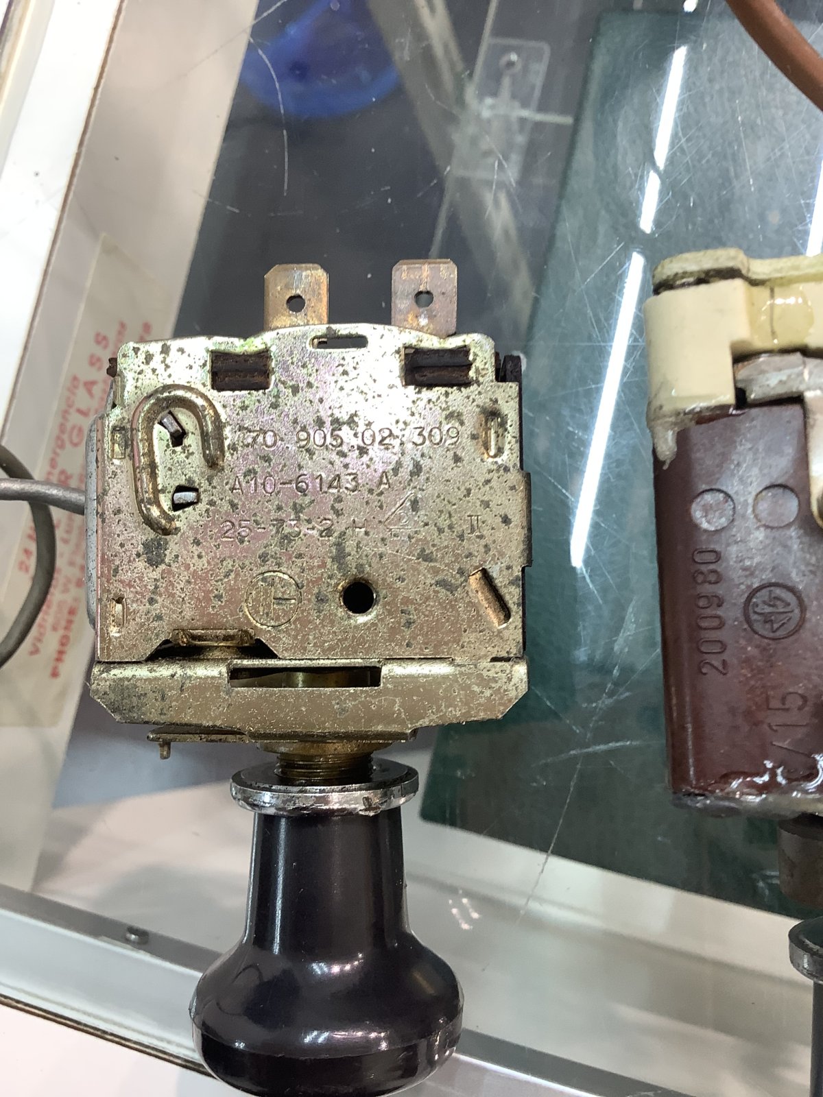

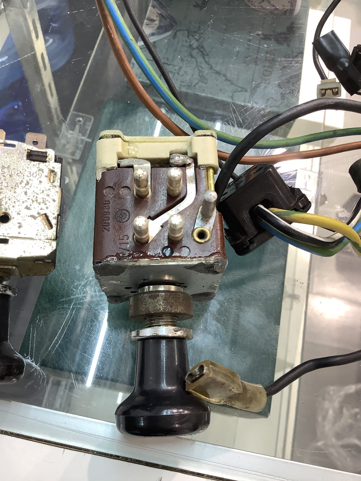

The E9 switch has a longer stem and threads because of a small spacer (not shown) installed to the inside rear of the AC faceplate. The longer stem, threads and spacer allow the switch extra rearward clearance for the plug socket to line up correctly. It would seem the E3 does not require as much clearance.

It’s a tighter fit in the e9 as it has to have the plug horizontal, in an e3 the panel is taller and there is room to have the switch vertical as I recall.
FYI. My switch is clearly an E3: 19mm total post, 7mm= length of threaded portion.
