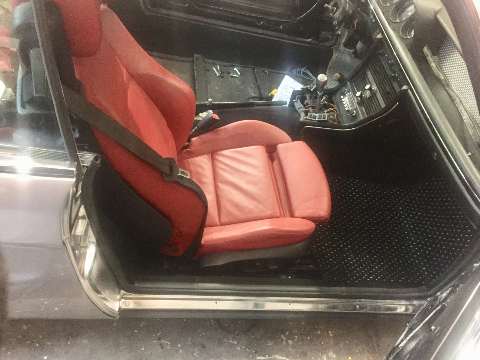

Bmachine, cut out the existing perch.
If you look over at the driver side you will see a 1“ x 2“ rectangular piece that was welded to the floorboard. The bolt holes match the location of the E 93 bolt holes.To the front I welded Square plate on the bottom and top of the existing floor board.
Drill holes, bolt in.
The bigger challenge is the electric operation of the seats.

And, after working on the car today, I decided I’ll put the aluminum trim panels back onto the side of the car. Instead of using the BMW studs that held the trim in place (oops I‘be welded and filled all of the panel holes) I will use 3M double stick tape to put the trim back on the car.

For what it’s worth, I relocated the battery to underneath the backseat and went with one of the small lithium batterries, this giving more room underneath the hood.
