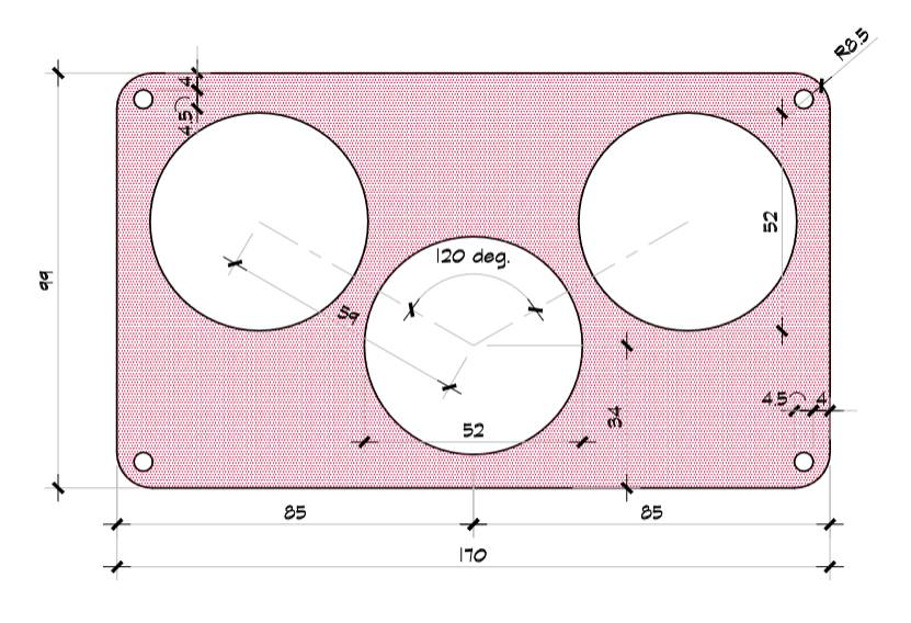

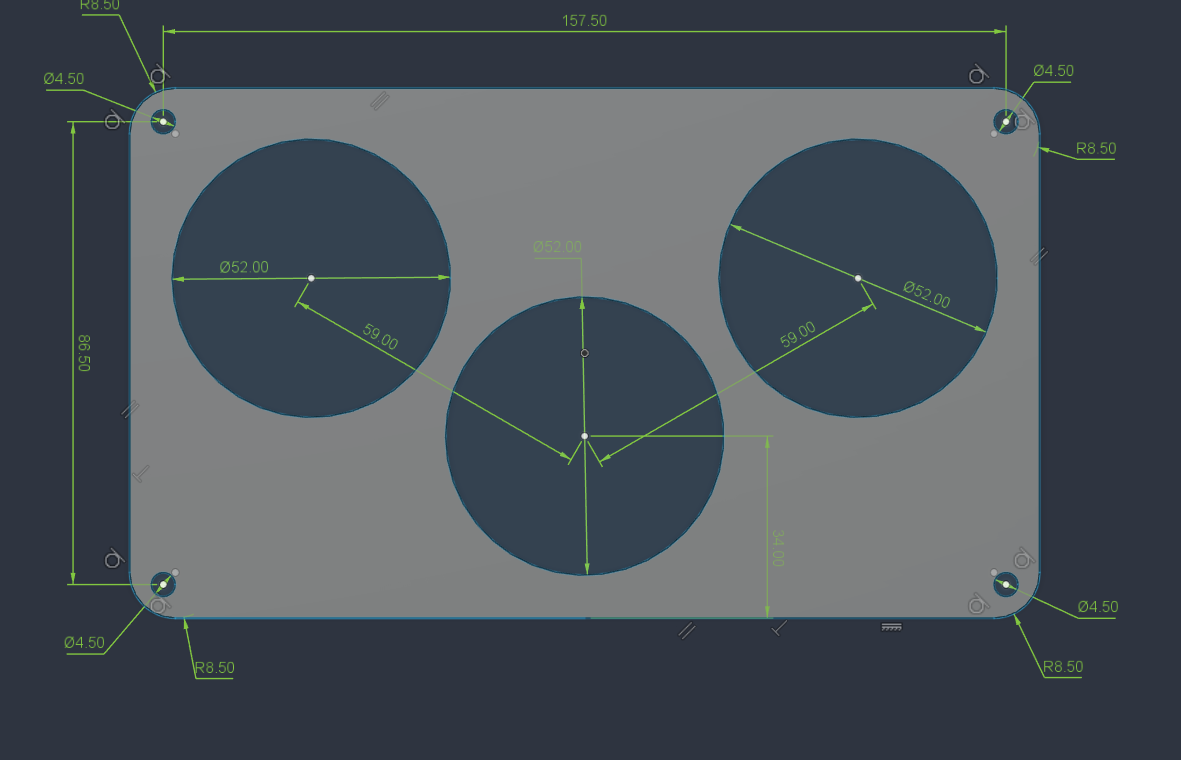

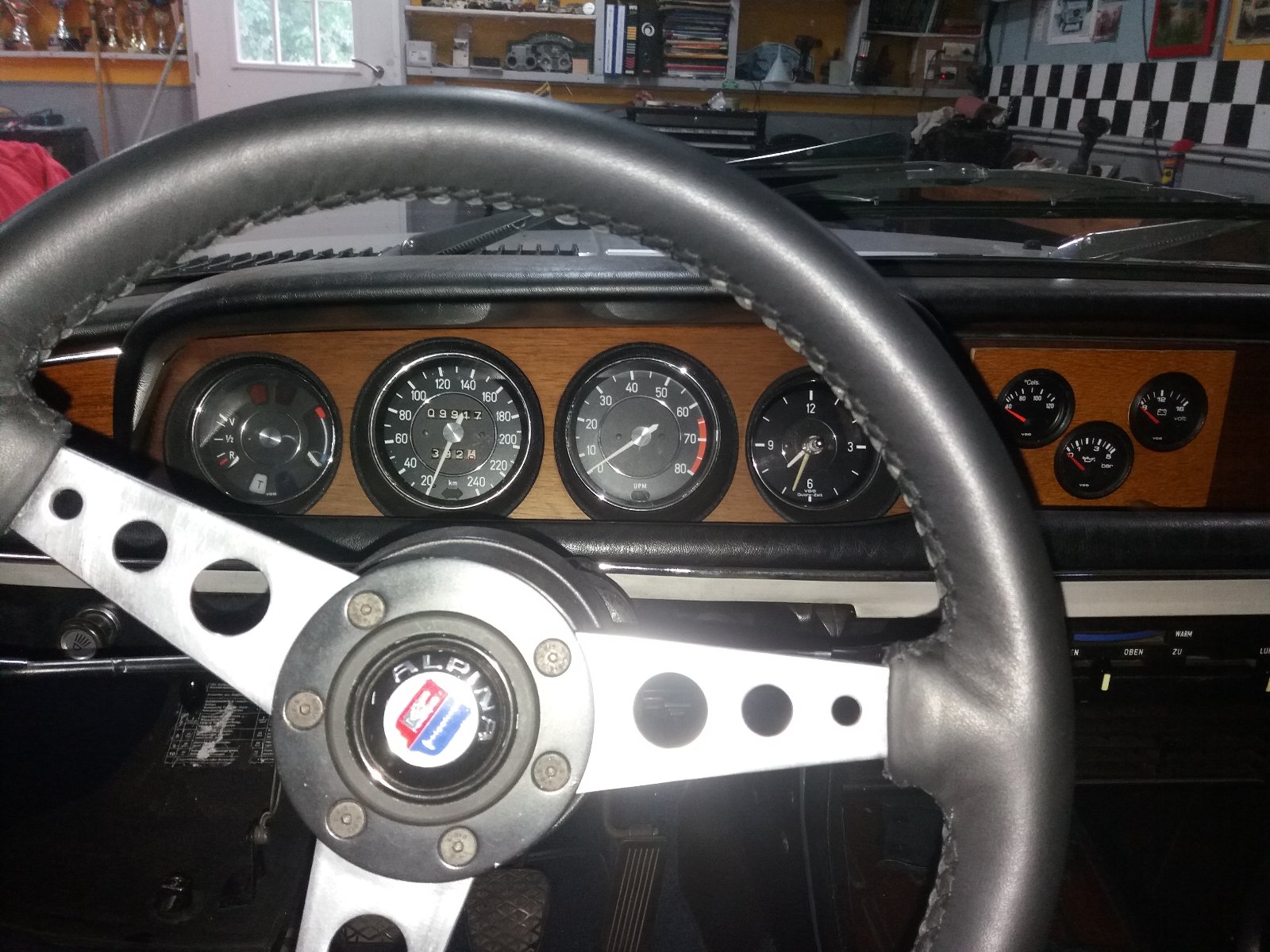

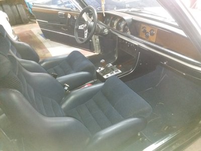

Thank you, Scott, for posting that. I used your 2d to create my 3d that send cut send will accept. I will also send anyone the 3d file also. I know that I want an AFR gauge and an oil pressure gauge but not sure after that. I will keep yours in mind.
