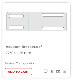

A laser cut black powder coated plate that attaches to the actuator and has the wooden speaker grill double sided taped to it.
Plus some custom brackets and relays.

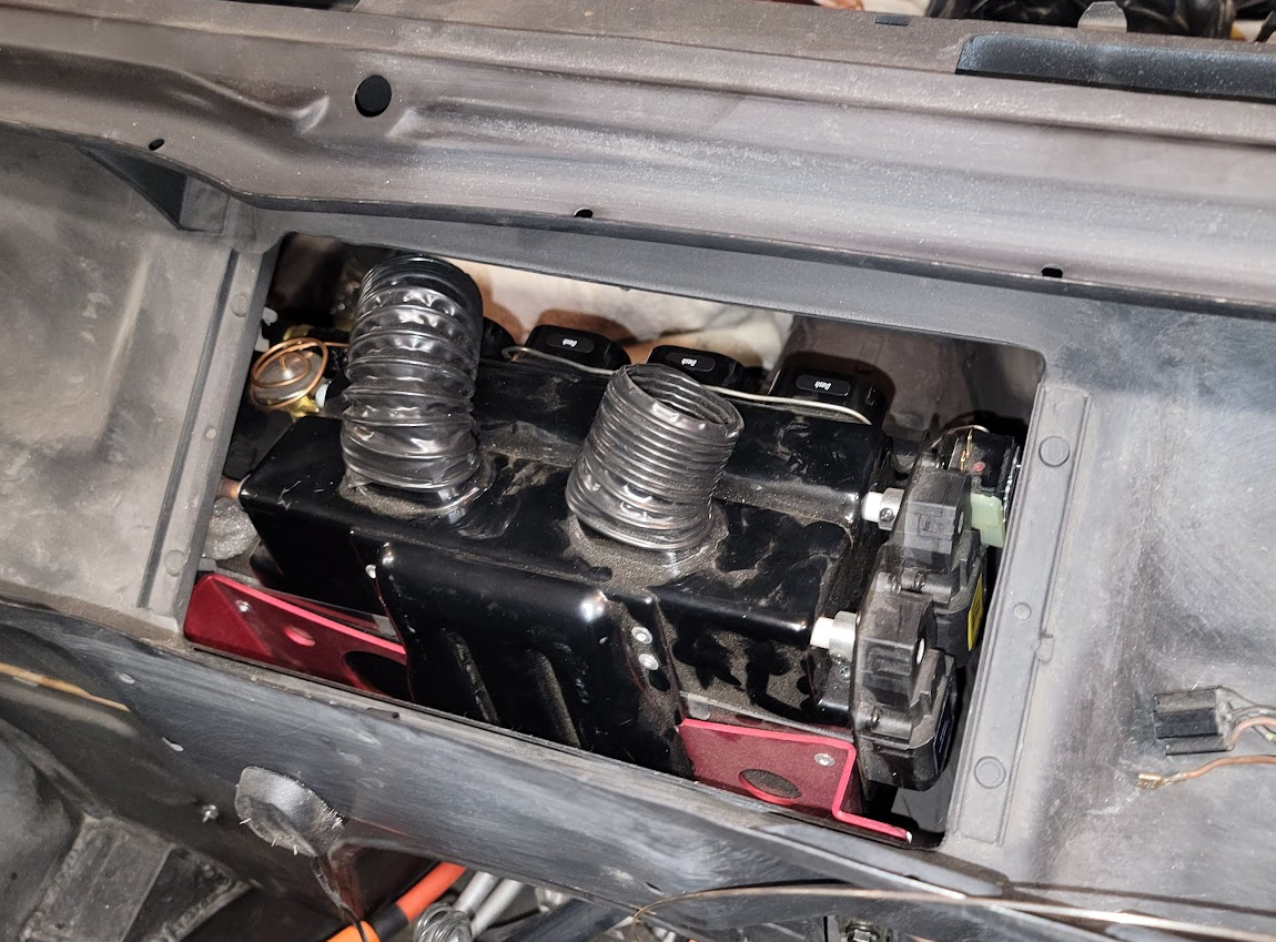

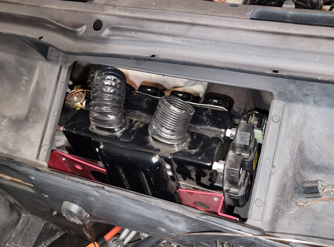

Autre petite question, avez vous toujours le boitier de chauffage sur votre voiture ? Sur la mienne je passe a peine le doigt sous le tableau de bord.

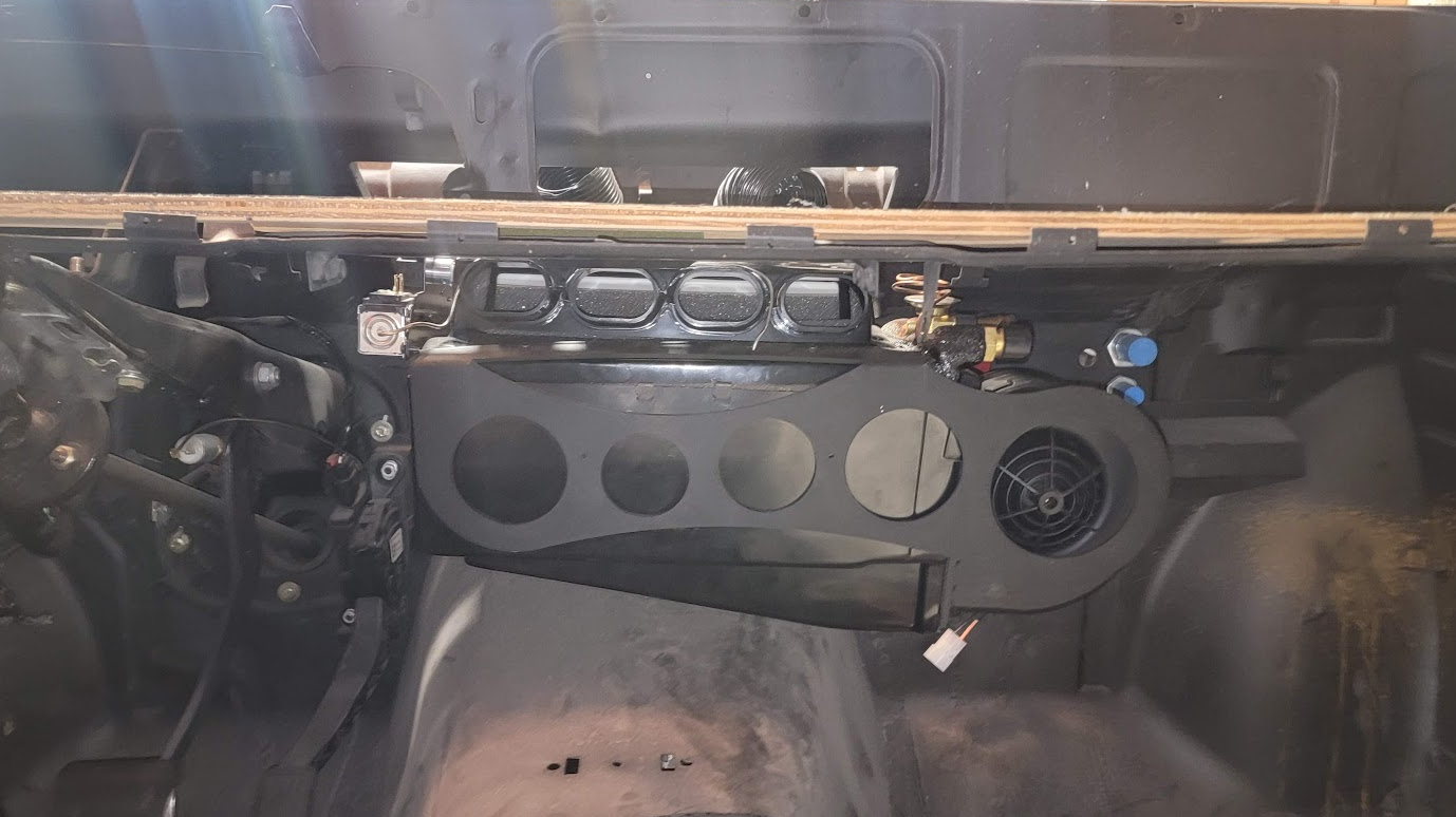

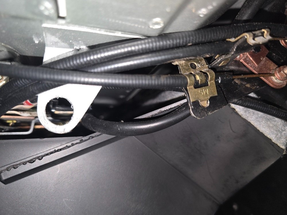

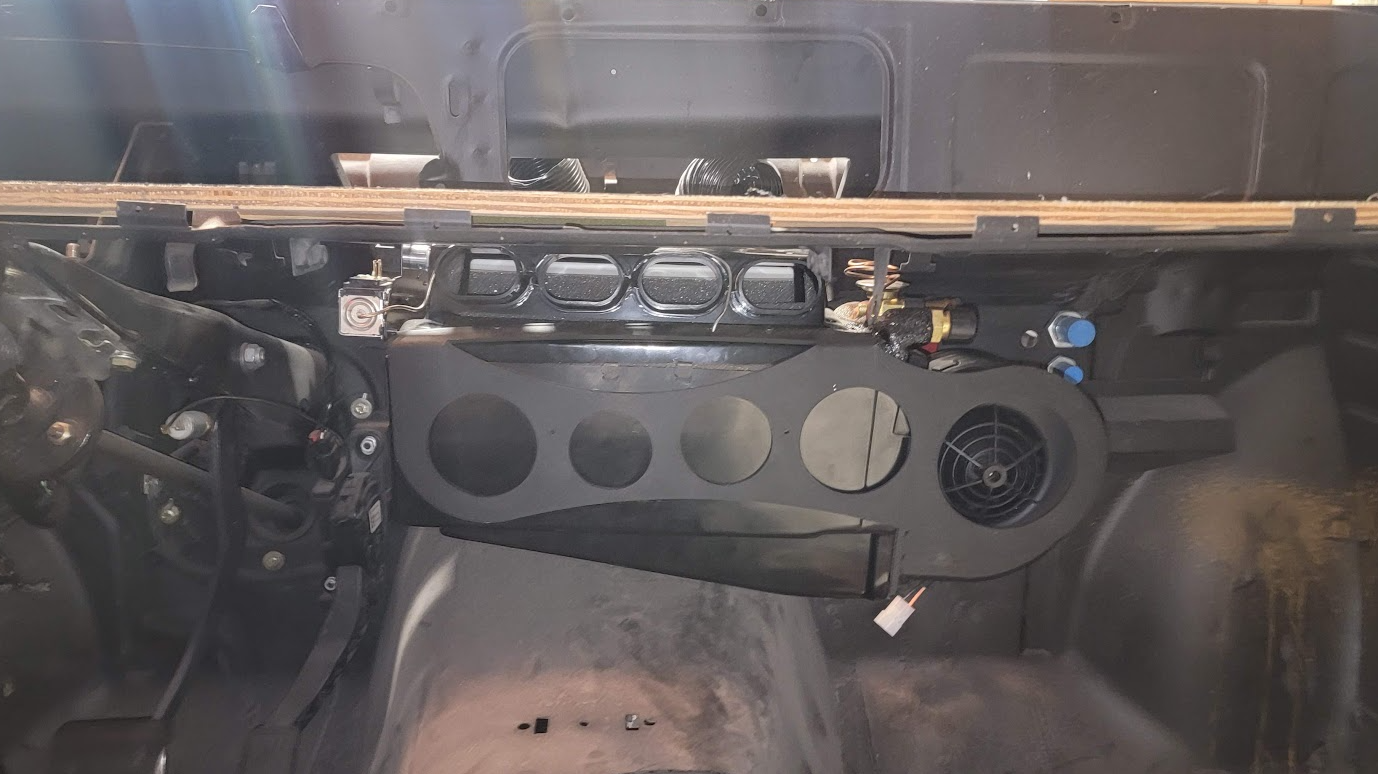

Good point @TM83 -- I did not use the factory heater box. This was a non-A/C car (and obviously quite custom) so I used the Restomod Air Vapir 3S HVAC unit. it is a nice solution, providing dehumidified air to the windshield, modern o-ring fittings to the modern evap, servo-controlled blend door, reduced size, etc. But it introduces a whole host of new problems to solve -- integrating the factory cable controls to the digital inputs, shortening the glove box, re-routing the heater hoses, fabricating custom ducts for defroster and dash vent integration, etc. This isn't such a problem when you've already ditched the ICE for EV but the juice probably isn't worth the squeeze for most owners. However, it is what freed up room under the dash for my sliding speaker grill.
I've always felt that the stock A/C implementation was a hacky dealer-installed after-thought that takes up a lot of room with extra fans and controls and no true integration with the heating system. If anyone wants details on how I solved the challenges with the aftermarket HVAC unit I can start a different thread but I suspect the purists are already close to seizure at this point.
