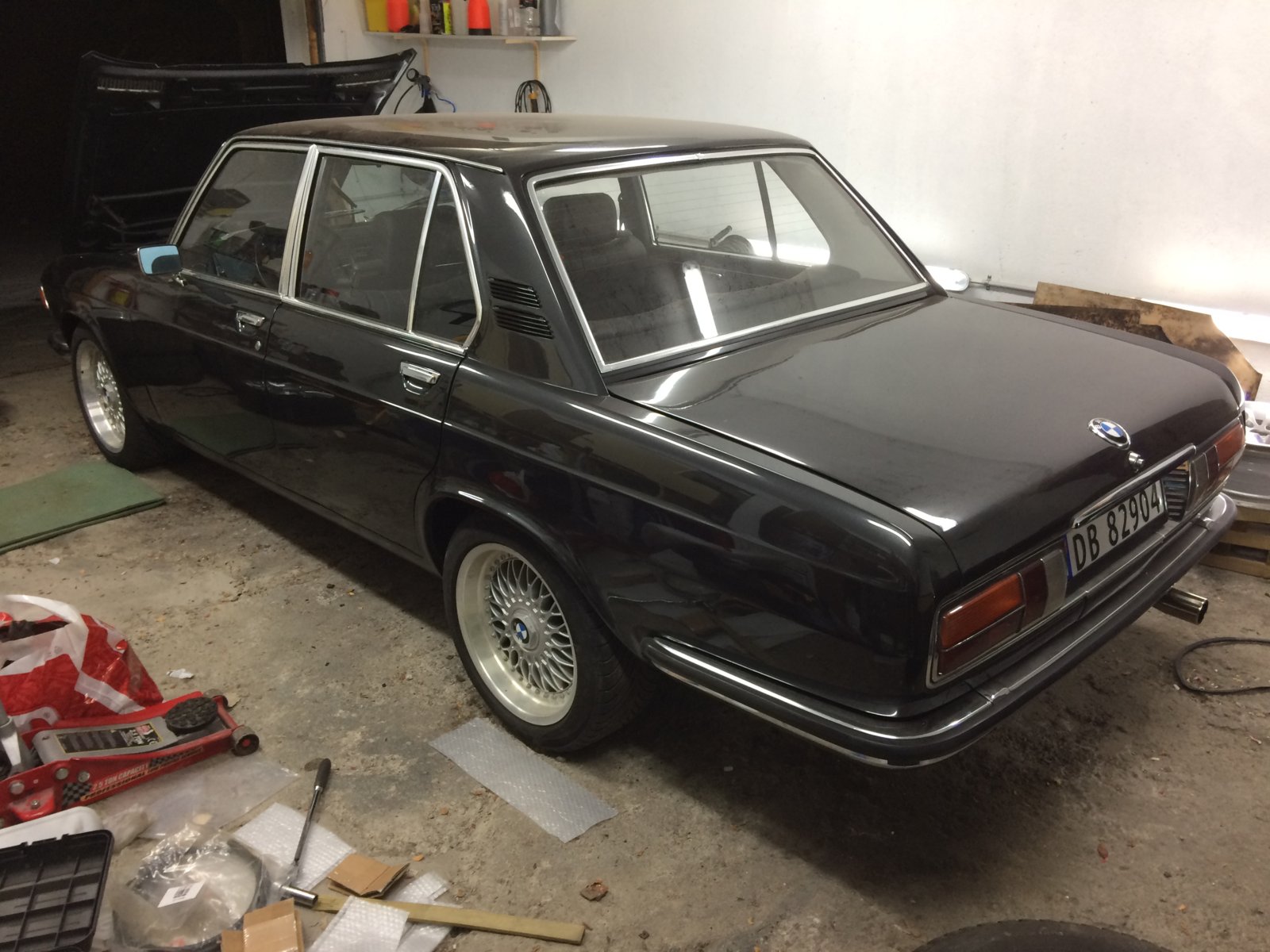

Looks great! I really like the clean sides on these models - no side trim or lights. Is that a single carburetor setup?
Yes thats correct. It’s a solex 4A1.
Both engine and carb is from an E12 528. Fitted by previous owner.
Runs ok. I’ve heard most negative things about the 4A1, but I havent had any issues so far besides a defective tn-starter.
