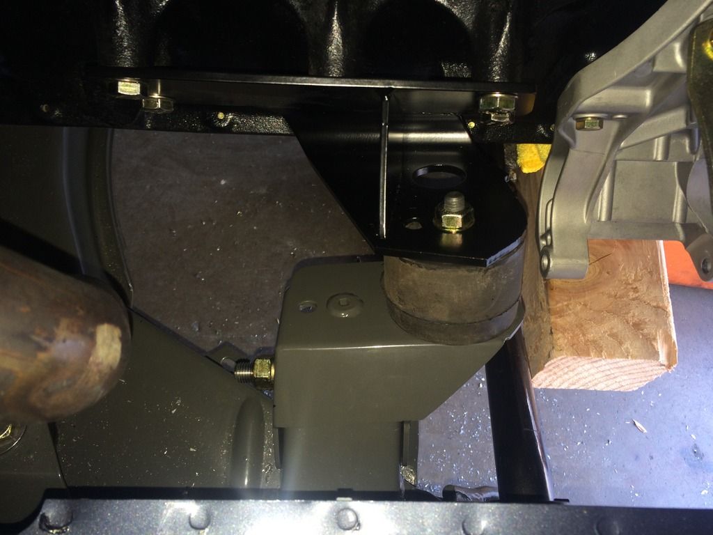

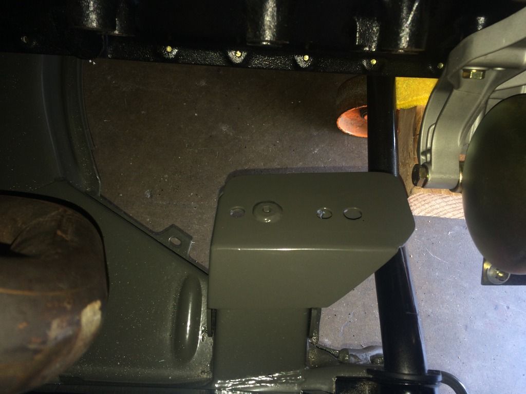

I used the Alpina headers on my coupe. The headers are not a direct fit but it can be done. You’ll need to modify the passenger side motor mount to allow for clearance.
You can see here that the headers interfeee with the mount bosses on the block
We made an adapter to fit on the subframe with a plate that moved the mount forward. Then modified the mount position on the block. This moves the mount in front of the header. None of the modifications were permanent.

I see. The header is designed for the later p-side engine mount. Nice work there.

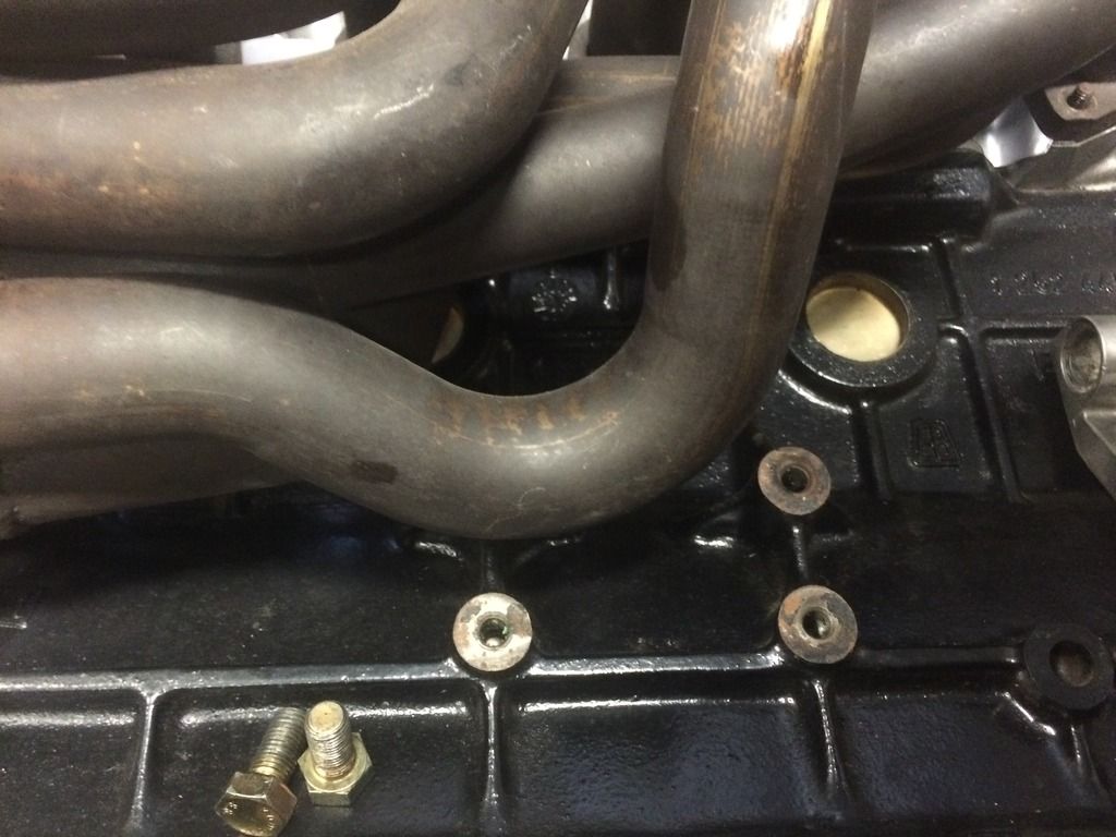

Did you smooth out the rig welds? I don’t see the joints shown on their website.

my headers were the actual Alpina headers. I did not modify or clean up any welds.

the Alpina headers were mandrel bent. I think the German ones you showed us are out together using a jig. The original bmw m88 headers were also mandrel bent. The new ones made by bmw or made on a jig. I actually like seeing the welds, it’s just another detail though could be a future failure point. How far in the future? Longer than we will ever know. Either way you’ll need to modify the mount.

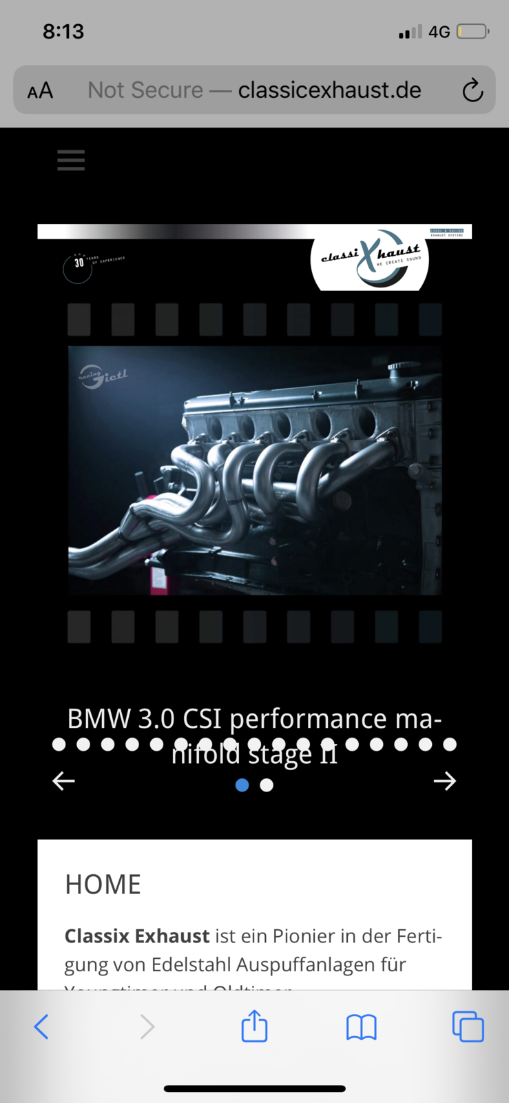

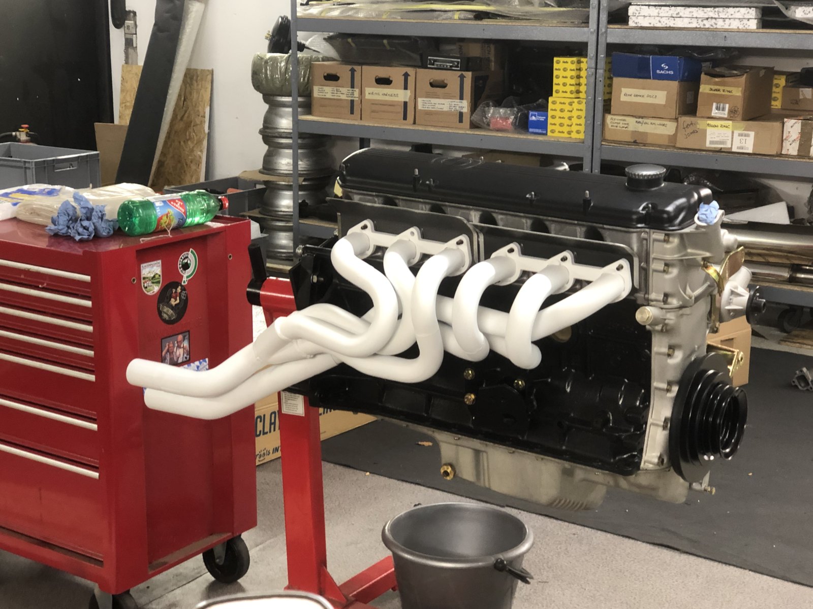

I’m pretty sure that @JamesE30 git his headers and exhaust from these guys. Perhaps he can confirm.

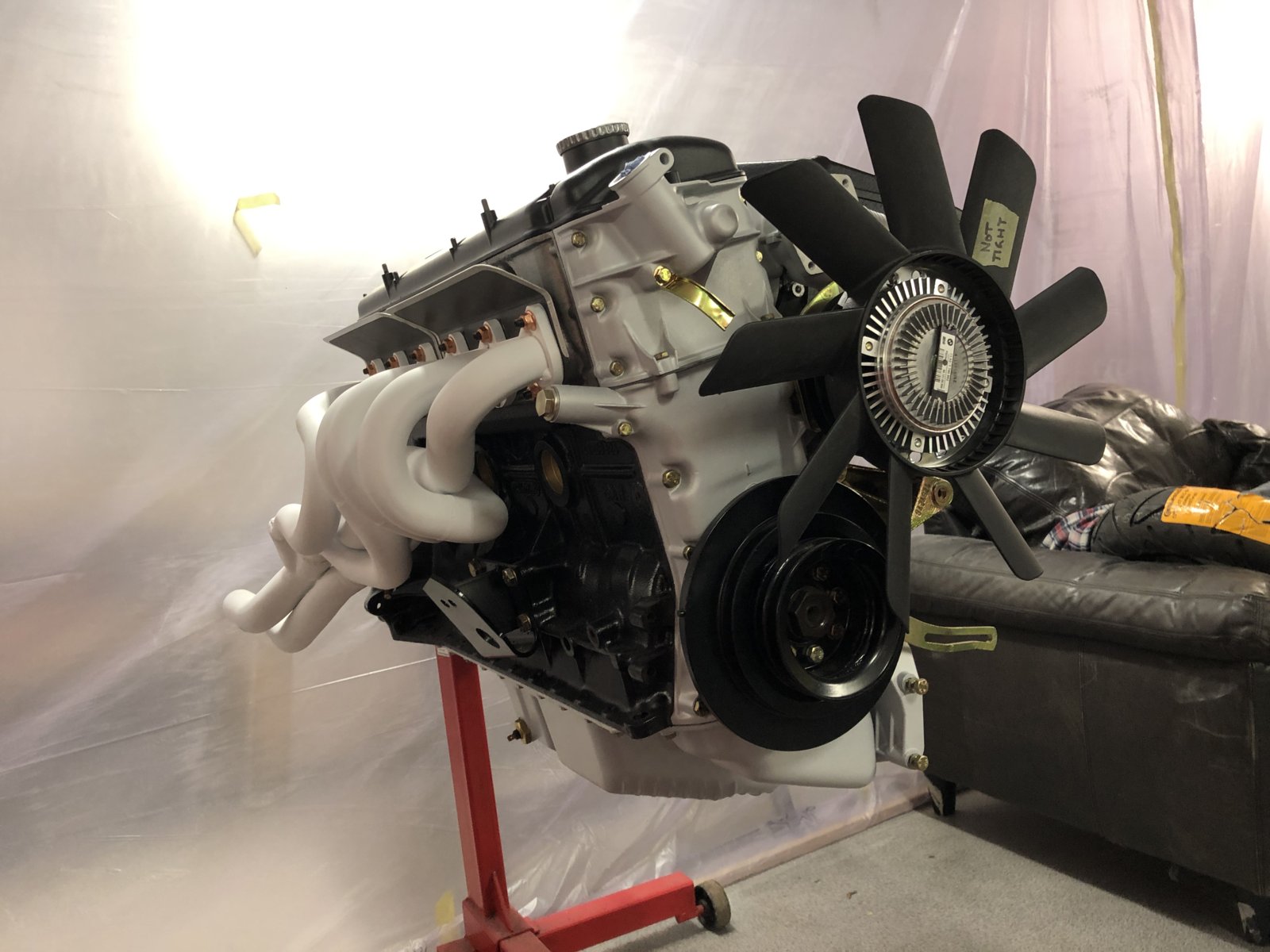

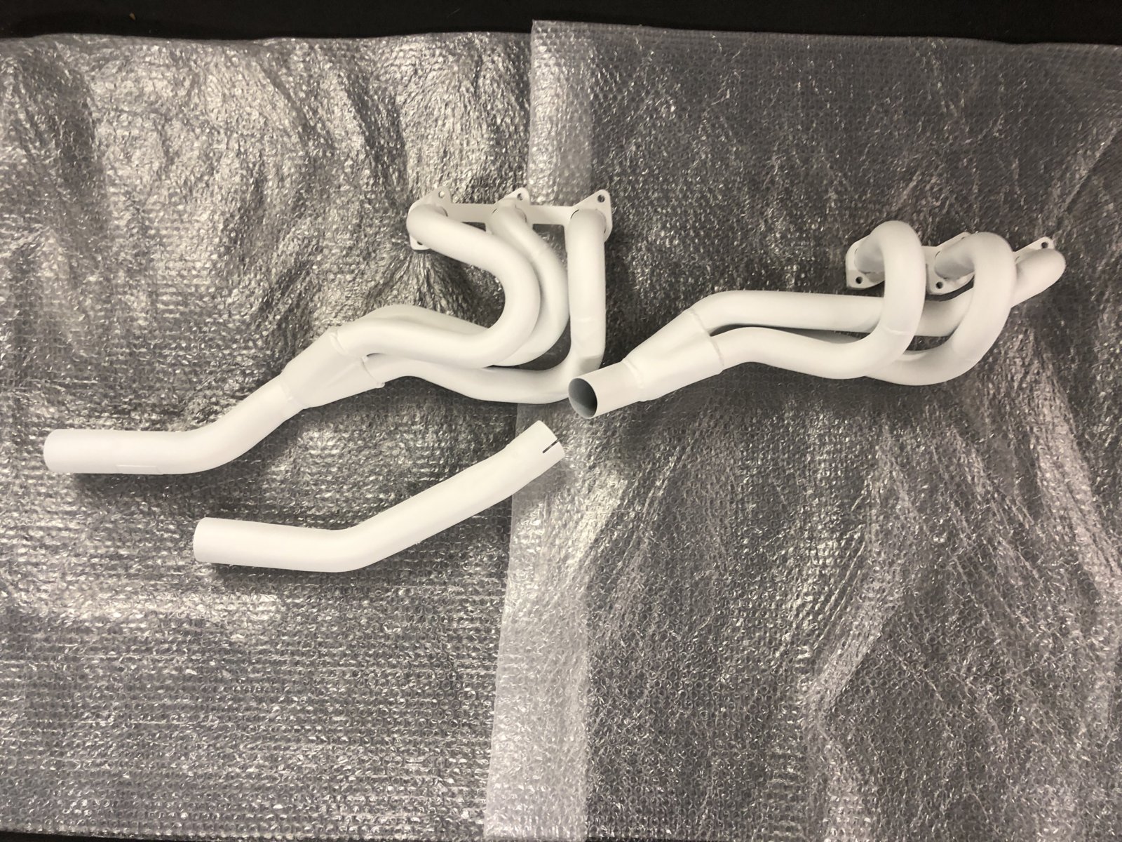

Good memory, thats actually my exhaust on the website. Sven was really pleasent to deal with and the product looks great. I had mine ceramic coated, the engine is currently at the tuners on the dyno so should have it running soon.
No interference with the stub frame rails?
I’ve read posts on similar headers which required notching out part of the chassis to clear the lower section.
