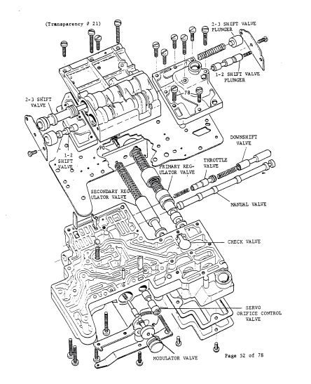

It might be helpful to know your transmission's maker so that you might consult the appropriate troubleshooting chart - and to ensure that you are using the appropriate transmission lubricant. (Per a recent thread, https://www.e9coupe.com/forum/threa...-oil-for-automatic-gearbox.31361/#post-255784 BorgWarner 65 automatic transmission, would use "Type F," while a ZF 3HP20 type would use Dextron or Type A.) That said, I drove several ZF auto equipped '70s BMWs and never experienced the problem you describe. However, I also drove an E3 with a BorgWarner 65 automatic that experienced hard gear engagement, but the problem was corrected.
Numerous things can account for harsh/abrupt shifting into gear. As Arde noted, "ALL" auto-equipped vehicles will shift harshly if the idle speed is too high and (anecdotally) the problem may occur if the accelerator cable is too taught (maladjusted). Then, depending upon the transmission design, there are bands that need proper adjustment and servos, a control unit and valve body that all must properly function to allow for the transmission to operate as designed (without rough gear engagement).
My BorgWarner auto-equipped E3 shifted smoothly, but suffered from significant leaks. A friend familiar with the transmission, as it used by Jag, Rover and MB, owed me a favor and offered to rebuild it. When the trans was reinstalled, the driveway was dry and the shifting was noticeably crisper. Unfortunately engaging forward and reverse gears was extremely harsh and occasionally accompanied by a pronounced "bang." My first inclination was to assume either a broken mount or a broken drive line coupling, but this was not the case. From what I recall, the fix involved pulling the pan and valve body, and cleaning the control unit but I can't be more specific since it was my friend that performed most of the work. The problem may have been something as simple as dirt/debris since despite being "rebuilt" the trans pan and filter were full of metal particulates and had to be re-re-cleaned. The problem may have been due to a combination of things, including one or more binding valve springs, but this is speculation.
Did your transmission engage forward and reverse gears smoothly before your recent fluid and filter service? Did you recently adjust anything else respecting the valve body or the accelerator kick down cable?
https://www.automaticchoice.com/uploads/producten/pdfs/Catalogue/bw65.pdf
http://www.auto-repair-manuals.com/...r-65-66-Transmission-ATSG-Rebuild-Manual.html
https://www.scribd.com/document/212425631/Borg-Warner-65-66
Gratuitous images that have nothing to do with harsh auto transmission gear changes:

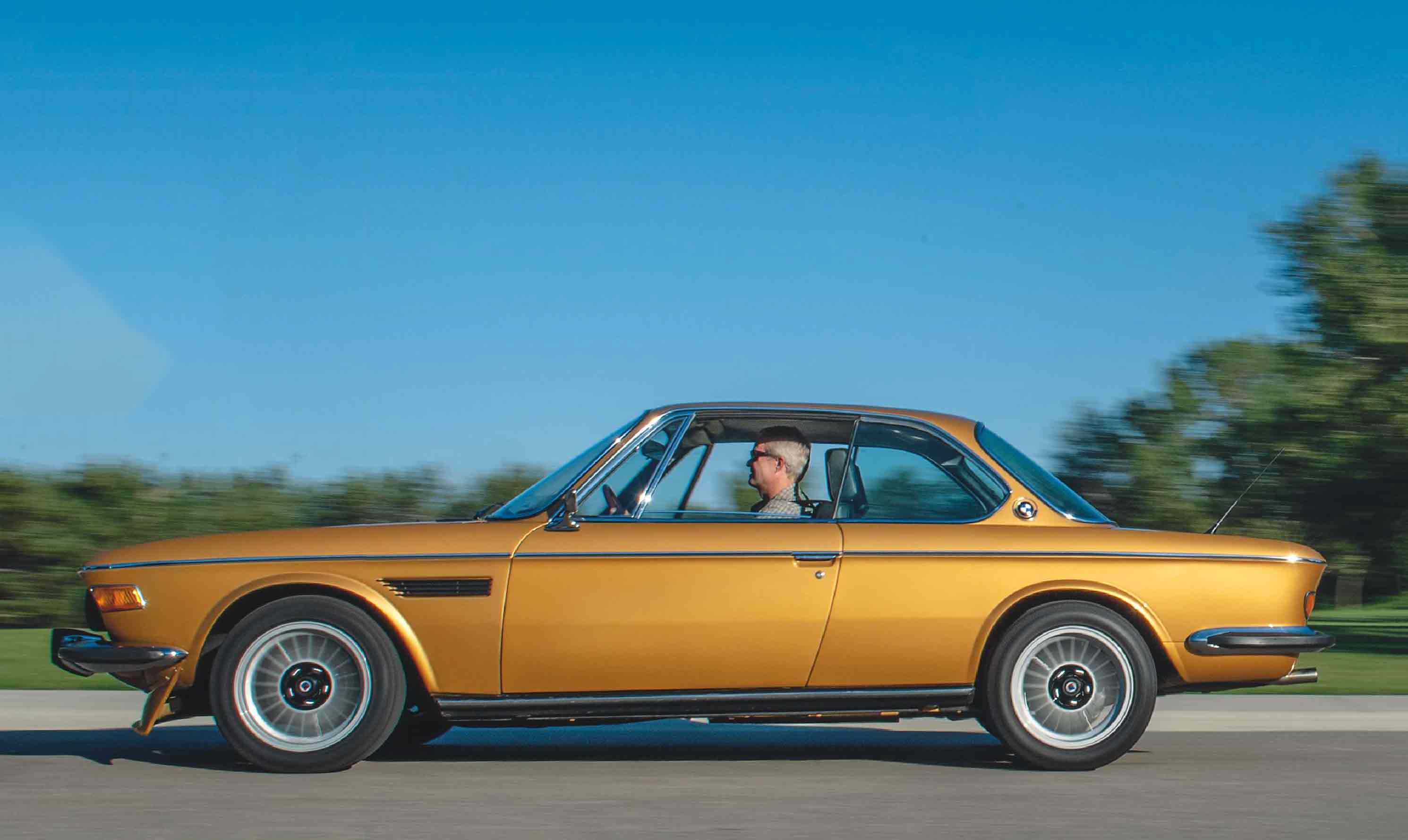

Hi Scott
Frances is fine.. the trans is fine.. shifts very well when driven.. when it is cold i have to be gentle when shifting forward(better warming it for a few seconds to bring the automatic choke down..)..It's a keeper. I rebuilt an original set of carbs..one of these days i will install it..but it is running so well i am not sure i will ever do it..
bimoverde
226
40
california
comforting..i love driving that car..the auto is a pleasure to drive in daily traffic probably not as sporty as the 4 or 5 speed but very easy to drive.. better than a mercedes 280sl that i drove for a while..
scottd
218
32
Nerve- so glad you are enjoying her, and happy to see a picture. Stay well.
Scott
