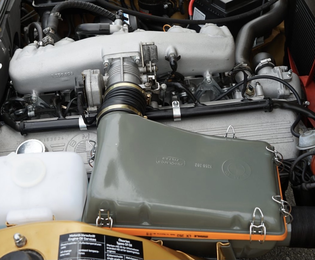

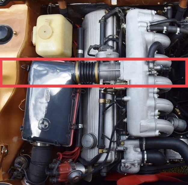

Very pretty. I like the underside quite a bit! I would honestly prefer if they leave the sound deadening off the fenders. If I were to add sound deadening (I’m not), I would paint the fenders and the deadening separately, then apply.
I am happy to see that the airbox aligns with the throttle body. Once you see the misalignment you can’t unsee it.
No offense to CSI owners with alignment issues. Not trying to create any anxiety with this academic observation. :)

Oldenzaal can never seem to get this right, or care.
