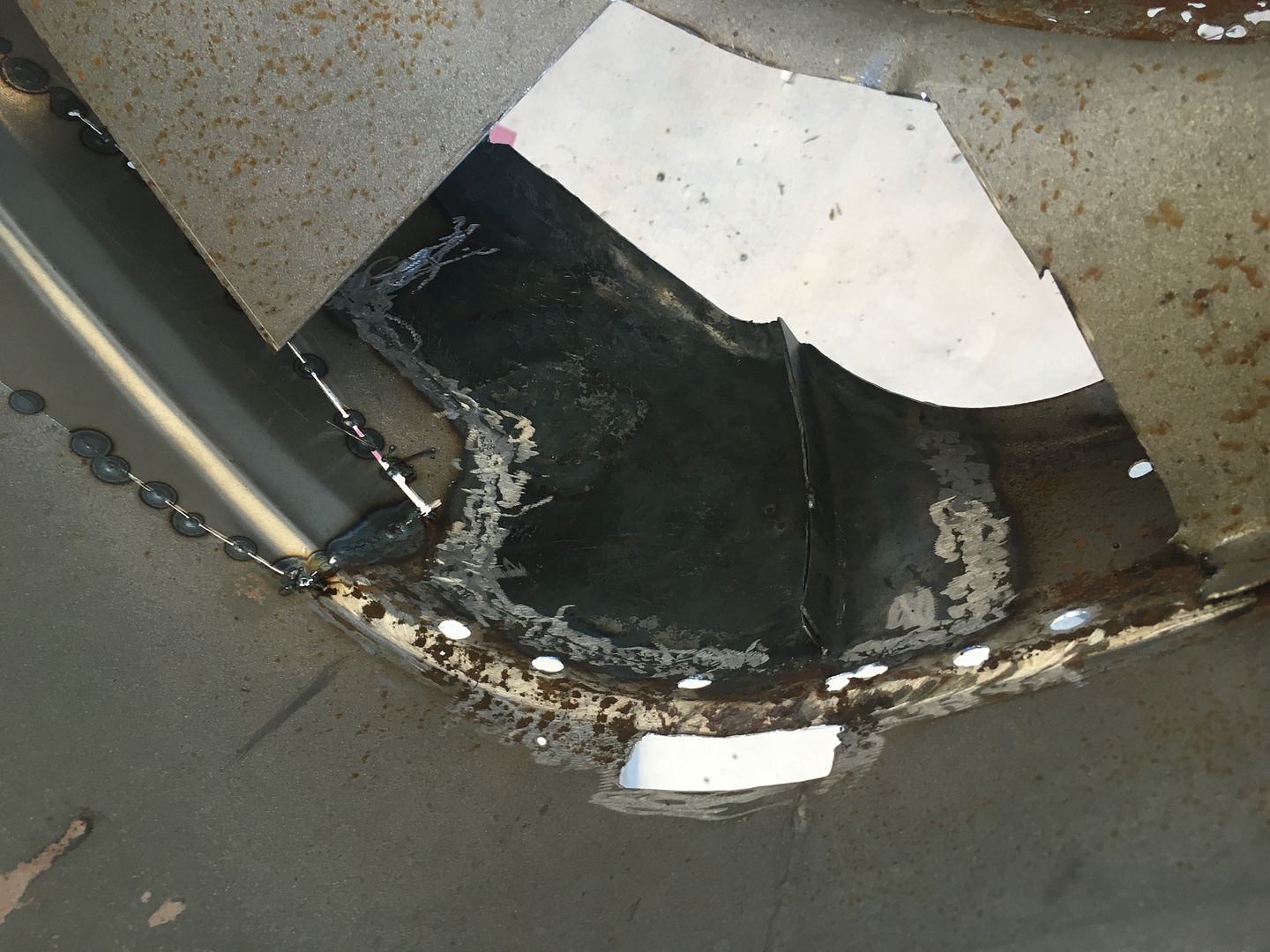

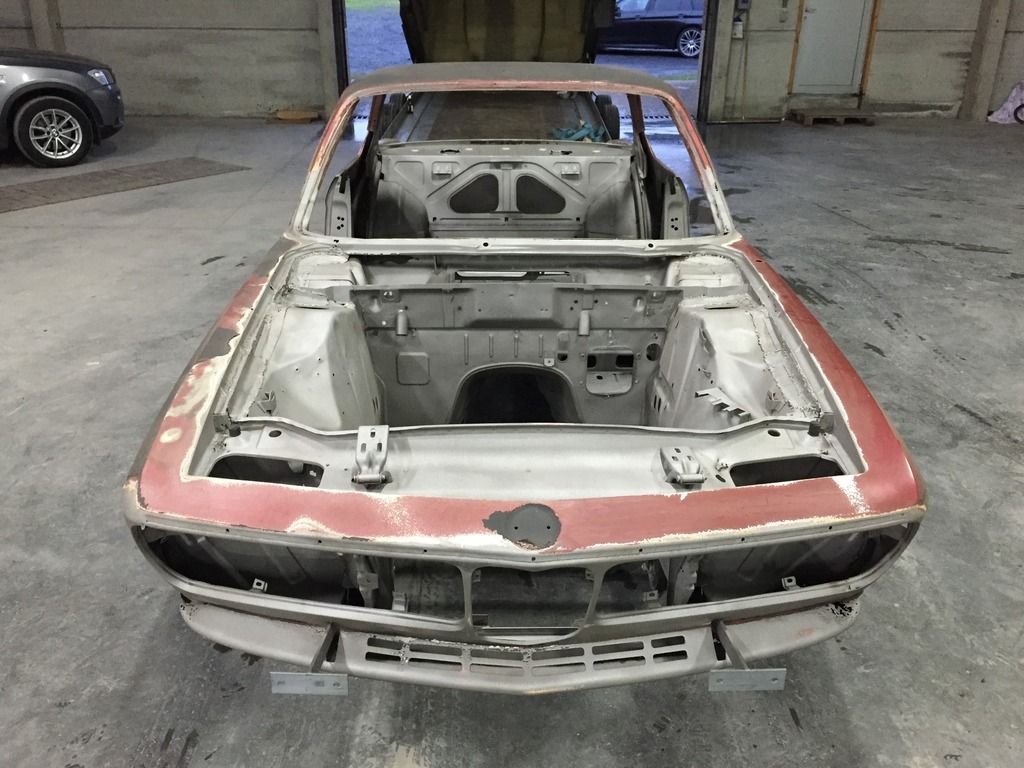

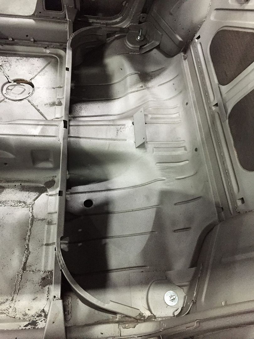

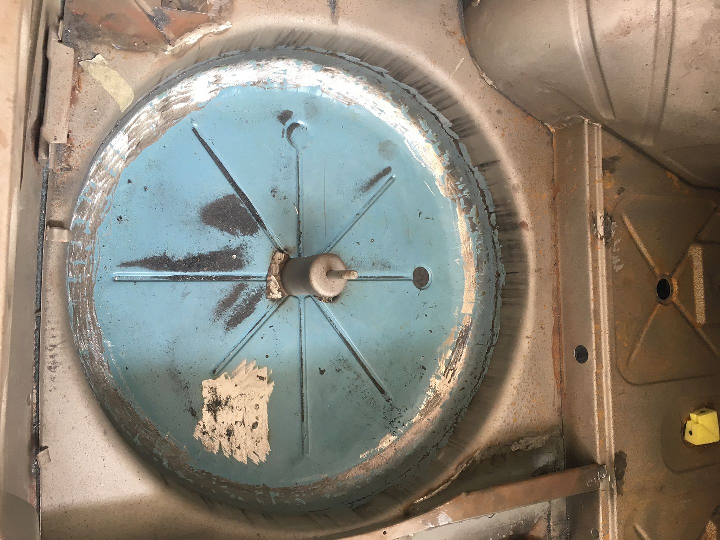

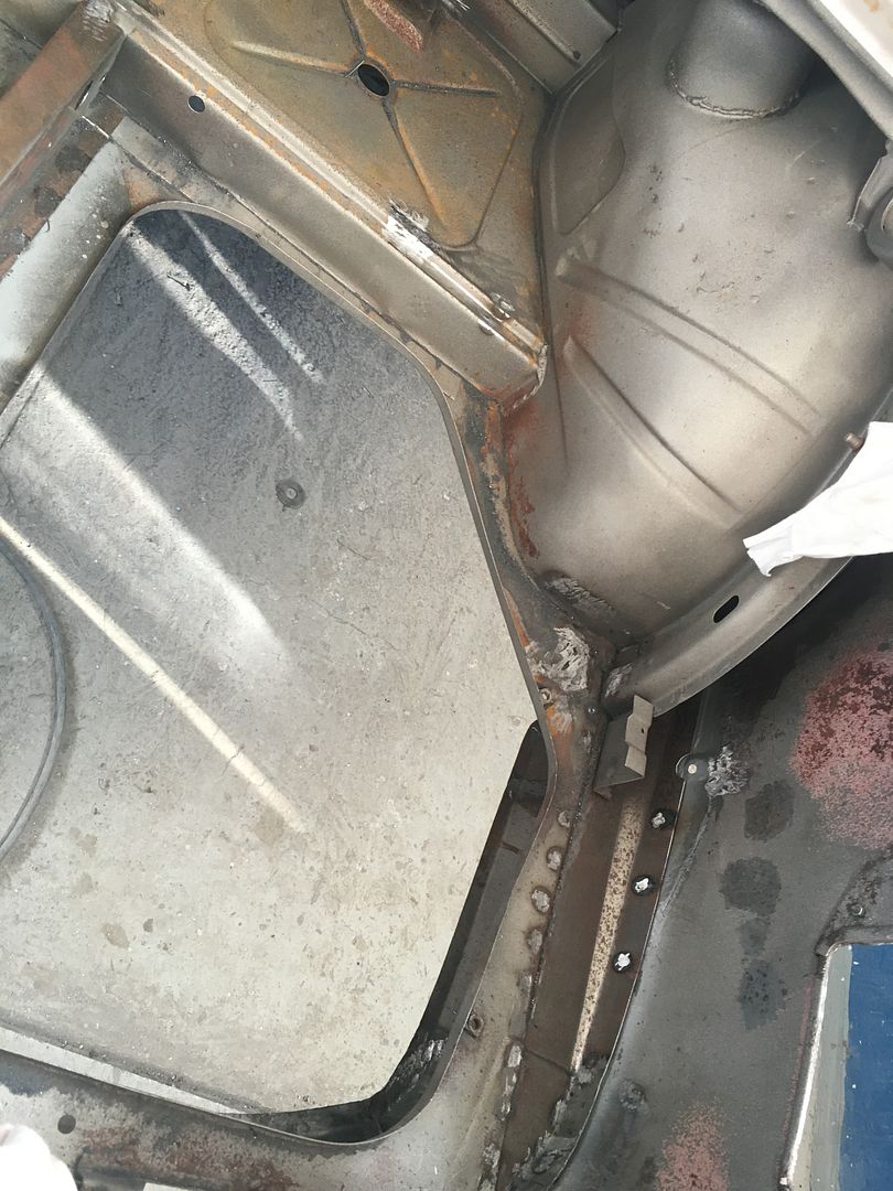

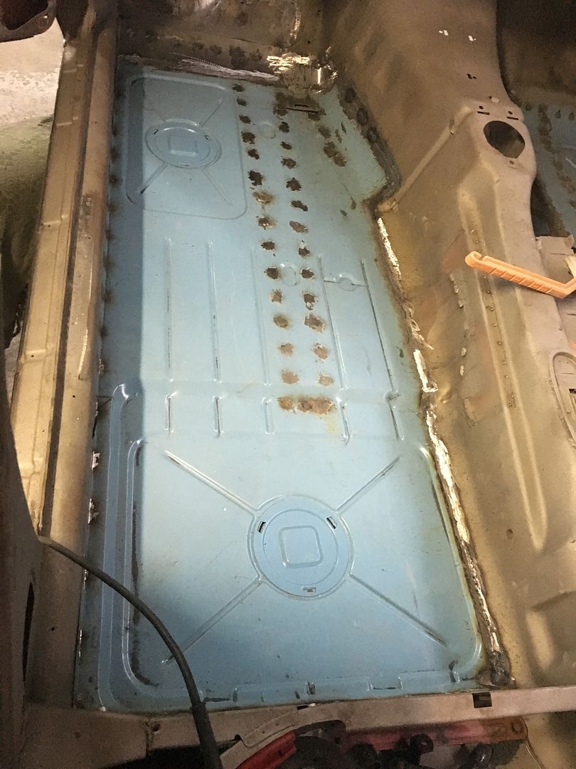

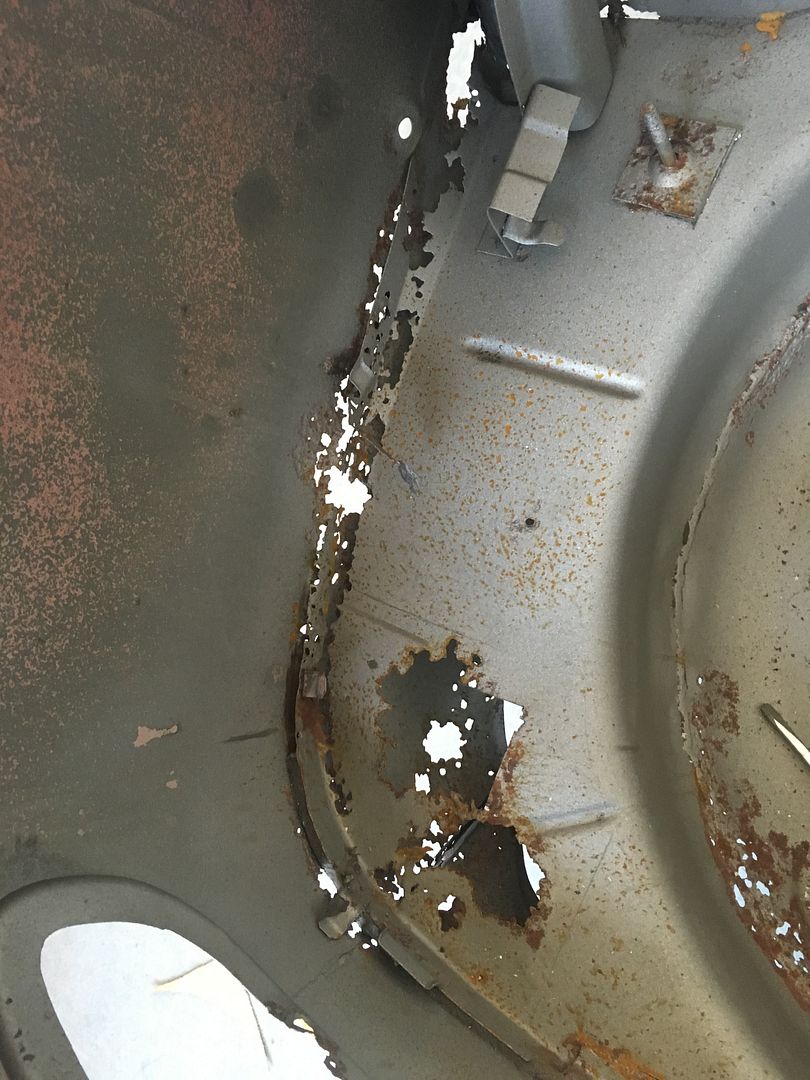

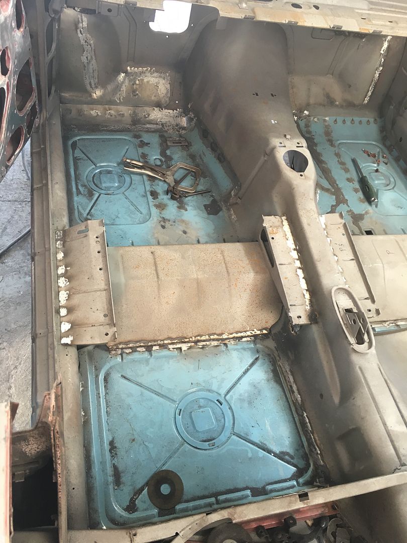

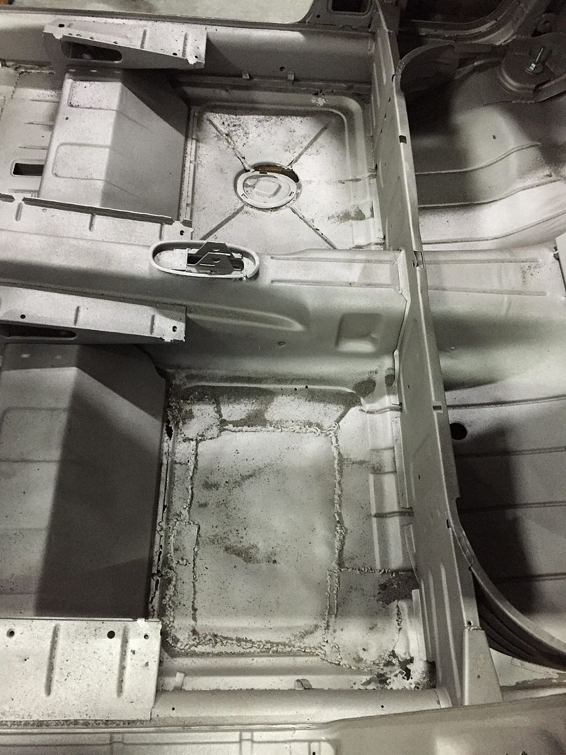

When the car was stripped I took it for sandblasting. Only the bottom and the inside were blasted to protect body panels from deformations.

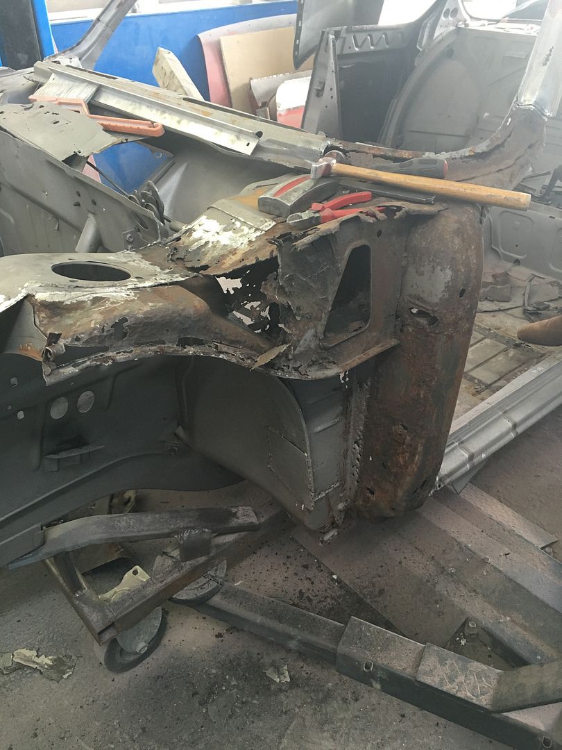

The bodywork was in a pretty bad shape. Worse then I thought...
Seems to be the previous owner did some welding himself. And he probably wasn't the best welding guru at all... I bet it was the first time he had a welding pistol in his hands...
But hey, at least now I know what I am coping with and after all when the bodywork will be finished I know everything will be ok.
I will not have to fear for hidden rust or weak spots anymore.

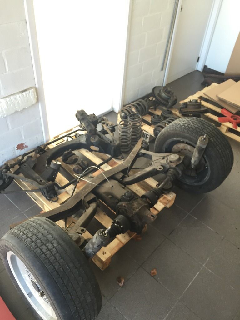

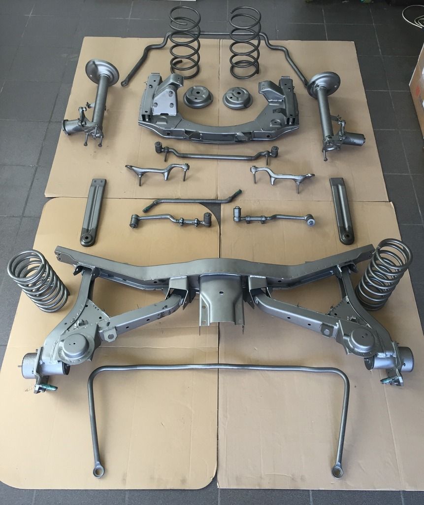

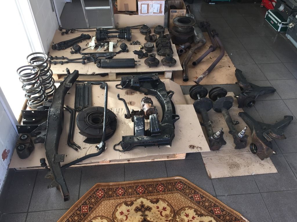

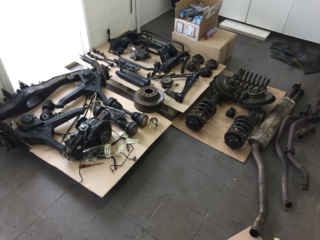

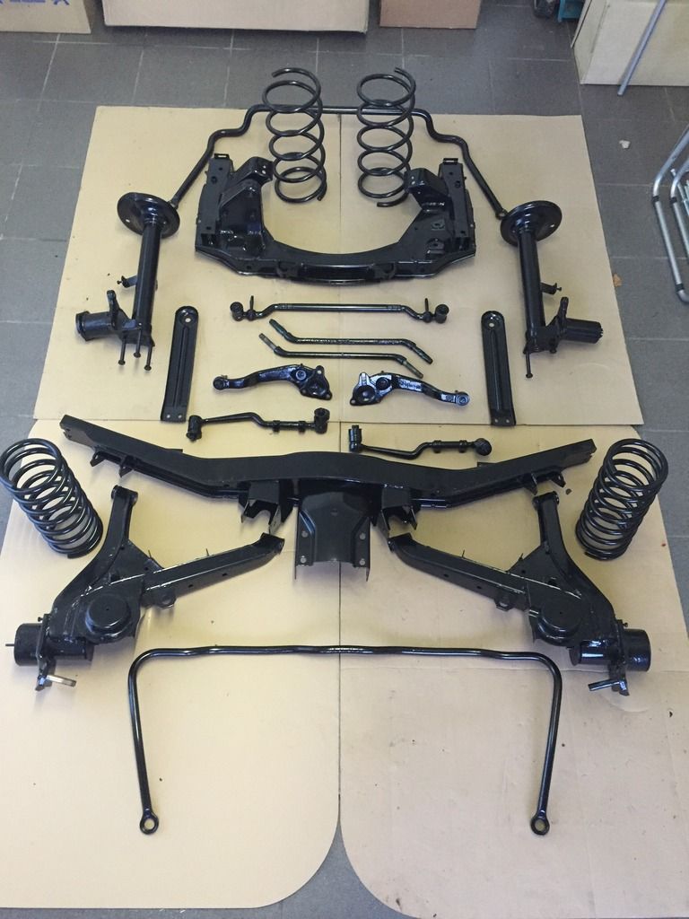

Since the body of the car is at the body shop I started dismantling the front and rear subframe.
It would be nice when the car comes back from the body shop that I can put it back on its wheels.

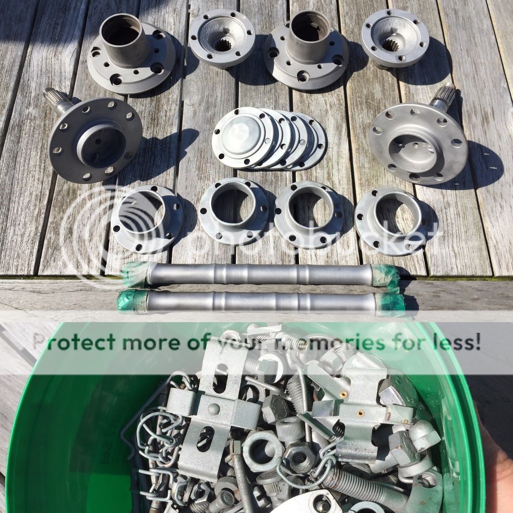

Unbelievable how much tar and dirt all those parts were covered with!

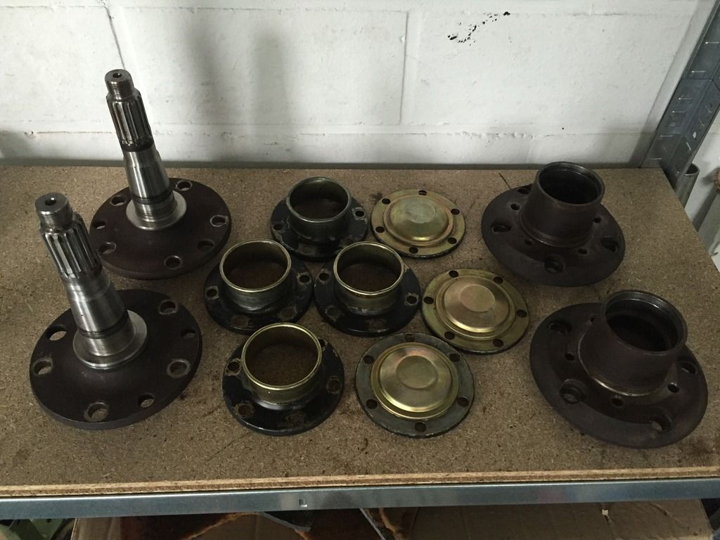

After cleaning up the most of it, it was time to take them for sandblasting.
And if I was happy with the results... Finally some clean parts...

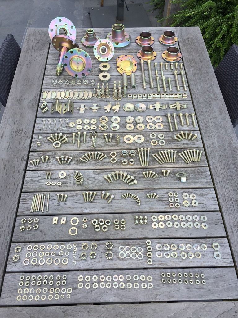

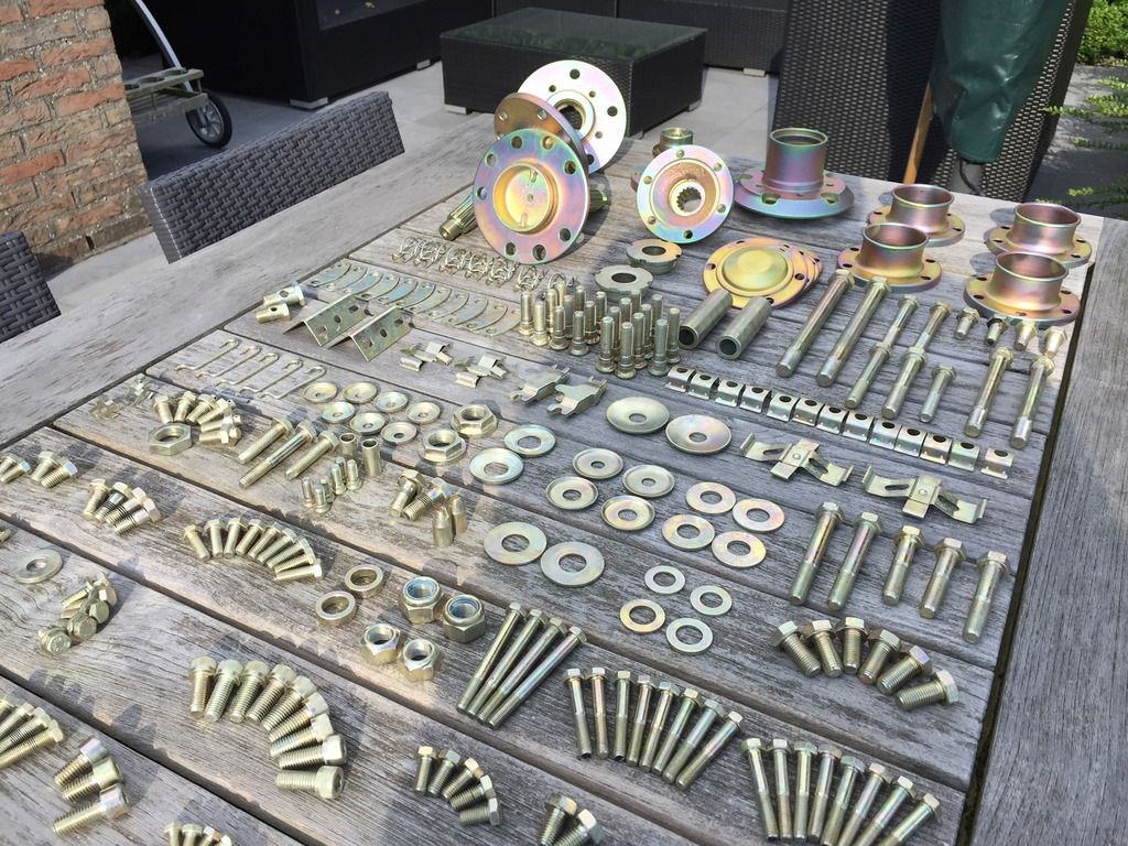

As pretty as they were in bare metal, they had to be powder-coated otherwise they wouldn't last long.

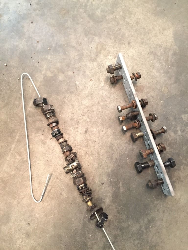

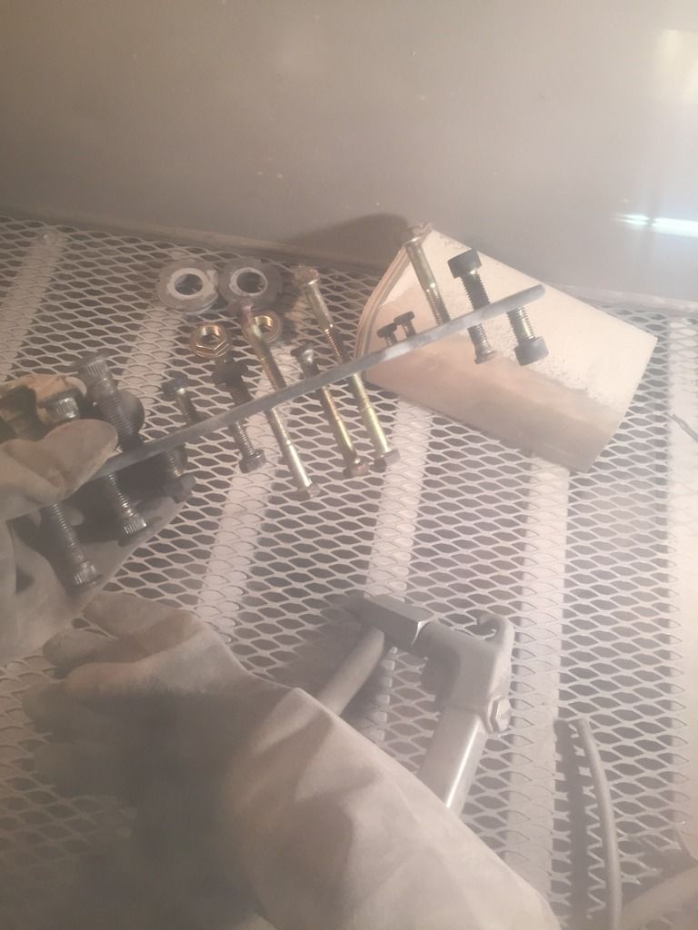

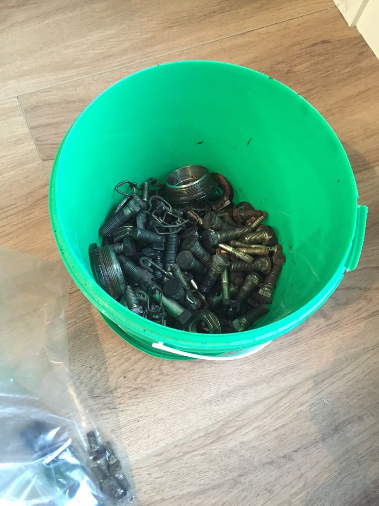

Since I cannot put these parts back together with dirty/rusty bolts and nuts I decided to yellow passivate them.
Sandblasting to make sure all dirt and rust is gone
Results

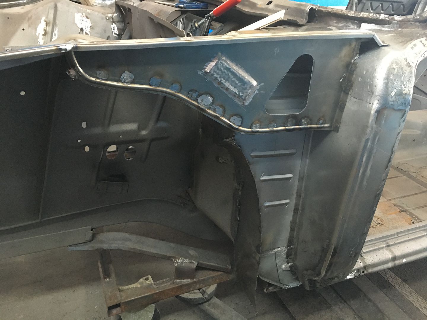

Are you planning to remove the front fenders. probably the only way to really see what the condition of the A pillars is.
Looks fantastic! As Philippe asked, are you going to remove the front fenders? I debated for quite some time with myself whether to remove or not when I had my shell in the same stage, everything looked decent from what I could tell when they were still on but removing them was a very good decision.

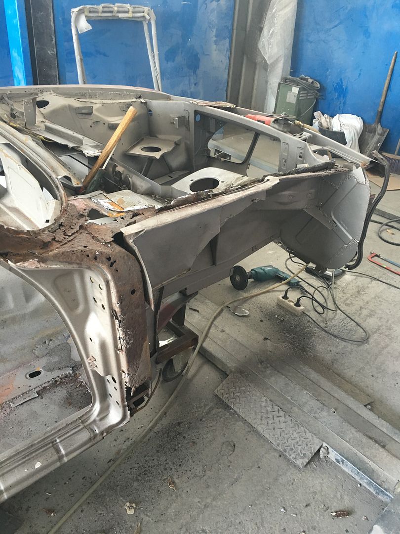

Front fenders were removed and the A pillars are already rebuilt where necessary, same for the rockers.
Let's hope everything finishes well... Can't wait myself to see the final result of the bodywork.

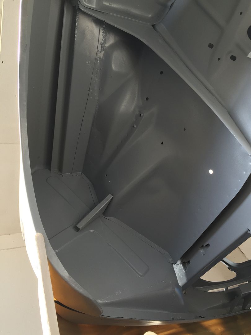

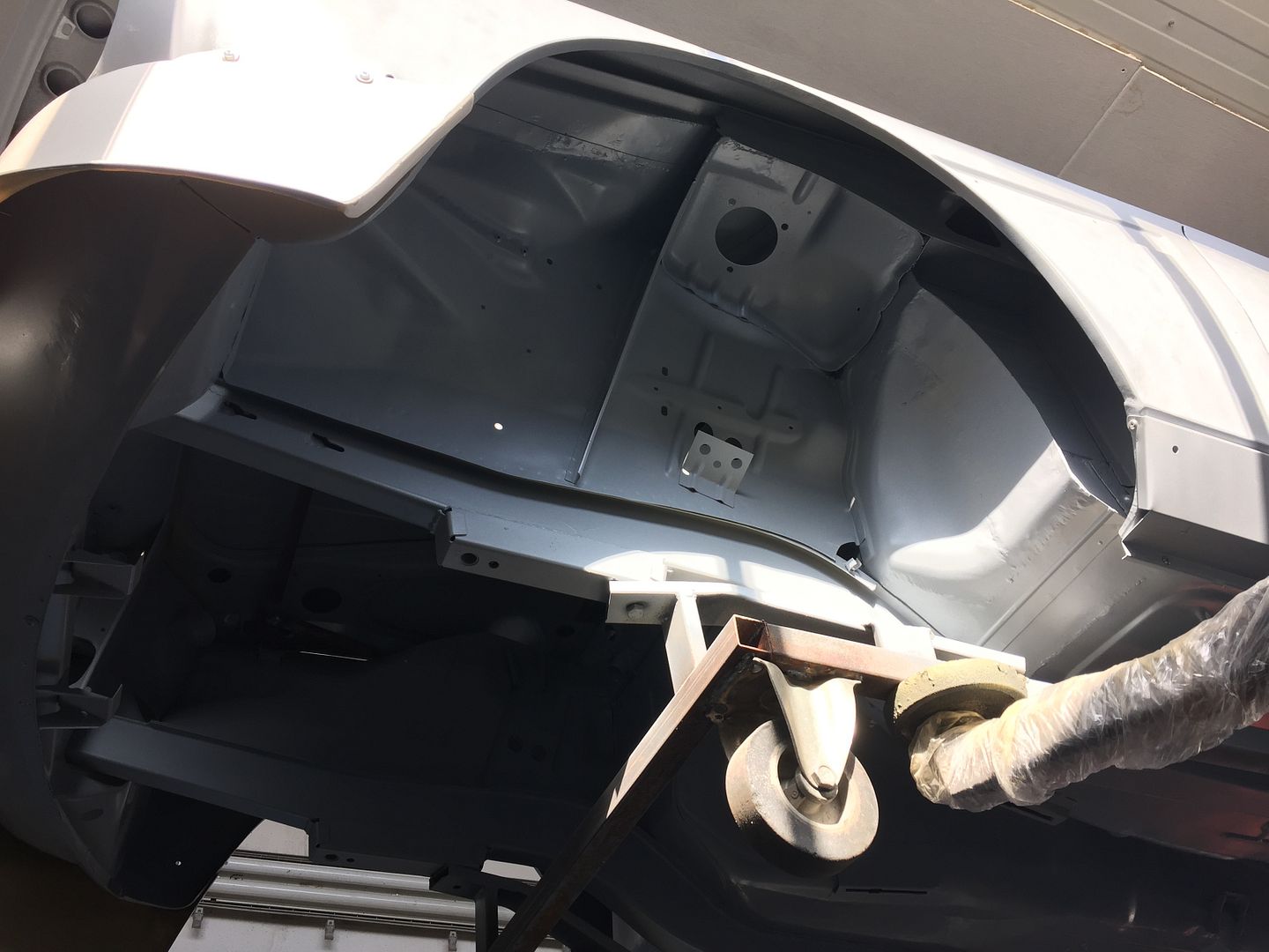

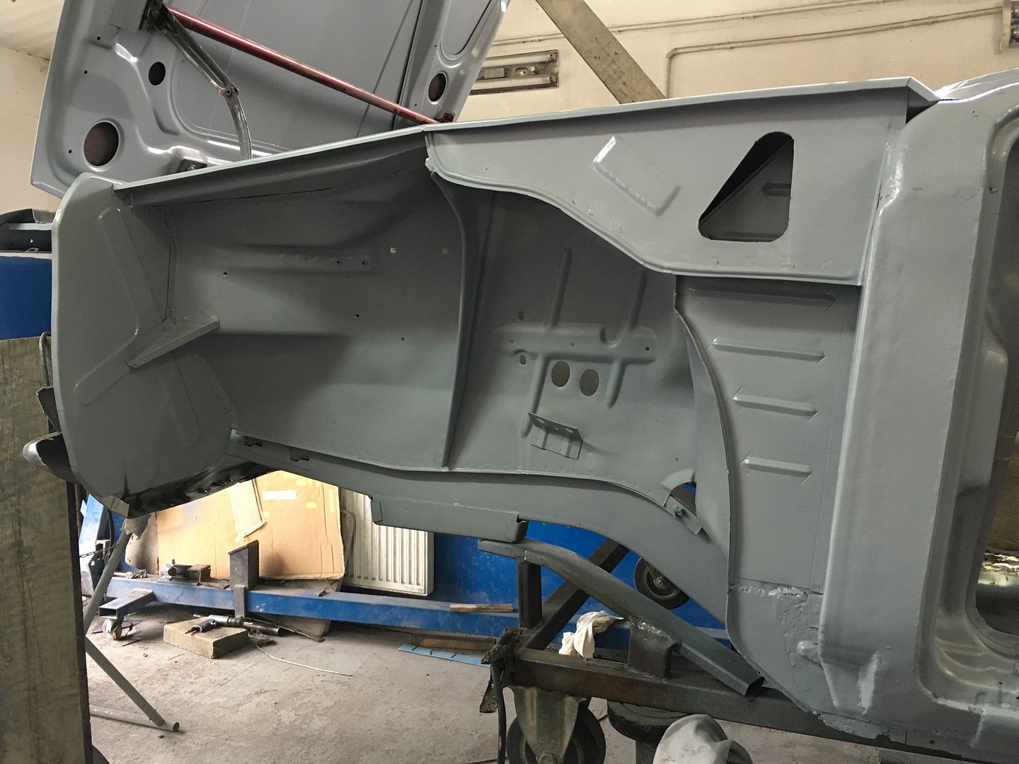

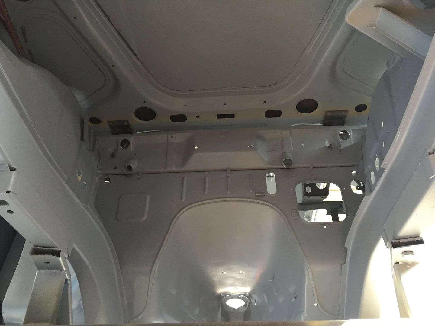

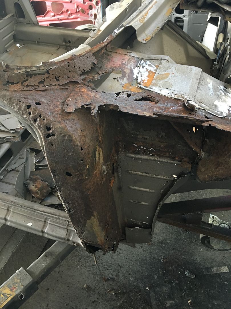

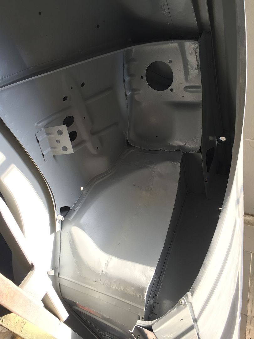

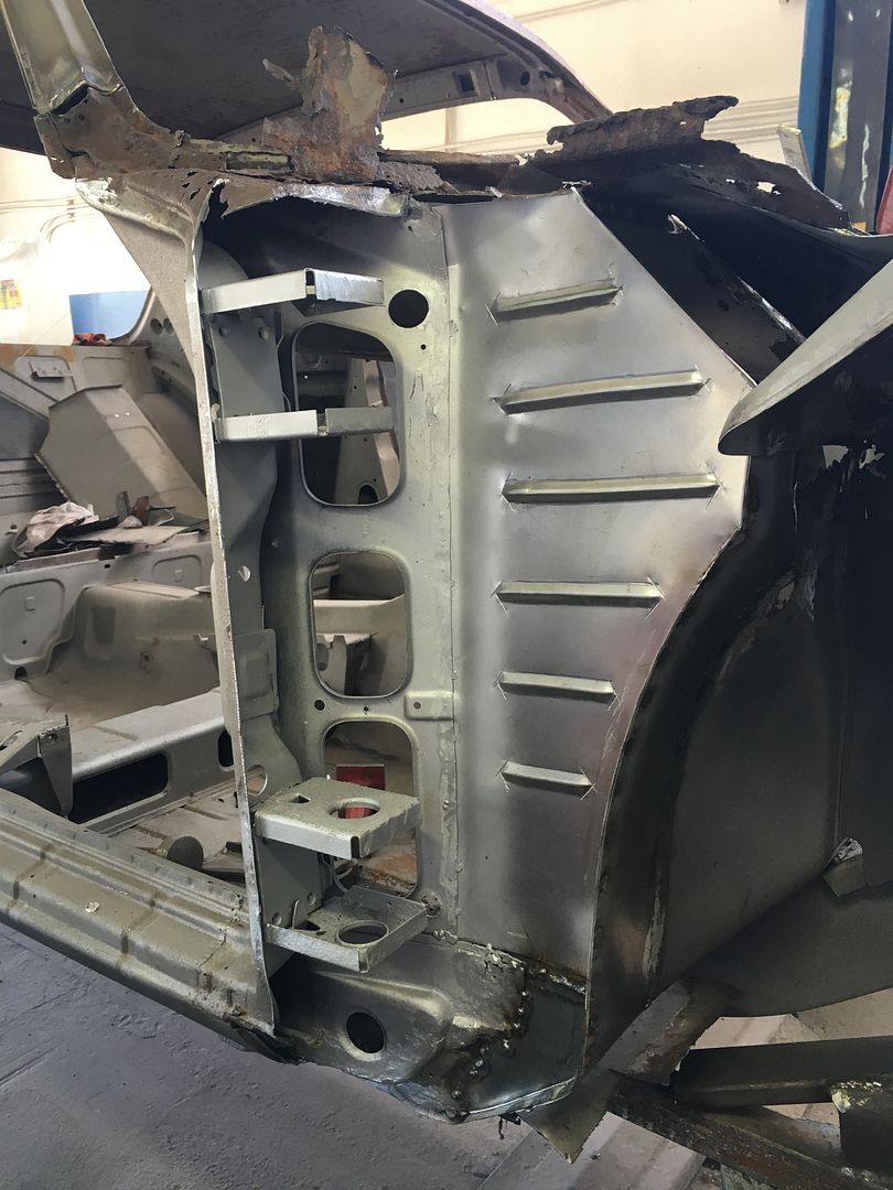

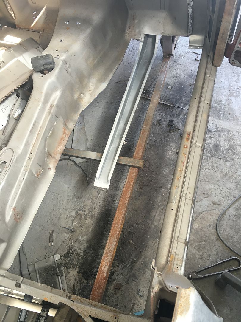

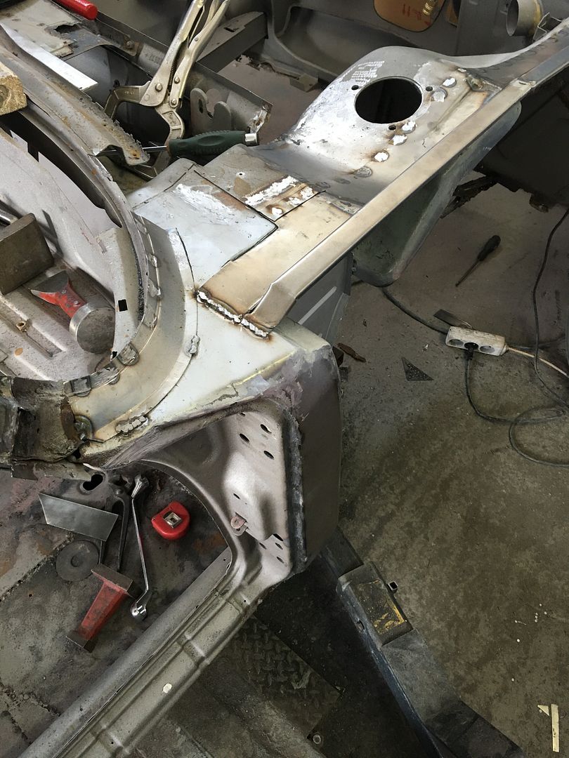

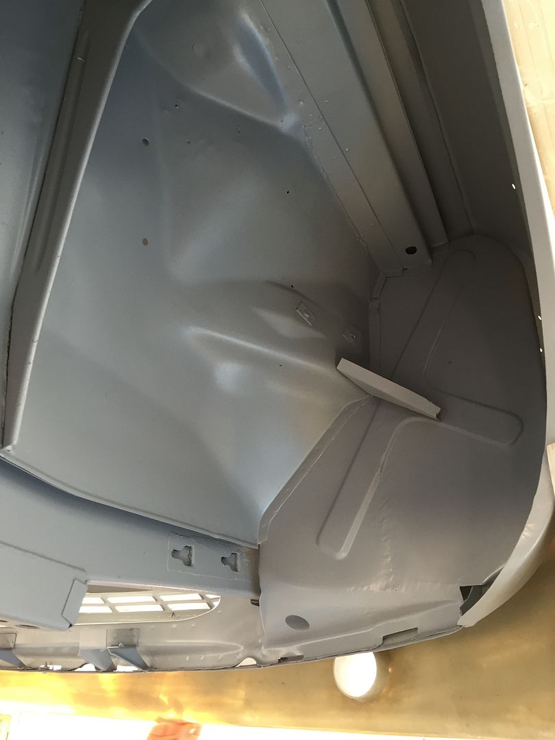

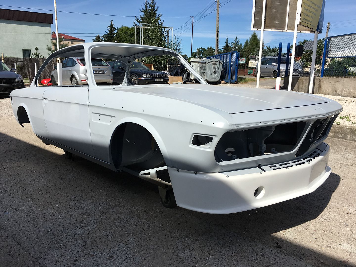

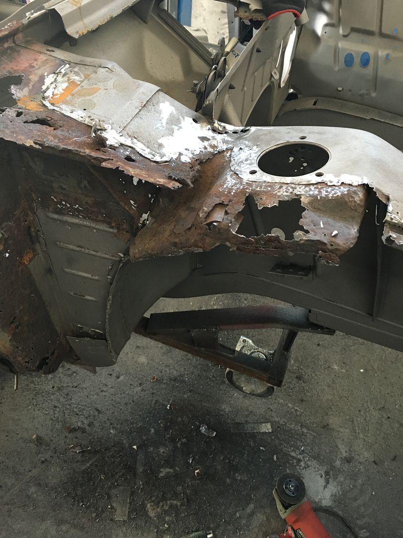

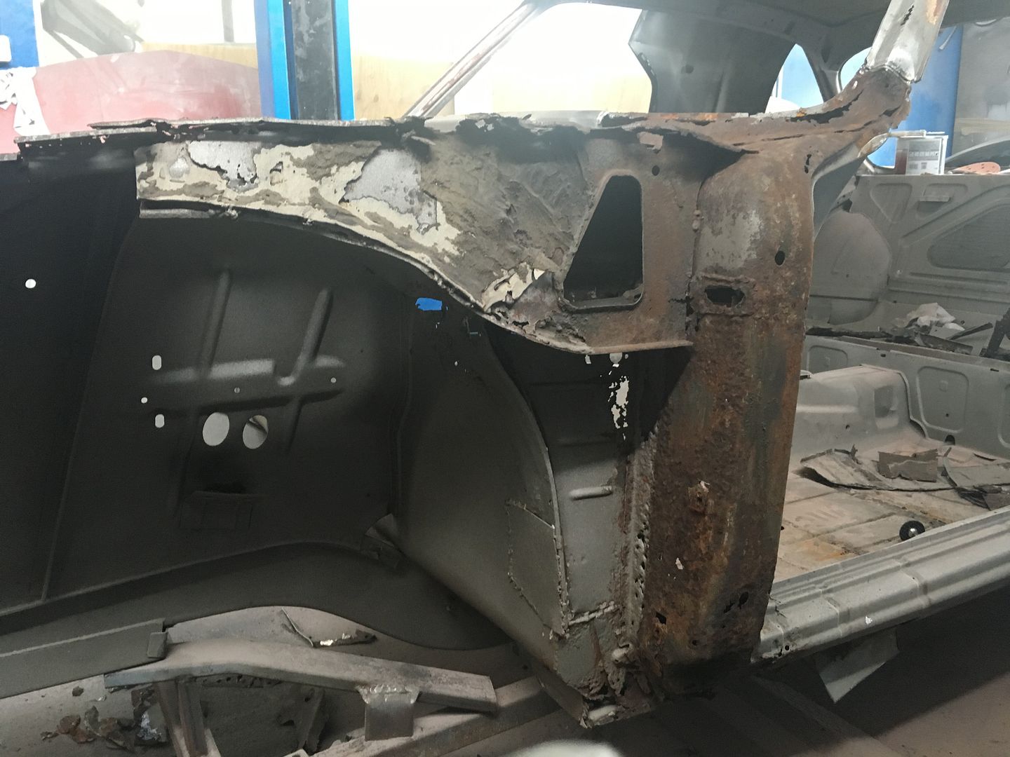

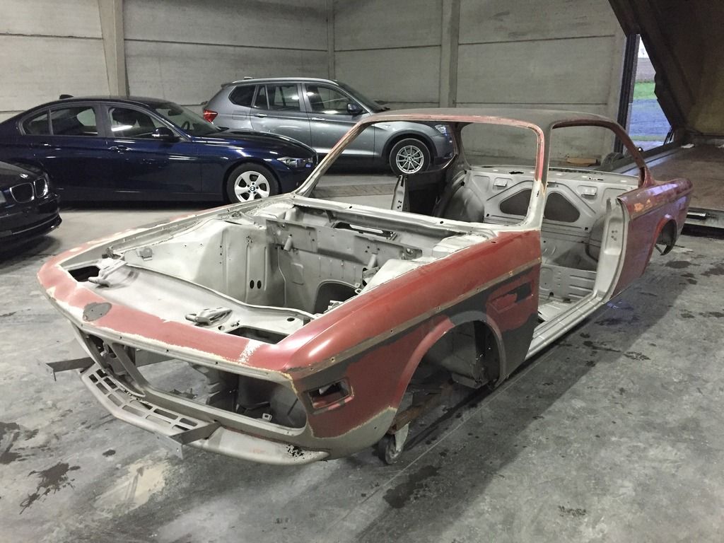

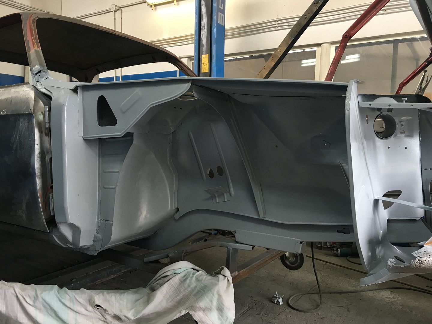

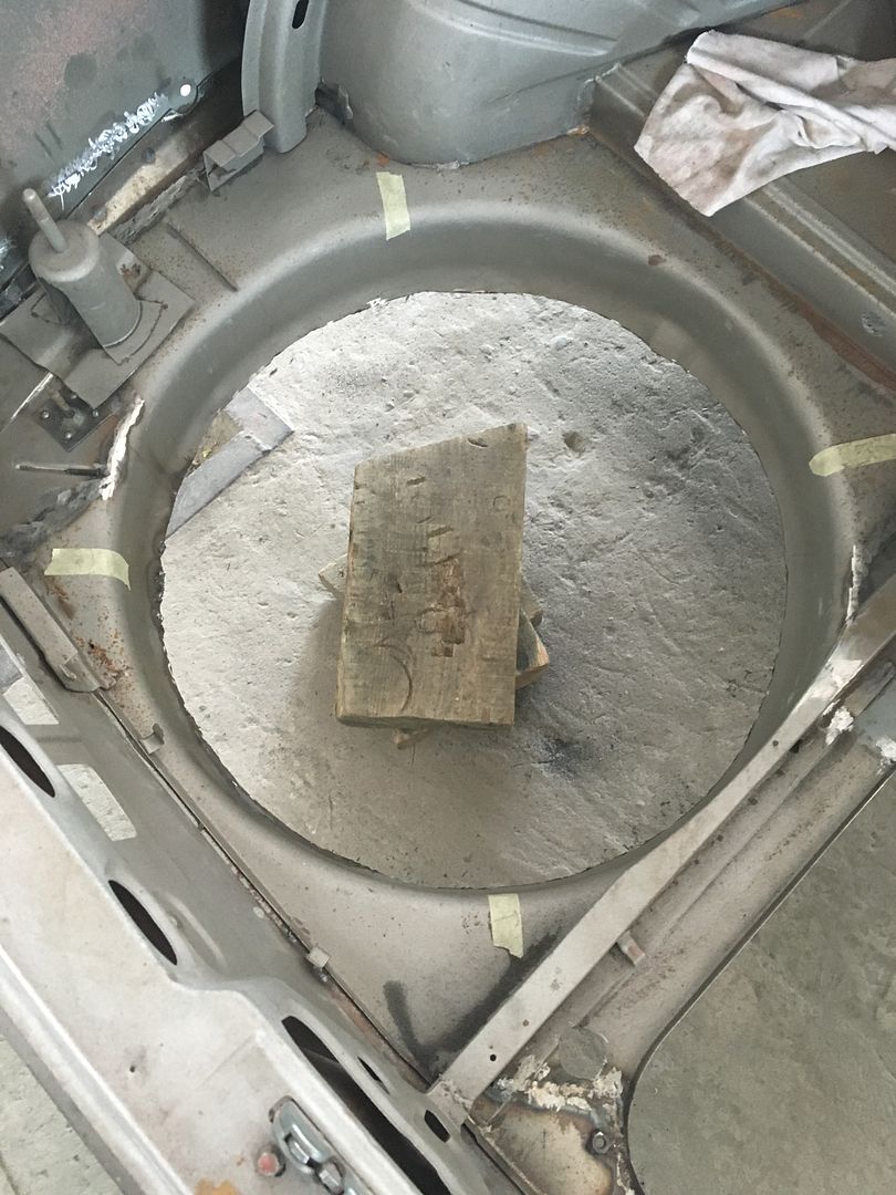

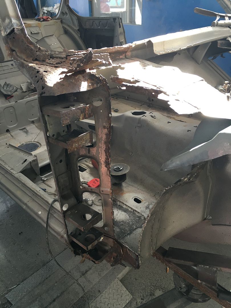

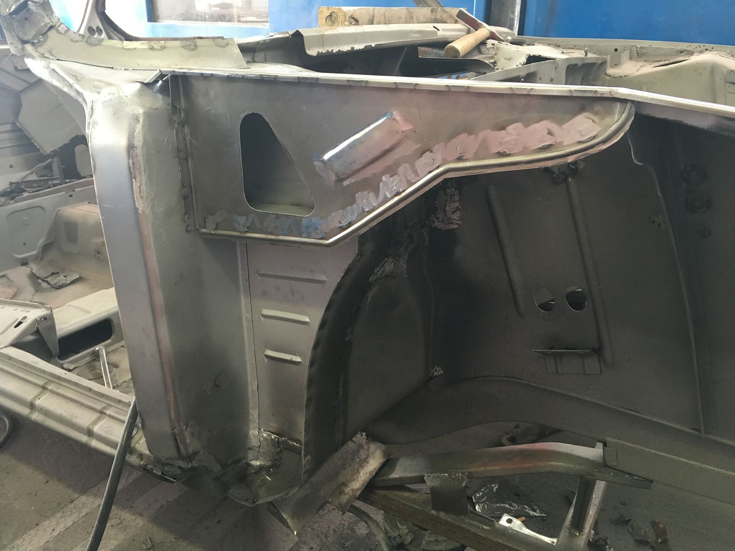

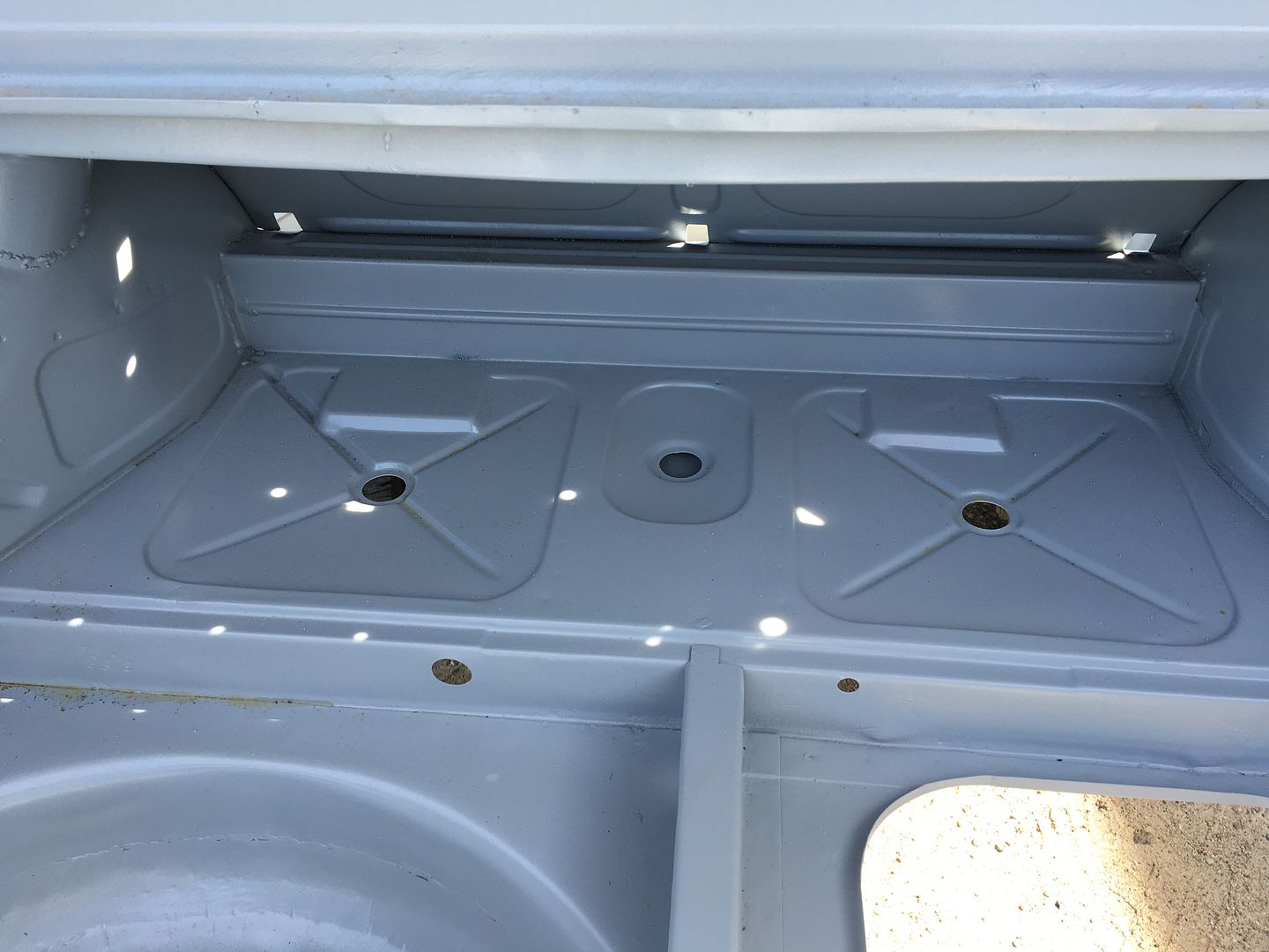

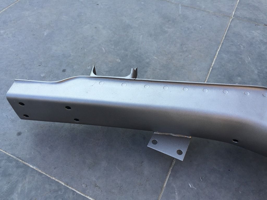

Some time has past and a lot of work has been done. Time for an update me think... :)
I have to say I was quite afraid to show the condition of the car at first. But since I've seen the outcome of the bodywork, I'm actually proud of saving another E9 coupe.
The people of the body-shop did an amazing job on this one in my opinion.
Pictures speak louder than words...

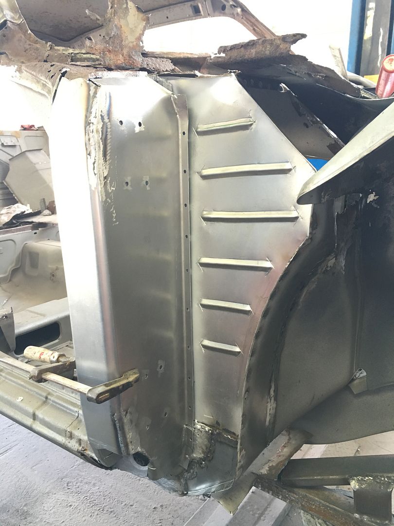

Let start with the A pillars (or what was left of them)...
Right Side:
Left Side:

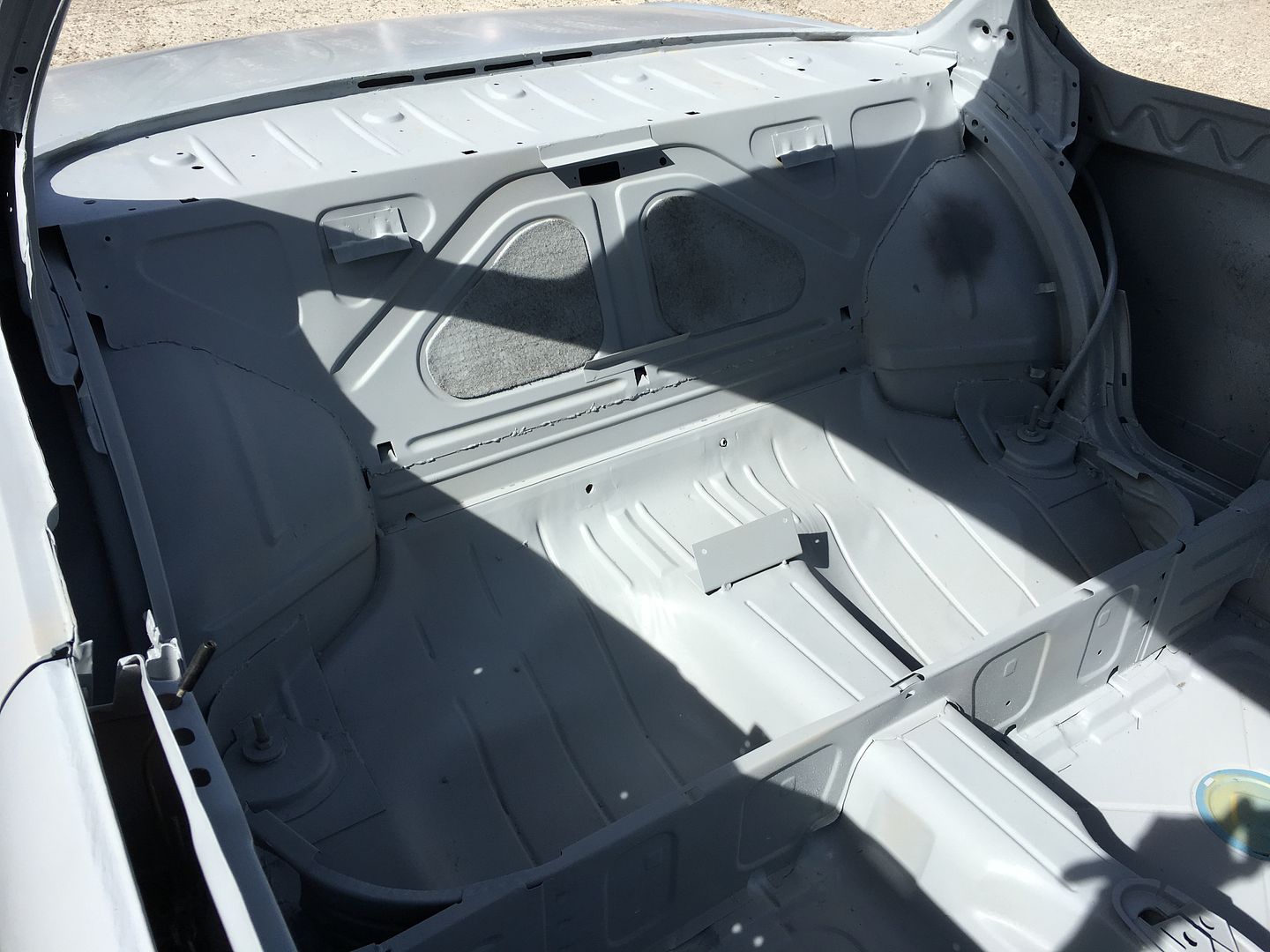

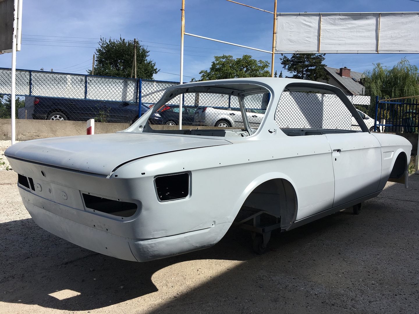

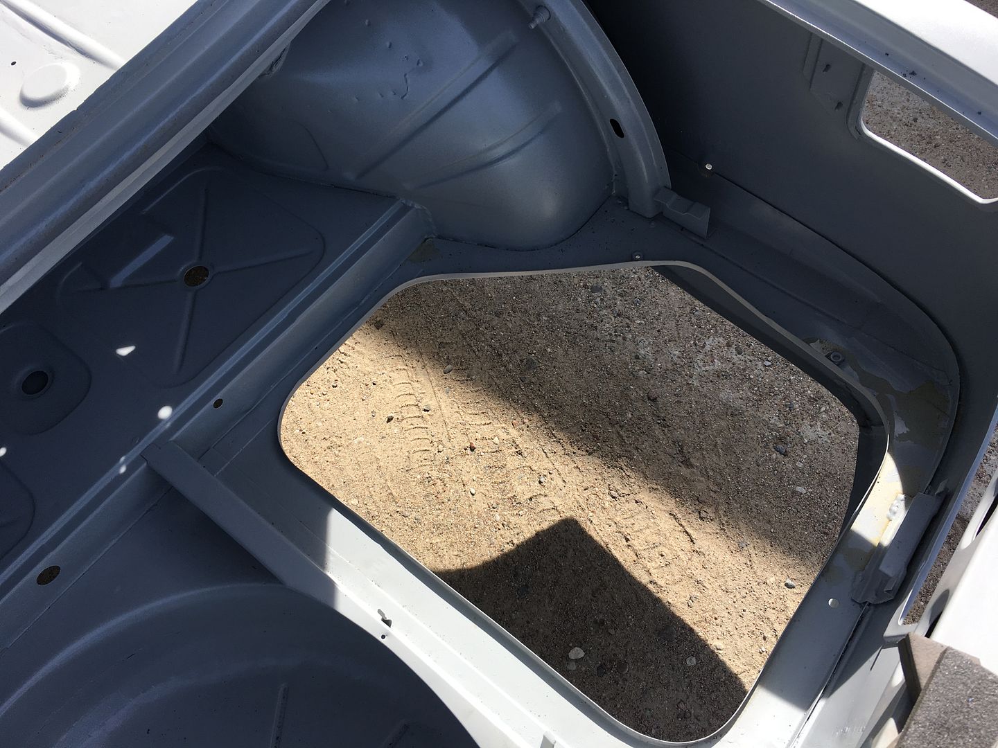

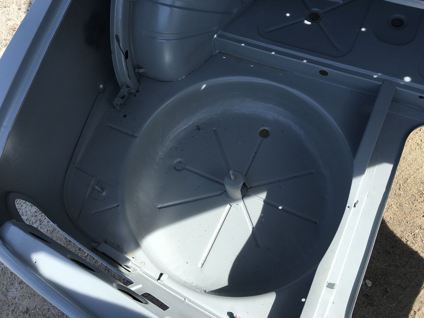

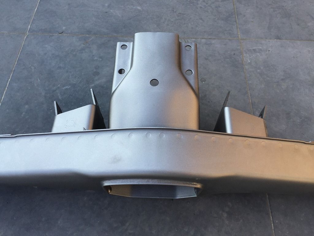

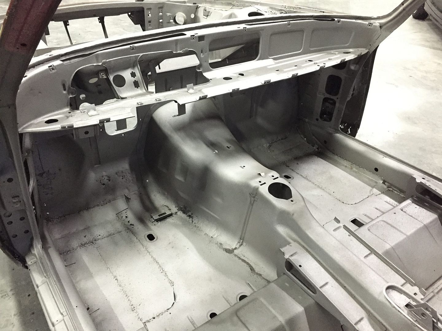

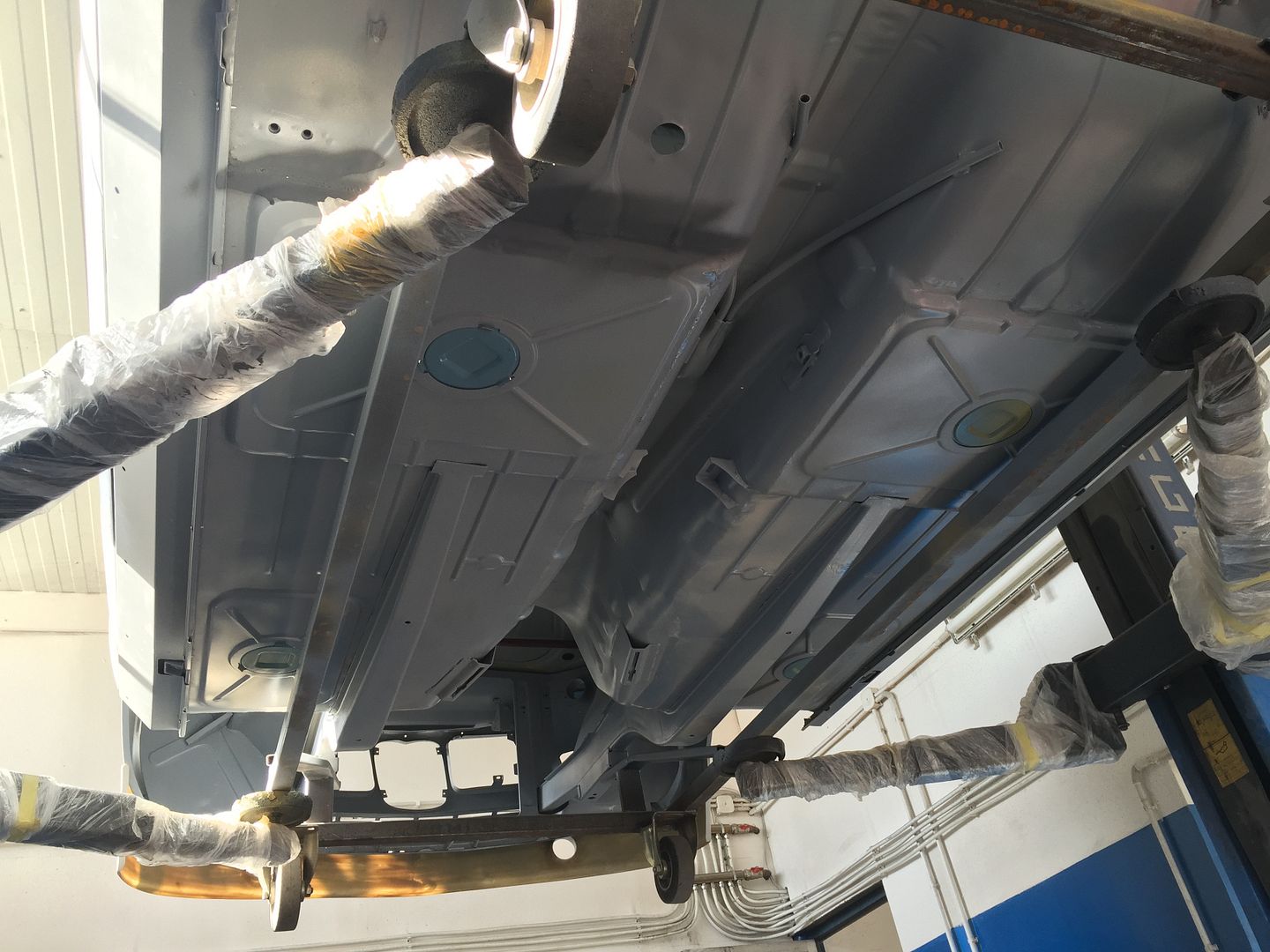

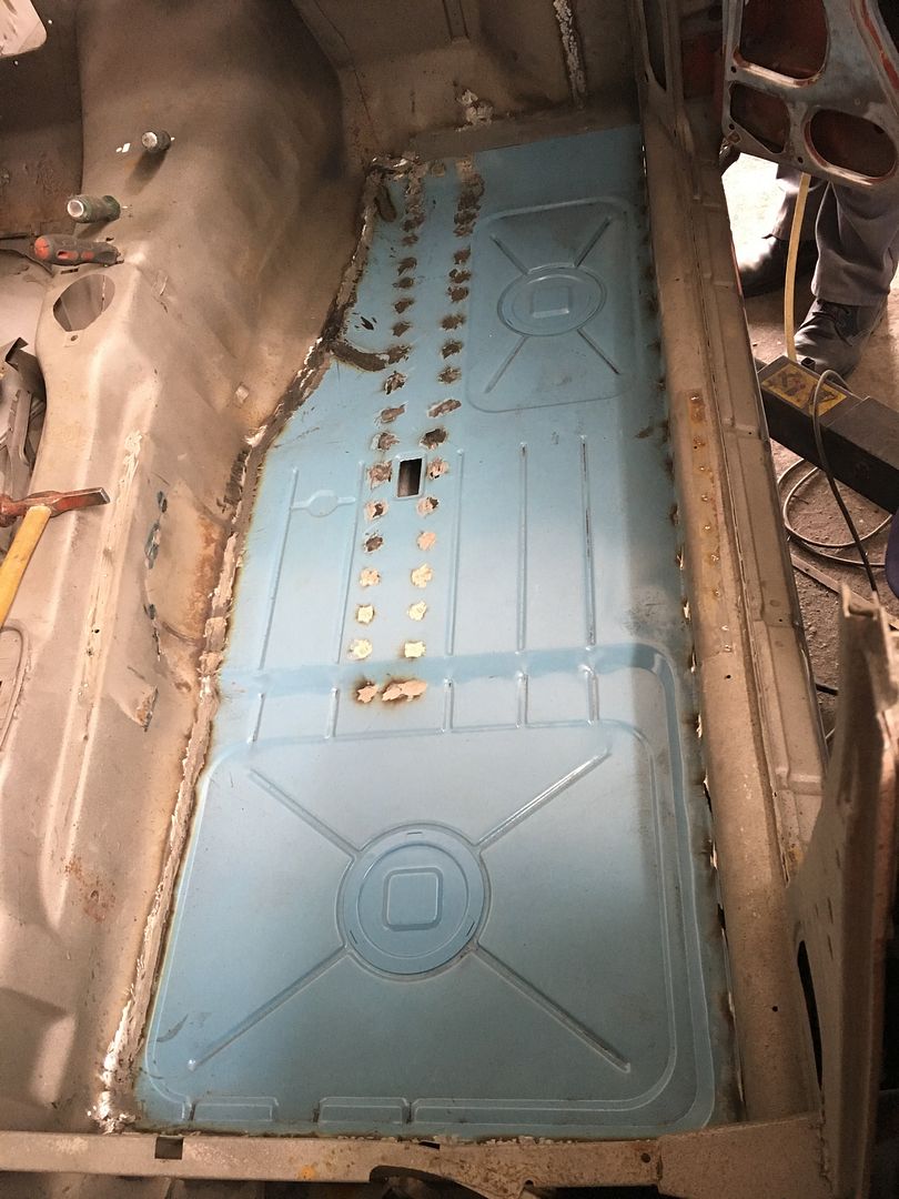

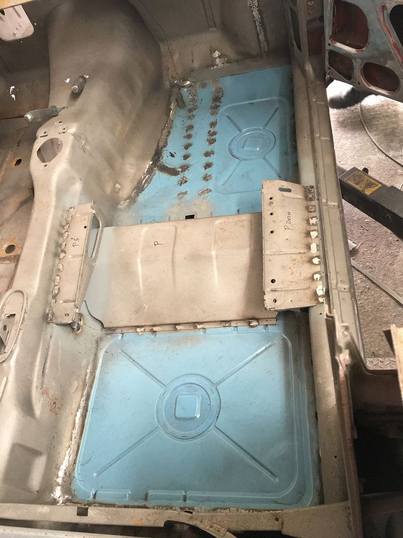

Since I still have a ton of pictures and I am getting tired of uploading, I will just upload the latest ones where the car is almost ready for painting... :)
Some lovely metal work there, looking great.
Can I ask where you bought the full length floor pans?
