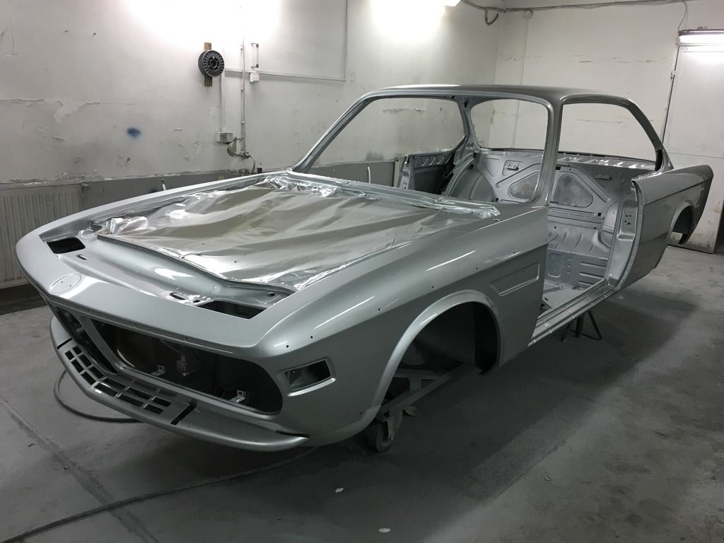

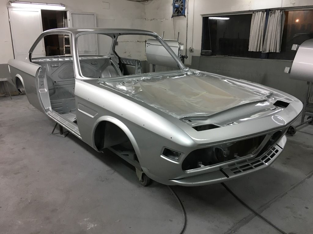

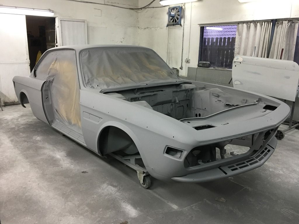

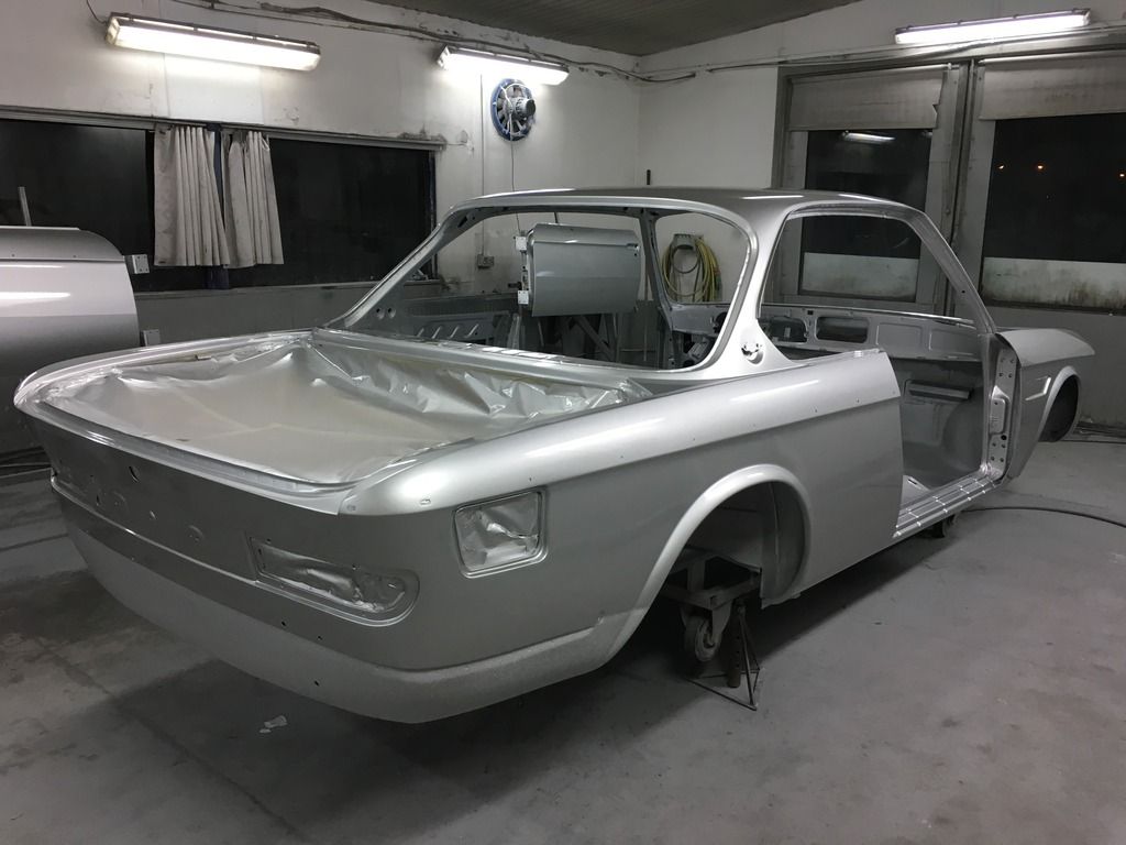

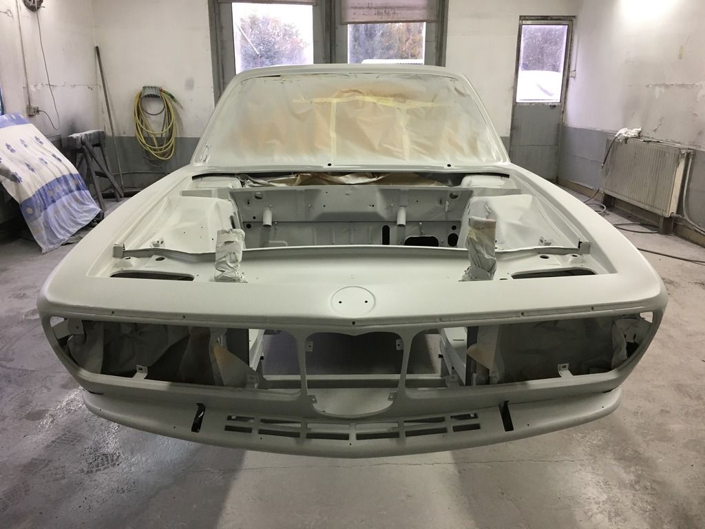

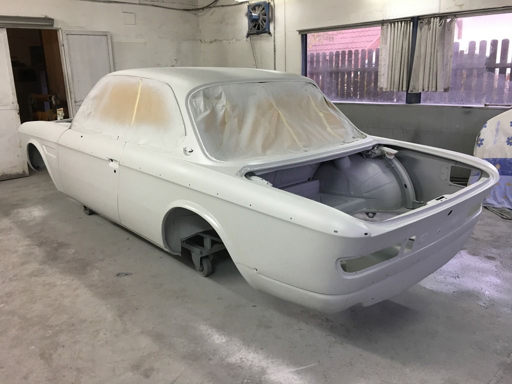

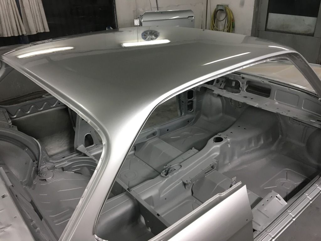

Almost time for painting!
Found some time to upload some more pictures.
I have to say that I am very satisfied with the bodywork and the results so far.
That looks awesome! Proficiat!
When I see all of these coupes being completely rebuilt and restored I start to wonder at which point we will achieve equilibrium: As many e9s being reborn as being officially considered dead.

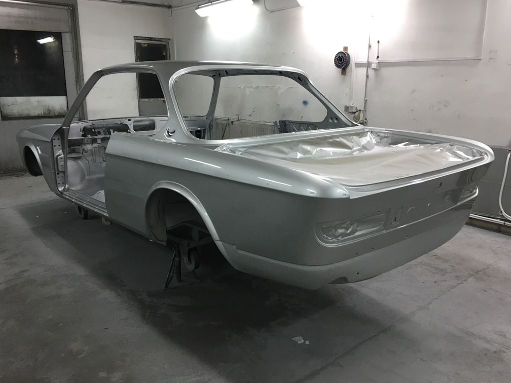

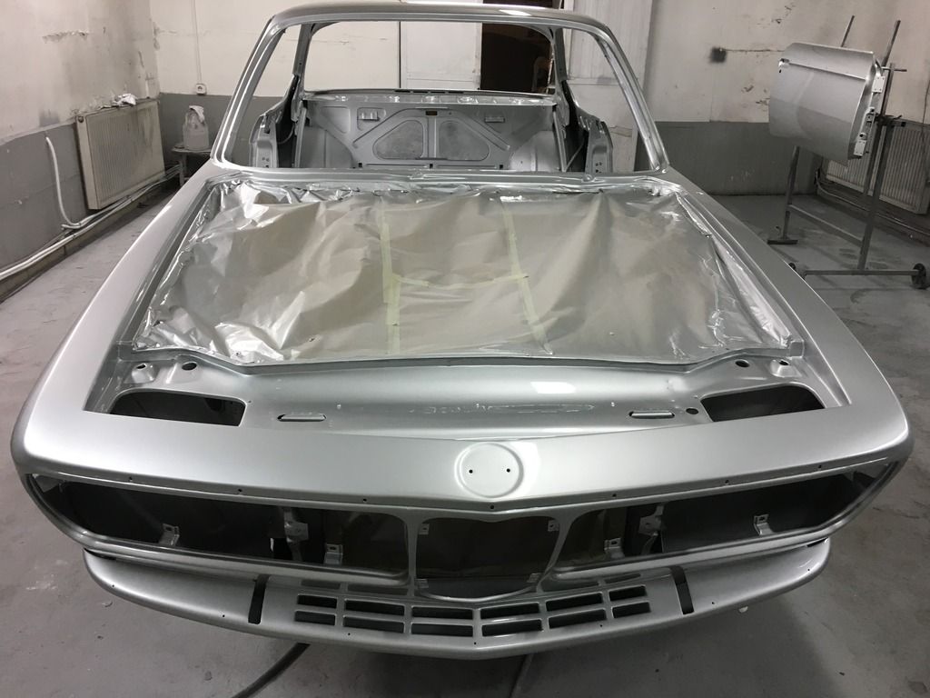

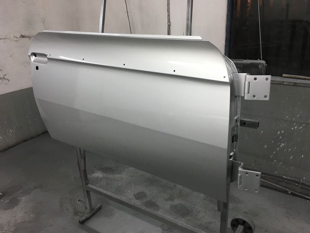

Damn that looks good! Is that an exact Polaris paint? On the photos it looks a little more silvery/ metal flakey, but that could be the lighting.

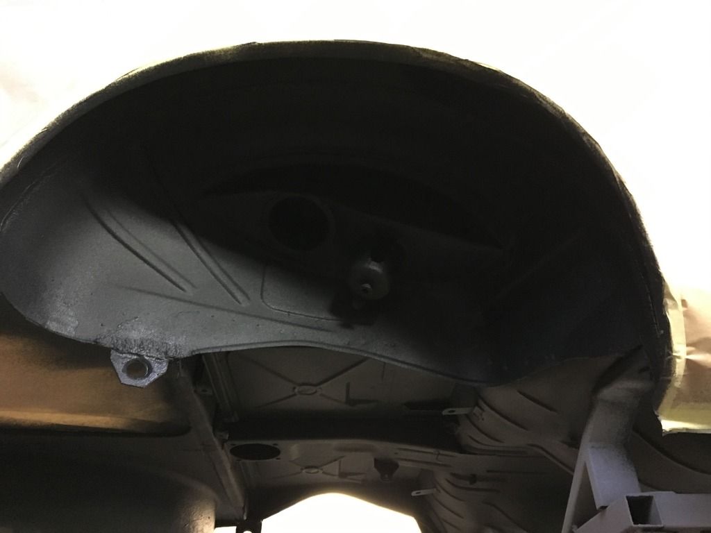

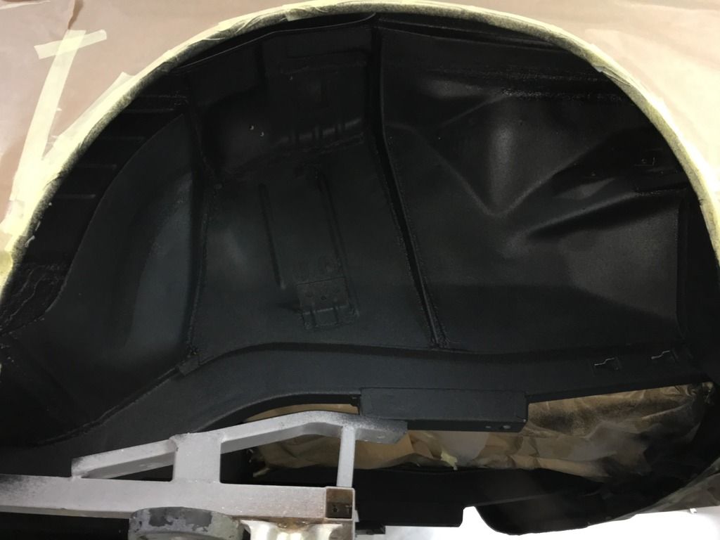

What is going on in the are under the rear bumper? Is that a different color or optical illusion? Grey stone guard?
Congratulations!
Congratulations!
Thanks!

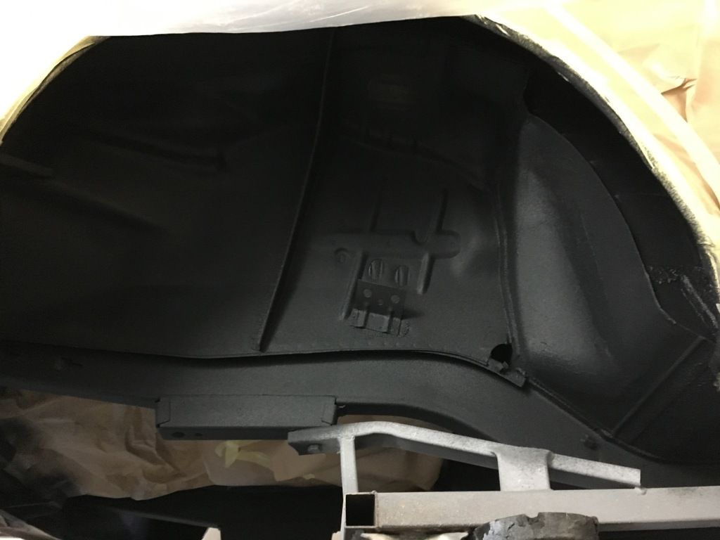

Bottom of the front and rear were first painted with stone guard, this gives another texture.
Afterwards the whole car was painted in the 060 Polaris silver color, the original BMW color.

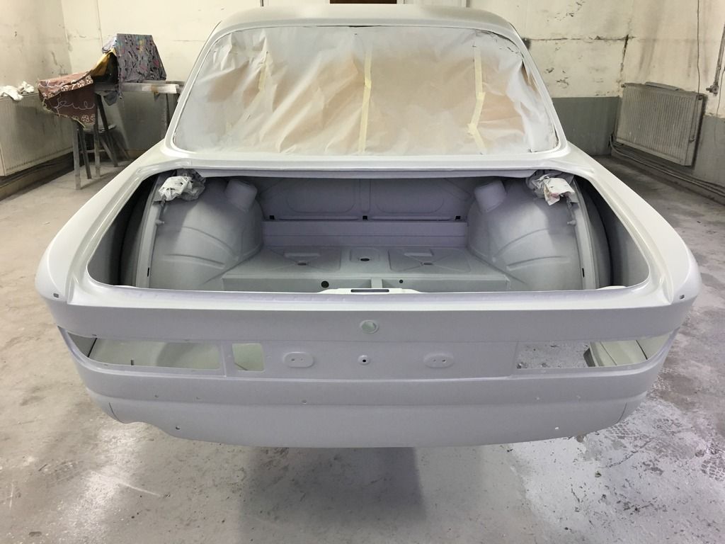

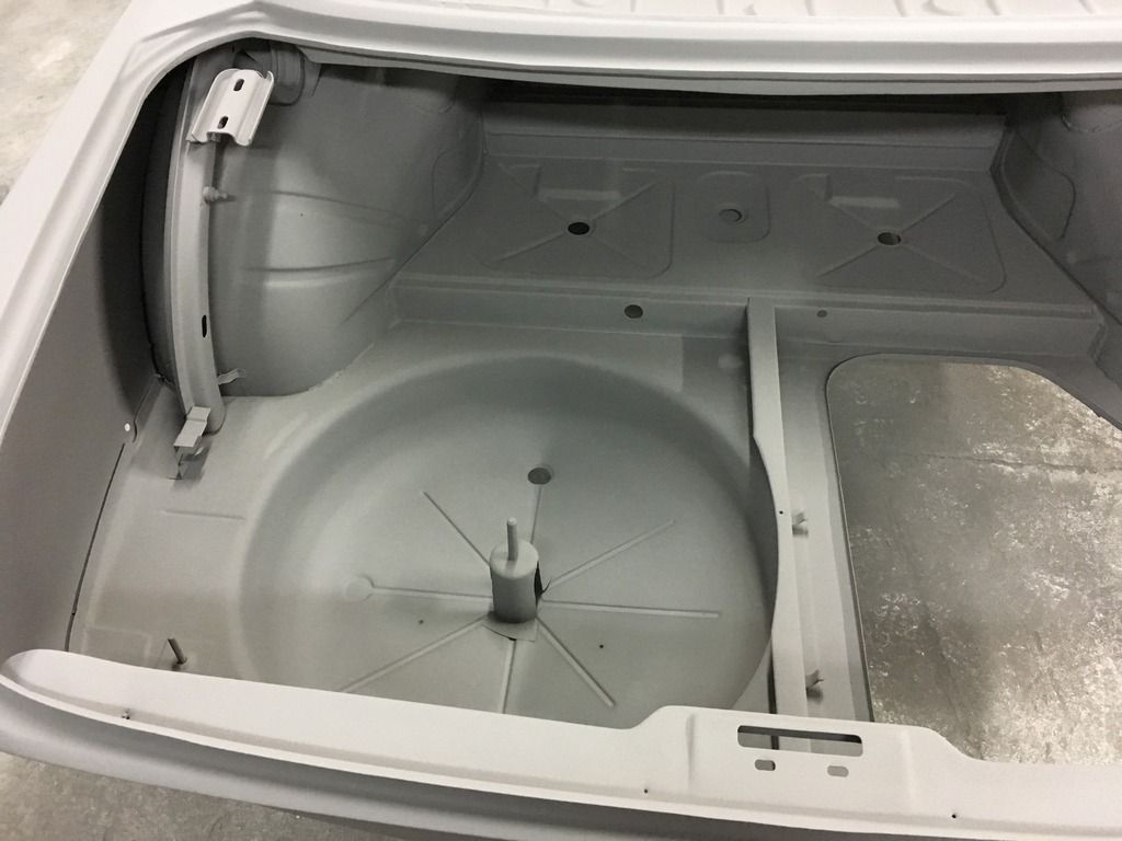

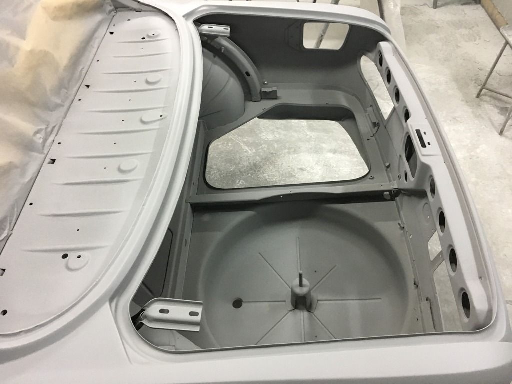

wonder why everone doesnt add the inside rear fender brace?

@aearch; what do you mean with the "wonder why everone doesnt add the inside rear fender brace?"
I'm doing my body work (already the past 3 years....) and want to know my options.

I think what Alan is referring to as the rear fender brace is, it's a strengthening 'brace' on each side, between the inner fender wall and the wheel house, in the trunk. I believe it's on all 74/75's. Take a look at Alan's resto pics and you'll notice them right away on each side (in the trunk). They are part of the updated design and are definitely an improvement structurally.
A great idea/ improvement whilst doing a resto, before the paint job though :)
I also first noticed them in Alan's pics. Mine is a 73.
Keshav
Keshav
Are you sure they are on "all" 74/75s ? As this example shows, it does not seem to be. Wonder if it was only a US thing in conjunction with the 5mph bumpers?
Only US coupes got the large triangular bracing from the wheelarch rearward for the big bumpers. You wouldn't want to add it as now you can't find wheelarch covers for the 74.

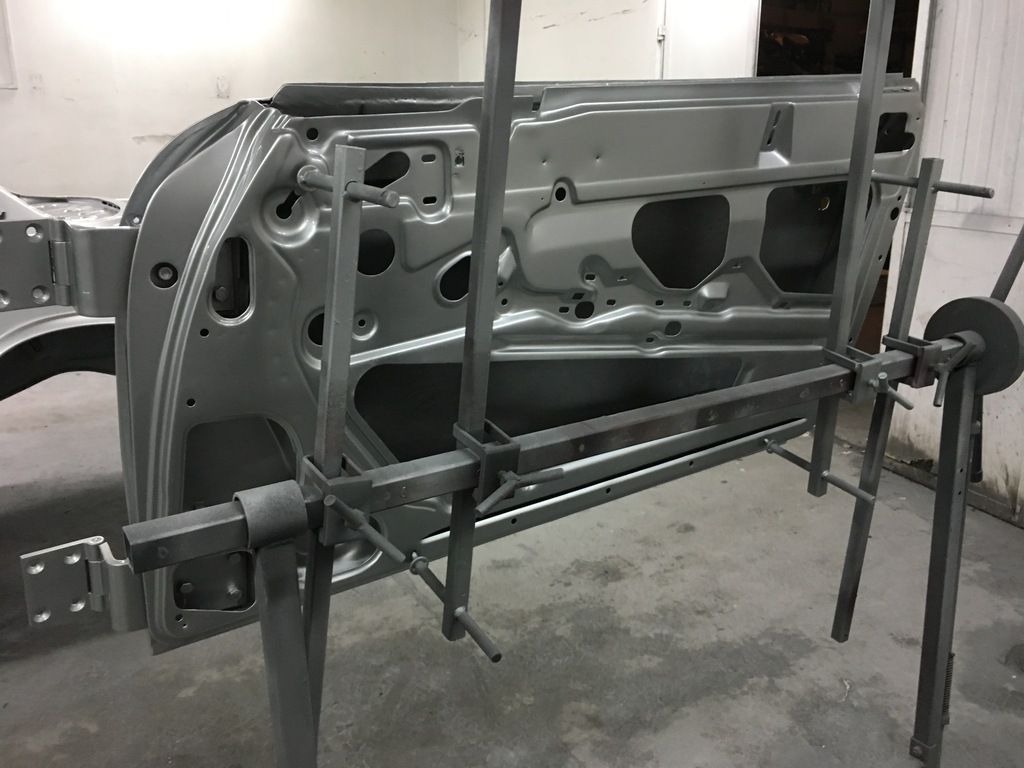

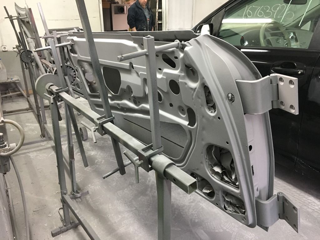

Revision of the subframes etc...
