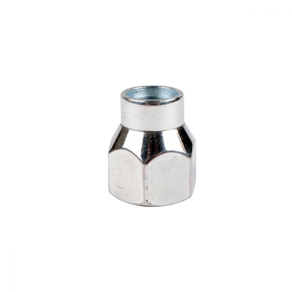

It isn’t something that you usually need to concern yourself with. Mahle’s just have a super thick mounting boss. The Mahles that I had couldn’t be mounted safely without longer studs. You can buy lug nuts with threads that extend past the mounting surface.
I had a set. They work well but aren’t a substitute for longer studs.

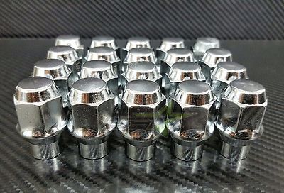

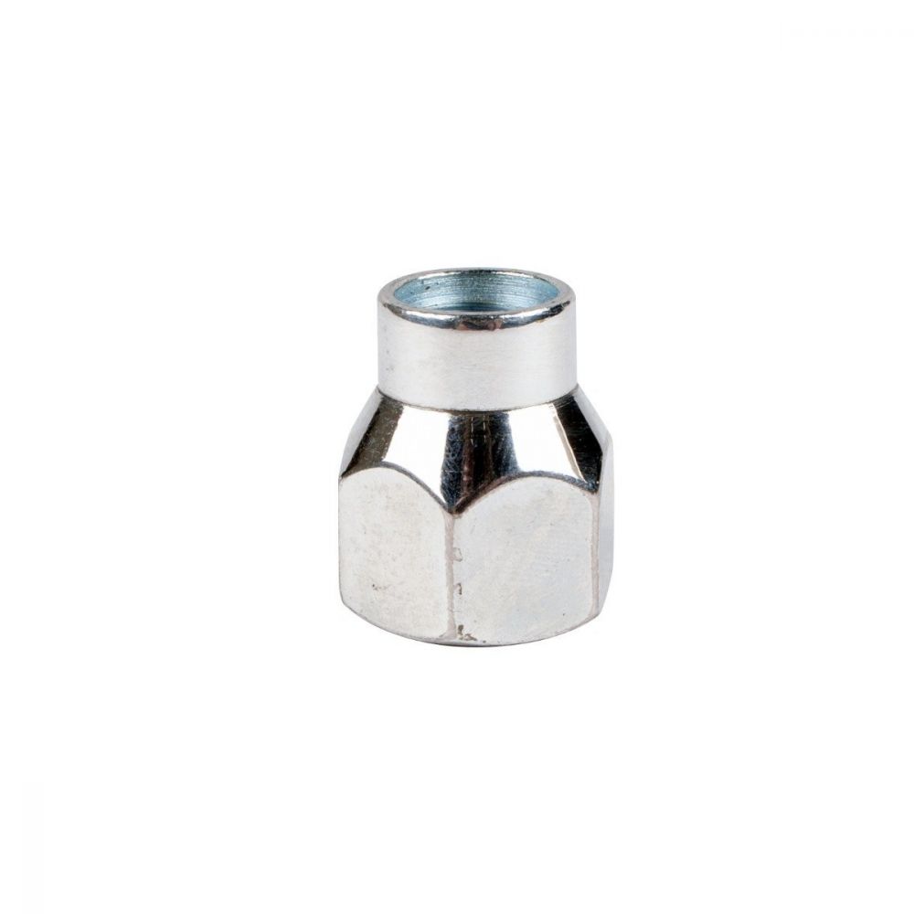

Example:
Example:
Thanks Markos, do you remember where you bought the long lugs? I think I may have found them...or something similar from Dorman #711-312
I got mine on ebay. These are the ones I purchased:

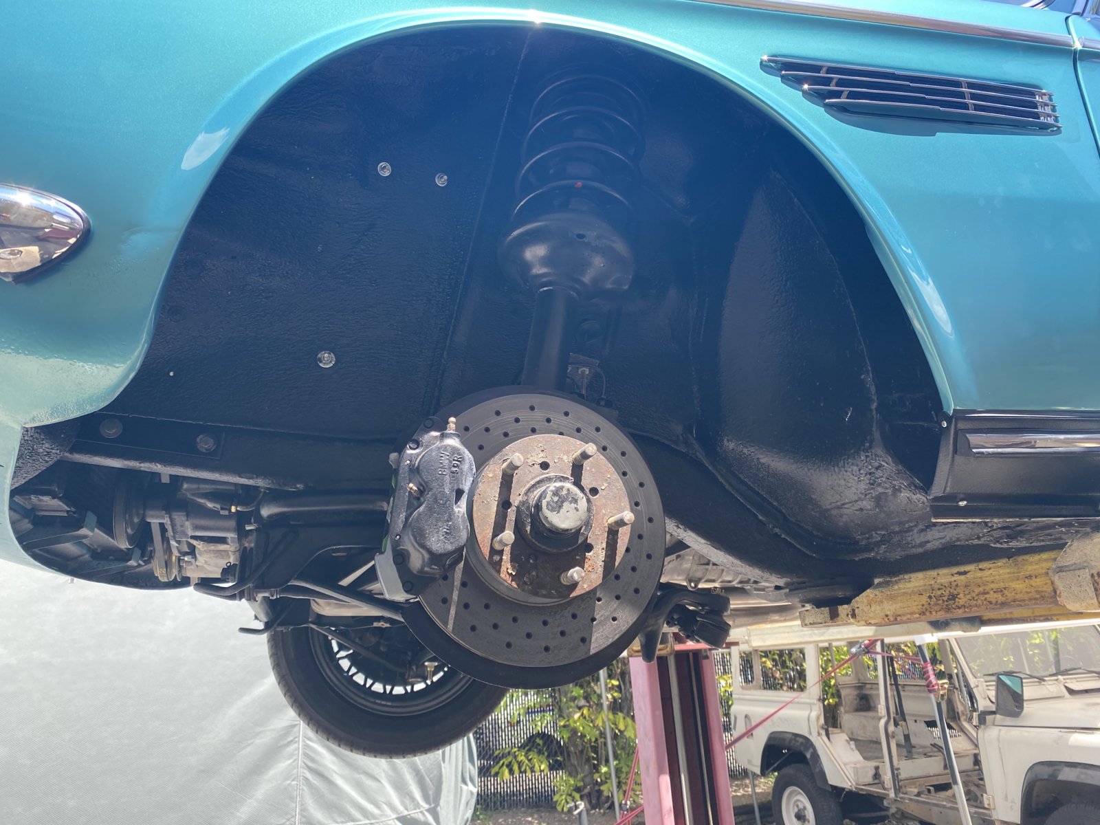

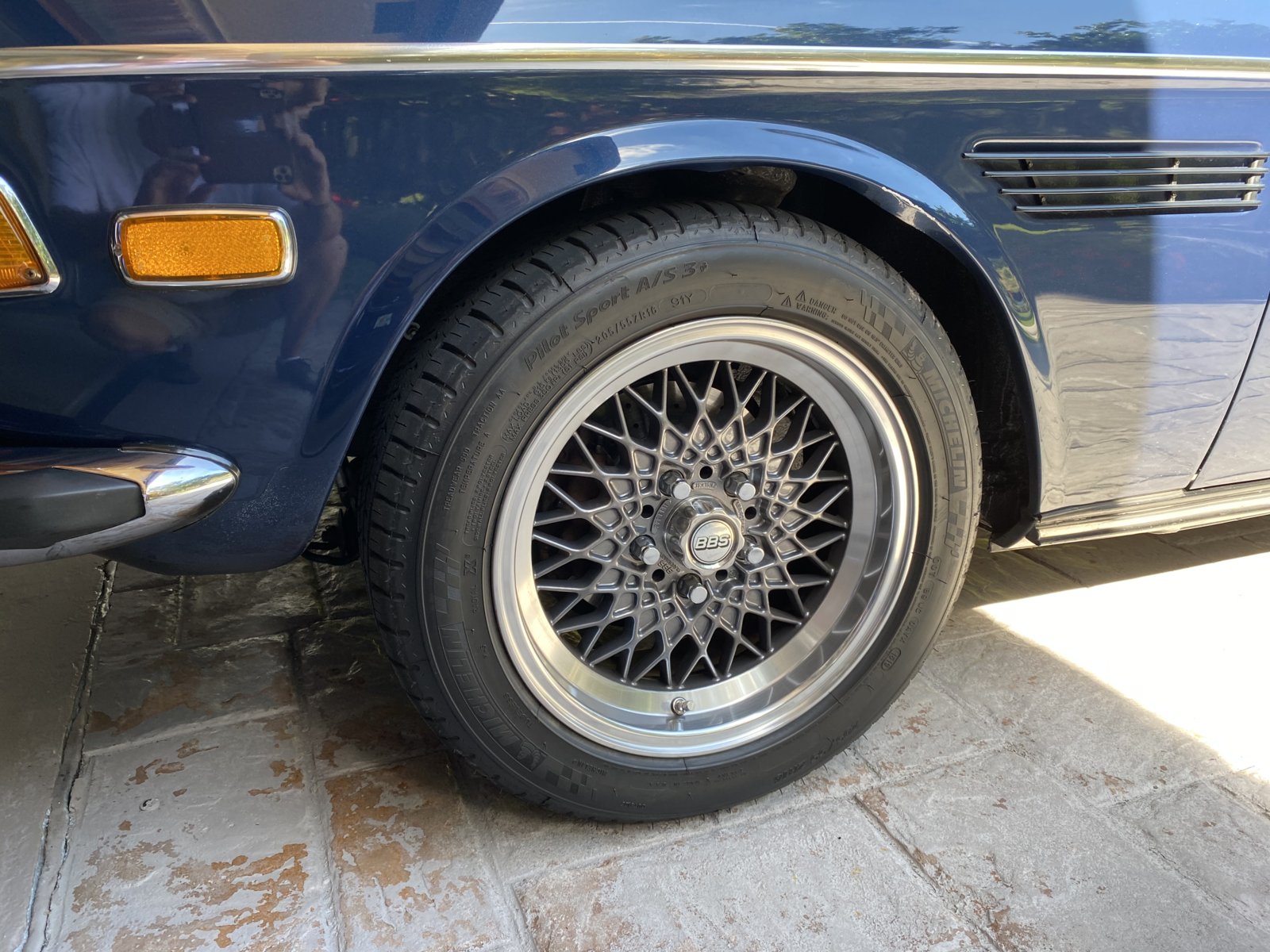

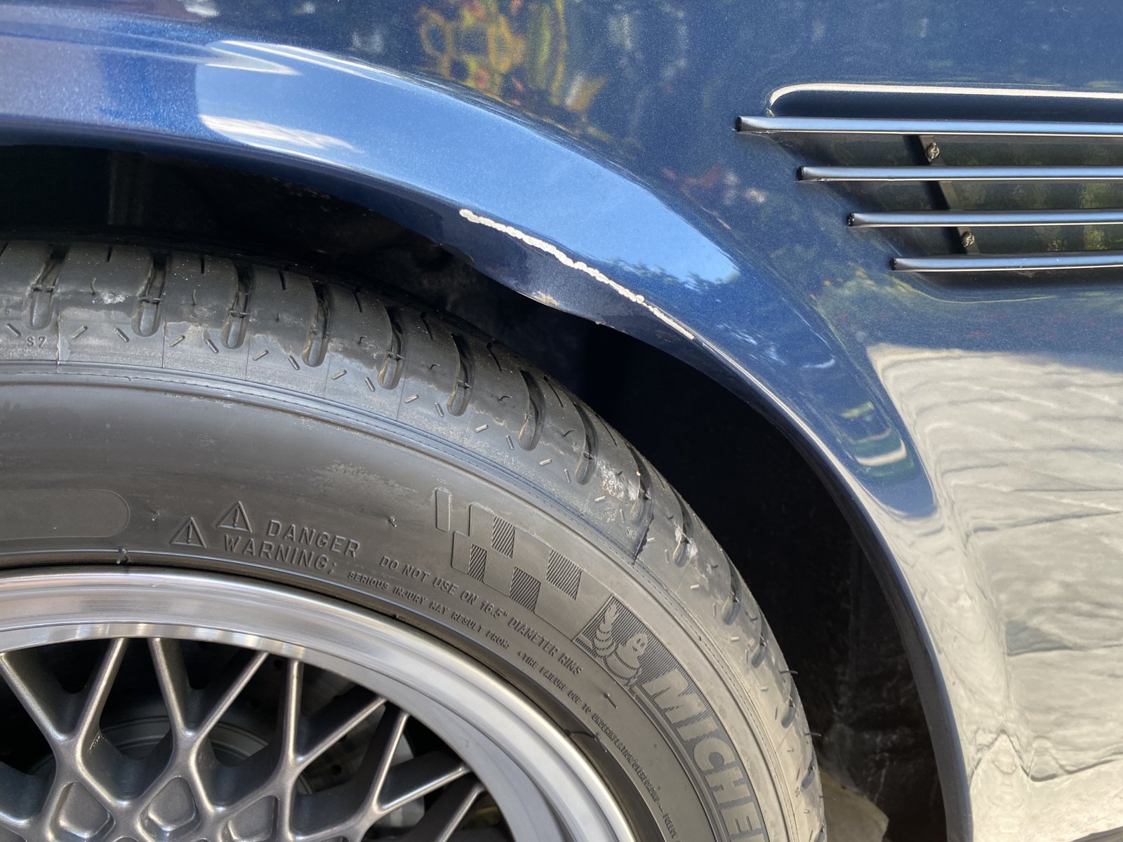

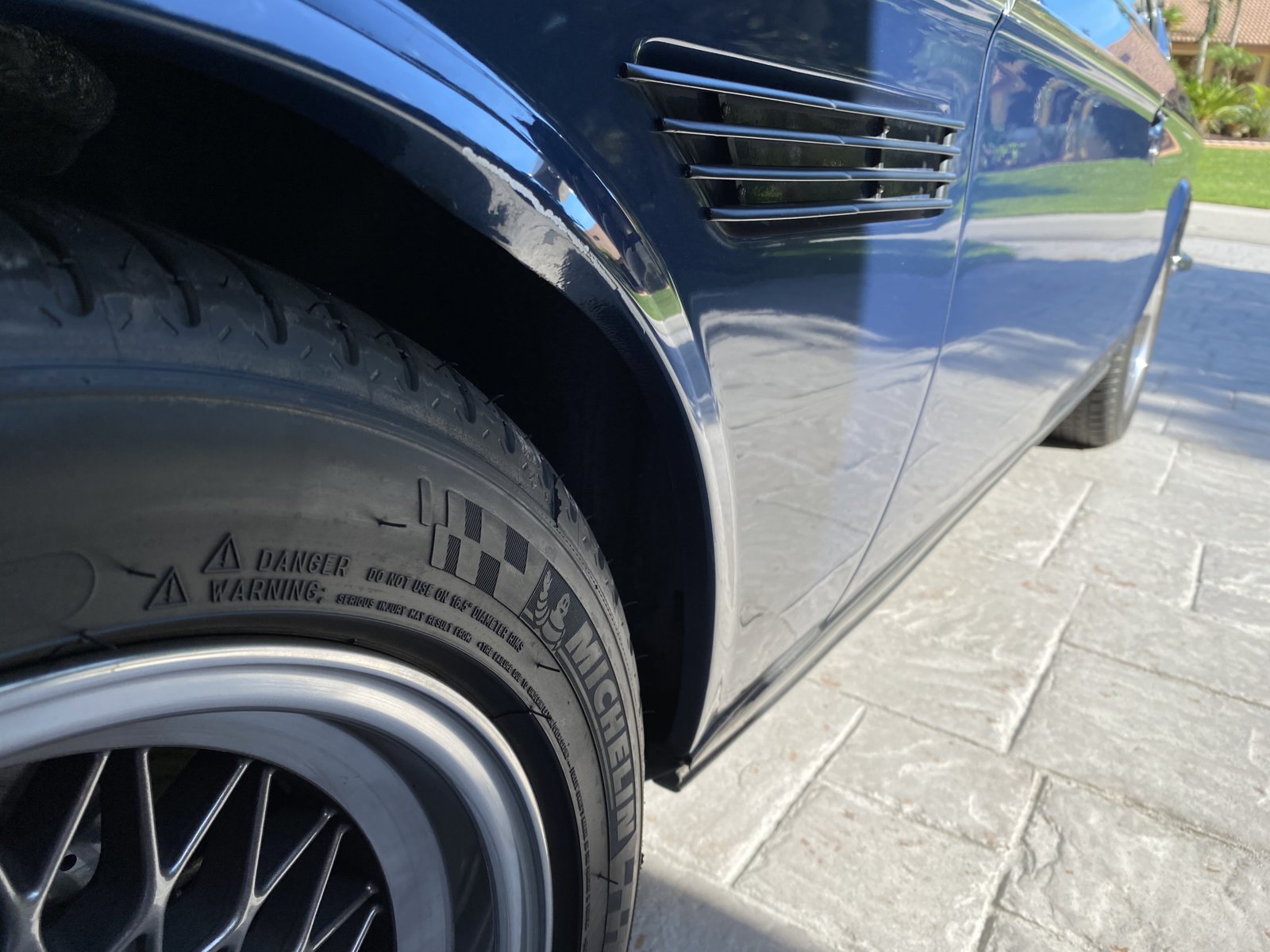

My car came to me with the stock 14" FPS wheels with 205/60X14" tires. The PO lowered the suspension and my floor jack would not even fit under the 1 1/8" front anti-sway bar.
I bought 4- 16X7" ET11 BBS basketweave wheels made in 1983 on B.A.T. The lug studs needed to be changed on all 4 hubs to fit the wheels. Markos correctly told me not to use those extra deep lug nuts. The 205/55-16" Michelin tires were mounted and I'm on the road again. I had the wheels turned to the left as I backed up and went into a depression. I heard a funny noise and saw the left front inner fender lip was pulled out and the paint was cracked. I was lucky my new tire was not cut. The car is no longer blue and the front fender lips are now completely rolled up and smooth to the touch. This can also happen with 15" wheels and oversized tires. Roll your fenders if you are going to lower the suspension.
