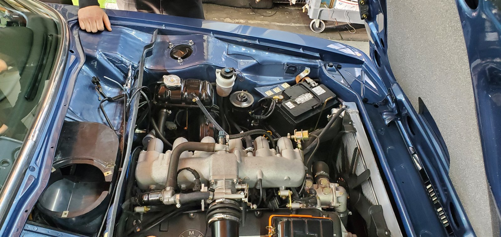

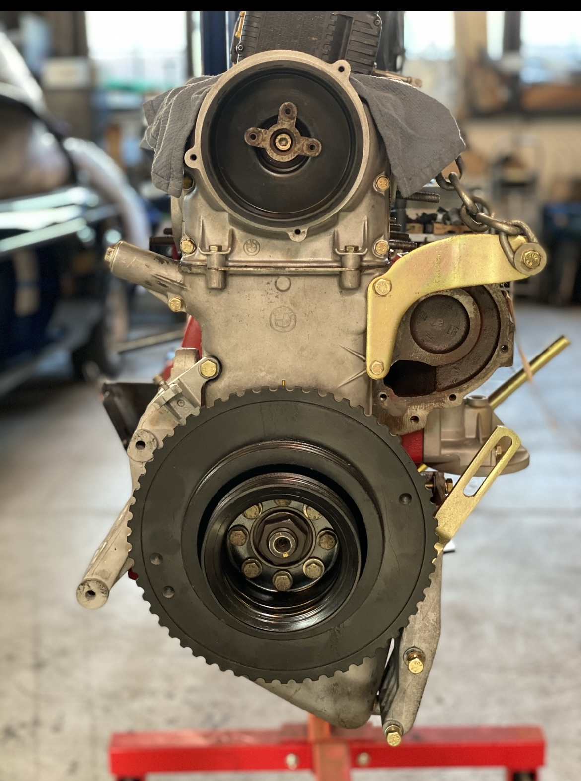

I have a 'period' CSi look to my motor. See pic. The intake runners are from an E21 (a bit longer to give some extra torque).
From there - Don can chime in on what I have and what he expects to get out of it once it gets to the dyno....

We tune for drivability. You push the pedal and instant response.
Instant nice big smooth response. A well tuned M90 with a moderate street cam feels like a turbo engine- give it a little gas and it responds. Give it a lot of gas and it really takes off. We aim for max torque at minimum rpm.
Torque is king for us.
nice looks like a very clean build very curious on one thing , I've seen you kept the rod driven throttle body in there ... what throttle position sensor did you go with is it out of an m50 and does it bolt in? this would be a big help
