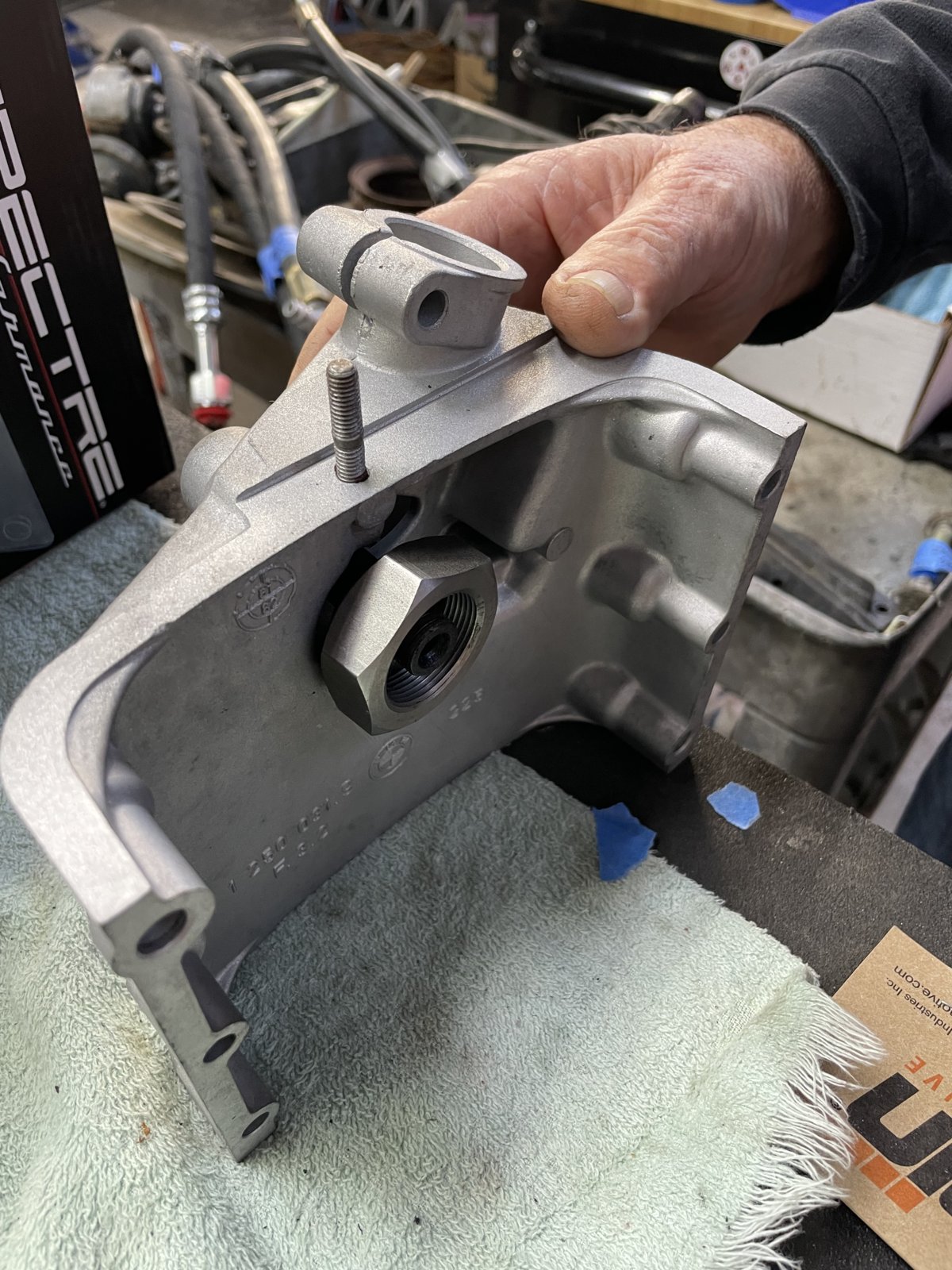

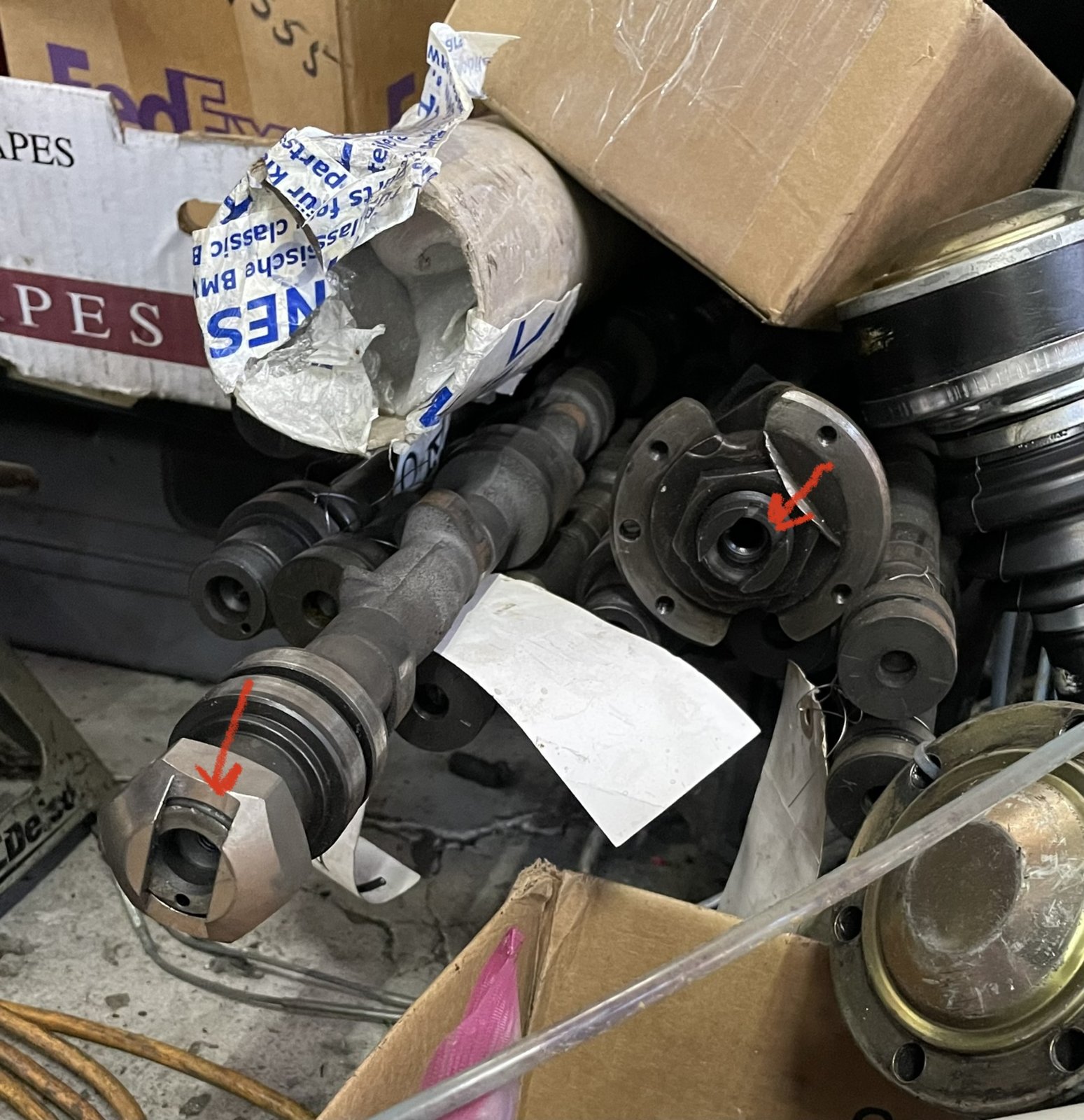

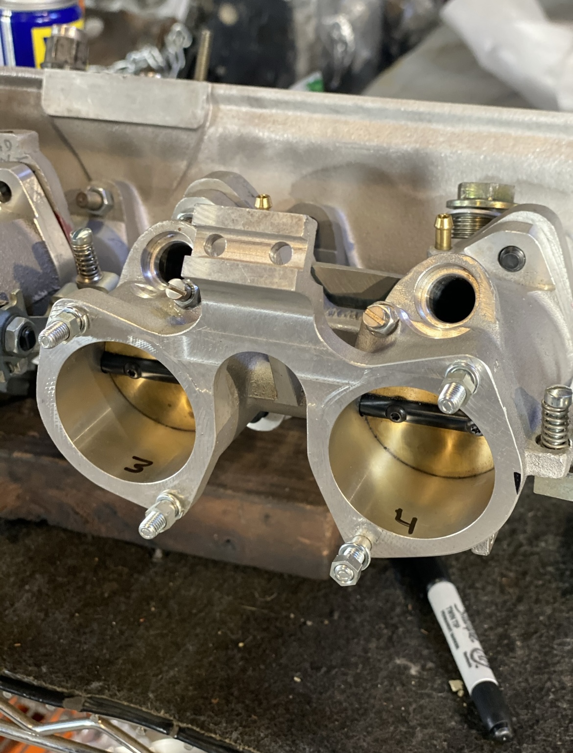

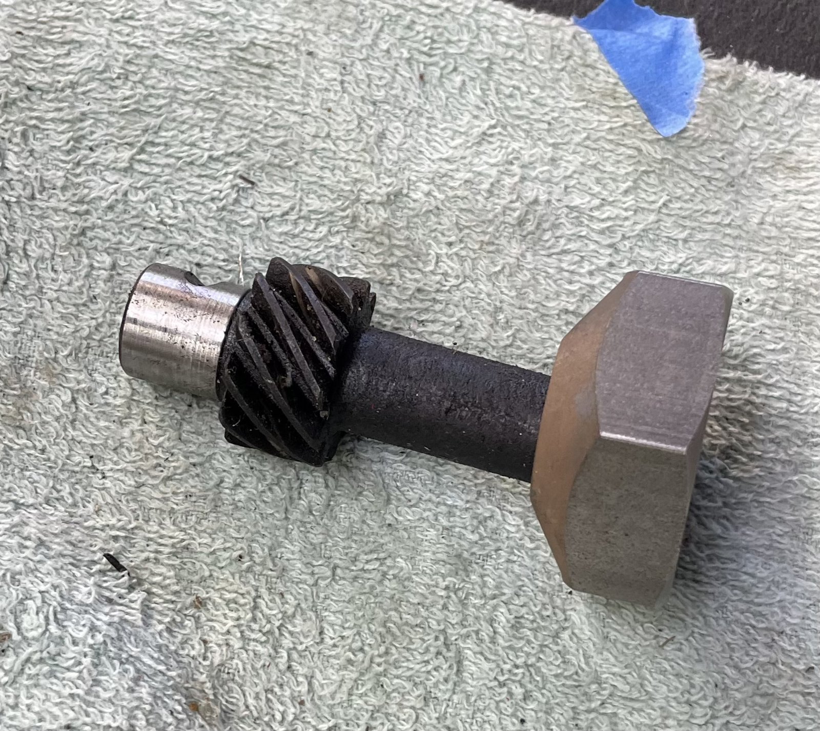

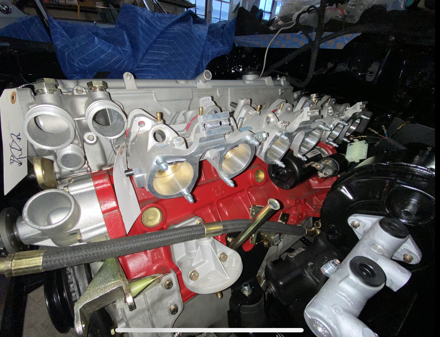

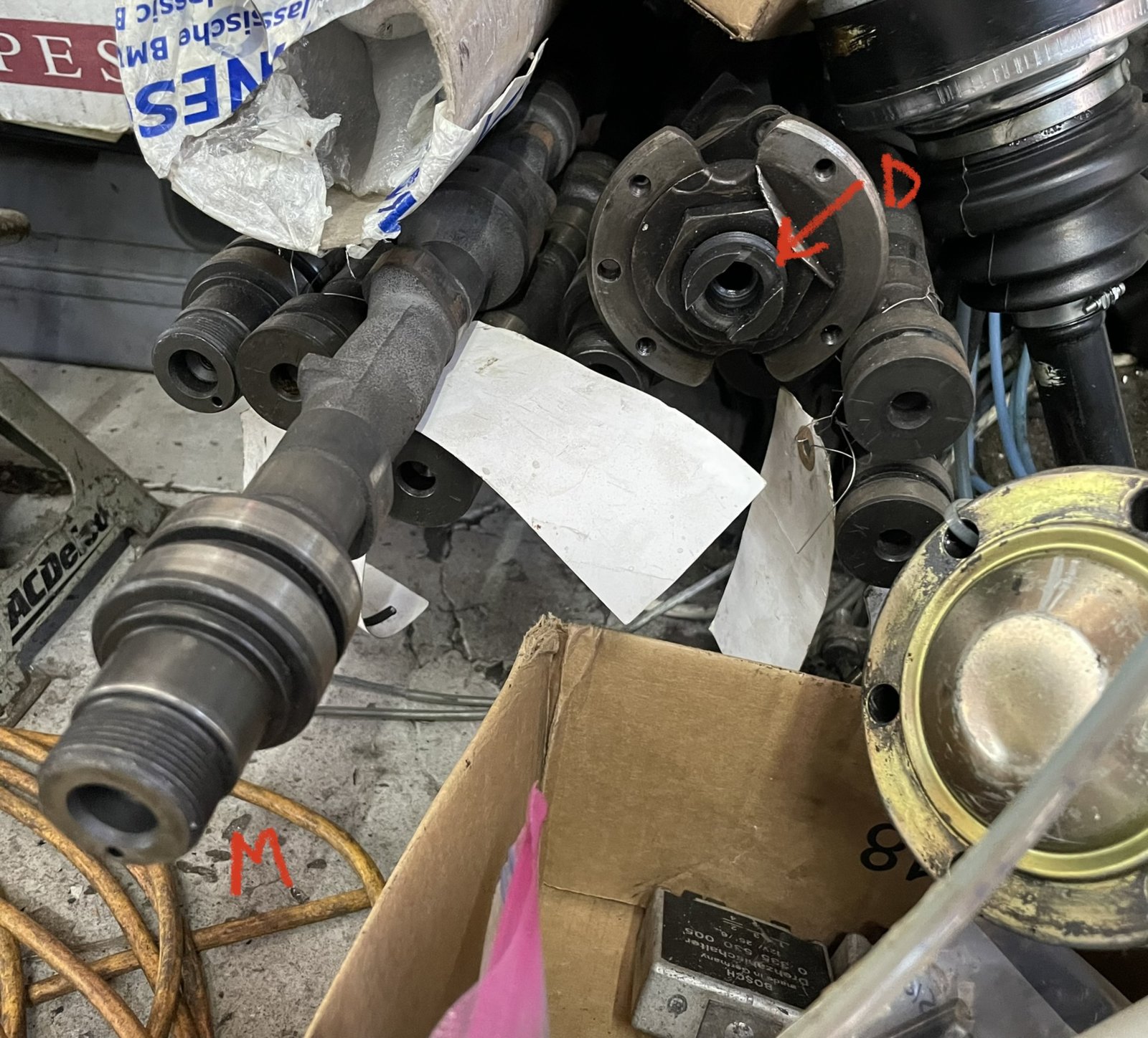

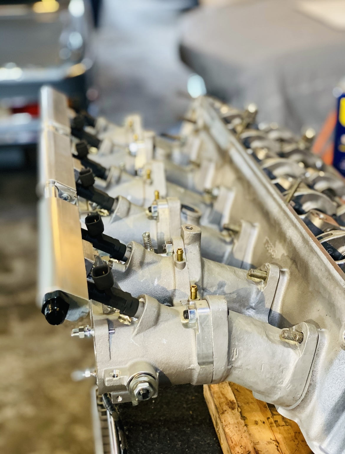

HBChris: We thought the same thing re. the red paint when we first saw it, but we decided to leave it as is, not least of which reason being that the ITB’s will . The block is ‘79 / head ‘86 / w/ larger ports and the water jacket.

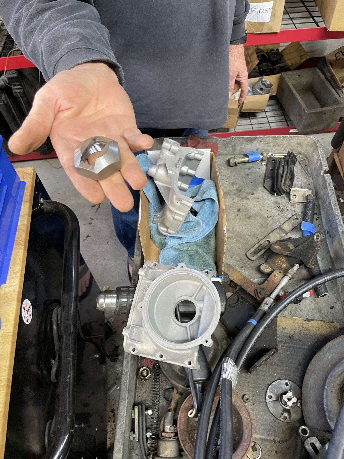

As for Motronic, the reason it’s set up that way currently is because that was the only option available when we got the cam. However, Don pointed out that with the help of a special nut he has, that it can be converted to a distributor. Long story short we can have it either way. Once it’s back from upholstery we’ll jump back in to the engine bay.
