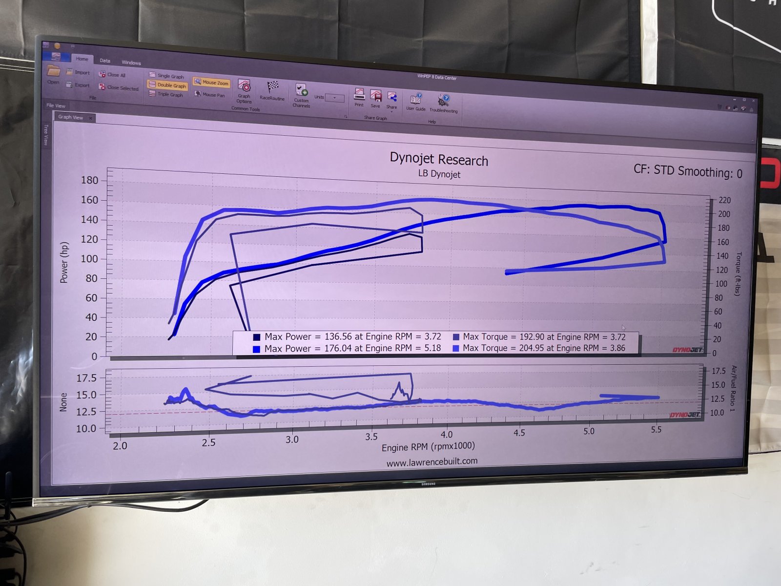

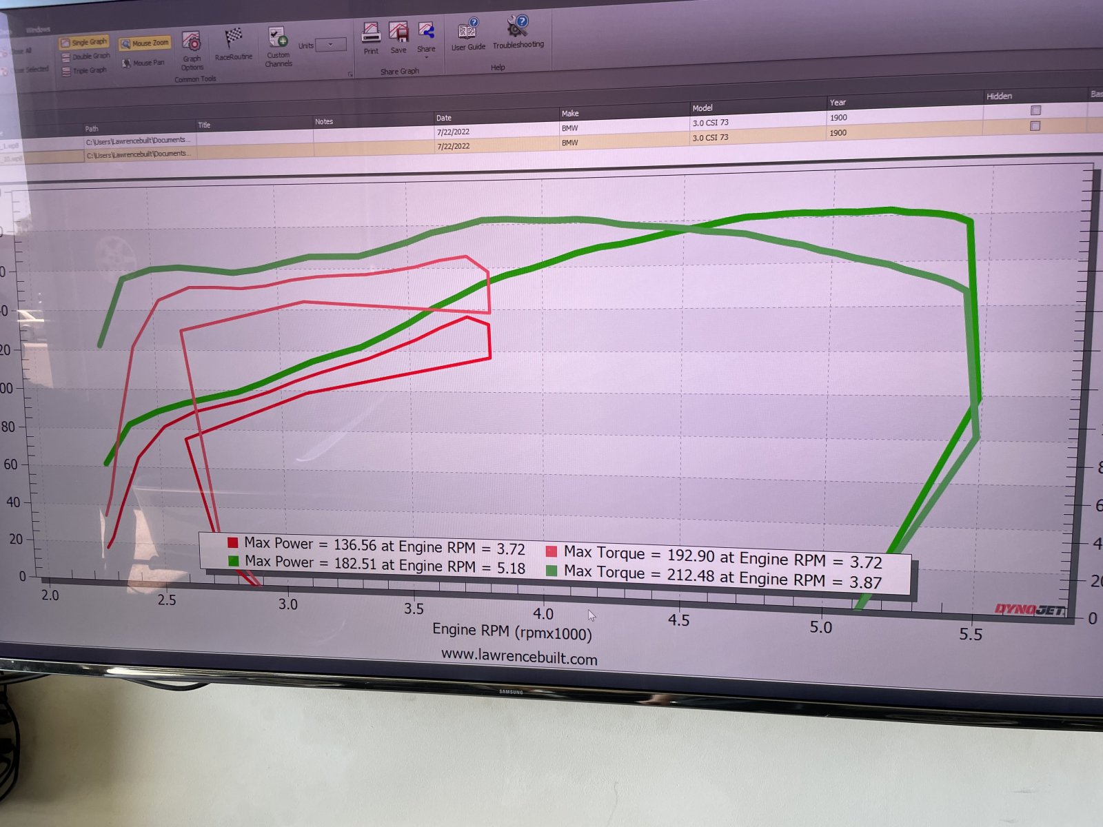

Last weeks Dyno of a 10:1 euro spec “dirty motor” with a Schrick mild street cam.

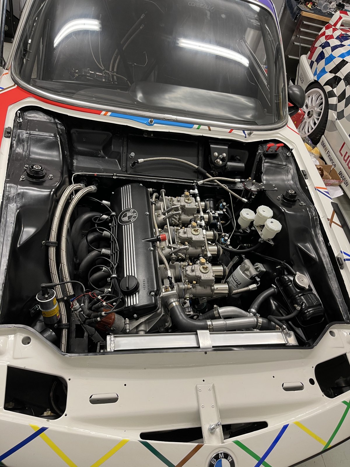

And trip Webers the week before on a Euro 3 liter engine.
