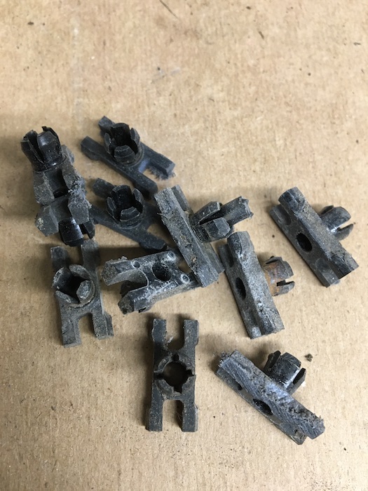

I found these in the pile of parts I got with the car...
I assume these are the other type of fastener used?
Are these and the threaded post fasteners available?
Yes and you may find the little plastic piece that goes in the hole and pushed through after that pieces legs are pushed through the hole. Some times the may be laying in the bottom of the door or trunk areas.
With 14 threaded posts I would expect they are at the ends of the trim pieces: front fender 2, doors 2 each, rear quarter 1 at the rear as you likely cant reach the forward most mount (if it's like a coupe!) The 2002 uses a similar fastening system BTW mixing both types.
Here's a picture of the clips I purchased new about 2yrs ago from I think Jim at Mesa Performance in Costa Mesa, CA.
The push-in pin mentioned above can be seen in the picture. Also, when i was looking around, some were sold including the thin gasket pictured on the left (which I opted for), and some did not come with this. I think its good to have to 1) better seal out water from the holes hopefully preventing rust. 2) acting as a soft spacer between the clip and the paint, and 3) as someone else mentioned, it makes it easier for the trim to snap onto the clip.

Thanks Bav3.5. I did find some of those in the parts that came with the car.
This is what I think I'm going to do. I'm not going to reopen the holes. They are nicely welded up and the finish body work has been done. I'll paint the car and at some point decide if I can live without the body line molding OR if I really need it on the car. If I need it on the car, I'll attach it with emblem trim tape (just like is done on newer cars)
