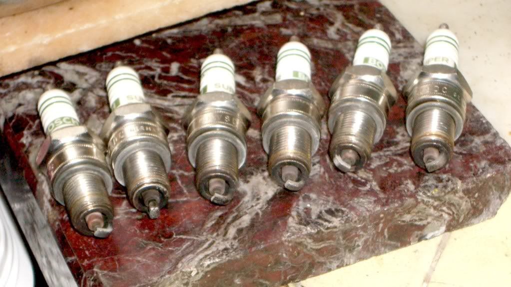

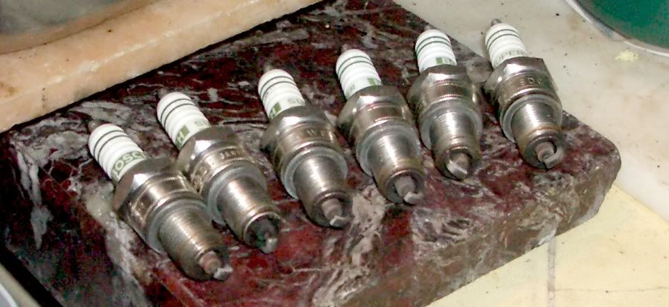

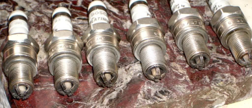

I dare say that some of us, including this poster, may have misread your post and incorrectly presumed you were asking about a different spark plug: Bosch's 4 electrode platinum series (as pictured by Sr. Jacobs). Aside from the platinum center electrode, you may note the plug is a different design akin to an air gap. It is self cleaning and will fire under the most adverse conditions - according to the sales literature. It is also several times more expensive than the stock plugs.
I do not know anyone running the exact same plug you have pictured although I suspect that many do. As it appears to be the same heat range as the W7DC/W8DC it looks like your plugs are suited to your engine. I do not think there is much difference between your plug and the standard single side electrode. I believe I have used a similar plug with three electrodes BP6ET W7TC? but never found much advantage other than gapping becomes tedious. (I think the makers discourage regapping these plugs!)
The one benefit to these plugs is that they displace more volume so they improve compression (very slightly). The extra electrodes are more typically seen in aviation applications. I do not know why but can postulate that the extra electrodes offer more area for the spark to jump if there is unforeseen fouling. (Not that important in a terrestrial based vehicle without wings.)
It seems that your plugs might be a tad too cold, but reading the plugs can be misleading since you could have been idling too long before you shut the engine down. Ideally, you would make a full power run - cut the engine, coast to a stop, and pull the plugs. That is hardly feasible for most of us and besides, it doesn't account for the major use of the plug: idle and part throttle. Your plugs have to function under all of those conditions.
30csl said:Last time i removed them they were more white in colour.
They are Bosch W78 - what is that like for heat range etc?
