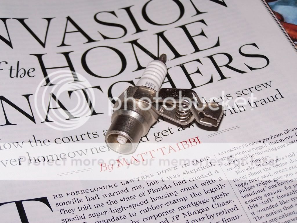

A handy tool
I use this handy tool for spark check. No need to pull a plug. Works on everything I have come against...lawn mower to M30
