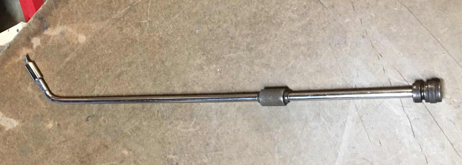

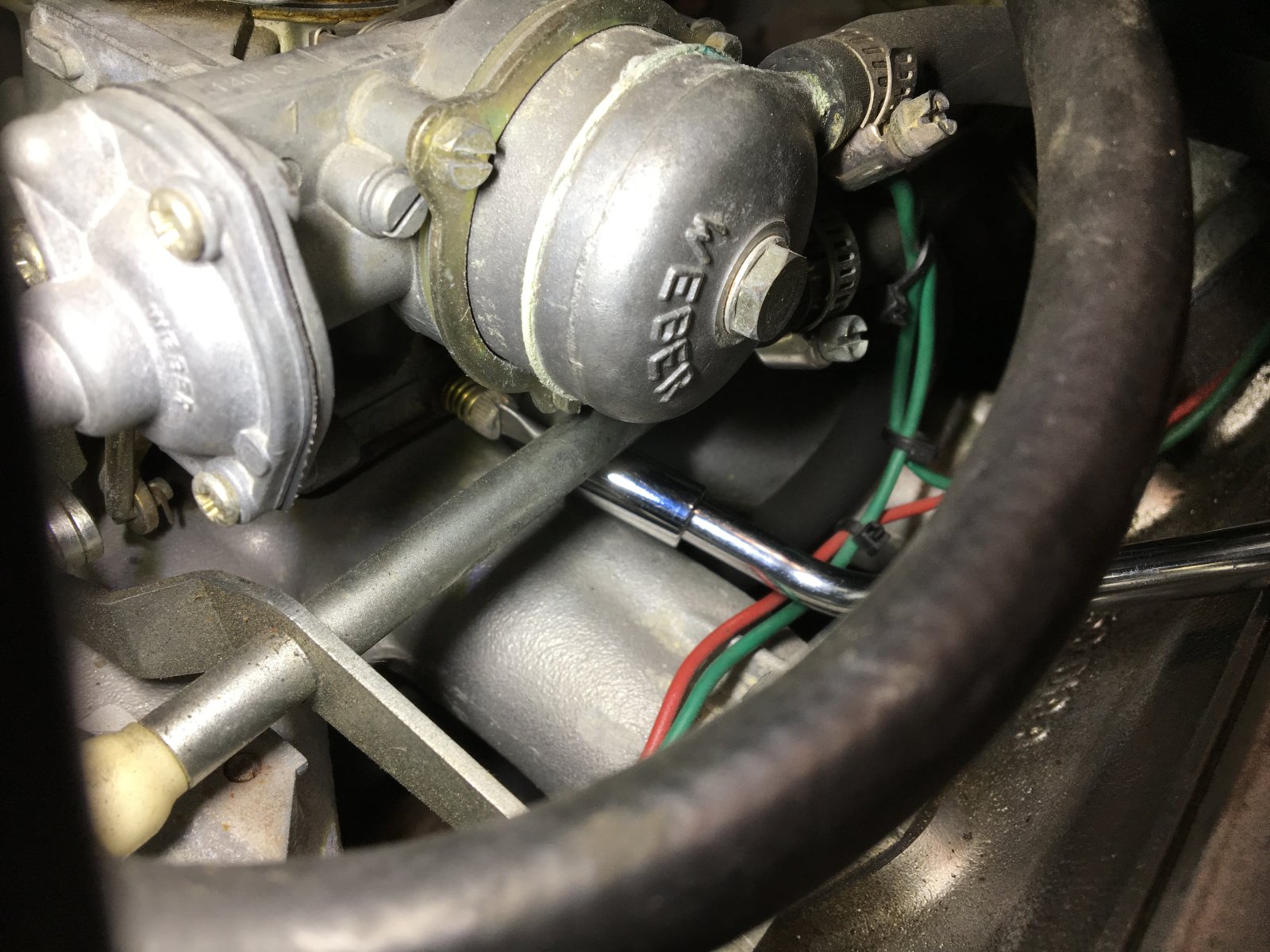

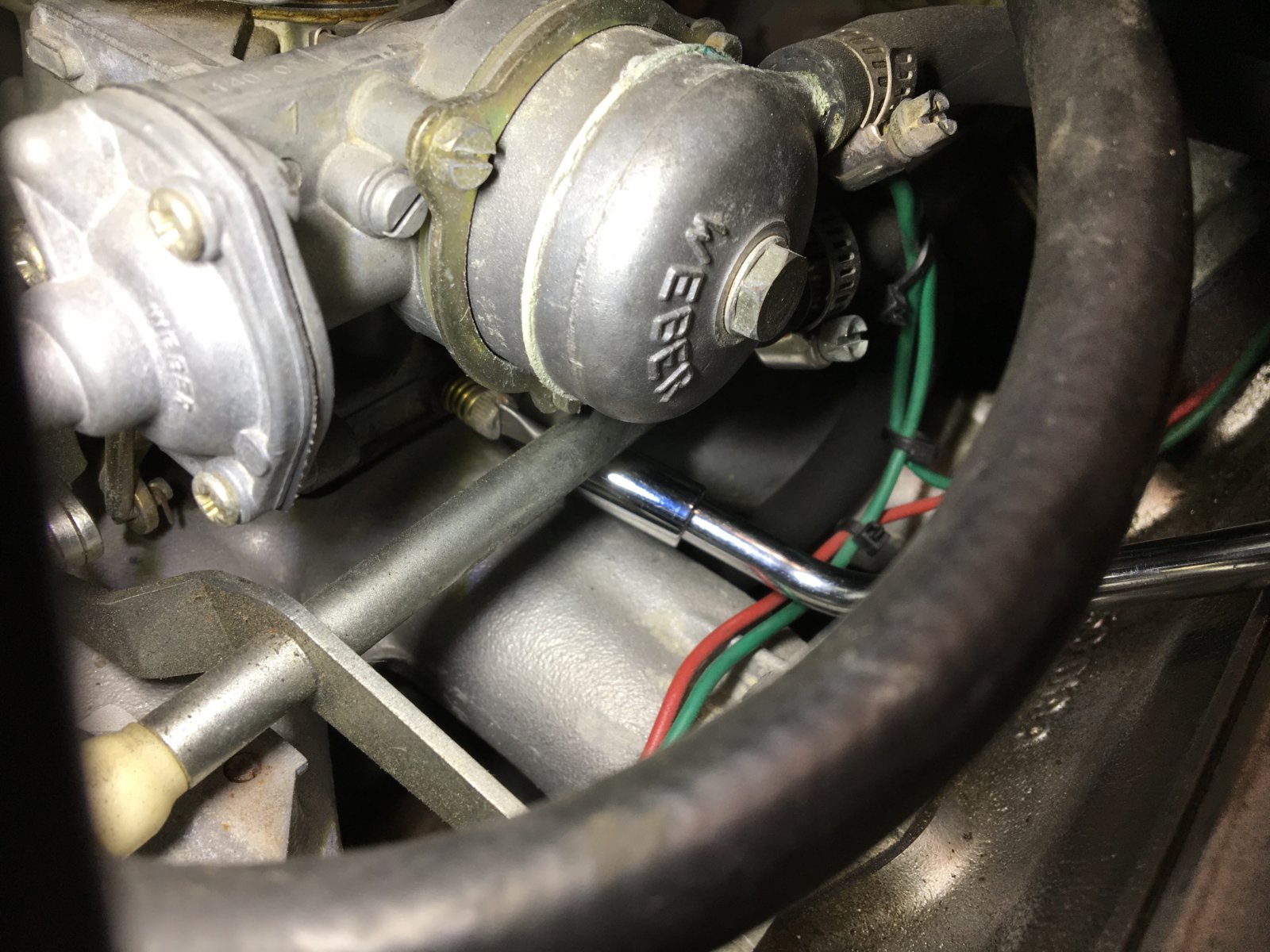

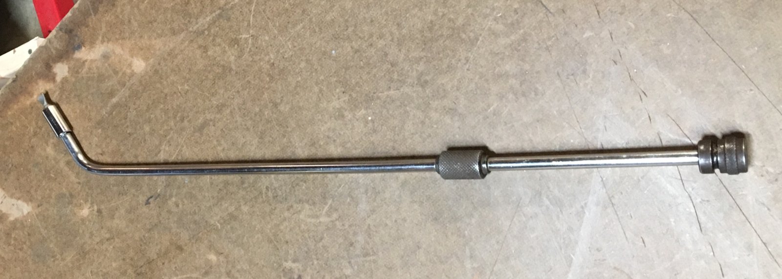

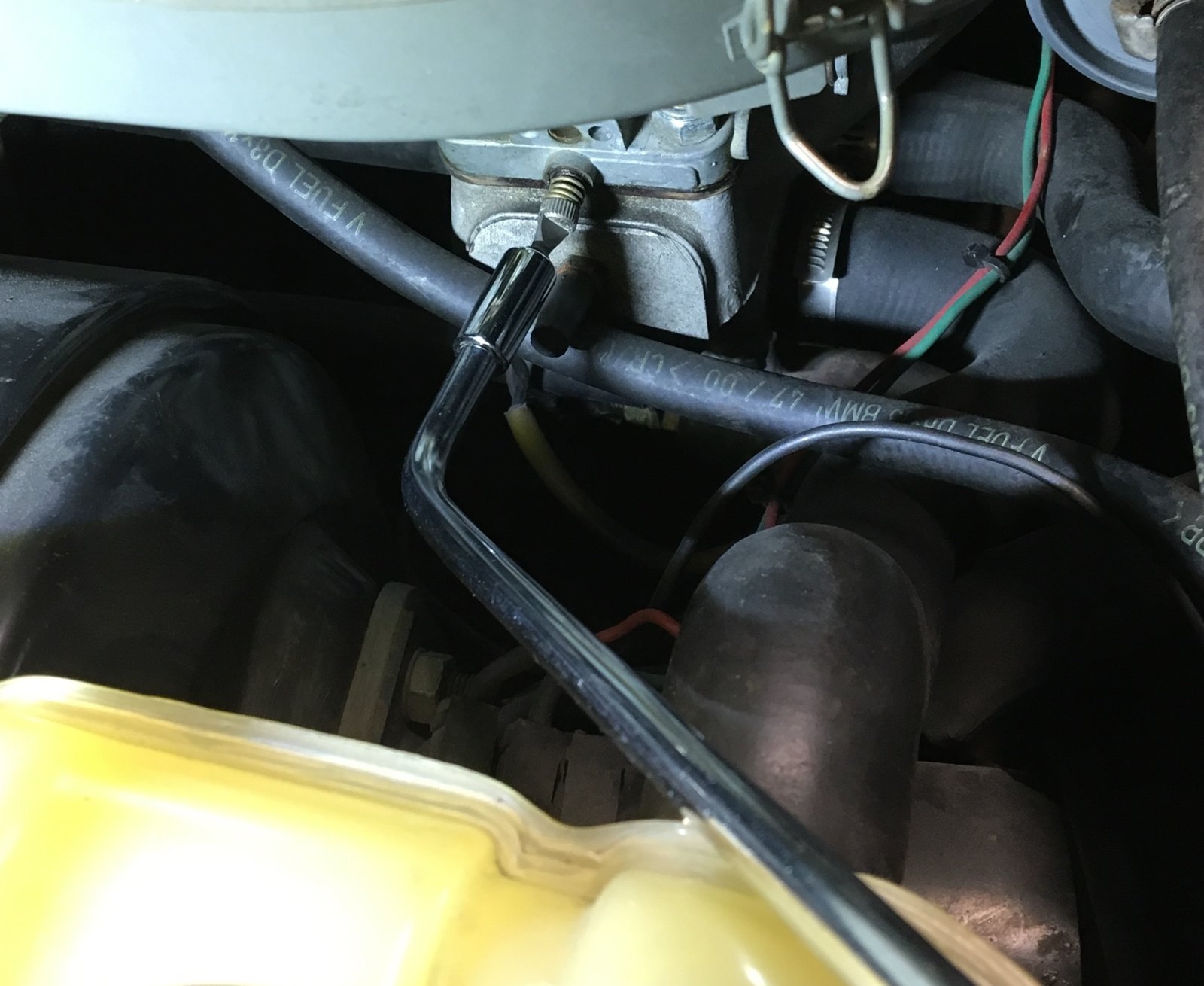

I splurged and bought a used Blue Point carb adjuster screwdriver. It is a flexible 1/4 extension in a tube with a twist knob on one end and a 1/4” square drive on the other end. You add a 1/4 square to hex adapter ($4) so you can use any hex bit.
This makes getting to the various Weber DG screws trivial. Not needed for DCOE’s. Unsure if it’s helpful with Zeniths.
Highly recommended if you need to play around with Weber downdrafts. I paid $20 for it.

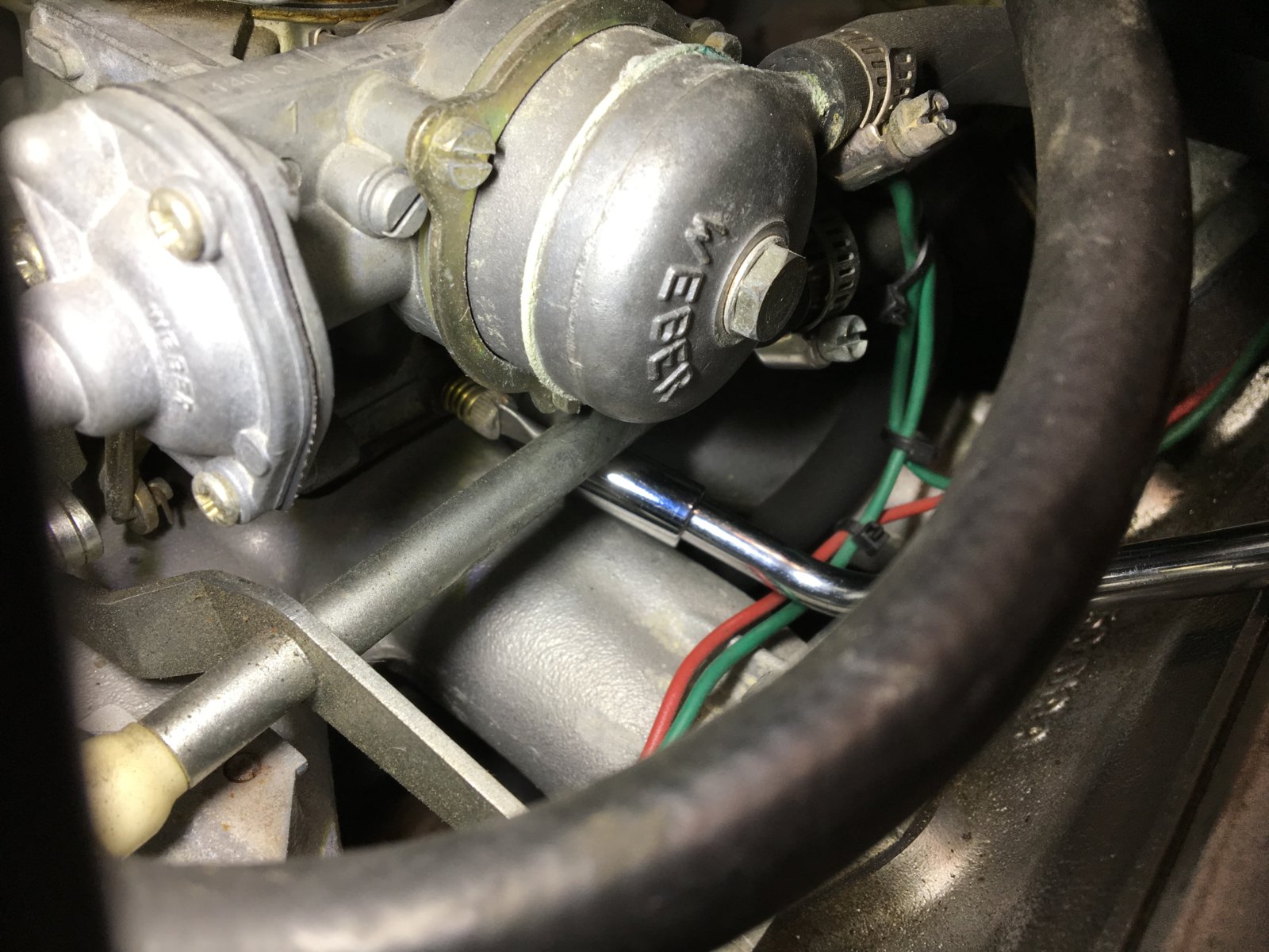

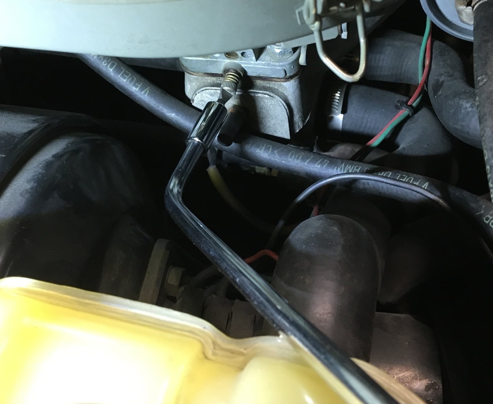

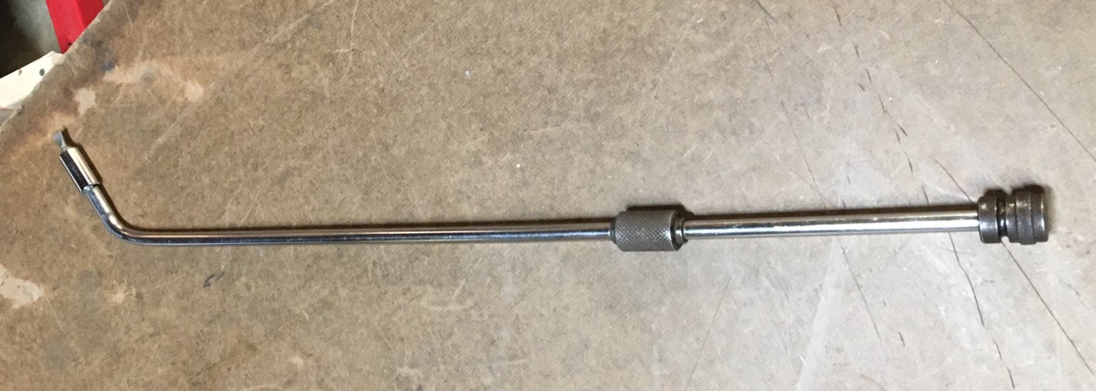

it looks very nice
we can use the zeniths without that cool thing, but thank you for posting

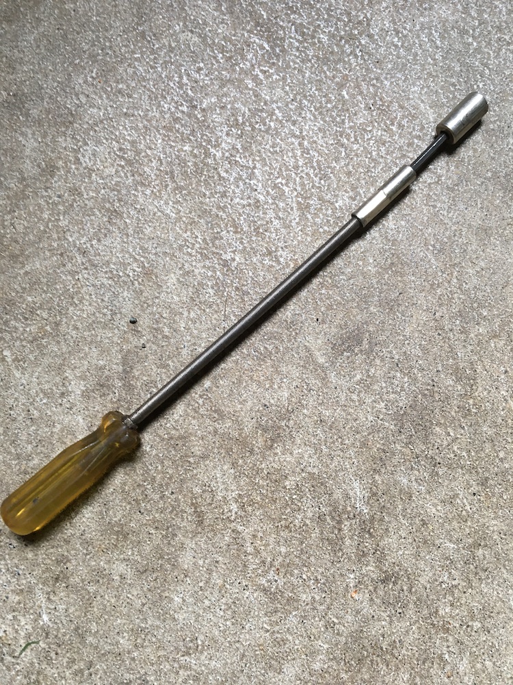

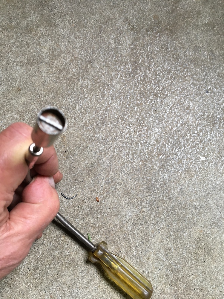

I made something like that one day after getting frustrated trying to adjust that tiny little screw for the fast idle speed I took an old thinner screwdriver, cut the end off of it, put an old spring ( tightly wound one ) jammed onto the screw driver and the end I cut off, into the other end of the spring. Now, I could do the adjustment much easier because I could flex the " screwdriver " easier to get around linkages and such The spring was about 2-3 inches long
