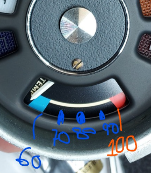

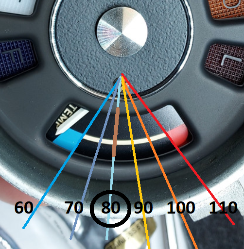

if needle is in the middle, your coolant temp is 85 assuming a linear scale, nothing severely wrong
