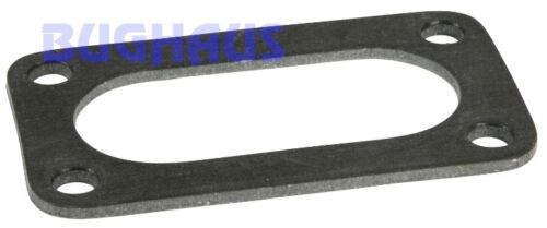

I have had some success with adding a phenolic/Bakelite 8mm spacer between the carb and intake manifold. That helps to isolate the carb body from the heat of the engine.

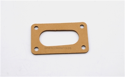

I bought some BAKELITE from amazon/ebay Had a local guy with a water jet cutter cut some out for me You can get extra thick base gaskets ( but only 4 mm thick ) from Pierce Manifolds that are for a Weber 32/36 Same bolt pattern as the coupe carbs Use one and probably not have to use extended studs

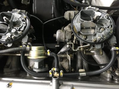

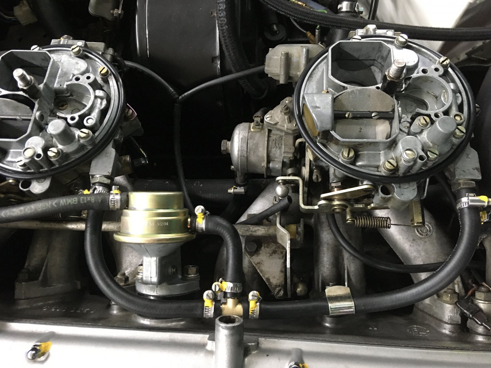

Hello
The fuel line shouldn‘t touch the hot cylinderhead.
I had problems with starting the hot engine in hot climate.
Because airfilter housing will get also hot.
After fuel line routing was modified as shown on foto I didn’t had any problems. I also used a clamp/holder to pull the fuel line away from the airfilter housing
Ulrich
