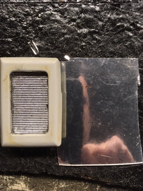

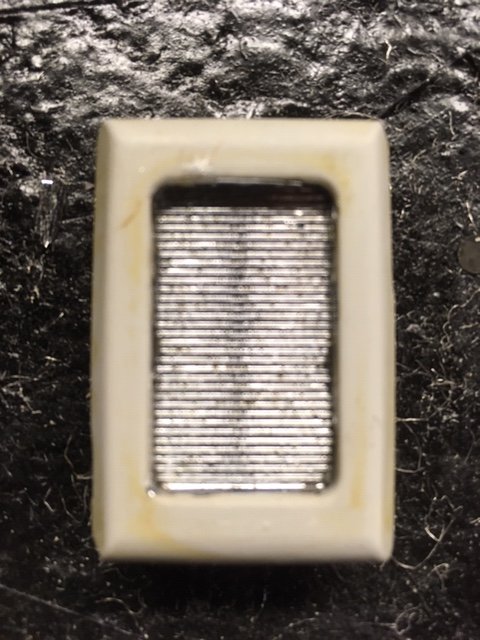

Mine were the usual, crispy and flaking so nothing to lose. I had some chrome wrap left over so....here is what I started with after cleaning the blank to get a smooth surface. I left the center with ridges cause I knew I could not get that fine ridge detail

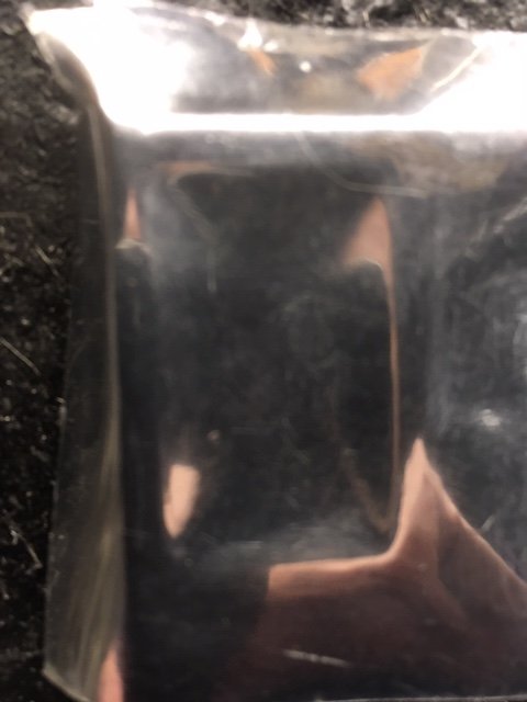

Next, cut out a piece of chrome wrap. It looks like crap because it has a thin protective clear over it that is removed at the end. Also adhesive back which was taken off.

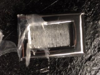

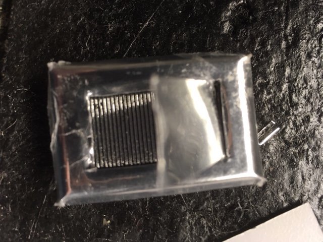

Cut each corner on a diagonal, fold one edge around the corner, cut the other edge straight. When done on all four corners, I used a razor to cut out the center.
Used a hairdryer to work all the corners and edges smooth, tacked down along the back with the adhesive backing, where the turn was too great/ no stick, I used a dab of crazy glue. Peeled off the protective coating:

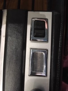

Then installed. The Switch is original. Not perfect but you cannot tell unless you look close. Best alternative I could come up with.

excellent, very nicely done

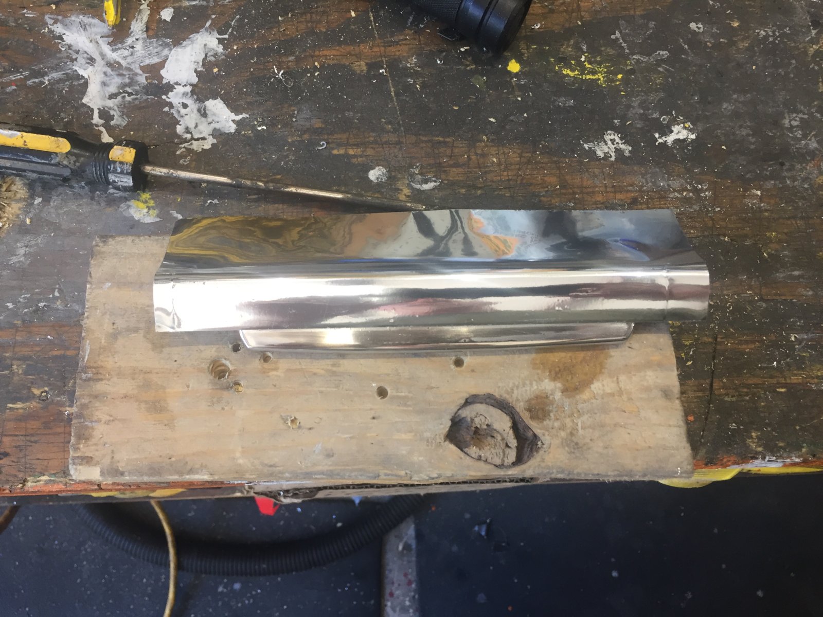

Tape stuff on a door handle that had some chrome pop-up / bubbles. Sand bubbles, apply tape.
Thanks so much, Scott, for the handle.
