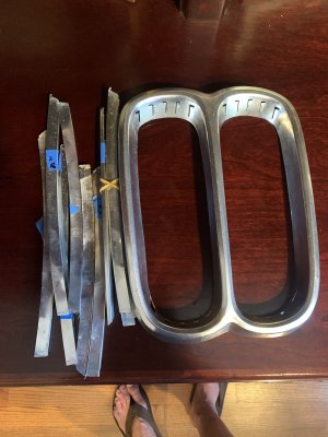

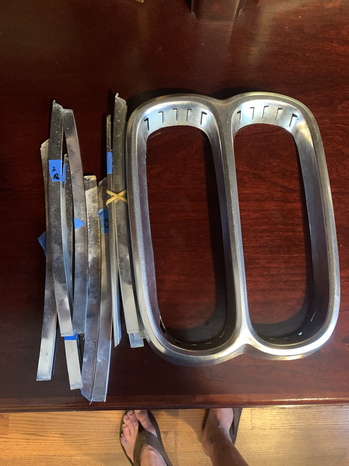

Thank you Tony, about the glue remover, have I to submerge all the center grill or simply use it with a brush, where needed?
On another 5 slats grill I used a sharp blade and a little heat gun and it rather easily separated.
Going forwad I will not use glue remover . It more work and much messier !
Cheers

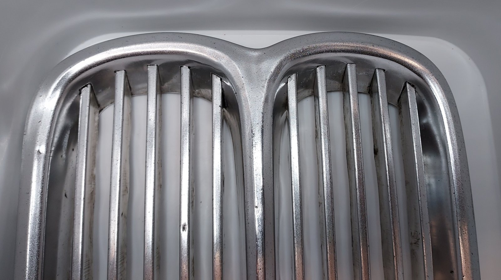

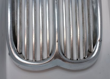

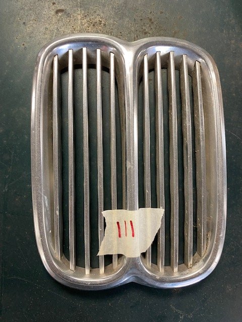

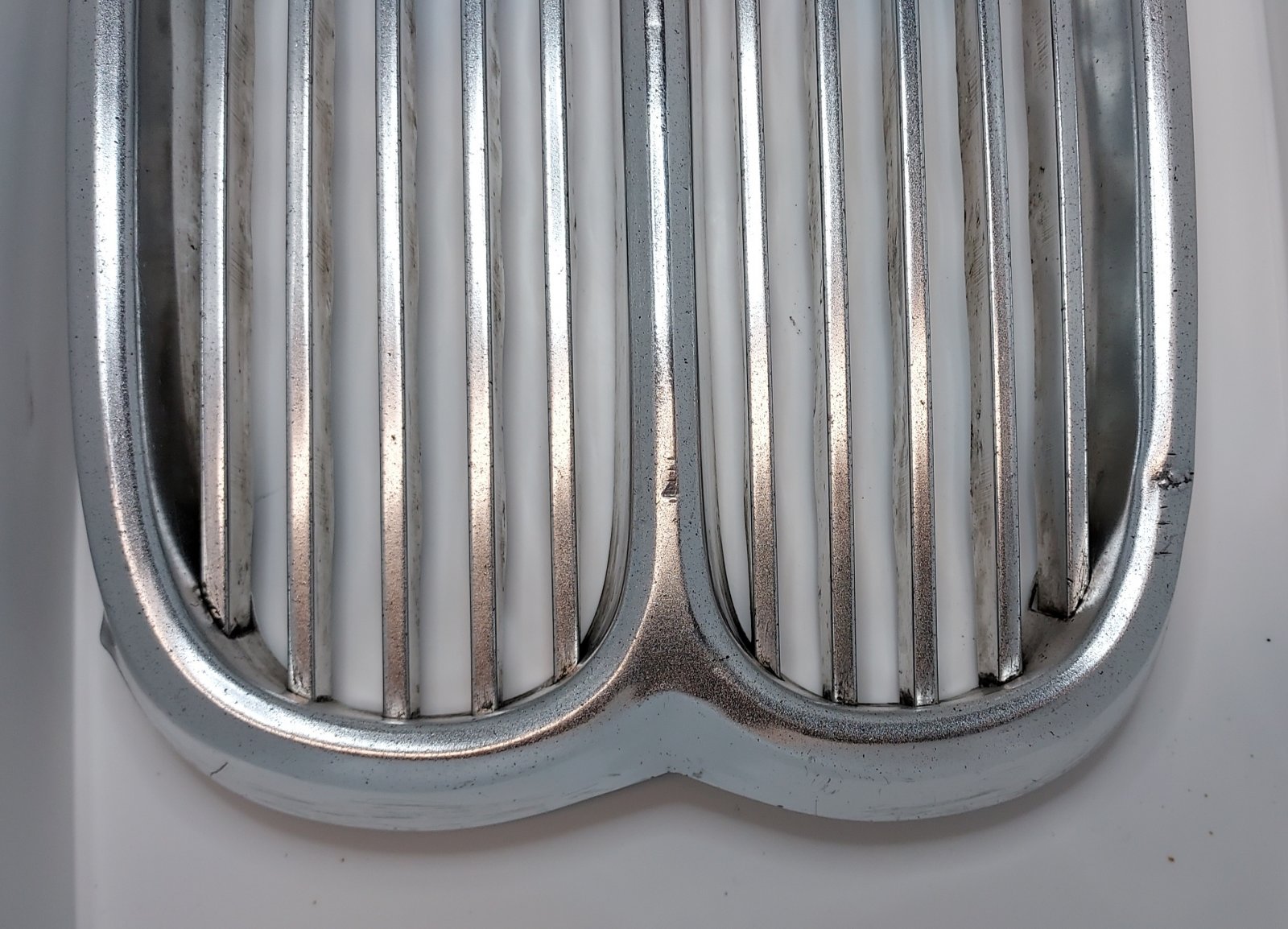

Here are the tools I used to pinch out the dents and sand it with 320 inside and out . You can see the bumps and where you need to press against to push the dents out ! Another words when you sand the area that has the dents the outstanding (high) points get sanded and you know where to press the alluminum !
Then sand the little more and remove the last bits of the bumps from the outside .
Cheers

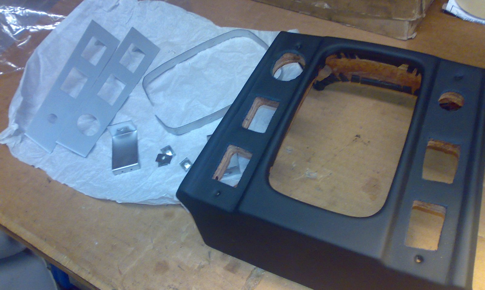

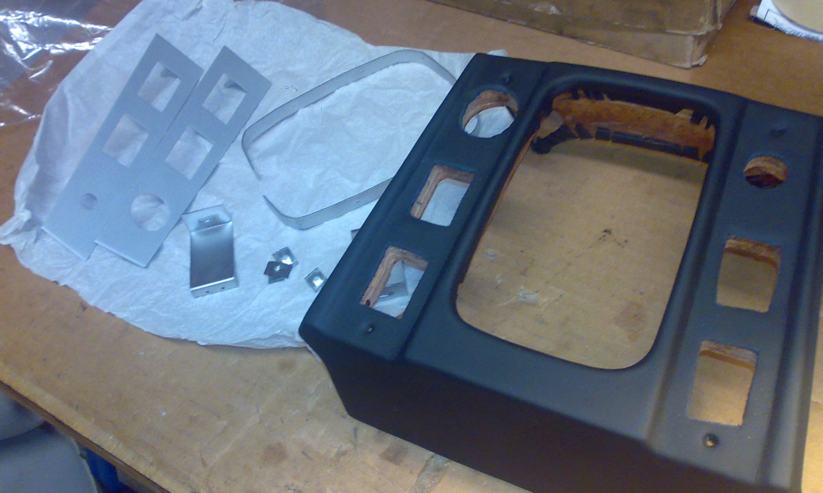

i can anodize them here, guys have experience and the have anodized alu plates for me,
i.e. the ones in the central console
see here, left side two pieces anodized, right side is chromed steel
I took a disposable brush and dab some on the glue !
However couple of weeks ago on my next grill I used heat gun and scraped off the glue with a sharp knife , and exposed the tabs whereas I could bend them gently and loosen the slats . It worked just fine and it was a lot less messy!

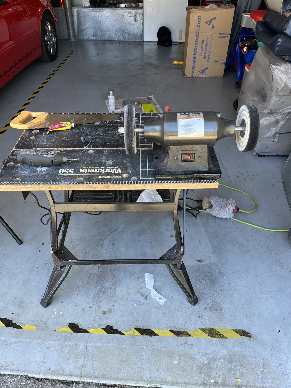

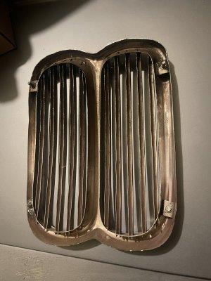

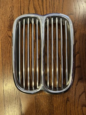

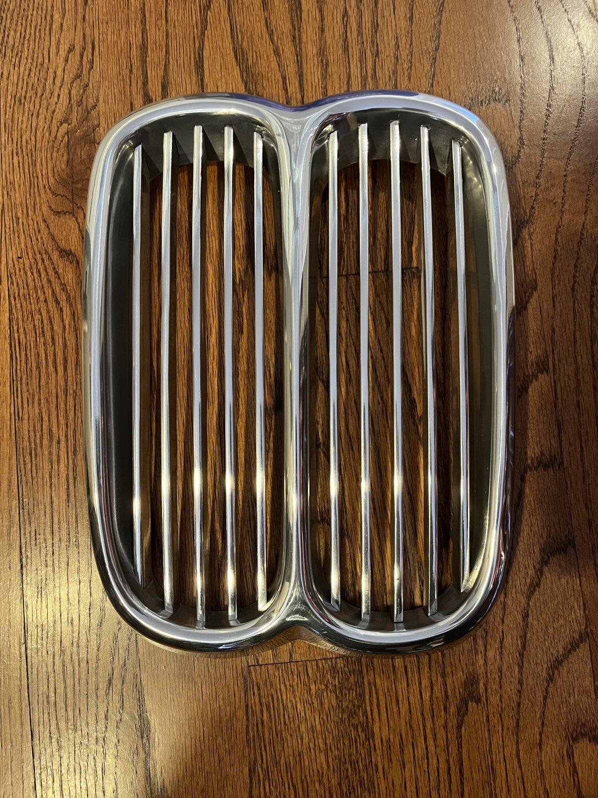

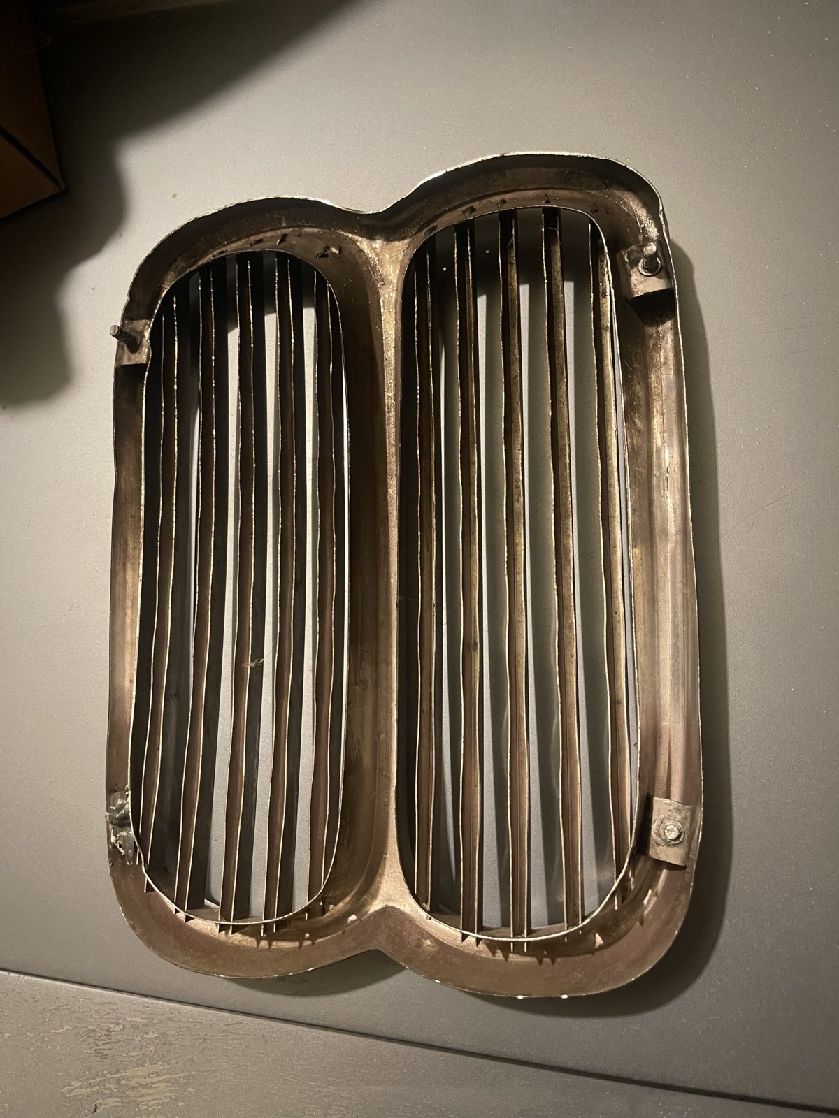

Just completed my Center Grill restoration. Not sure if it was worth all the work, but I am glad to have it done. I still need to have it clear coated. I had planed on doing it myself, but now that I am getting my entire car painted I will have my painter do it.
Here are some picture of the project. As outlined by others the steps I took were
1- Stripping clear coat and dismantaling slats
2- Hammering out dents

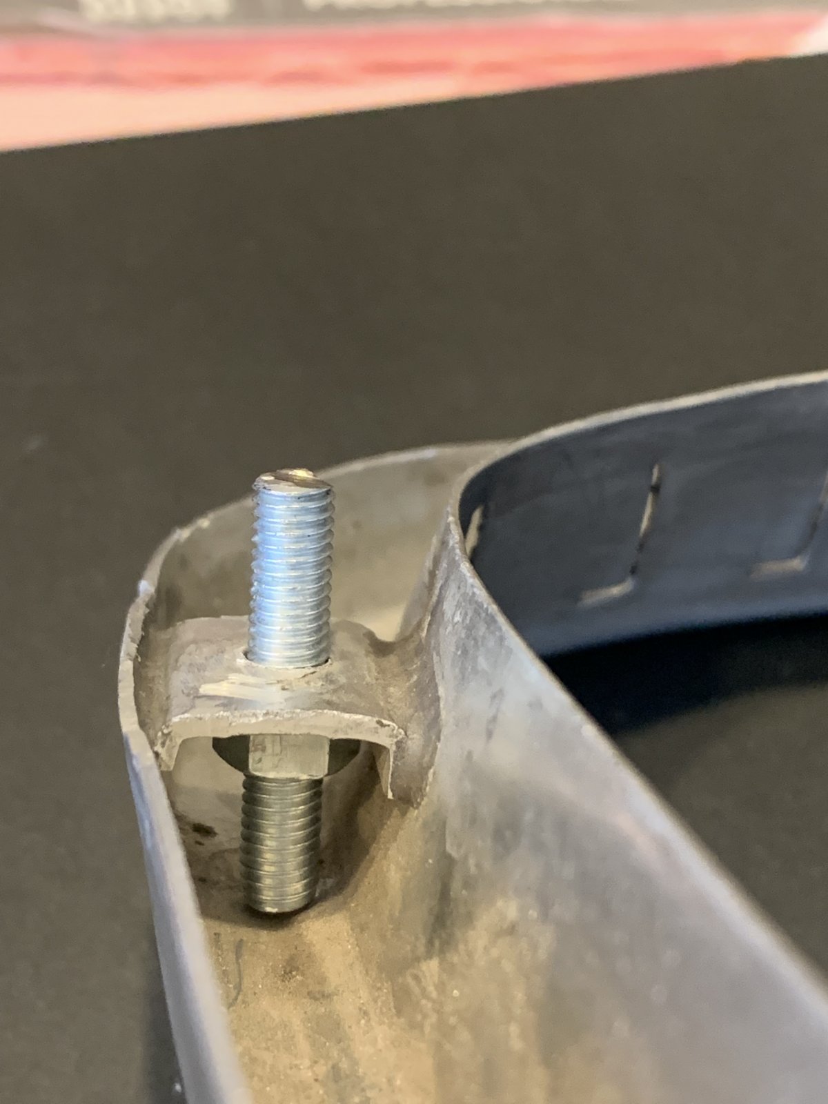

3-Had to replace two of the bolts that hold the grill in. I just dremmeled them out and put in new bolts
4- Sand ,sand,sand and more sand

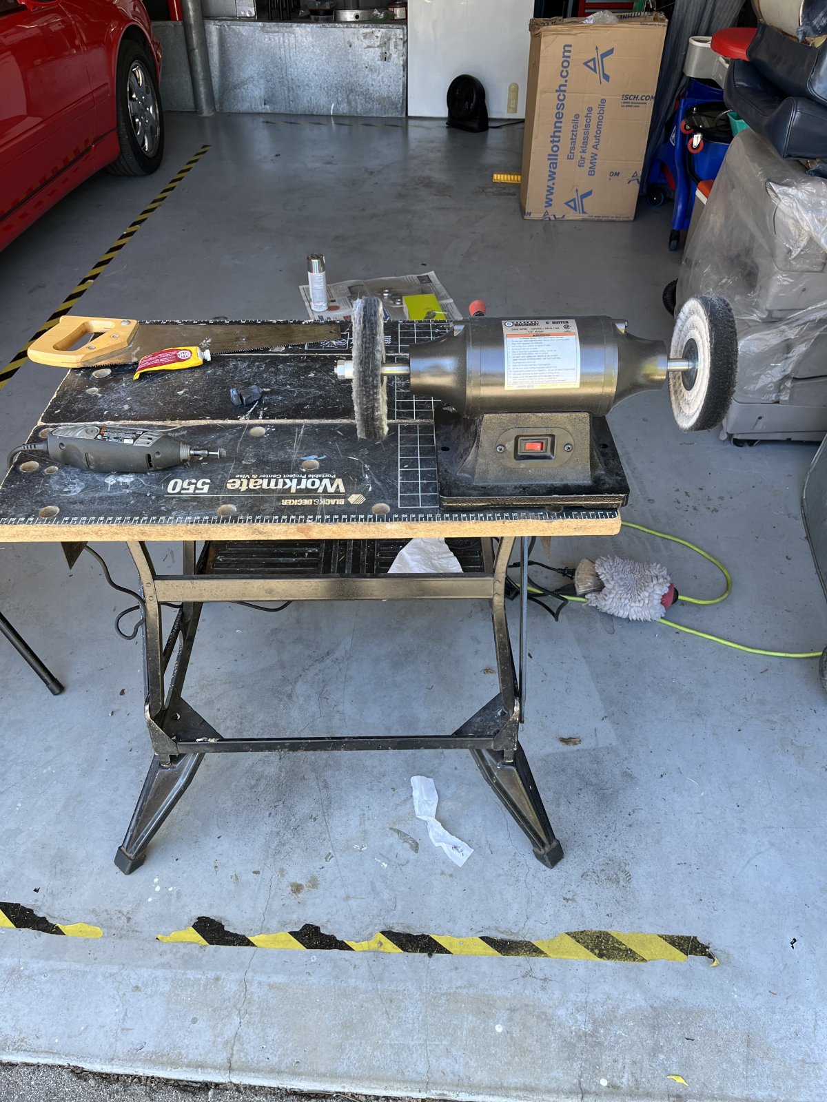

5- Polisih with dremel and a larger polisher I bought at Harbor freight.
Here are before and after picturer

It is a big job, a lot of sanding And then super careful on the buffer wheel. I have done quite a bit of reworking the aluminum trim on these and 2002's Have a look at a product called Everbrite I have been using that and the polish they recommend ( acid free ) on all the trim that I do and it stays pretty nice. I took an old piece of belt line trim from a 2002, sanded a section down, buffed it, polished it and then treated it with the Everbrite, threw it outside under one of the cars where it went thru all the element's and after 2 years , ( actually remembered about it ) pulled it out and a quick wipe off and it still looked polished I like it
