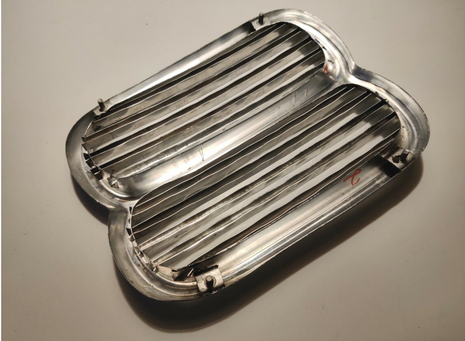

i have thought about taking a grille apart to polish the slats + cerakote them. i was planning to plane down a piece of wood to put inside the slat to minimize any damage while buffing. for those that have polished the fins, do you think it will work?

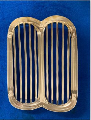

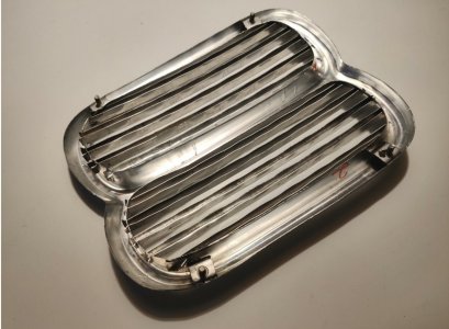

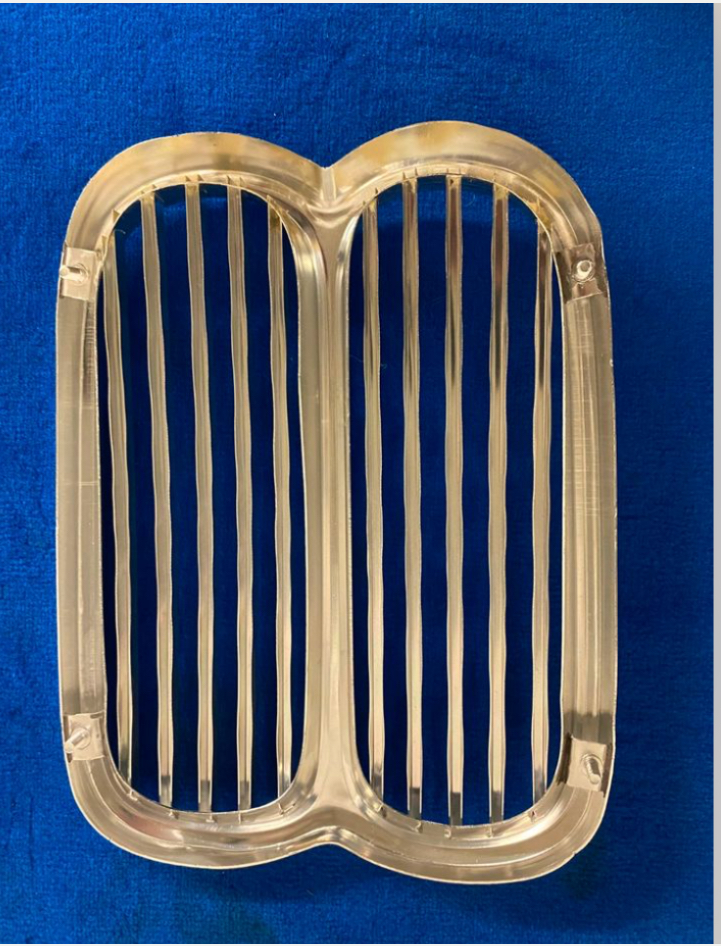

IMHO……The slats when seen from behind are all pretty wavy and uneven thus getting a wooden support to fit within the slat will not be an easy task. The pic is typical for a used grill. Even a brand new one (2nd pic) slats aren’t exactly even. The slats when removed are very flimsy and very easily bent/ scratched….

@Keshav, i have noticed the same thing ... but the ones i have tend to be a little wider on the back side. the wood (or possibly a metal strip) might be helpful to straighten the slats
Sure, worth a try…..I once tried to get the slats to look even from behind even though one cant see them, but the material is so thin and even the slightest stretching left marks on both sides..

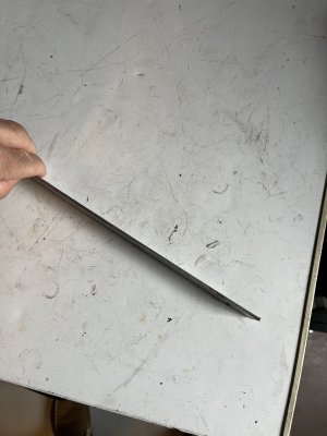

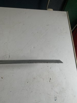

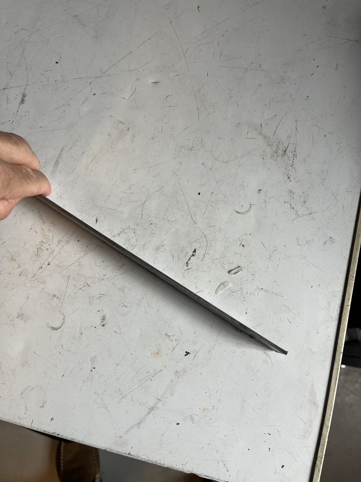

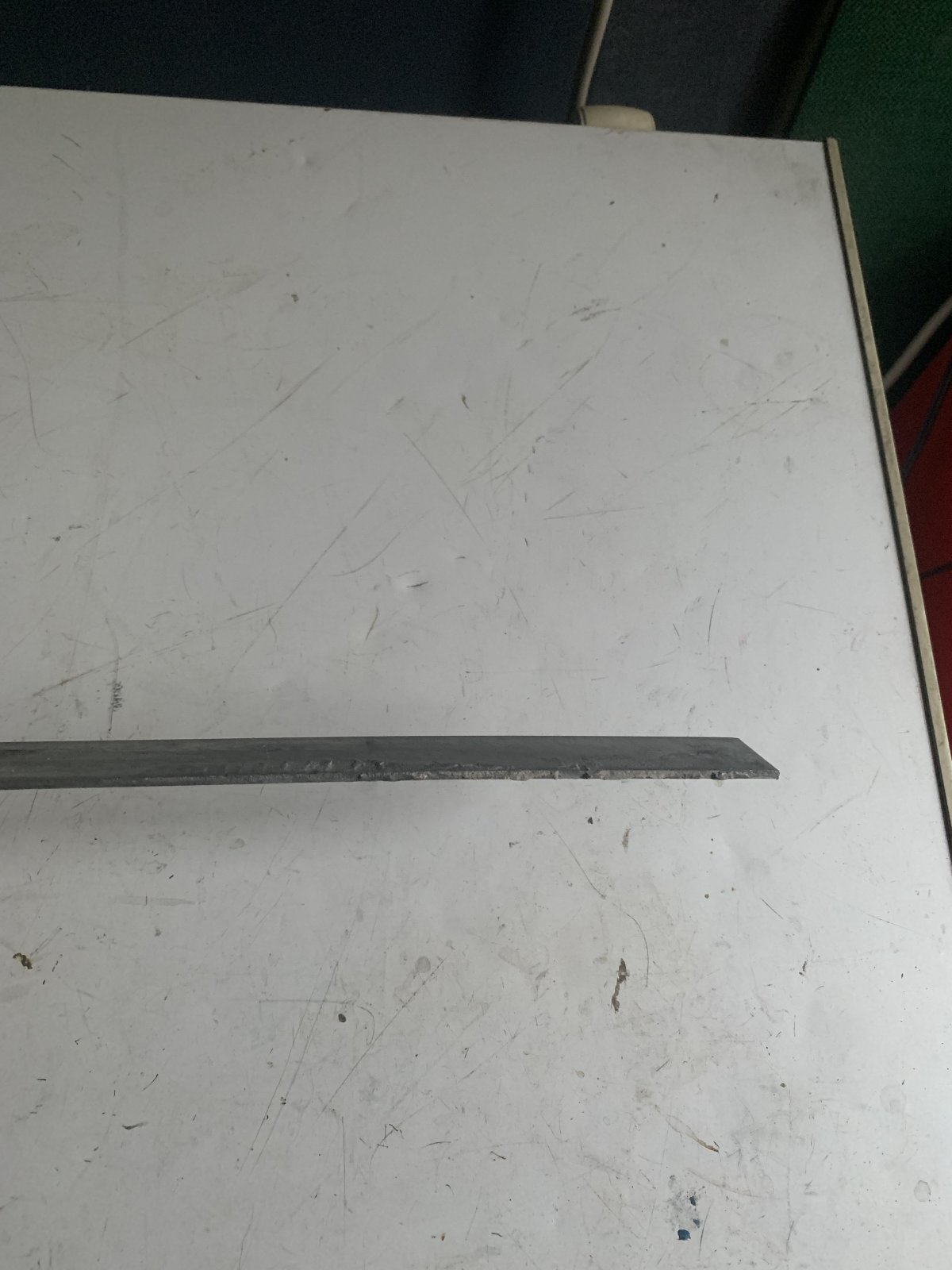

Make sure to have support behind the slats once you remove them. I lucked out and had this piece of metal. I recommend going to your hardware store and see if they have something like this. Not only did it provide support when sanding and polishing it also allowed me to pound with a rubber mallet the slats nice and straight. In addition you want to make sure you do not break the tabs and putting the metal inside the slat protects the fradgile tabs. Metal would be much better than wood if you can find it. If you do embark on this feel free to reach out to me with any questions, like all projects I wish I knen then what I know now . My cell is 650-740-6101
