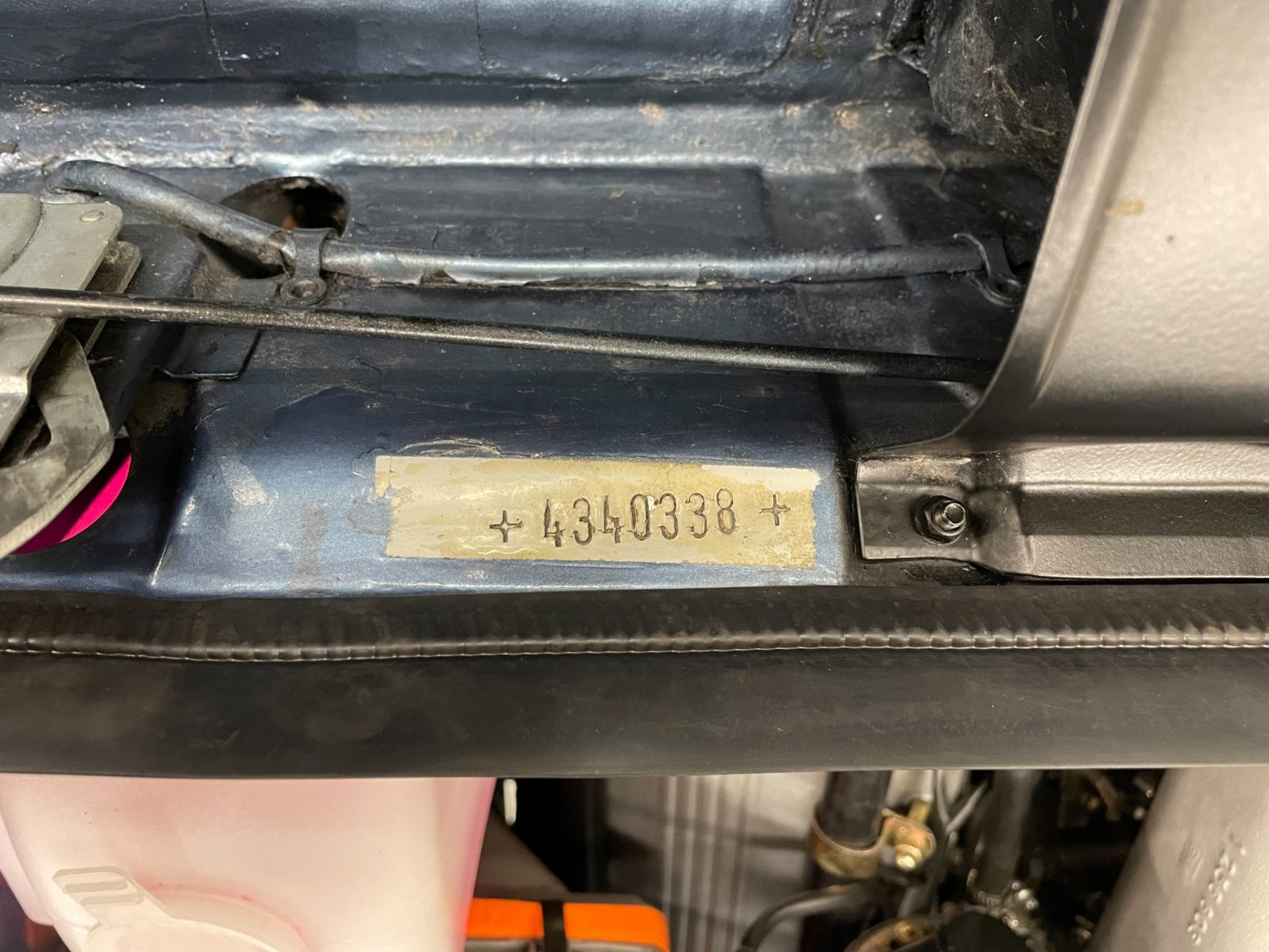

Let down a bit perhaps by the painted calipers and exhaust and other issues that could have been addressed by BMW Classic for the 25K€. I have never seen a four speed slave cylinder with a five speed trans either.

yes the VIN plate was a new one for me too. remember, this is playing for the BaT crowd where true authenticity or perfection is not necessarily required. some people will just pull out the checkbook and buy what seems to look appropriate for big money.

What’s up with the VIN plate?
VIN plate ? Yes, indeed. Why would a car with an apparently ,untouched’ inner wheelhouse (?)
have such a strange VIN plate (while original (blank) VIN plates are still available) ??

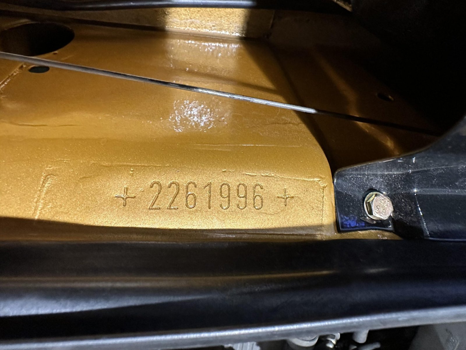

The chassis embossed VIN also appears to have a strange ,frame’ ??
hhmmmm…??

The “frame” around the chassis VIN is common. He is just one of 1,000 examples where the lines are visible.

The VIN has a raised area that looks like more than just paint.
Looks pretty normal to me, other than overzealous body filler. We’ve seen some bad ones. I still don’t know why fill the never needs to touch the cowl.
