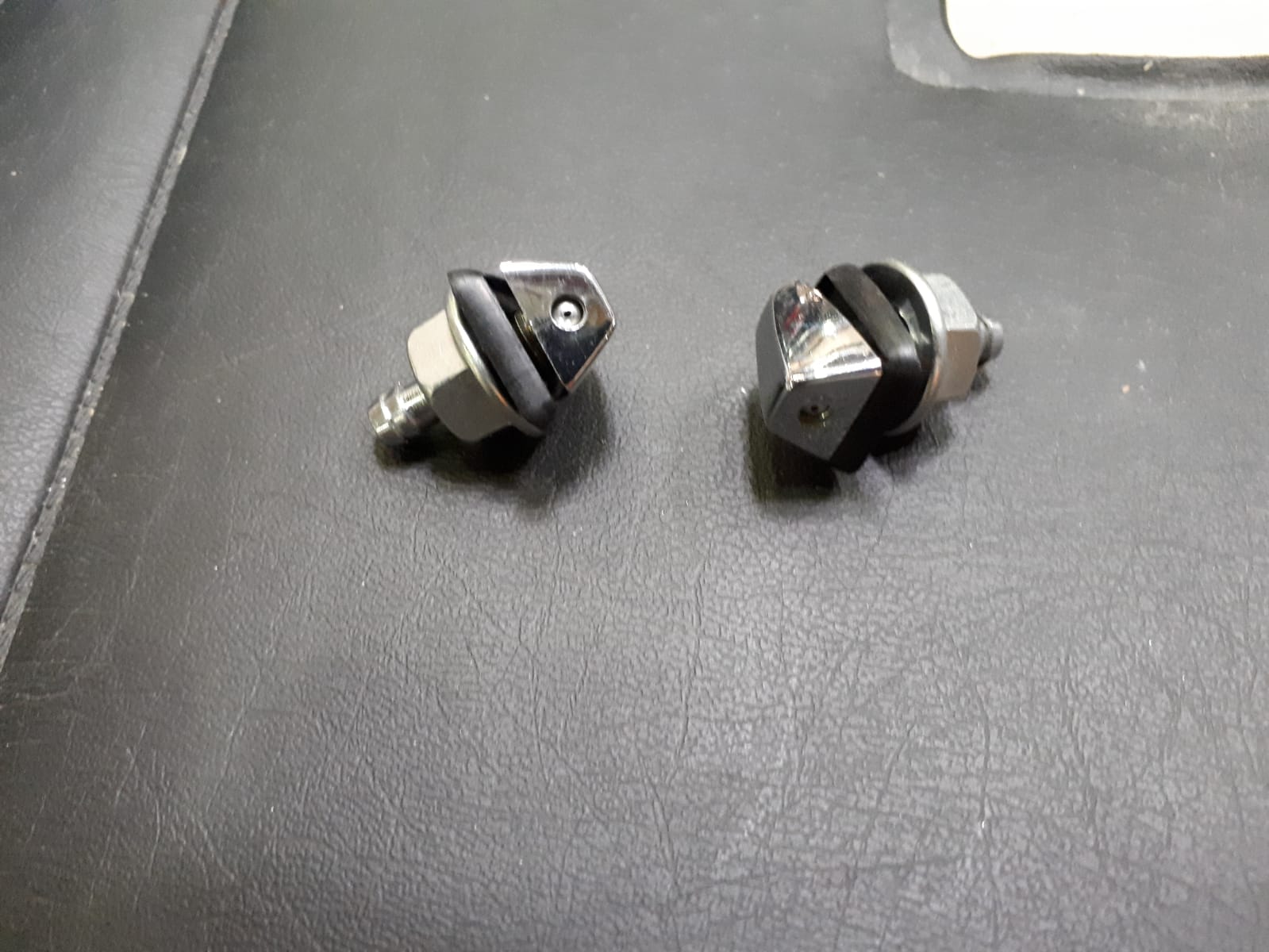

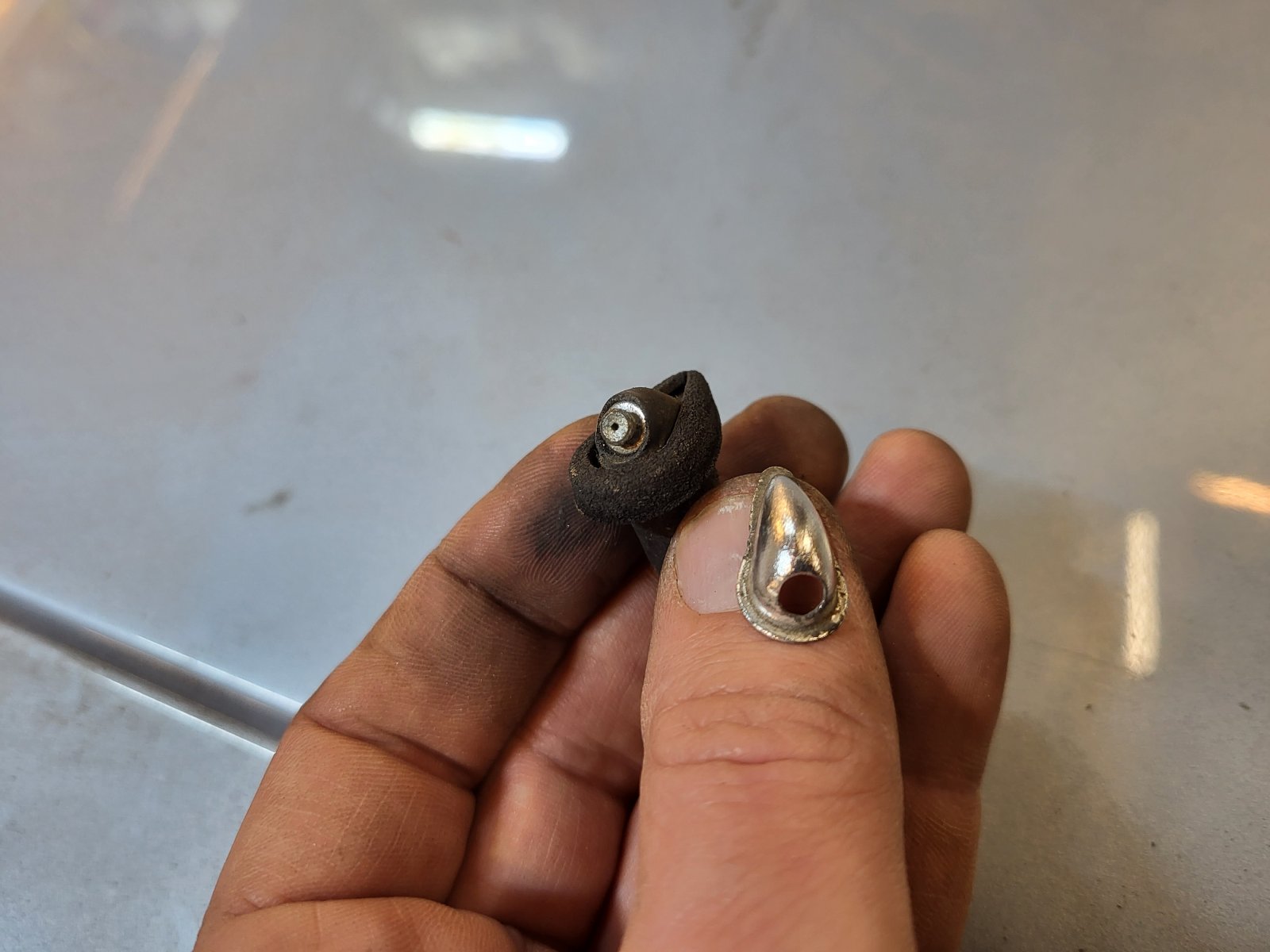

The original ‘chrome’ nozzles are made of solid Alu and not plastic ones with chrome ‘paint’….just saying!
That seems odd to me. BMW already had black plastic nozzles. They also had “chromed plastic” grilles. I don’t see how cast aluminum would be selected from a cost perspective. Also the nozzle posted by @Jon B is not aluminum.
Not mine and not for sale, nor the Alu head light covers…..
Solid aluminum or not, those are plated, and said plating is failing. It would also be the only chrome plated aluminum part on an e9. Lot’s of chrome plated white metal, chrome plated brass, chrome look plastic, and polished / anodized aluminum.
Don't know much about 3d printing but is this a candidate? Print them and then put the "stretch on with a heat gun" chrome? So small it won't take much material - maybe profitable?

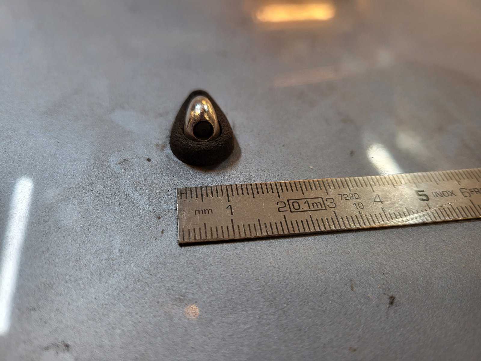

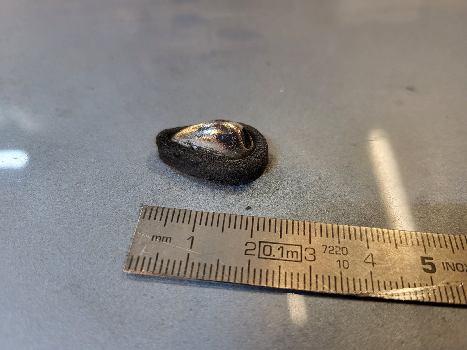

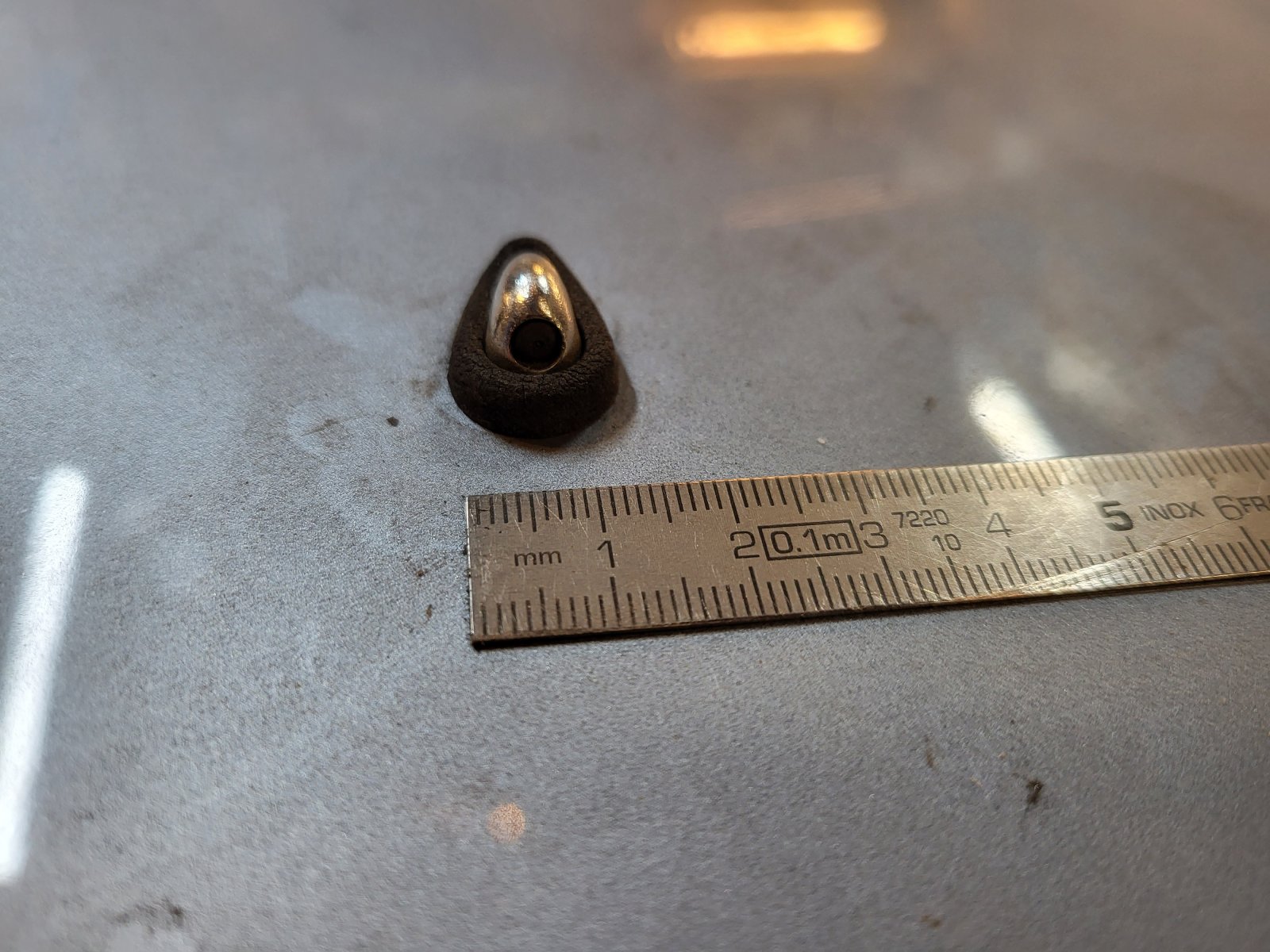

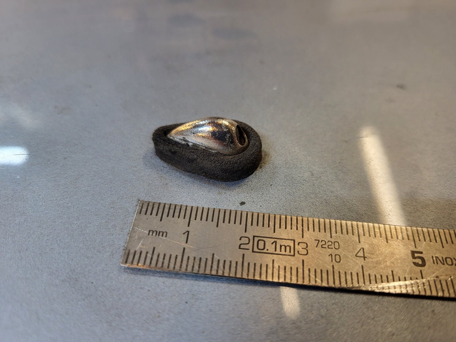

Just as I am standing next to them; my car has rubber feet under chromed pot metal washer jets. I am sure they are metal as they are bloody cold to the touch.

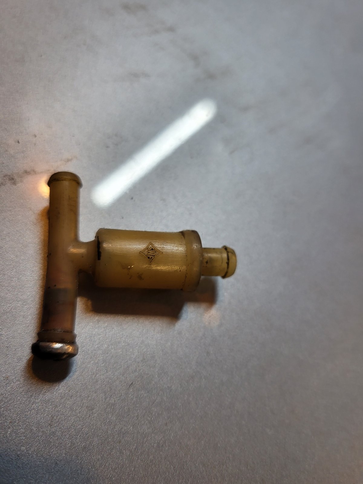

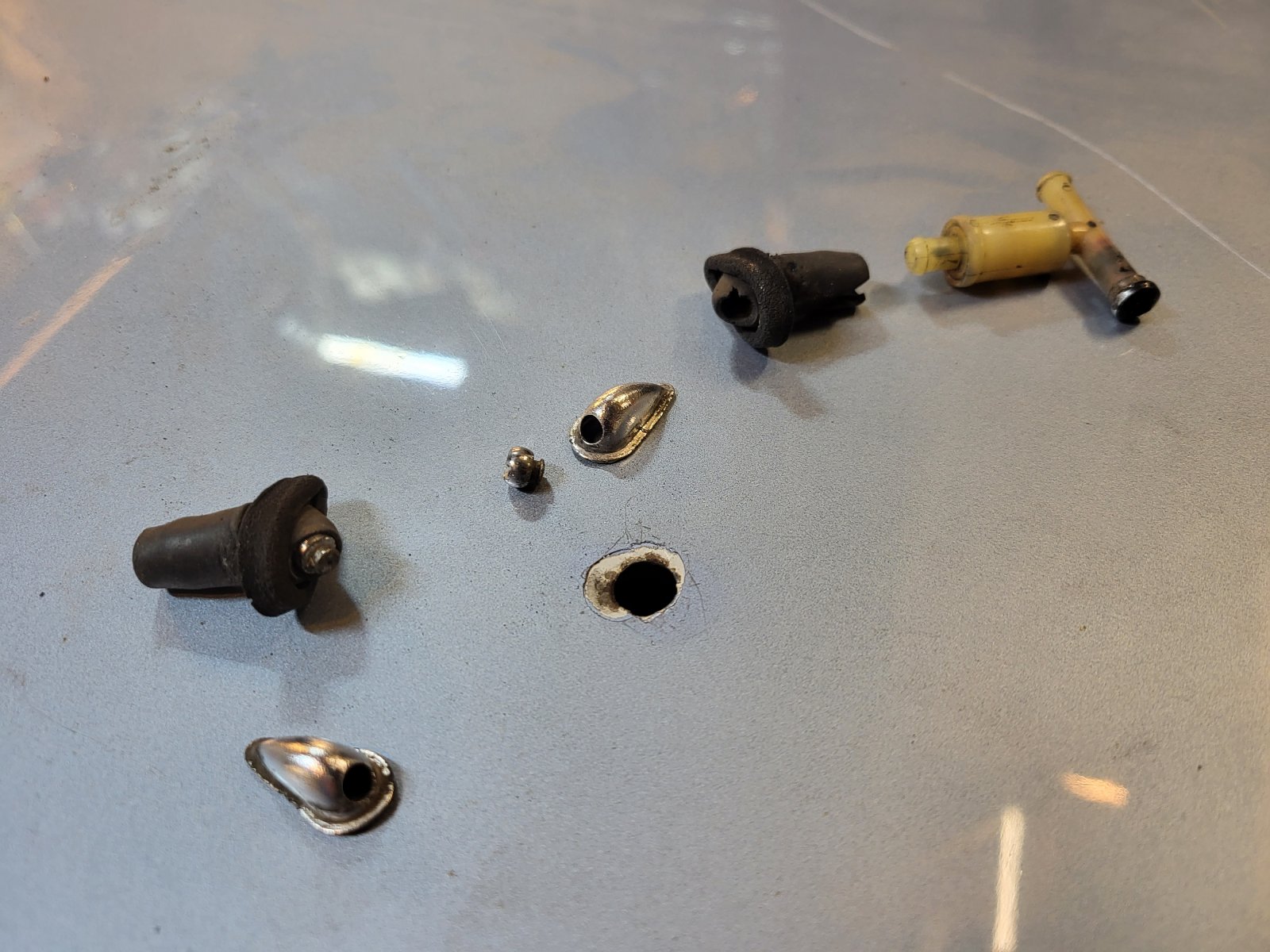

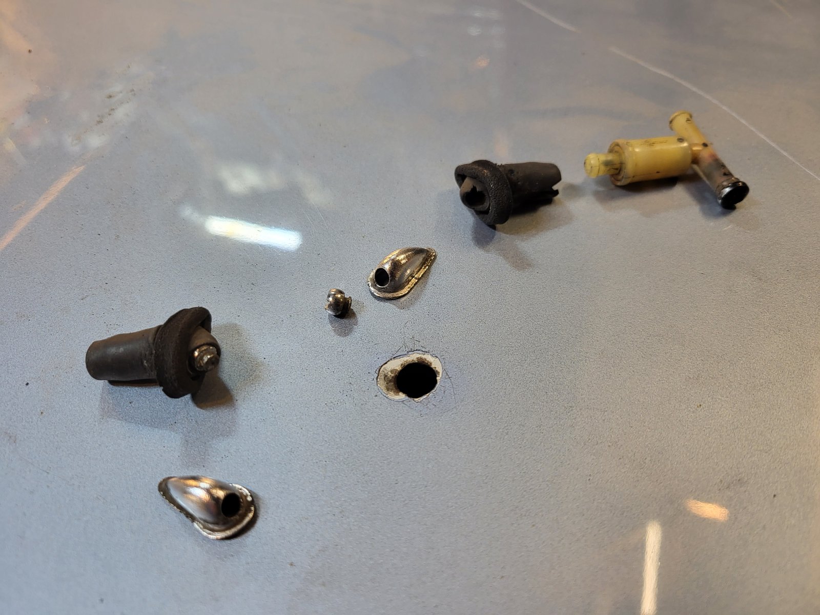

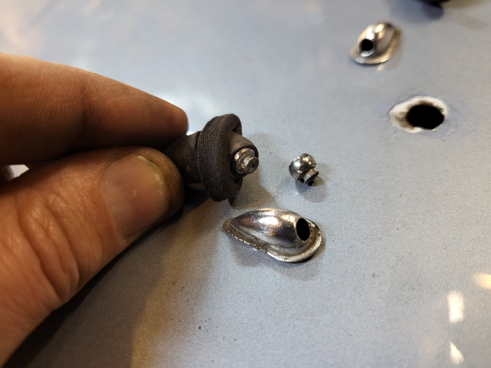

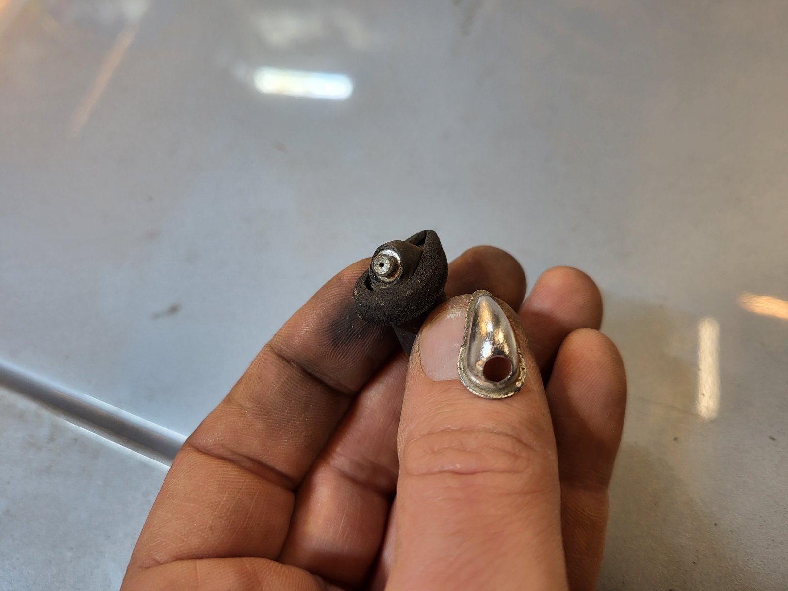

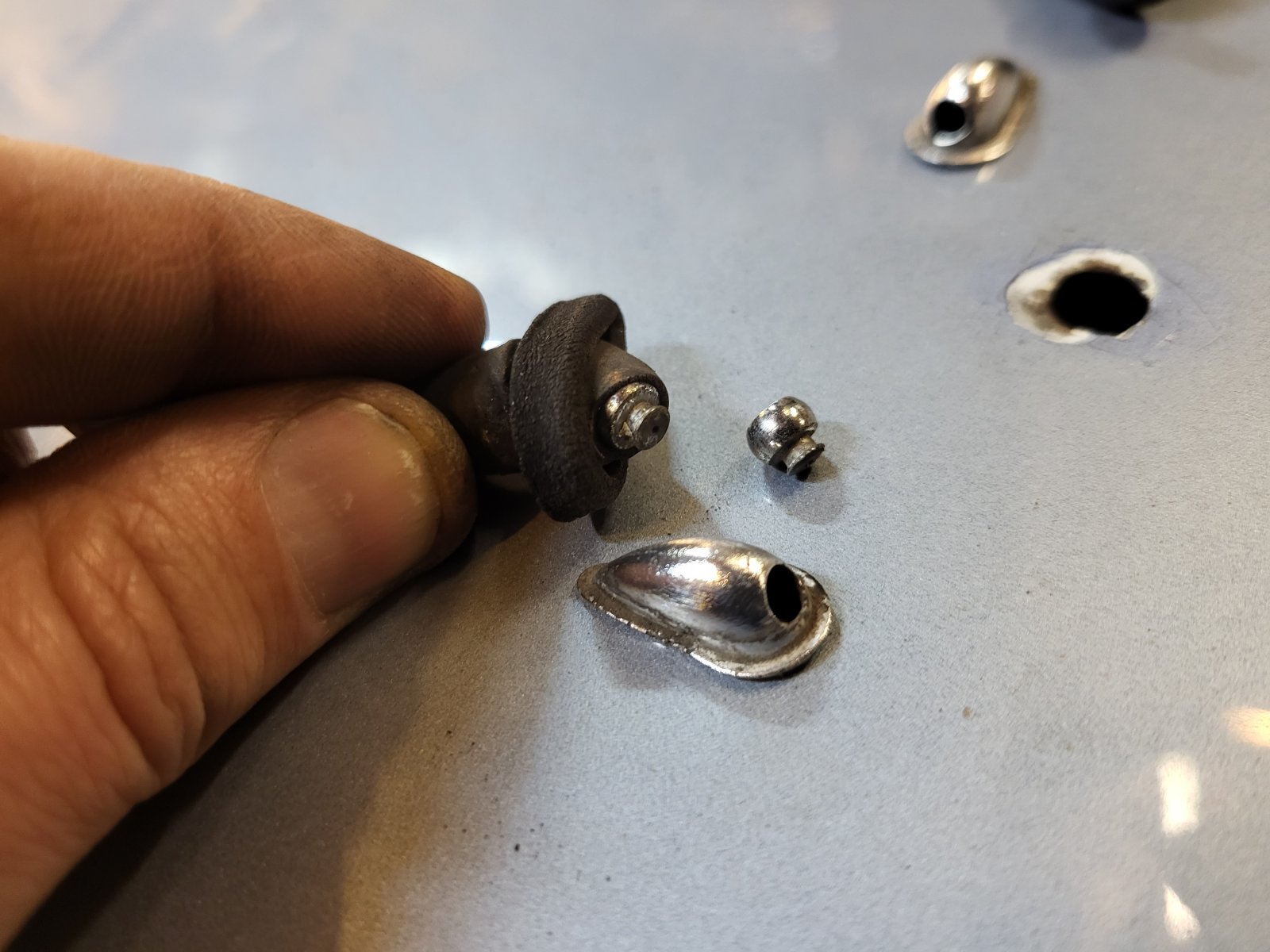

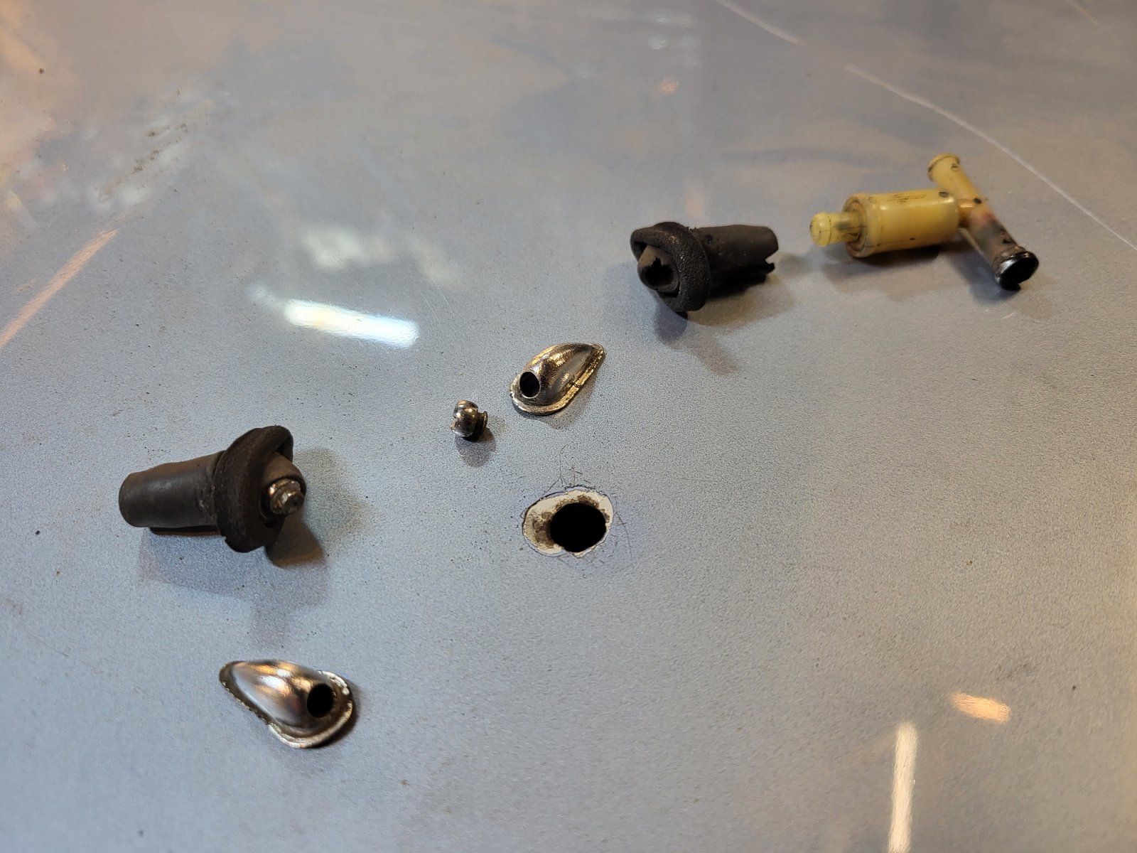

Ok, I just spent 1 hour to get them out. What a fight!
The main part is a rubber tube that inserts from the top of the hood. It snaps in place with a recess in the rubber that grips the round metal hole.

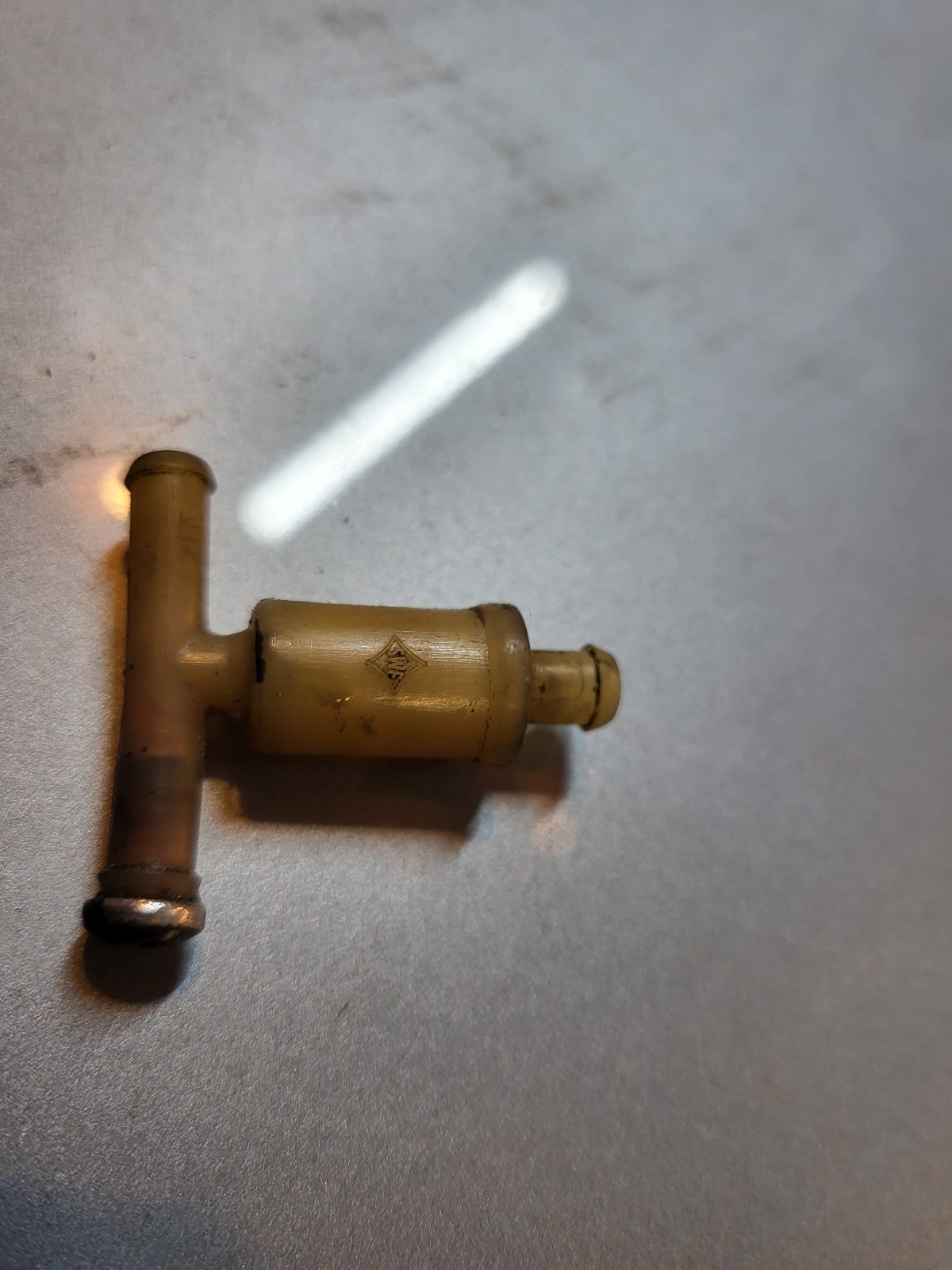

Below the hood is a plastic connector that fits in the underside of the rubber part.
At the top is a metal cap that can be pried off; it retains a small metal ball that is the actual jet opening. It's ball shape allows it to rotate inside the rubber part that fits snugly around it.
I am not sure if my rubber part is still water tight, as I gently tried to pry it out with 1 blunt screwdrivers, it has some nicks in the rubber which also acts as a conduit, so I hope I didn't poke through it.
The plastic part actually has a logo on it: SWF.
Anyone knows if this is original?
