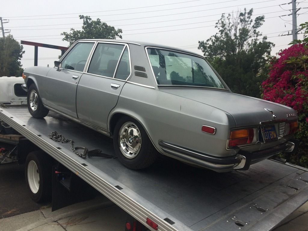

Going on the tow truck, most of the exterior looks like this. The bumpers are straight and the chrome is shiny. Pretty much all the anodized trim looks to be in excellent shape. You can see that the early cars came with gray headlight grills. The paint on the hood failed and there is light rust coming up. Fortunately this and the battery tray are the only rust that we've found on the car.

Clear or no clear
Initially we were not sure if the car had a clear coat or not. Visually it seemed to have no clear. We cleaned a section of paint and polished it. The paint shined up but left the pad a dark shade of gray. We repeated the same process inside the rear door on the rear wheel arch. Again the pad came out a dark gray. I called several people that have been in the bmw world a lot longer than I have and no one could give me a definitive answer and the internet left us in the dark... Our old service manager who retired almost 5 years ago worked for Roy Carver RR, Bentley and BMW as their service manager from the late 60's until Roy sold the business in '85. He was positive that in 1970 Polaris did not have a clear coat and that BMW didn't start using 2 stage paints until late '70 or early '71. This car is a 1/70 build.
So based on the fact that paint came off on the buffer pad in 2 sections, no one in the enthusiast community had a definitive answer and the only answer that I could rely on is from someone that dealt with these cars when they were new on the dealer level, the conclusion is that this car has no factory clear coat.
It's possible that it might just have something to do with what Hoffman ordered, too. Some of the anectdotes about quality I found were from people in Europe. I find it hard to believe that the clear would fall of that car and the interior would look like that.
I should add that no where on this car is there any form of clear coat failure. I would think that if this car had a clear coat that it would show the typical signs of failure. There isn't a single indicator.
