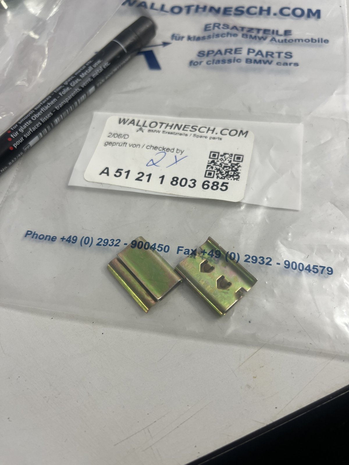

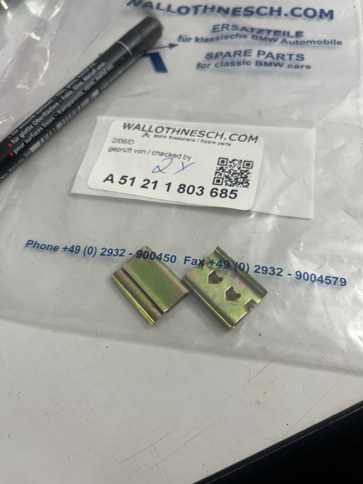

Did I turn clips as they should be? I tried to fit the door trim but clips are barely holding the trim.
eriknetherlands
2,768
2,006
Netherlands, Eindhoven area
If i'm not mistaking, then 4 small teeth should be present, 2 biting into the inside of your trim & 2 biting your door flange. The trim has a groove in it, and that (ofcourse) has two sides to it; I set one clip with the teeth oriented to the inside of the car, biting one side of the trim groove, the next clip with the teeth to the outside biting the other side of the groove, the next one again to the inside and so on. This effectively increases the width over the full set of clips, compared to teeth that are all oriented towards one side.
As they also scrape and bite into your fresh paint, I covered them in grease before putting the trim on. It's a source of rust if your not careful.
