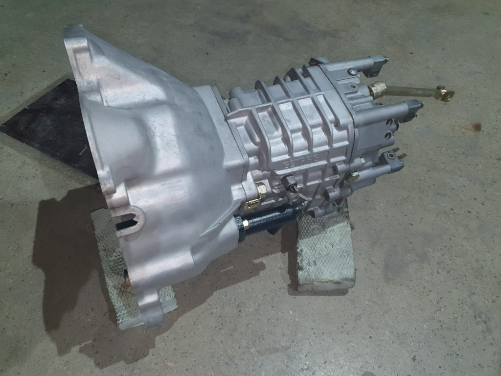

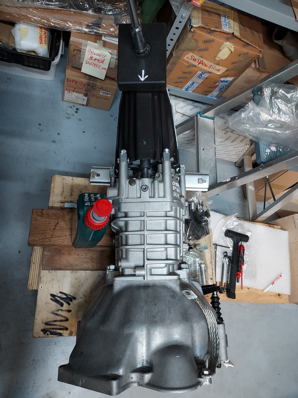

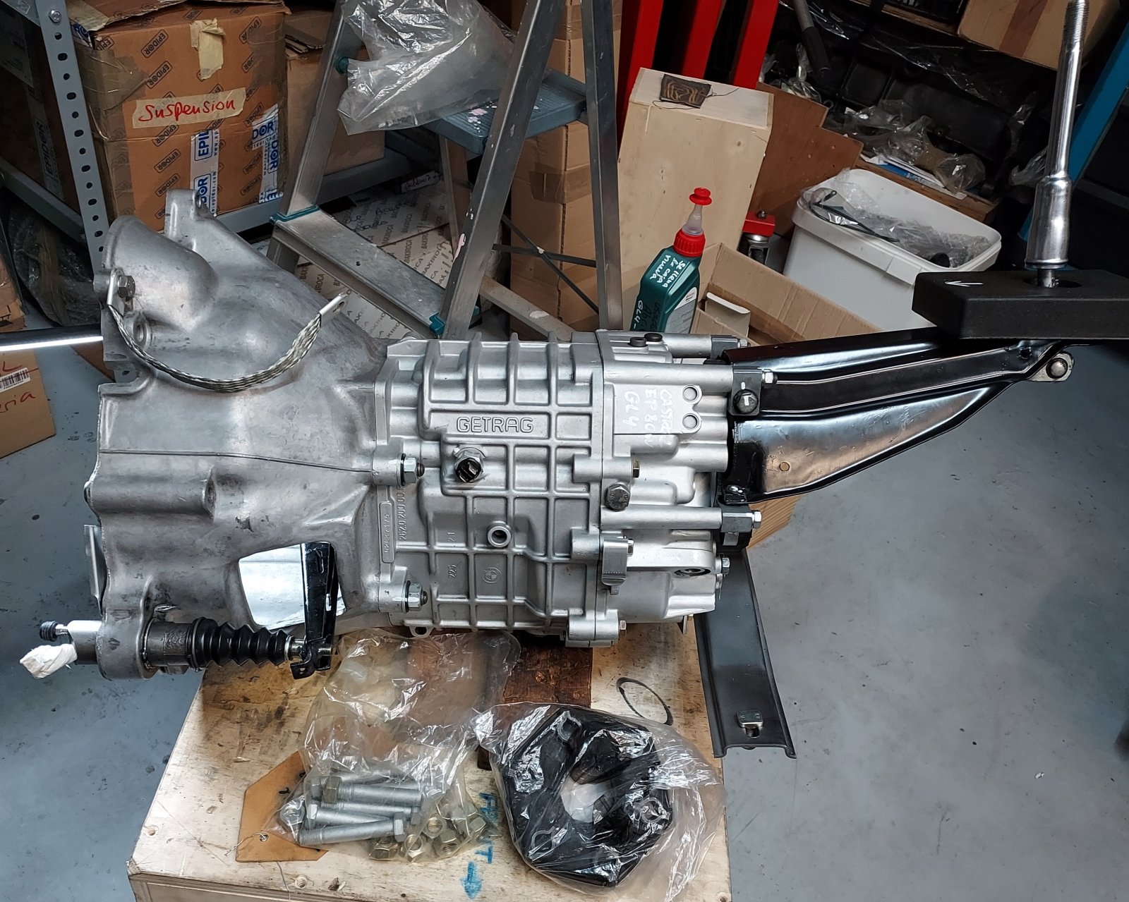

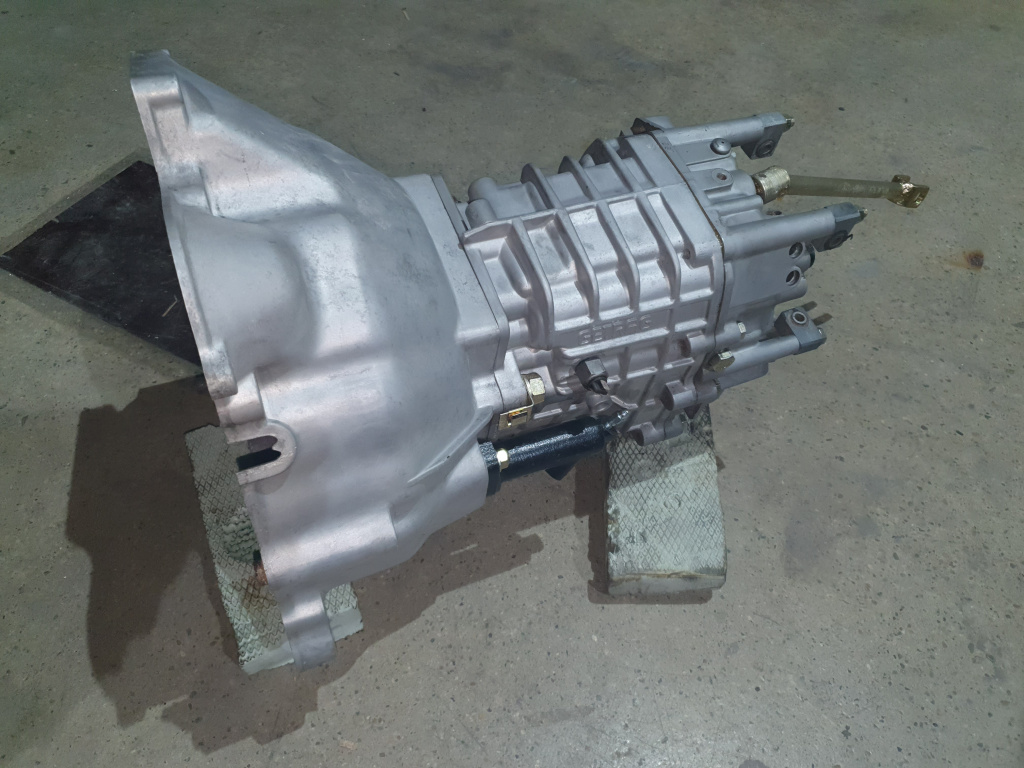

As some of you know, I switch from automatic to 4 speeds shift.
Got a late trans with closed bell housing getrag.
The question is, how is the "break line" and the hose between clutch cylinders are rooted?

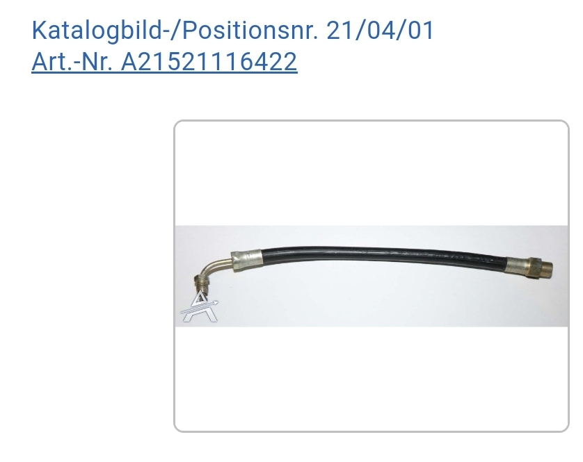

Think, I need a hose like this 21521116422 ?
And what else?
Pics how installed?
Thx for your help

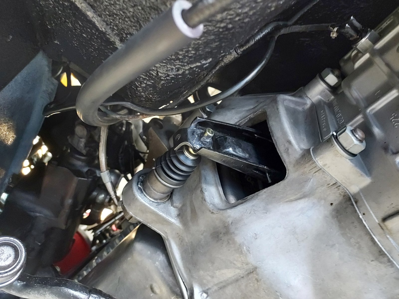

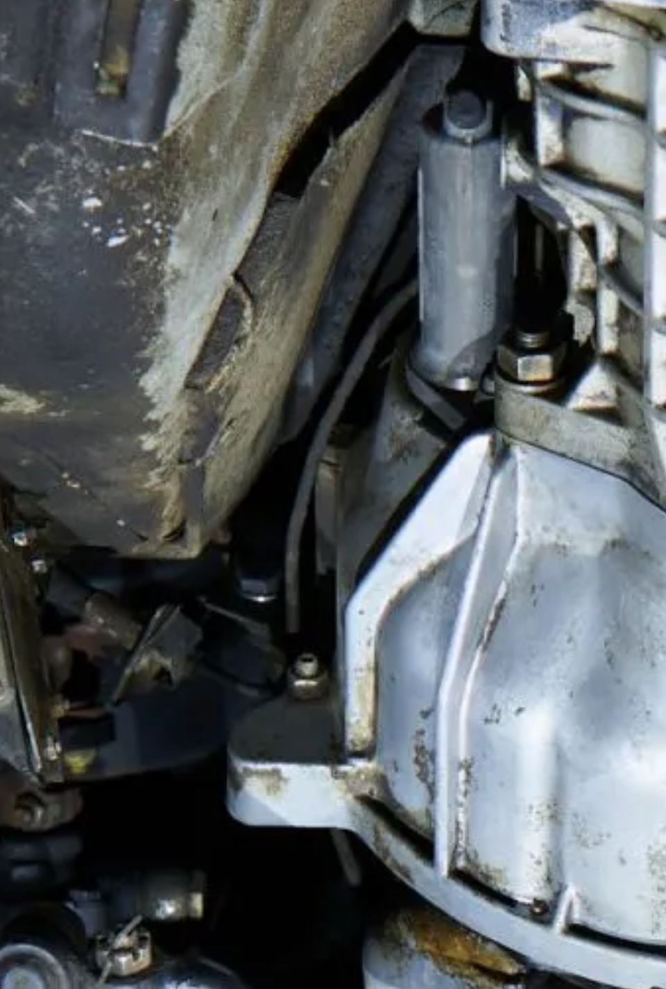

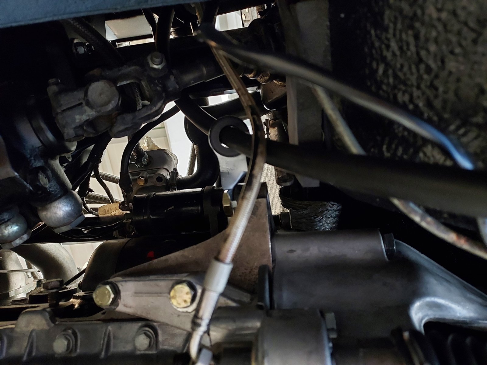

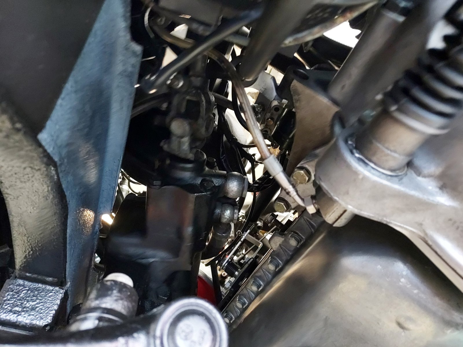

I took some pictures prior to disassembly, but they do not show the master or slave cylinder fully. You can see the fluid pipe that transits from the master through a guide bracket. What is shown is for a 1972 with original 4 speed manual transmission. If installing a 5 speed (which am doing), then a longer hose will need to be sourced.
Breiti
180
206
Mainz Germany
thx for the Pics, but is that a closed Bellhousing? it seams like it is a open?
I look for the late version with closed bellhousing.

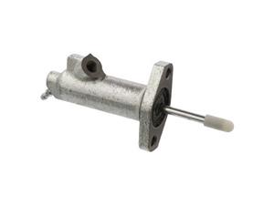

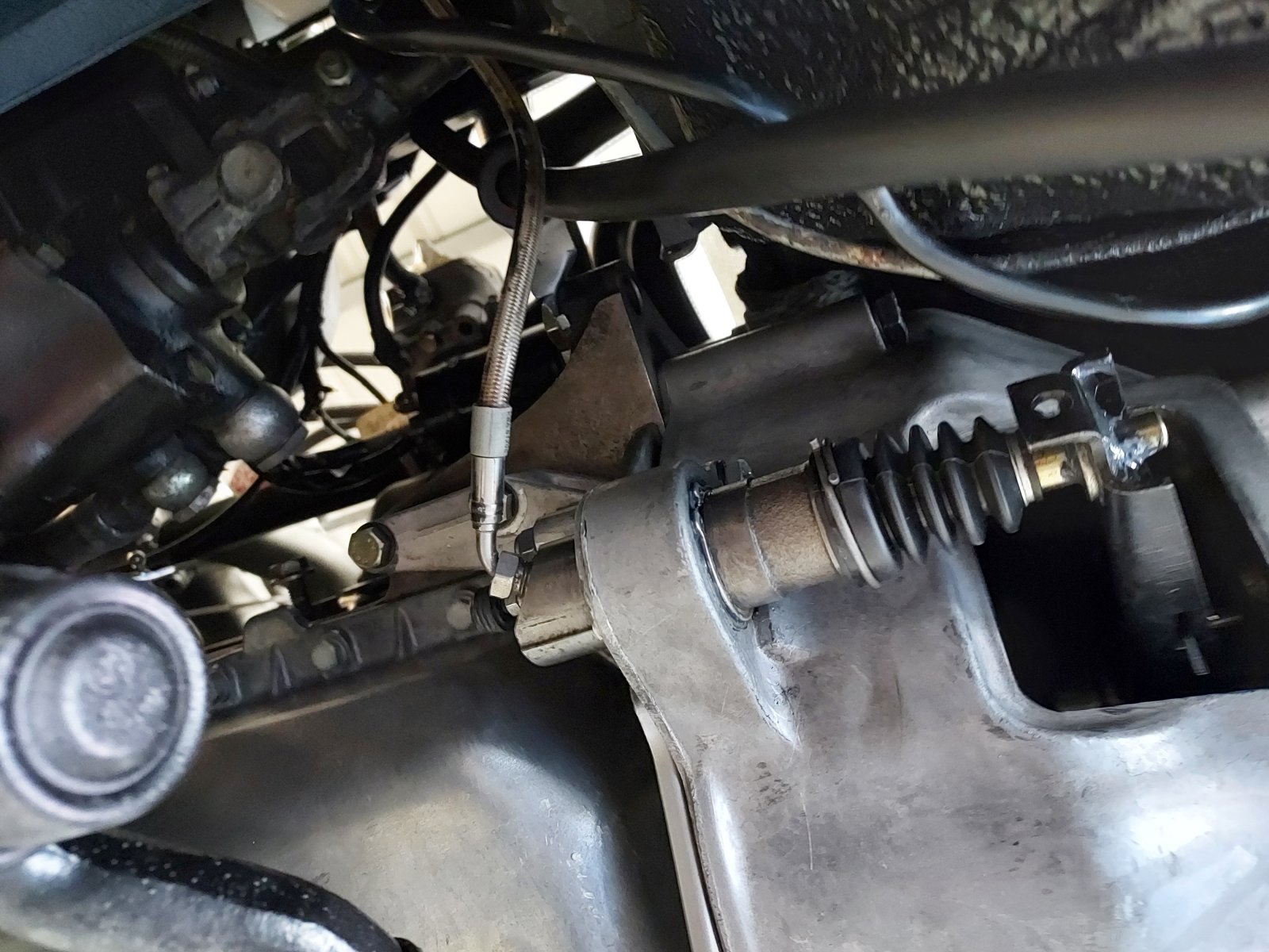

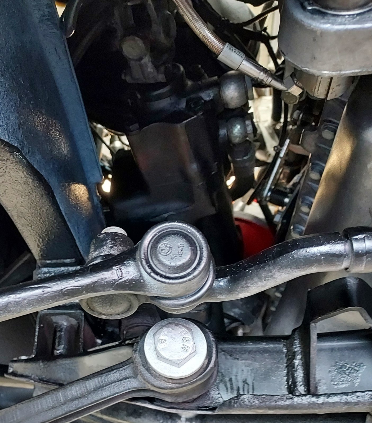

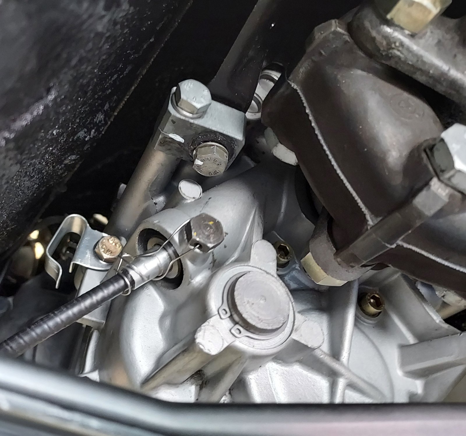

In my shop we use the '74 slave, the e12 master from RM european and La Jolla Independent stainless hose.
175.00 for all three......
Clutch Slave Cylinder
$18.46
Part Number: 21521157212
Part fits: 1980 BMW 528i Base Sedan E12 2.8L L6
