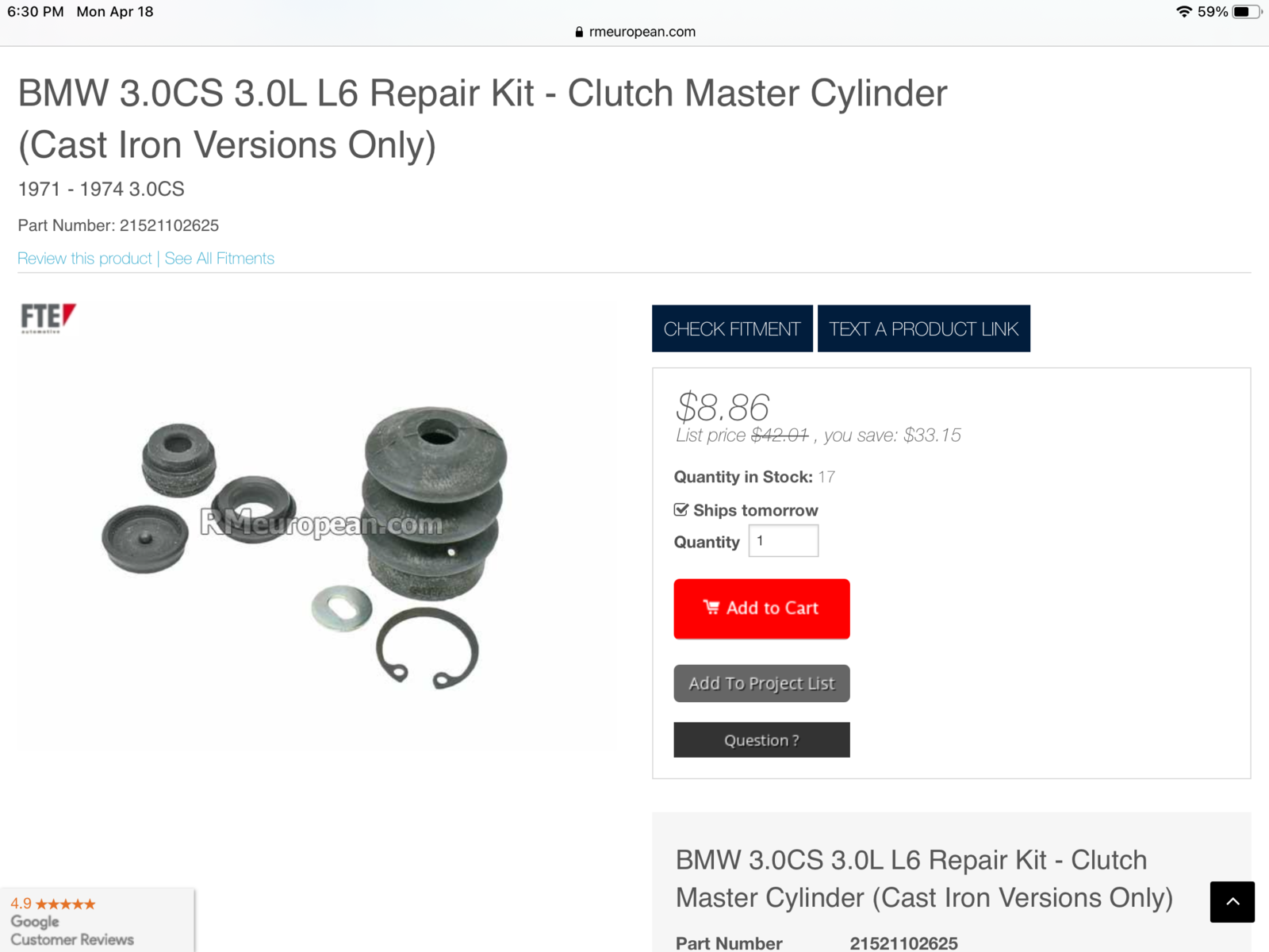

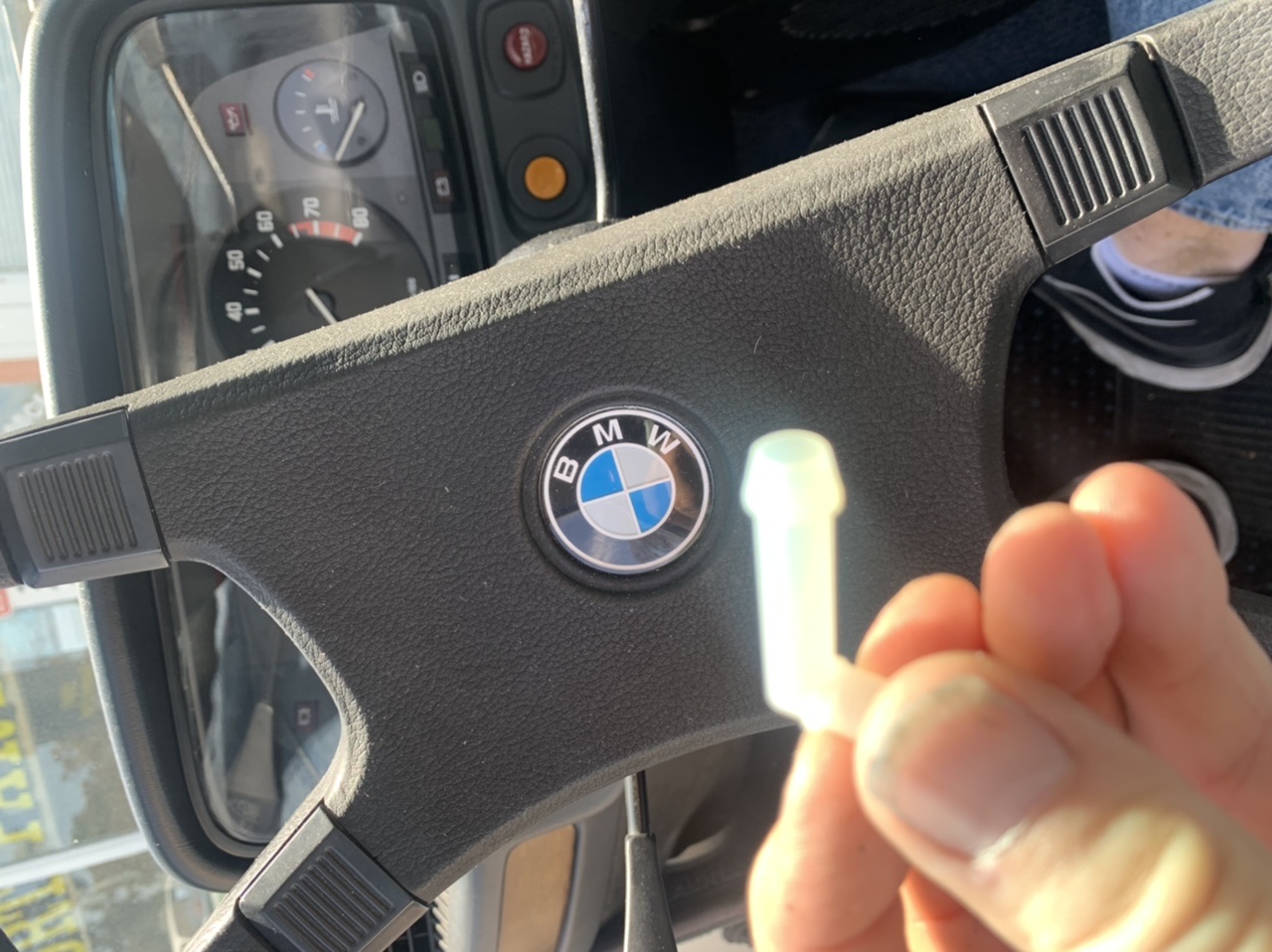

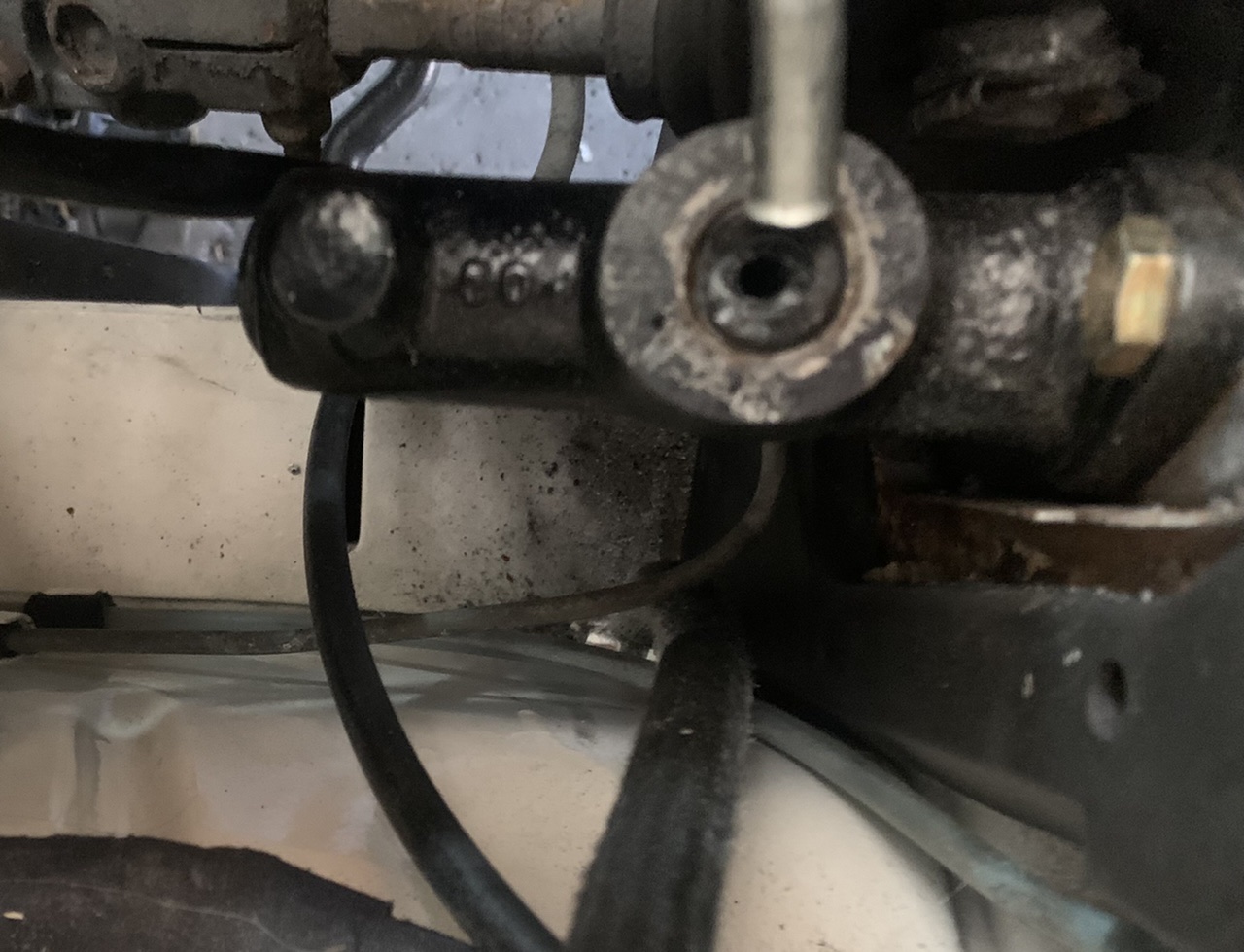

I give up, literally! I am so frustrated that the clutch pipe won’t fit into the new grommet on the clutch master. I filled down the flared end, I bought a plastic nipple as used in the brake master as Don suggested, neither one works as they still look to be twice the diameter. The rebuild kit was $40 or 50 from BMW and had to come from Germany and took two weeks.

did you try installing the pipe into the grommet then both into the cylinder as a unit? I also think there are 2 different sized grommets out there.
