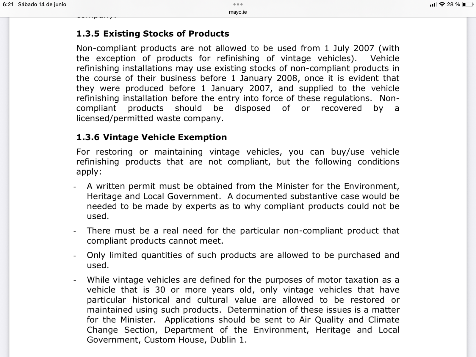

Thank you for this info, but it IS TRUE
you educated me in the exceptions, which I didn’t know
Now I found it for ireland….

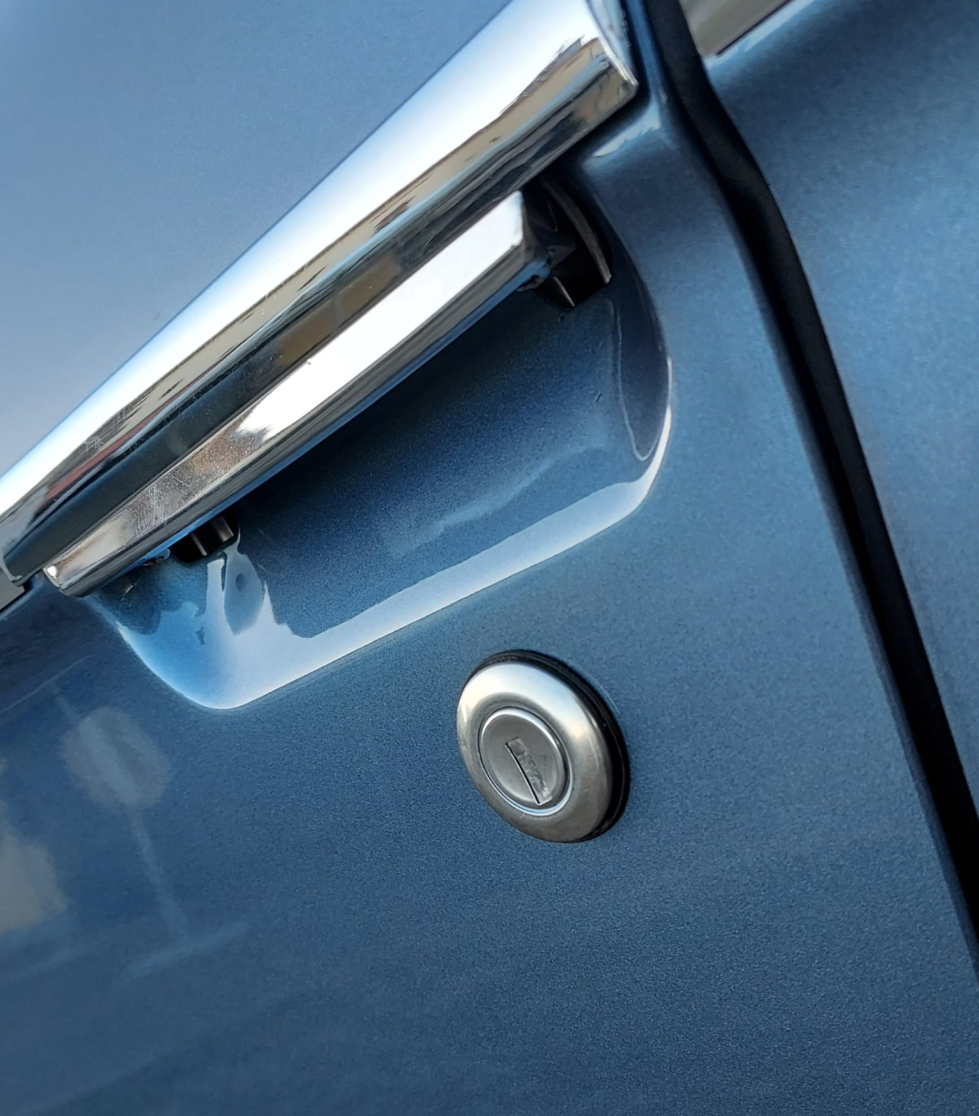

Mine was done water based, paint looks quite nice, and it is a complex colour
I will have an expert witness this in a couple of months and he may report back, I am no expert,

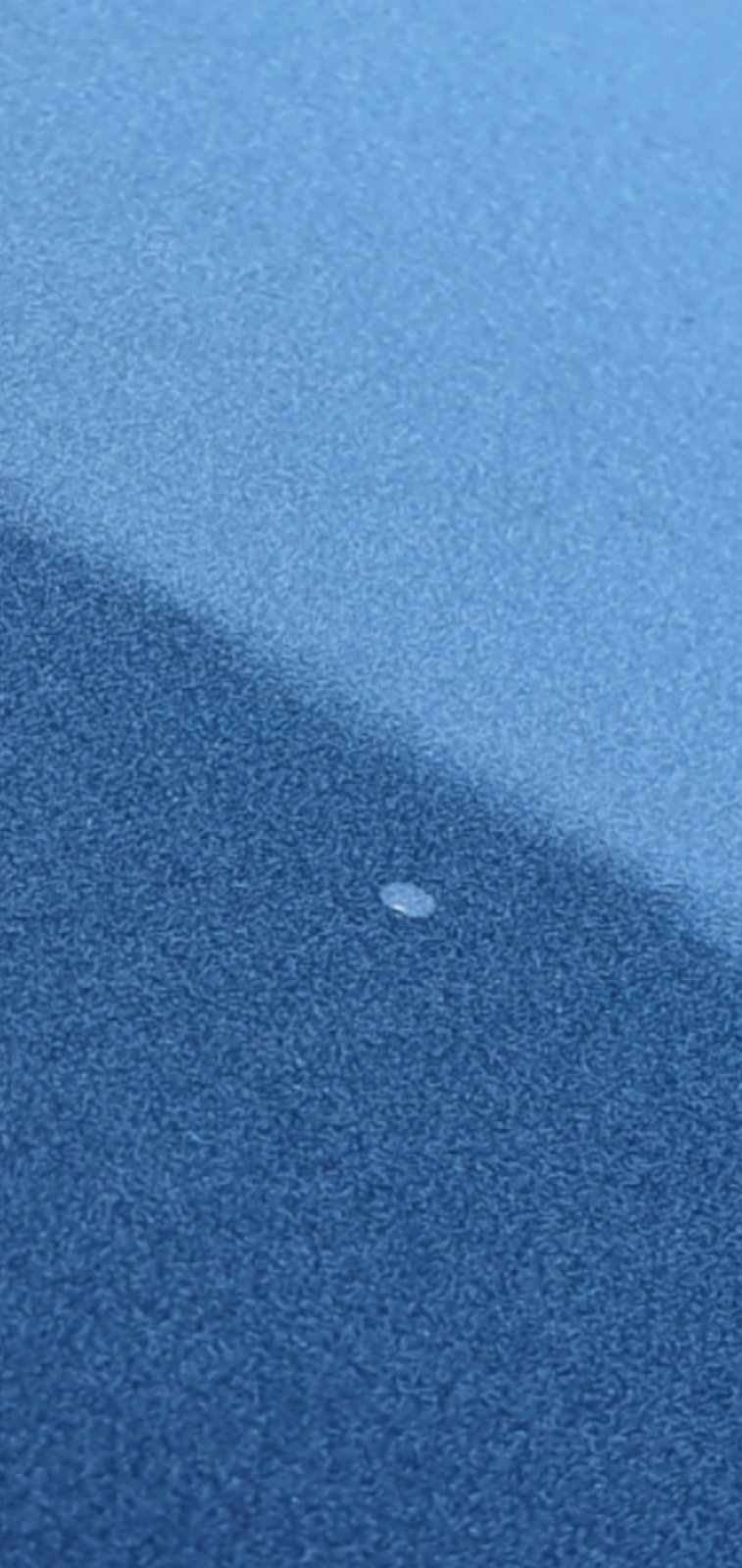

this bad?
Hmmmm,
Pros tells me that the metallic particles stand up better in the clear.
I would say, I don't see a different now, but those are only pics.

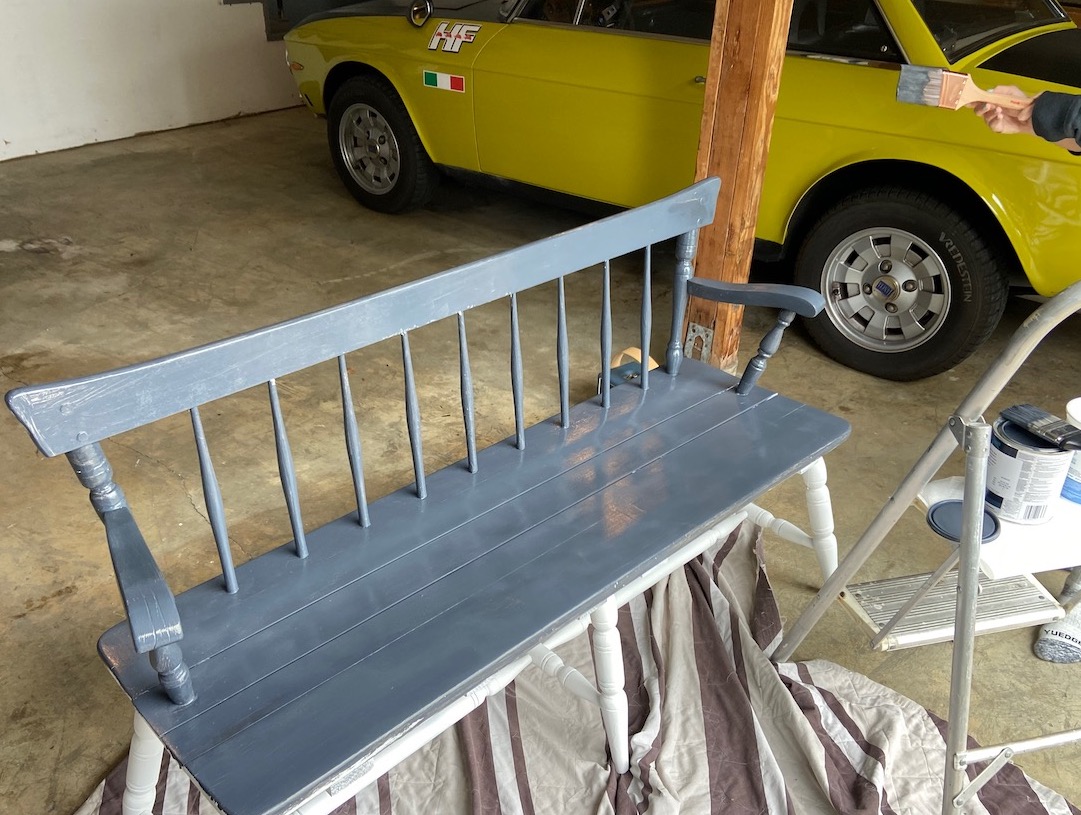

It would be nice if painting a car was as easy as painting a bench so I could do it myself. This bench is the color I would paint my E9.
