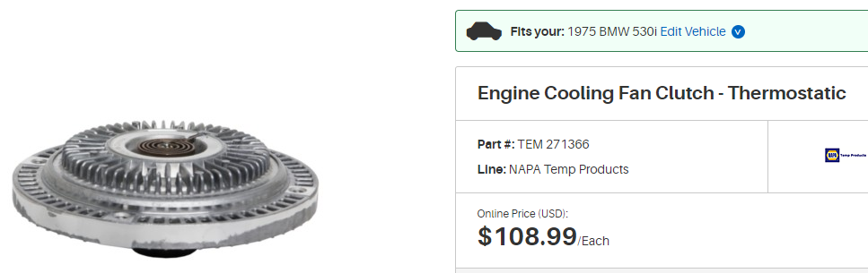

Thanks all. I was glad to come across this string which is helpful despite it's age! My 1969 2800CS 5-bladed fan shows evidence of being locked-solid in 2 different ways. Time to make amends. Don, is this NAPA fan clutch below, the style that you recommend with the spring in the center rather than the poly-metallic strip across?
https://www.napaonline.com/en/p/TEM271366?keywordInput=3.0cs+fan+clutch&vehicleAddPDP=true

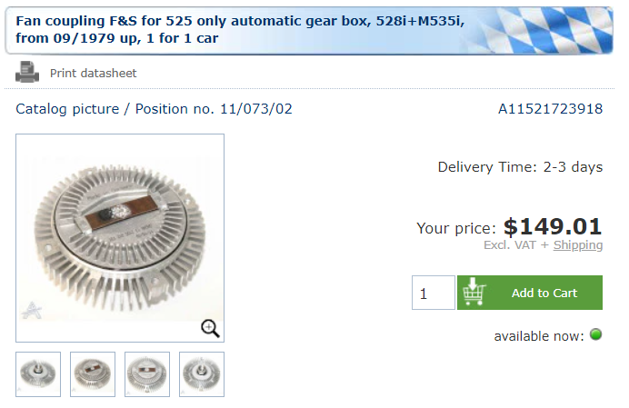

It appears to be an alternate for the early 5 series like this from W&N:
https://www.wallothnesch.com/en/fan...5i-from-09-1979-up-1-for-1-car-11-073-02.html

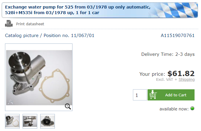

And both would use the newer style water pump with the thread-on Vs bolt-on fan mount? (probably available elsewhere than W&N for better shipping costs for US)
Thanks!
Nope- everything has changed!

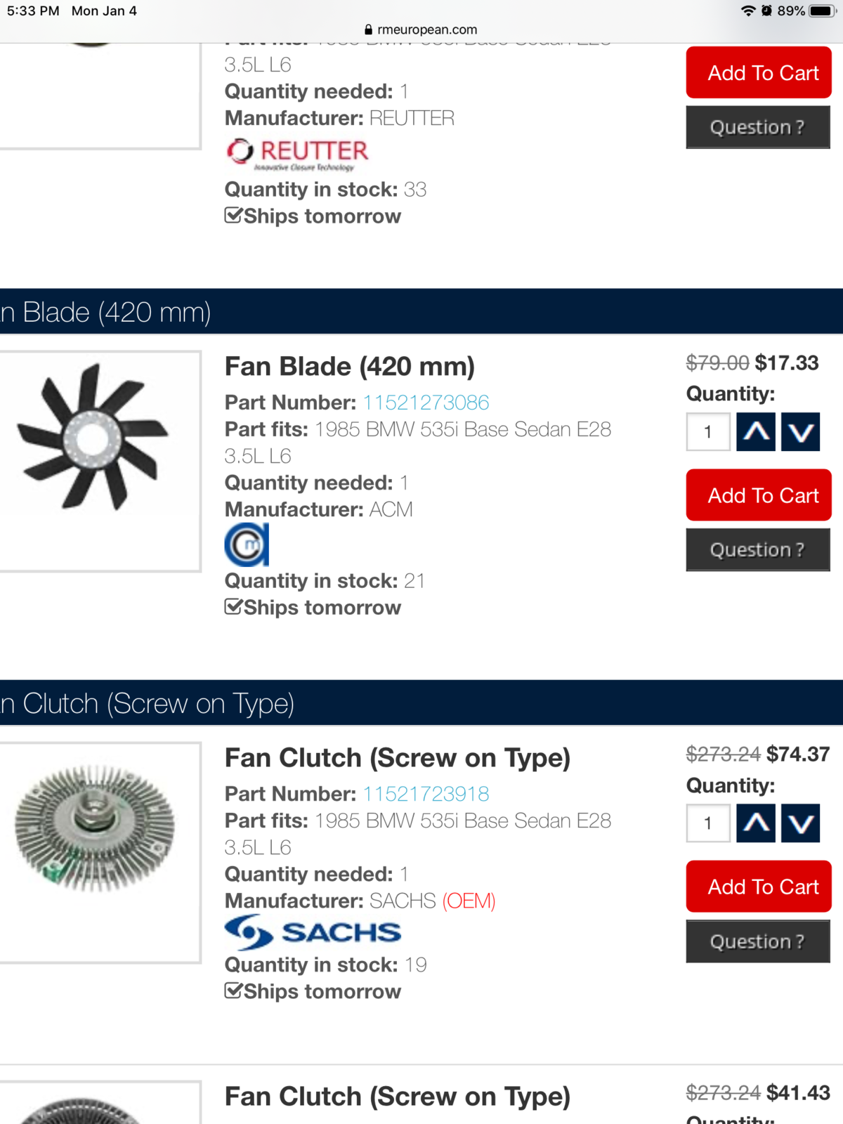

Rmeuropean
