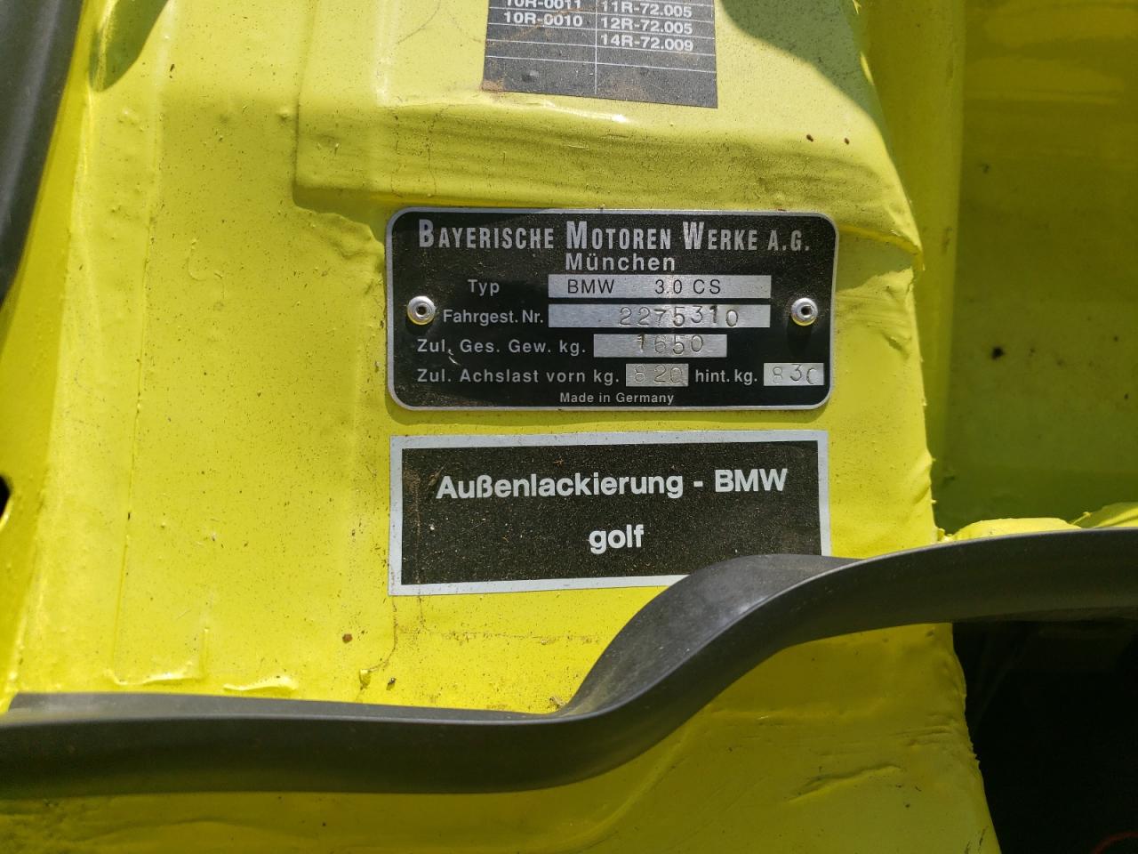

The VIN is 2275310.if somebody looks at this, send me the VIN
It also looks like a reproduced plate. It looks new and the stamped numbers are not lined up. Maybe not the correct serial number? It would be good to see the other SN locations.thanks i have now added it to the ancestry project. the VIN doesn't look like its in the original position ... me thinks it has had some rust repairs and they drilled new holes.
