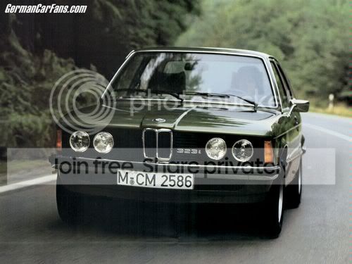

all these plates are new styles and not what they would have been in the 70's though
they had a letter for the city first like M for munich. then a seal and then a couple more letters and numbers
kind of like this
no blue area at the left...that came in the 90's and no red area at the left.... those were export tags

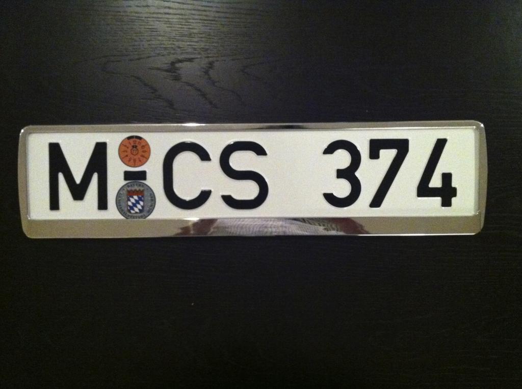

I just had this rear plate made from licenseplate.tv. They seem to be the only folks that had the vintage font. About $80 including the stickers, frame and shipping. 7 day turnaround. Sure hope I got this right. M for Munich along with Munich sticker. 374 for the production (March 74). TUV for 1977 (first renewal 3yrs after manufacturing). Color correct TUV for 77. I think these were supposed to be metal disks, but I couldn't find those.

That´s spot on period correct.
Except for the tacky chromed-plastic plate surround. Such tastelessness hadn´t been invented back in the 70s.
70s correct german mounting would be without a surround but with two bolts / screws (centred) going through the plate to the mounting holes.
On the front two bolts through the plate (upper lip) on then through the bumper holes with a special reinforcement rubber strip (still available, I believe) and otherwise bare.

Great to hear I got it right. Ill take that chrome strip off. For some reason I could image it being used back in the day.
Now I just need to figure out how to mount this, and the US plate...

Does the plate come holes pre-drilled for mounting?
