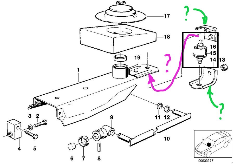

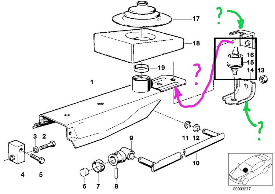

That is the problem and there should be a rubber spacer sandwiched between.
Don and @hbchris , attached is the closest diagram I could get to the Getrag. Is part #15 (boxed in black) the bolt and spacer we are referring to? ie, is the spacer this size? I ask only as I need to drive the car tomorrow night and won't have time to get the actual part. I may have to improvise.

SOLVED! Thanks so much for the workaround w sway bar rubber doughnut. The bolt w spacer seems to have been the main culprit. The platform bushings didn't seem that bad. I left them alone. Do them when there is time.
I do notice now that if I am in third gear take my foot off the gas the stick moves back about 1/4 of an inch. (?)

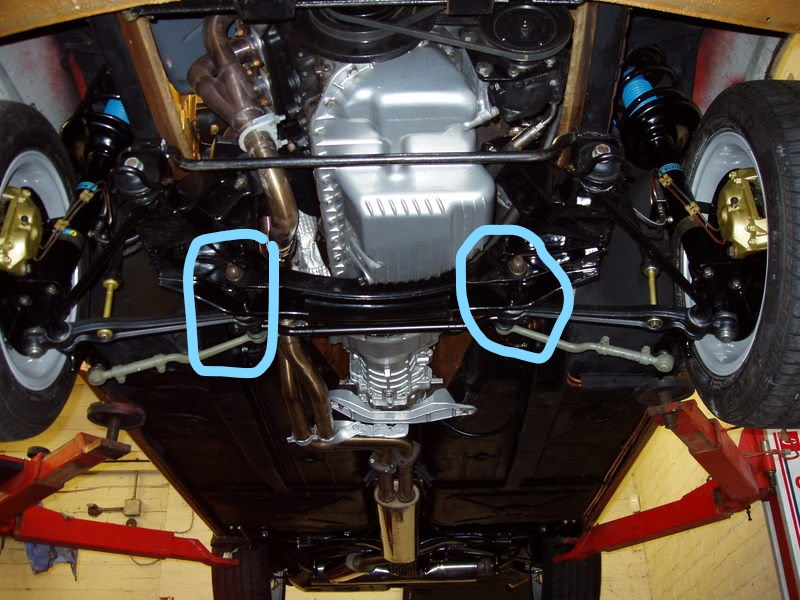

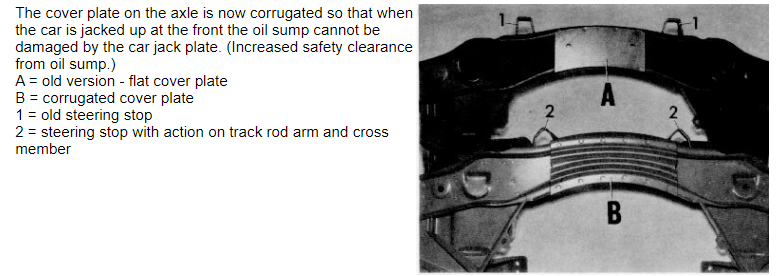

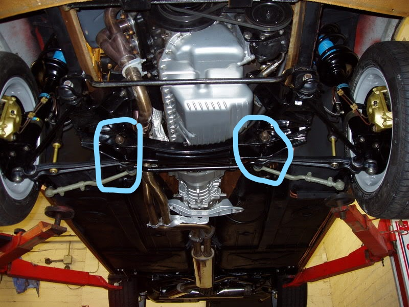

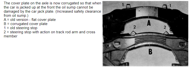

For other newbies out there: I used a low profile 3 ton jack (my springs are lowered - a regular 5" jack will not fit). With two 3 ton jack stands. I jacked it up from the front and in the middle on the corrugated cover plate of the axel. As recommended by @eriknetherlands ( https://e9coupe.com/forum/threads/best-lift-points-to-hold-your-e9-up-in-the-air.39594/ ) do not do this if the this cover is flat rather than corrugated see attachment. I put the jacks on on left and right on the subframe ( see attacheched). Also I have a spoiler. Even the low profile jack would not clear the spoiler. I used 2x4s under each front tire. Worked great.
