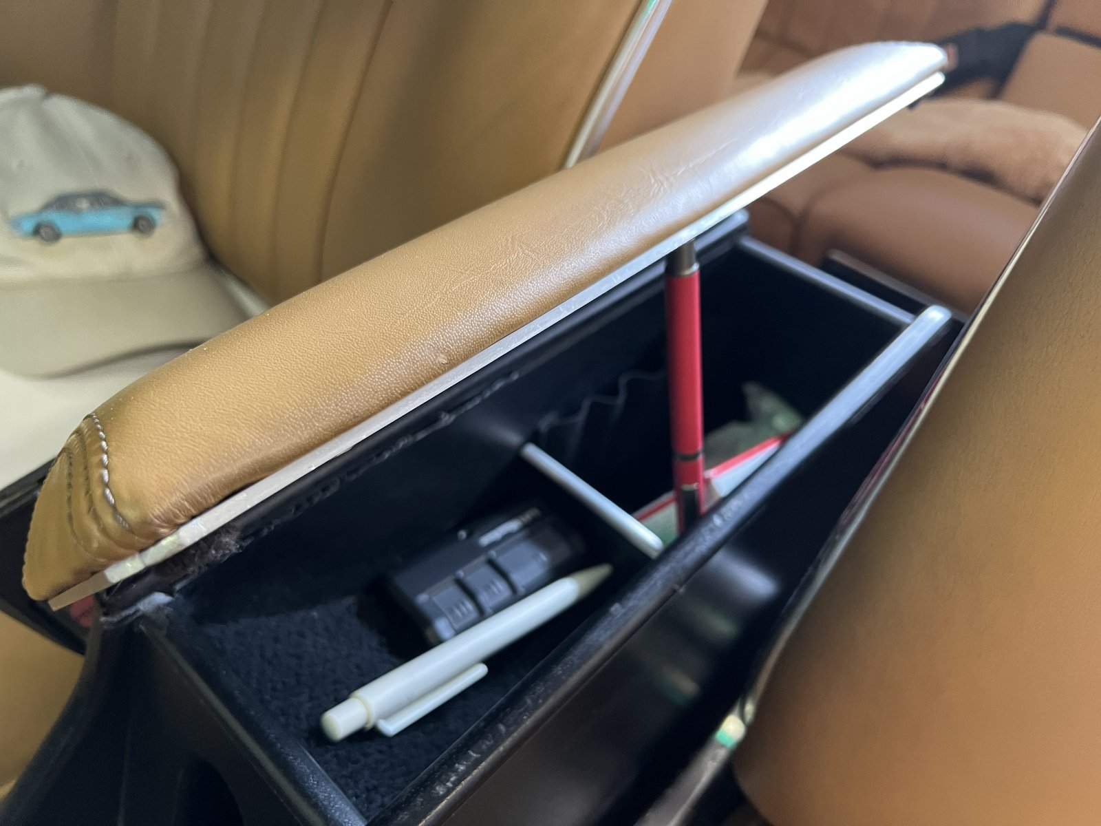

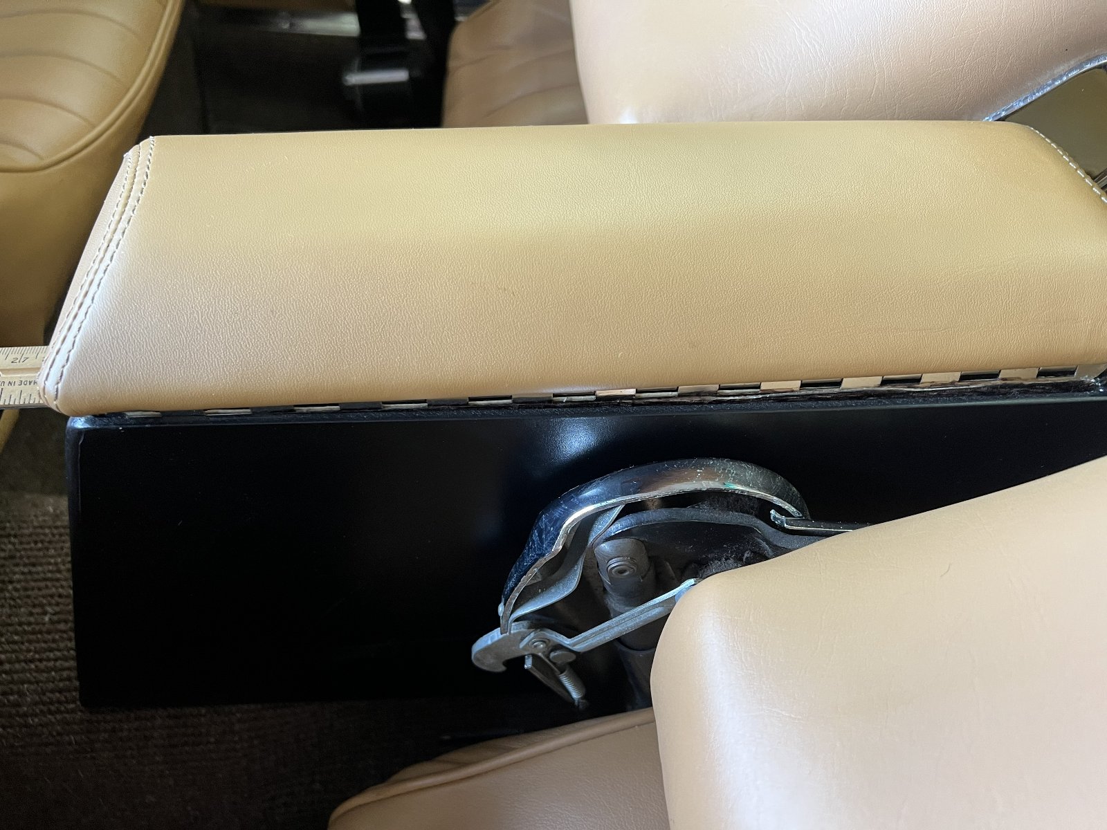

say hi to Eric for meI'm meeting with Eric (Anton) on Thursday so will see what items/options he still has from his design. Anything specific you'd like for me to get from him? I'm a very late joiner to this game since it sounds like he created these a number of years ago and from his own admission he sent the plans away to someone else a bit ago, but may be worth picking his brain just to see what did work, didn't work, etc.
It would be seat structure or the horsehair pad.i honestly don't know how you would track them in the orange books since the sunroof model is not really differentiated in those books (by VIN)

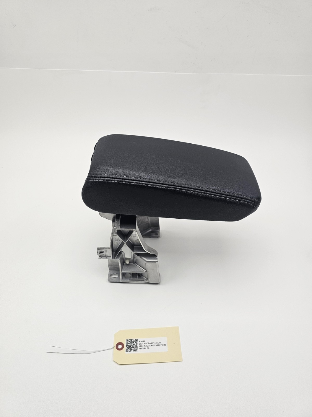

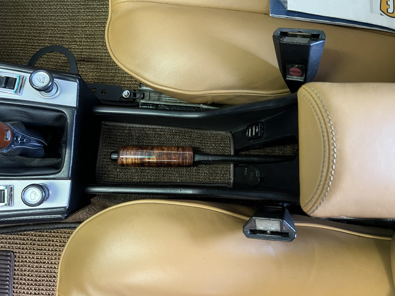

Scott -- one thing I thought about, and your prior post seems to start down this path, is whether I could find an existing armrest/cover that could be used.i honestly don't know how you would track them in the orange books since the sunroof model is not really differentiated in those books (by VIN)

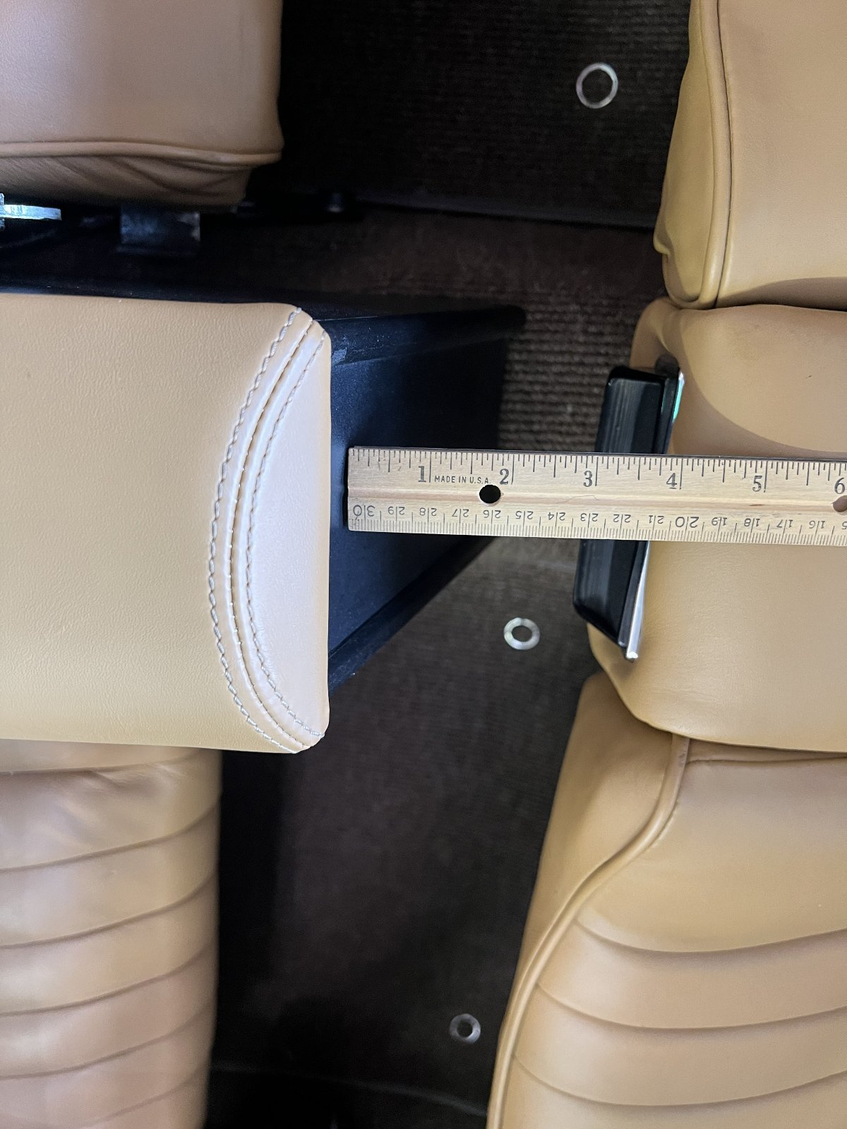

that piece looks pretty wide. ideally narrower than 150mm and shorter than 350mm. right now i am a believer in the henry ford approach - you can have any color you want as long as its black. or you can change it yourself or paint / dye it depending on material. the love of the idea of a manufactured sliding piece is that you aren't inventing / manufacturing something difficult. if you had to recover a top, okay, not the end of the world - even without getting into color, texture is often a problem.At a certain point the question becomes whether it's easier/cheaper to have a frame built into which a more readily available hinged part can be implemented, like the one you posted earlier, or something like this..probably would need to look around to confirm the right width, length, etc but may be worth considering. Also then comes the question of coloring - I believe that Anton's had the armrest in the interior leather color which makes it look more customized and perfect but obviously comes at increased complexity - is my red the same as your red vs someone else who needs black or tan.
absolutely. i am looking at cars between 2000 and 2020 ... and the preference is 2015 to 2023 for exactly the reasons you mention ... and with cars that were produced in huge numbers. think VW, Toyota, etc. i looked at BMW but they all had funny shapes.And at that point the customization answer may be "here's the frame that the E9 group has built at $X cost, here's a link to a readily available drop-in hinged portion along with simple instructions of how to assemble them together, take the stock part to an upholsterer if you want custom leather/vinyl". Probably the best method to avoid having to deal with custom.
Also would be ideal to find a part from a car built in the last 10-15 years so that we can ensure availability (maybe) for the near future. Sourcing parts from a 1990s car is possible but can start to get spotty as the years go on.
