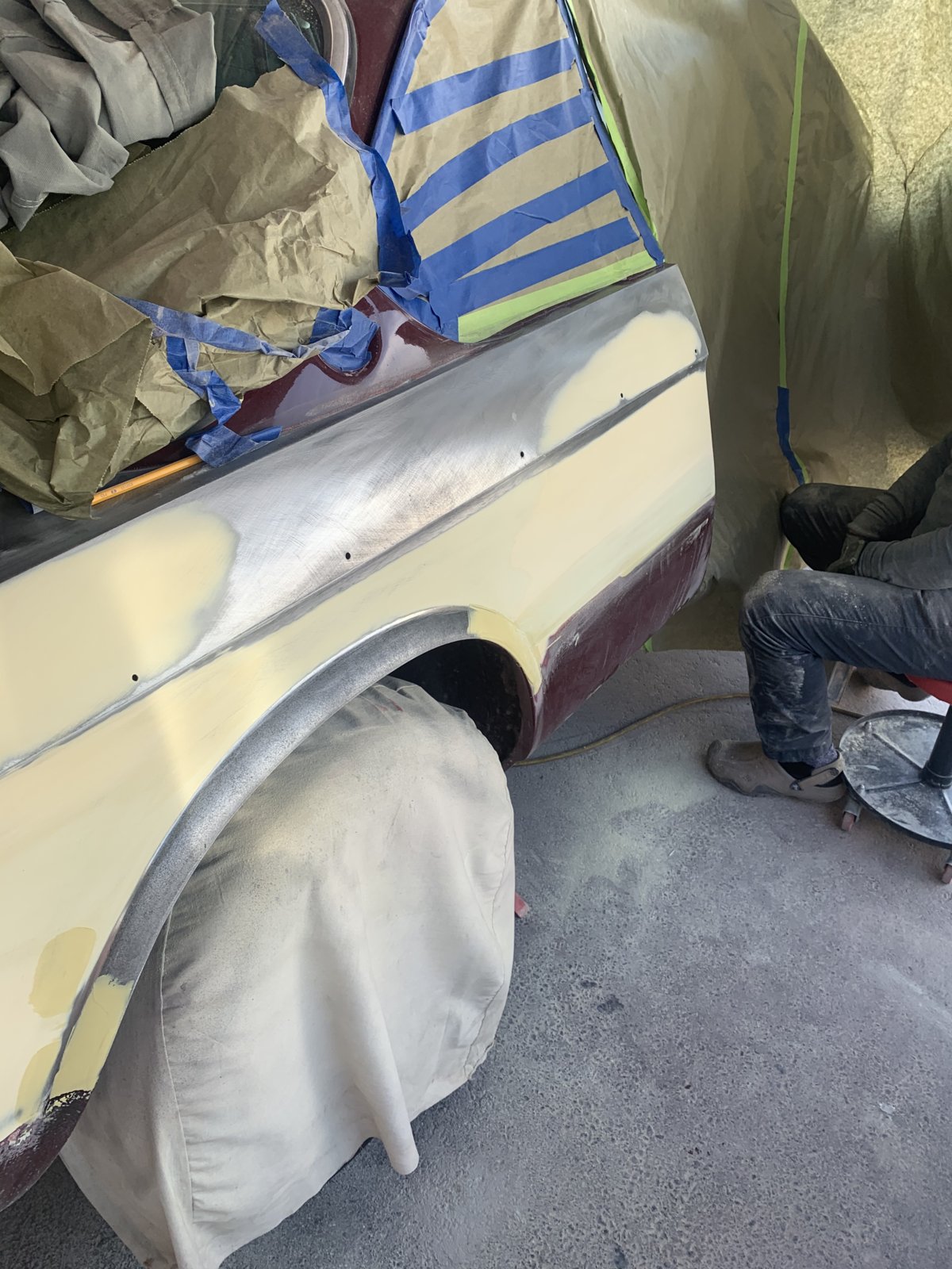

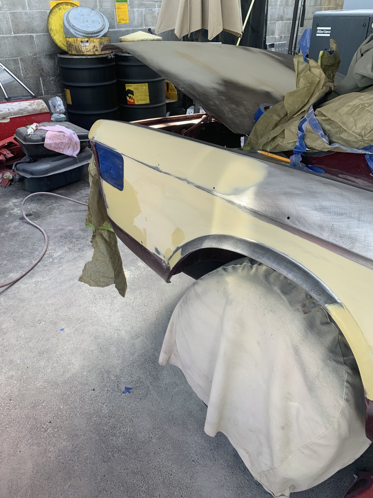

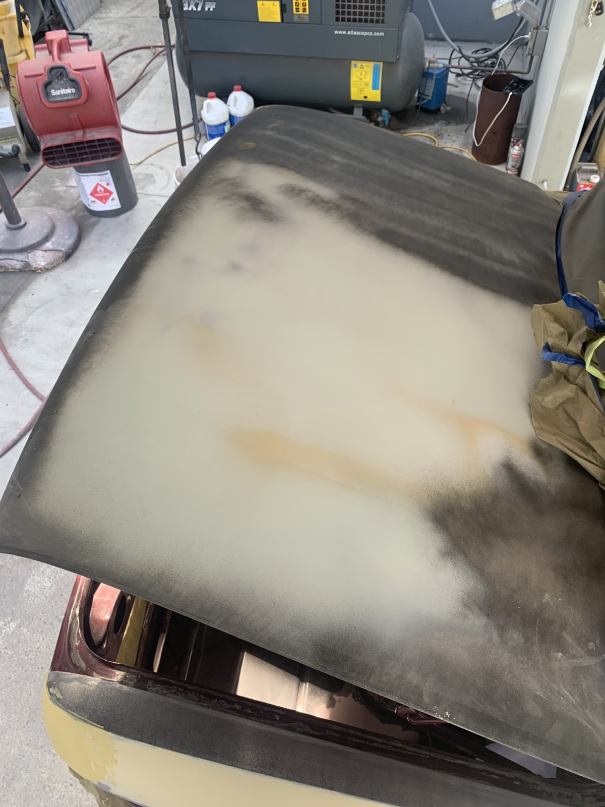

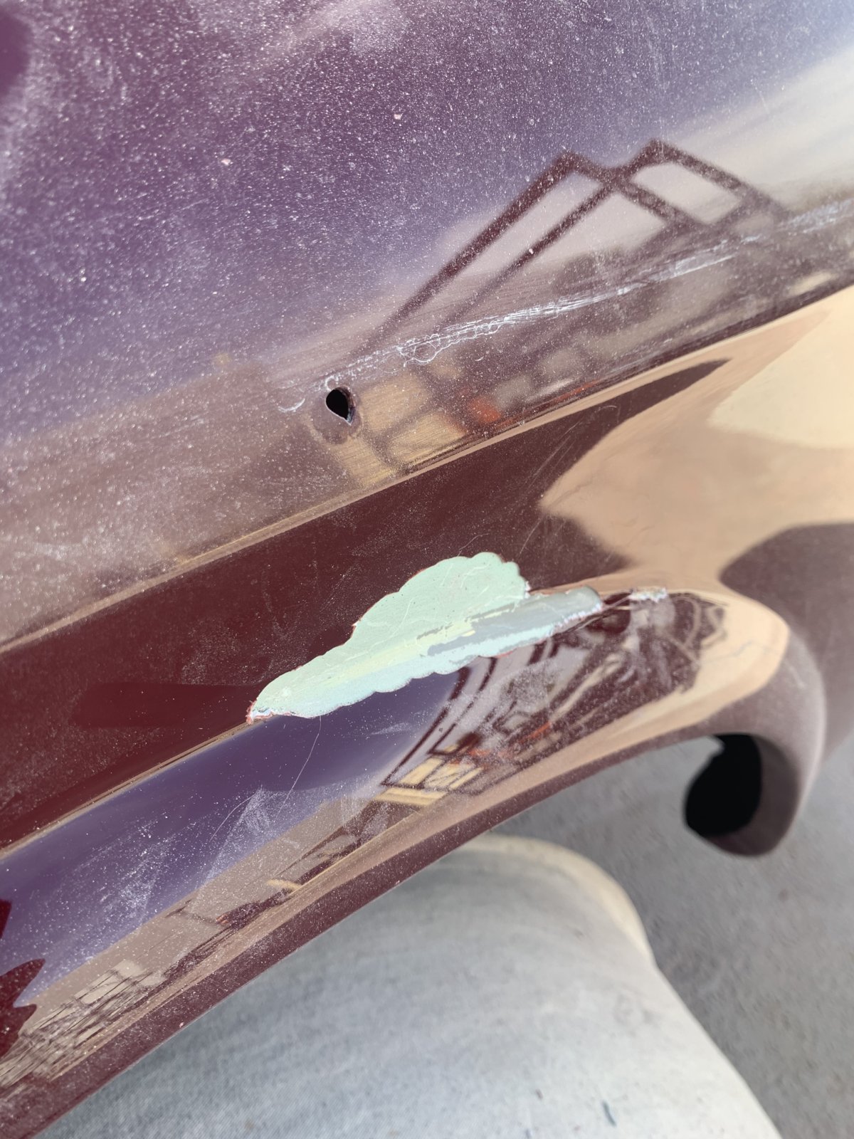

Paint stripping has begun. Bubbles on wheel arches was due to filler still being wet when primed, it was off-gassing when paint was removed!
Chris, what do you think was the main reason that previous paint did not hold up? Paint quality? Prep? Natural degradation?
View attachment 104948View attachment 104949View attachment 104950View attachment 104951
Hi Chris , my car came to me in poor condition , so it’s easy for me to go at it with power tools , but from what I can see in the pics ,your car looked quite good so I think it takes quite a bit of bravery to take apart a good car .
Are you doing the work yourself ? Or do you use a body shop ?
Will you etch prime it on the bare metal areas ???
Just wondering as it is all ahead of me :)
The paint failed so I had no choice to go for a repaint. We are stripping where necessary, I only did the disassembly and I have quite a few pics I should add. But we don’t have to do door jambs, engine or trunk as we keeping the Malaga paint.
