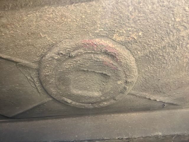

Last fall I inspected a very original US spec 3.0 CS. The paint, I am certain, was original with meter readings of 3-4 mils. This image of the underside shows the gray coating but of interest is a bit of Malaga peeking through. My guess is the cars received the tan primer with some overspray of body color along the outer edges, followed by the gray rubbery coating
