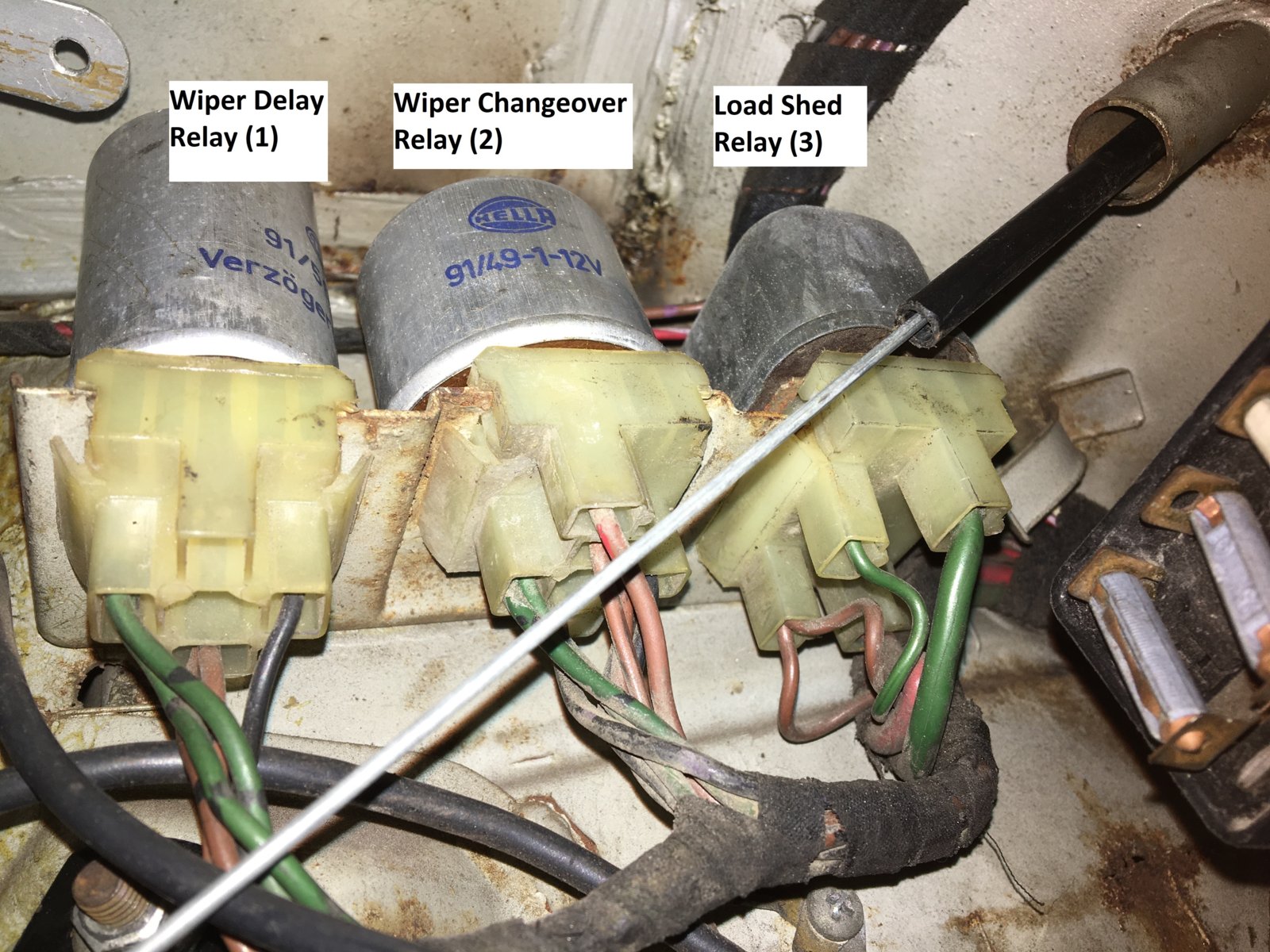

2800CS Early (Feb and Jun 1970)

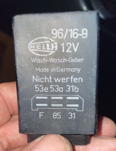

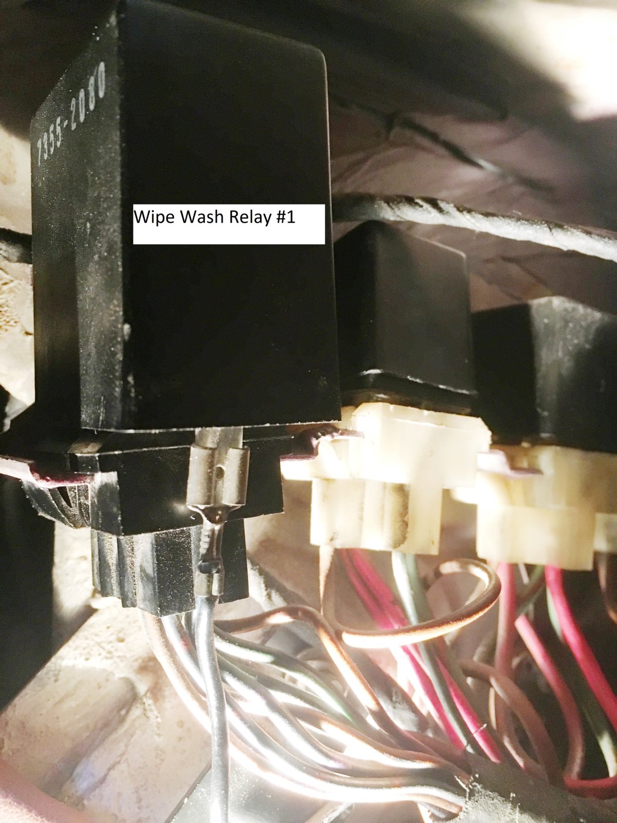

1) Wiper Delay: brown/black (2), green/black (2), black
2) Wiper Changeover: green/black (2), brown/red, black (2), black/violet, brown (2)
3) Load Shed (for headlights and heater blower): red, green/red, green, brown (2)

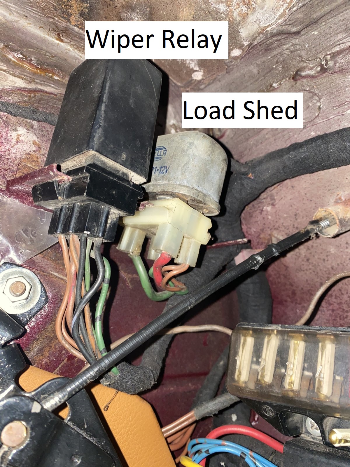

2800CS Late (Mar 1971)

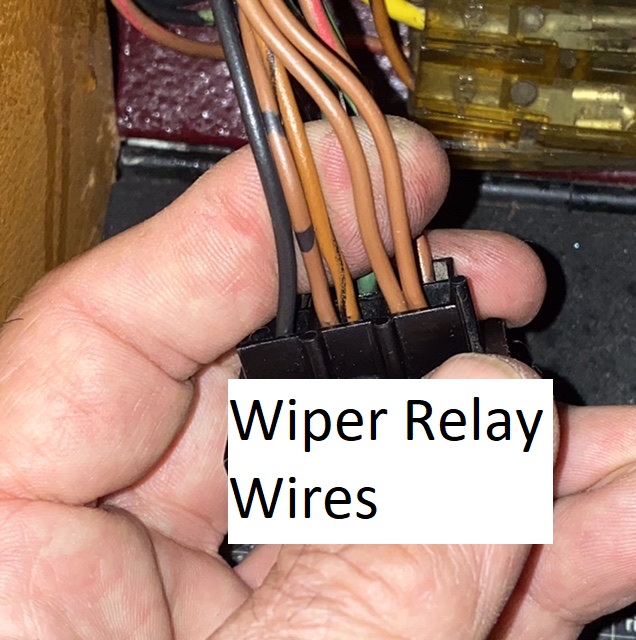

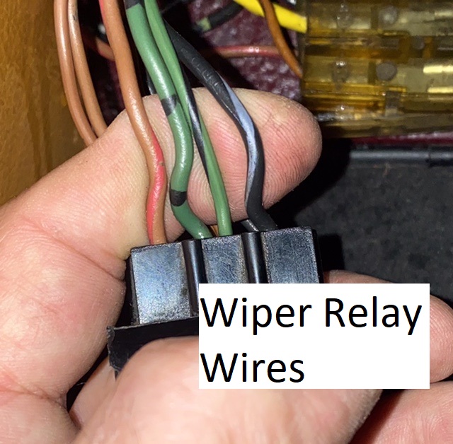

Wiper Relay: green/black (2), brown/red, black/violet, black, brown (2), brown/black (2)
Load Shed: red, green, green/red, brown (2)

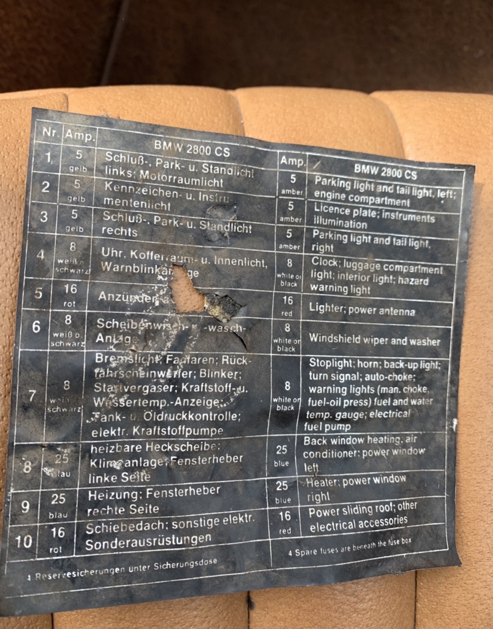

2800CS US/NA Market Fuse Sticker

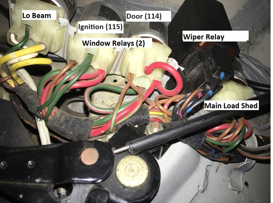

1974

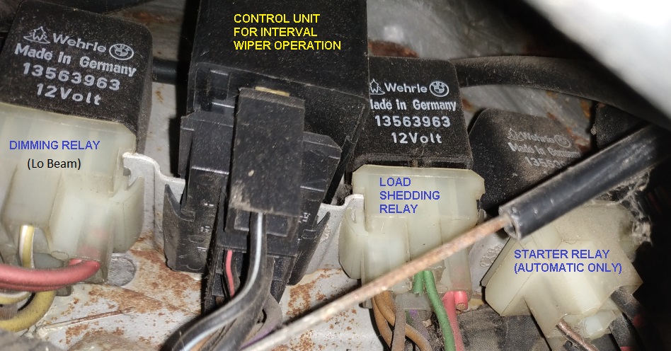

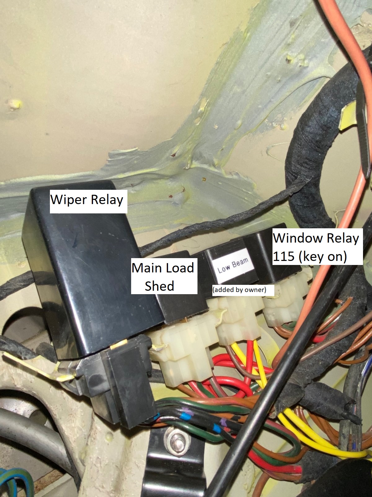

Low Beam: yellow, yellow/white, red (2), brown

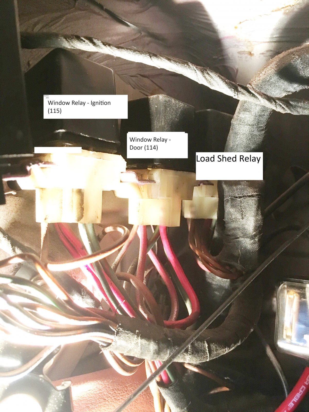

Window 115: green/red, brown (2), red (2), green (Activates all window motors when ignition key on)
Window 114: green/red (2), red (3), brown/black (Activates front window motors when driver door opened)
Wiper: brown/red, violet/black, black, brown/black, black/red, black/blue, brown (3)

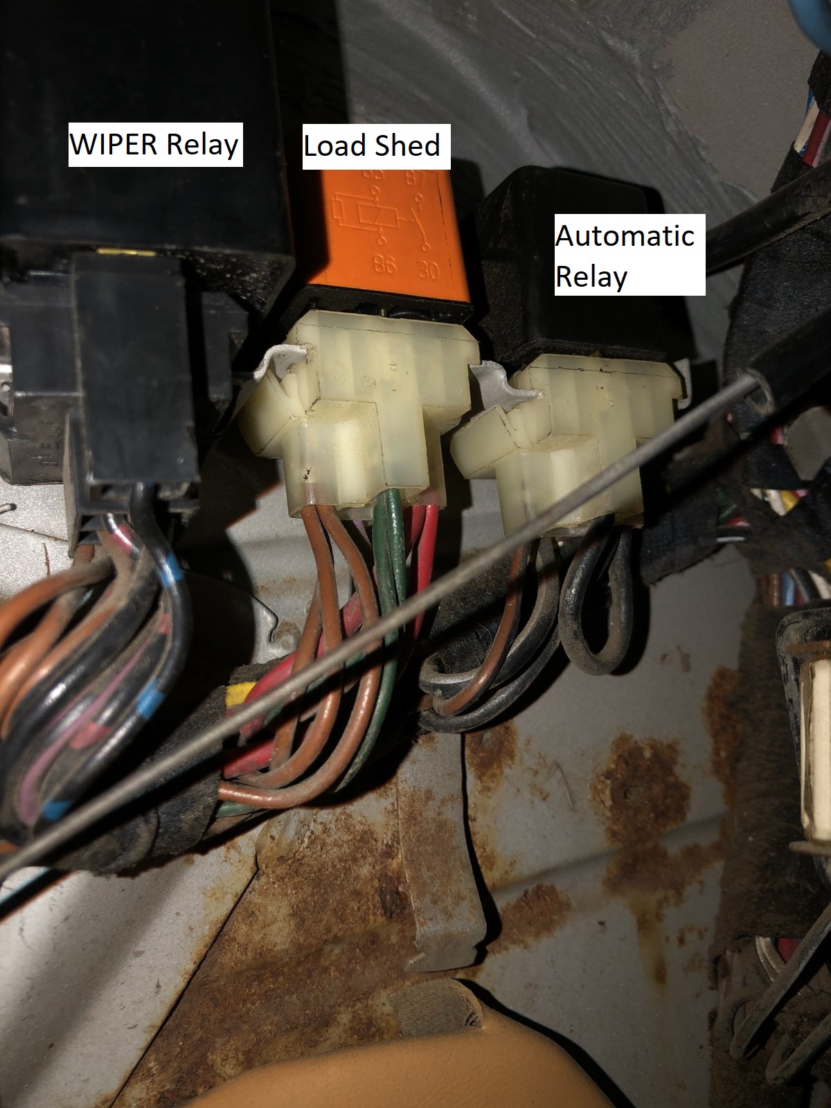

Load shed: red (2), brown (3), green (2), green/violet
Automatic: black (4), brown/black

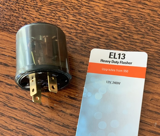

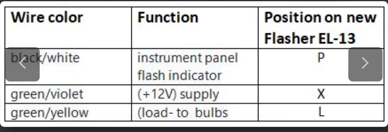

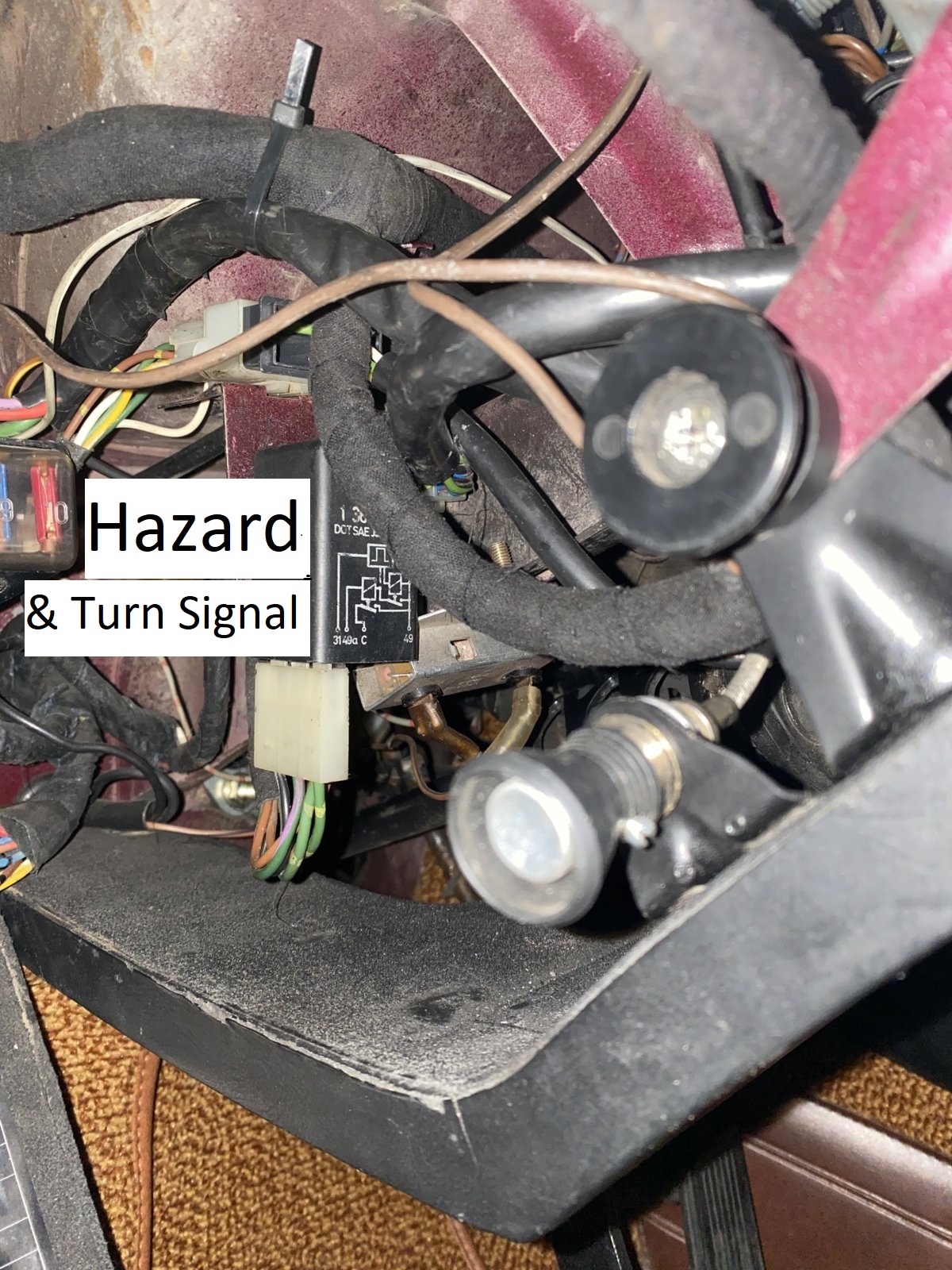

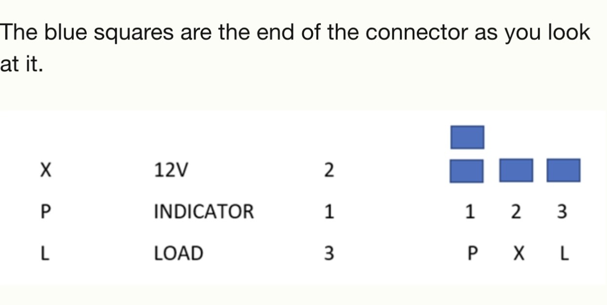

Hazard Relay Upgrade (EL-13 Electronic Flasher)
Allows use of LED bulbs, diagram below

1974
