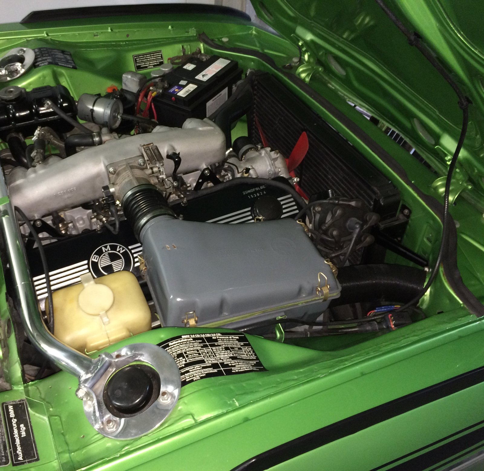

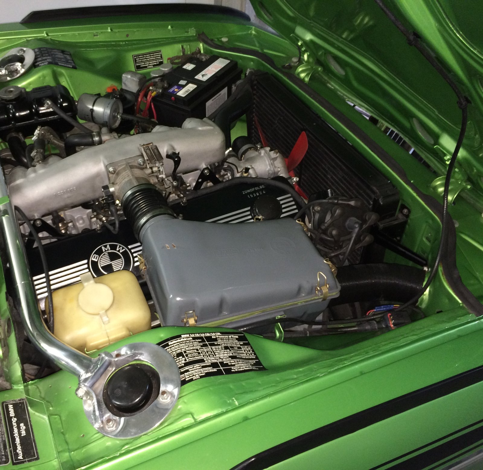

Hi David,
Photo of my clips and air box paint colour (not powder coat) FYI.

You have given me something to aspire to in the restoration of my Taiga E9 engine bay. Beautious!
