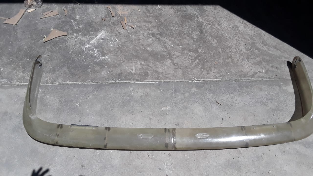

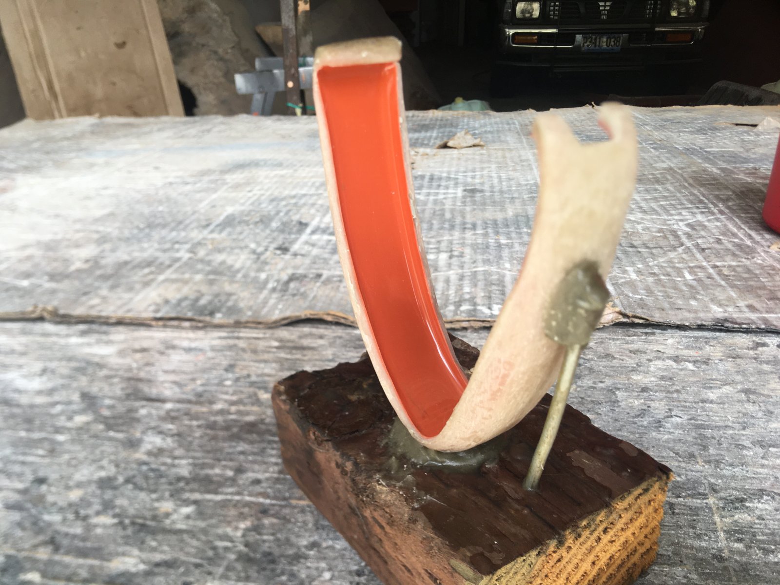

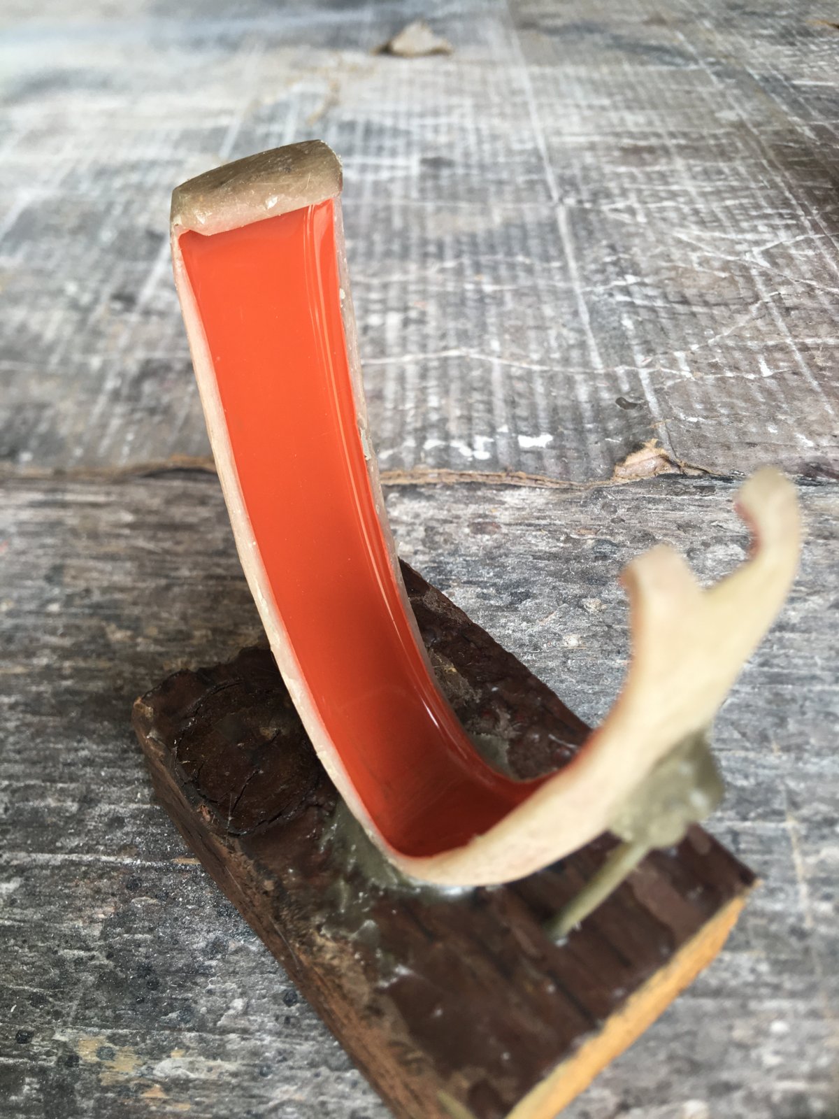

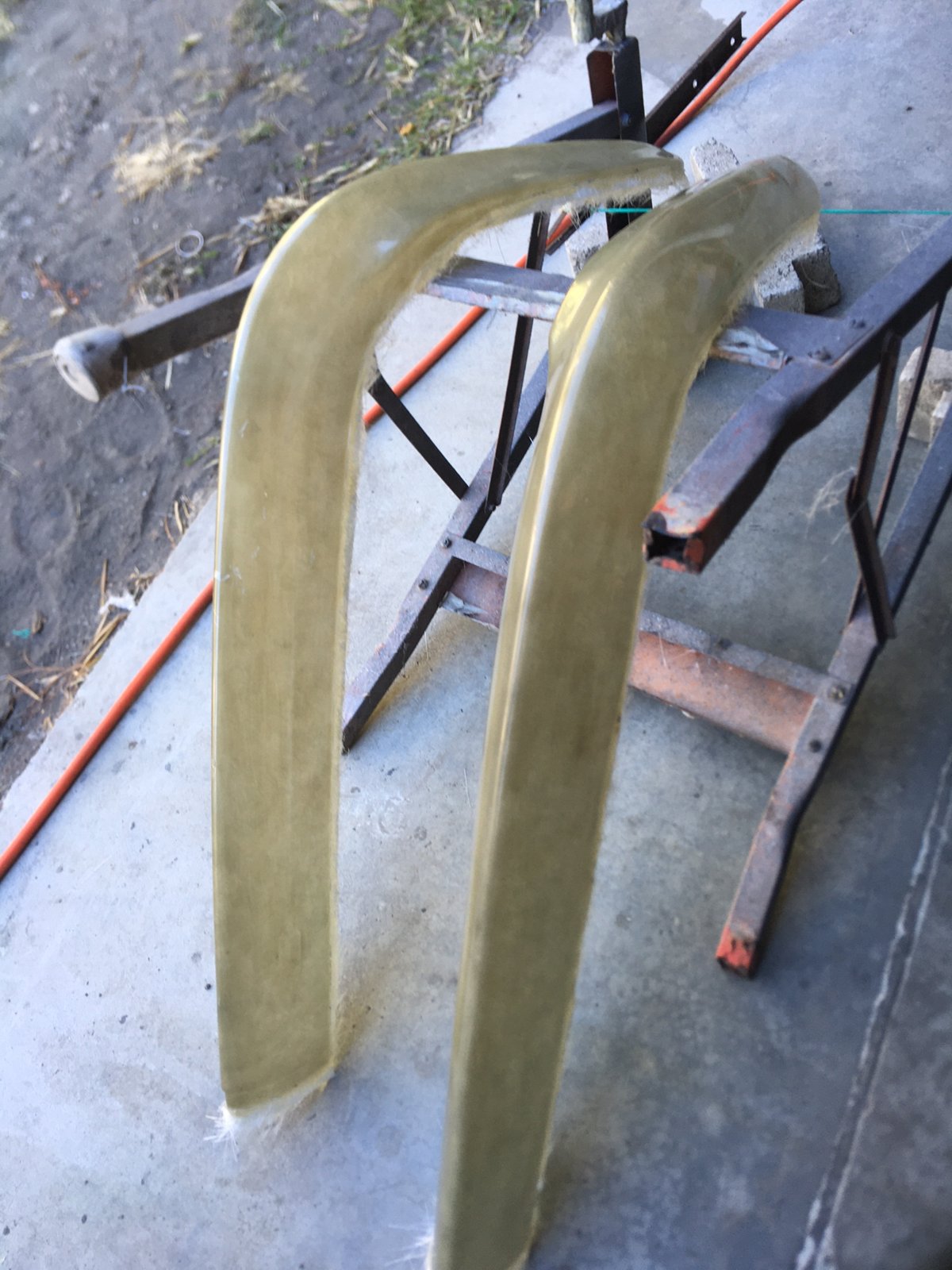

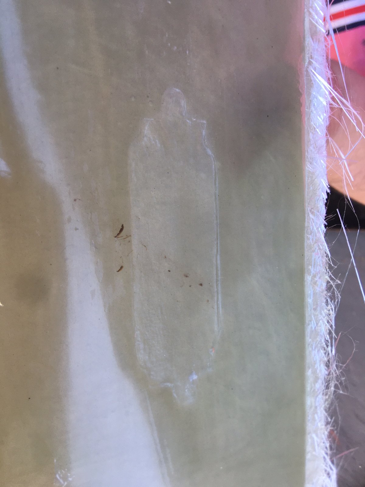

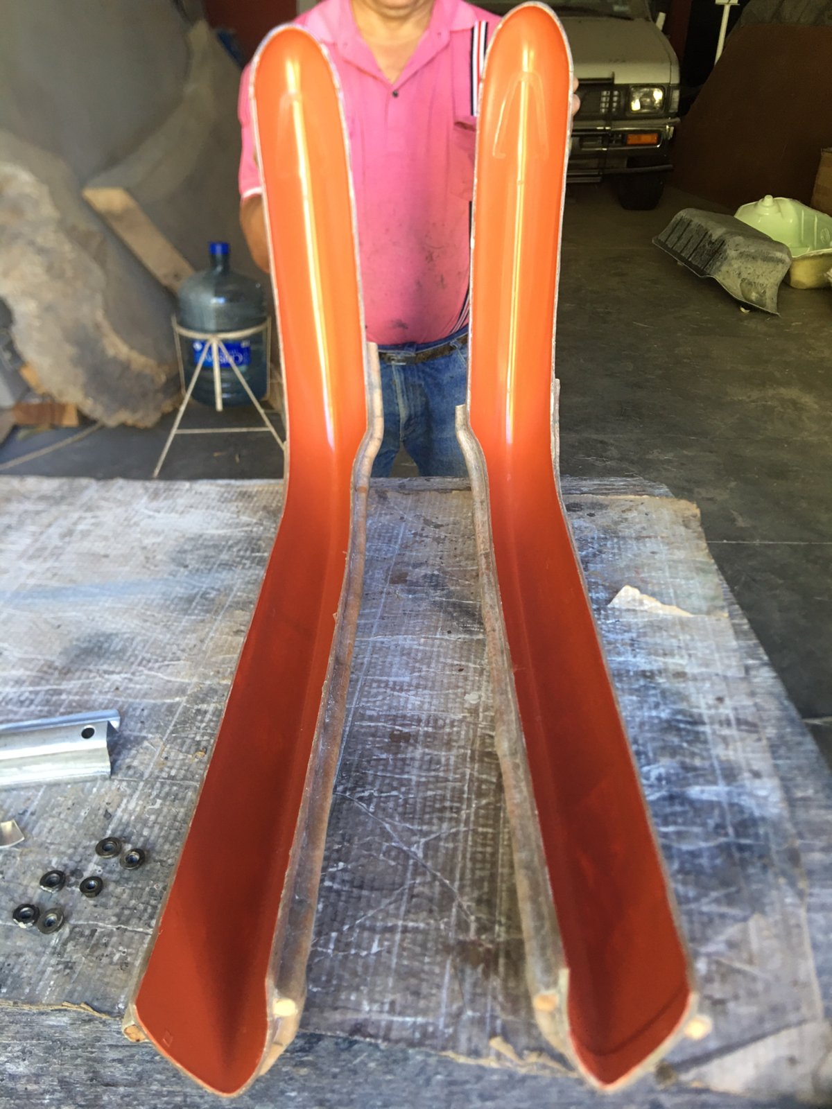

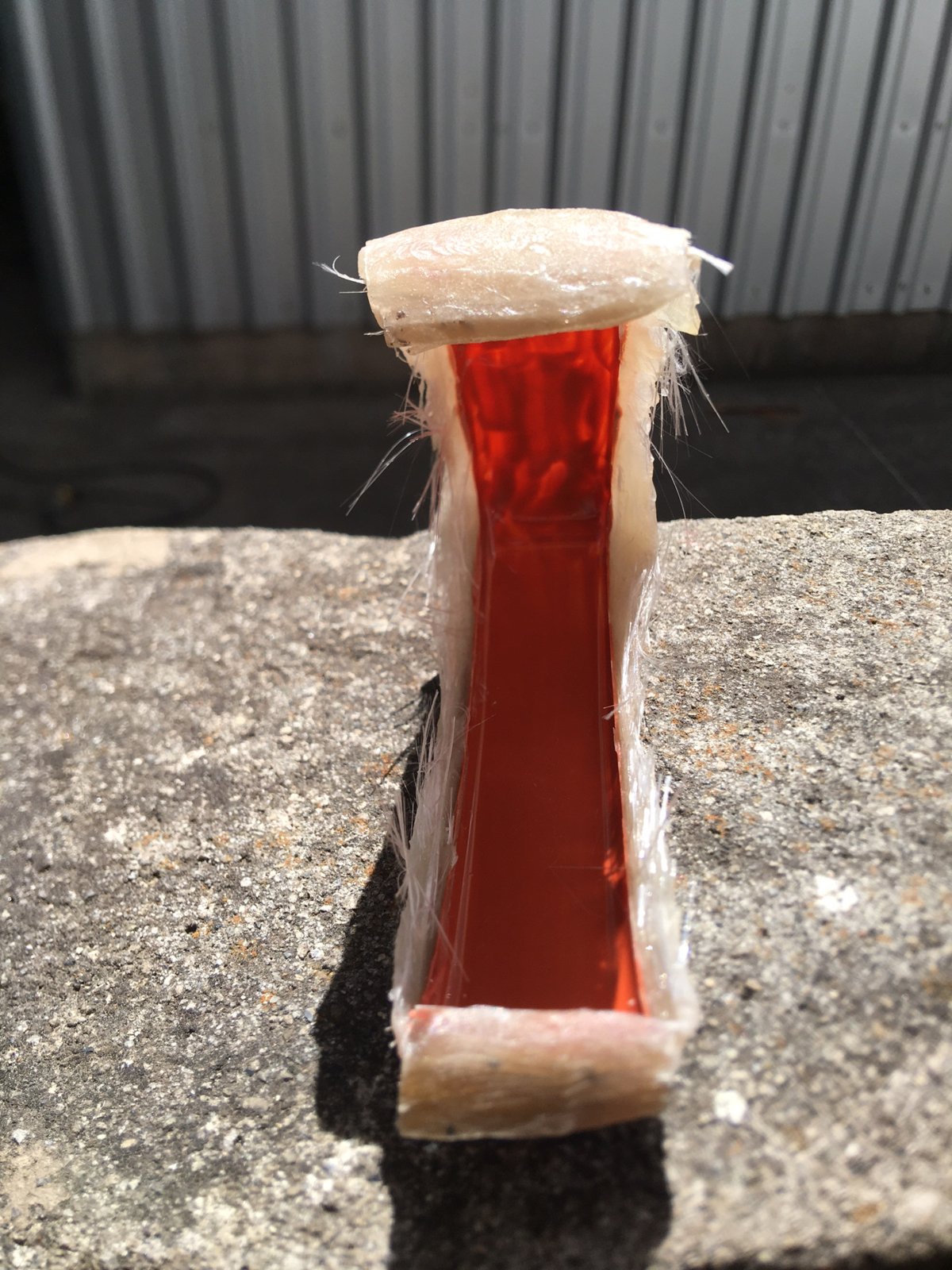

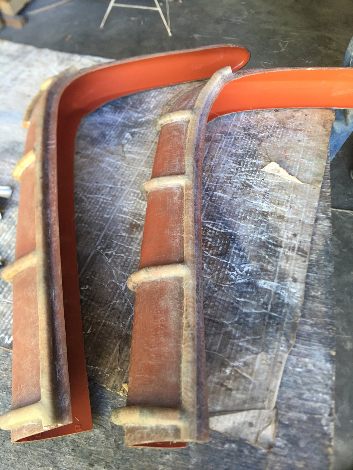

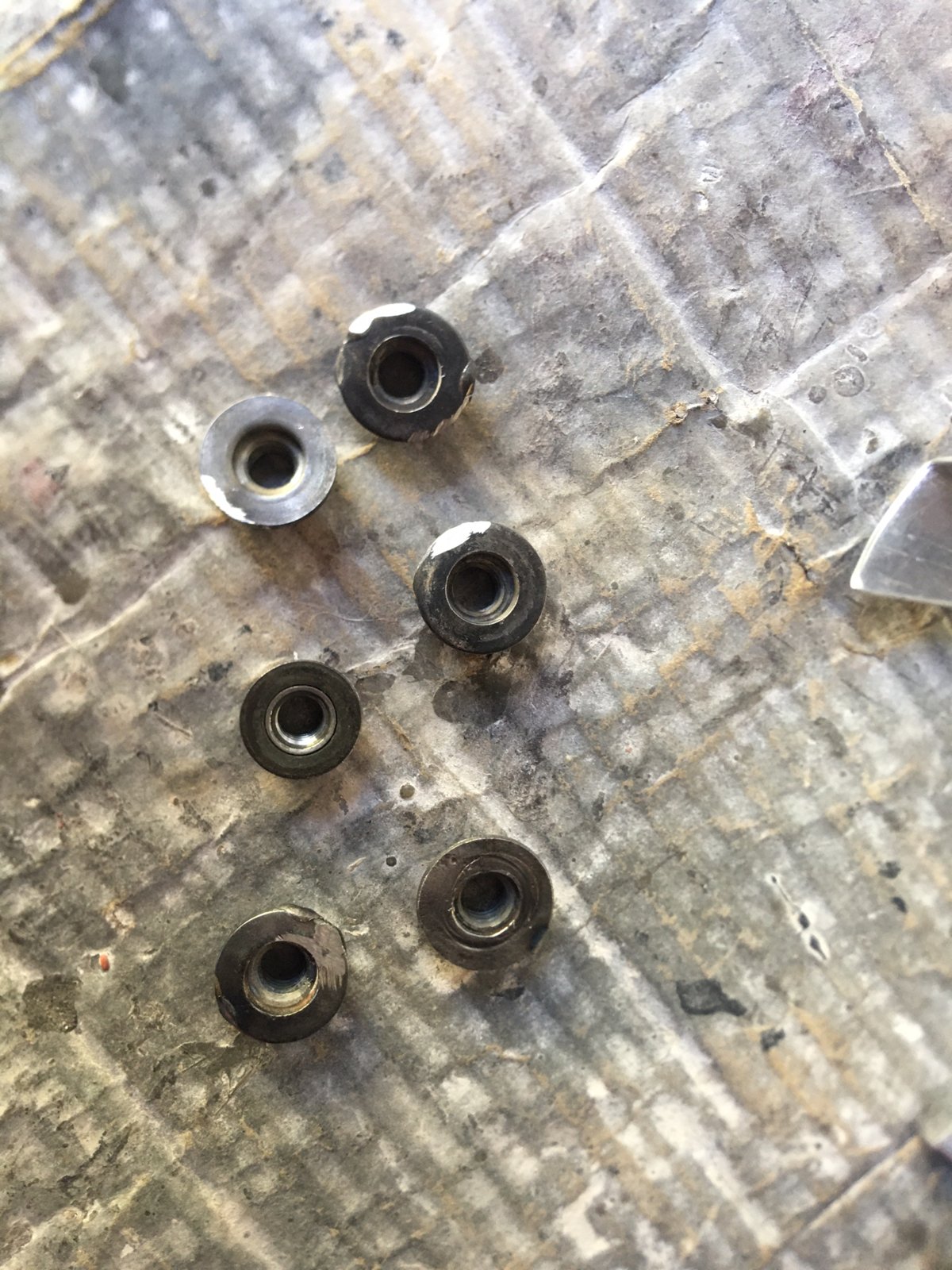

Moulds, center piece... cutouts for license plate lights

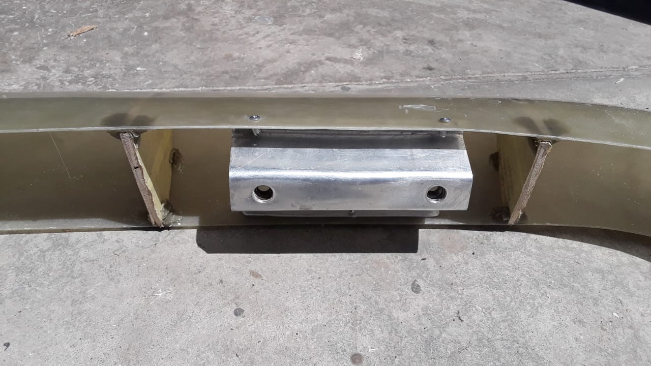

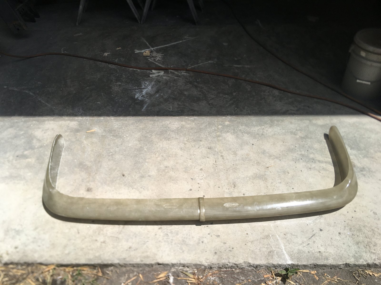

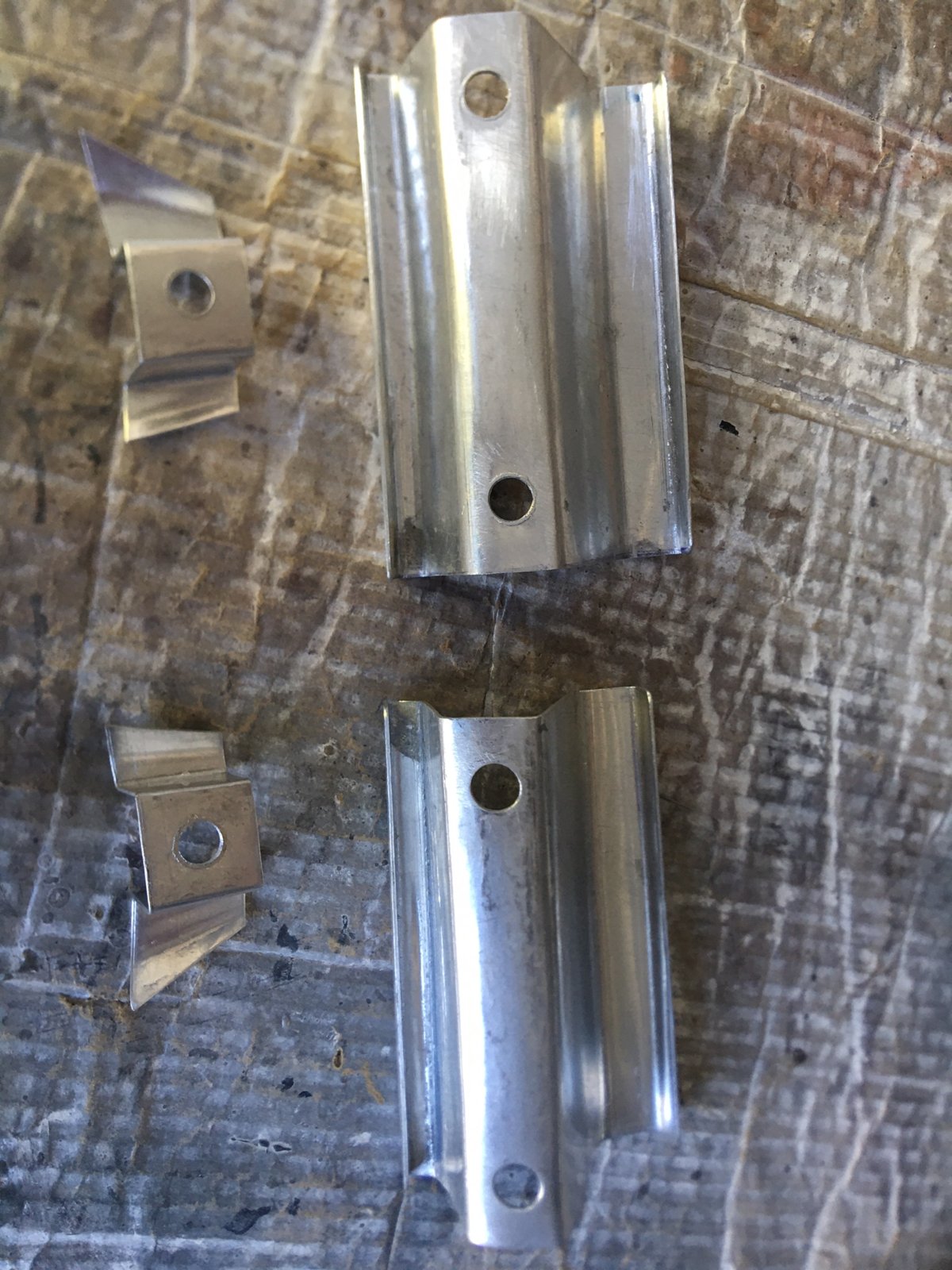

Nuts with washers, Ally plates, Bumpers.
Will install plates to car, then glue to bumpers, Glass the whole structure together, then join two halves, and attach center strap.
Cut out the holes for the license plate lights.
Paint semi flat black.
Hope you like. They will be strictly decorative, maybe weigh 3 Lbs.
Regards, Alberto

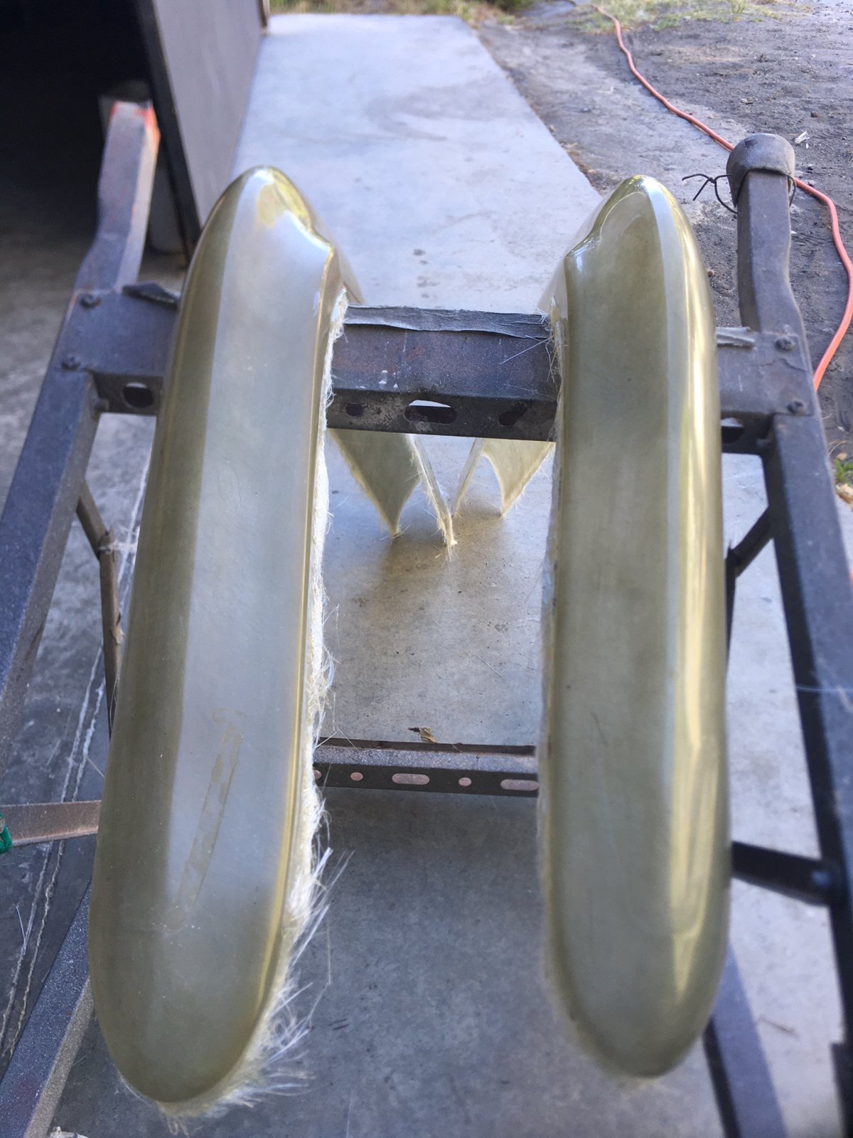

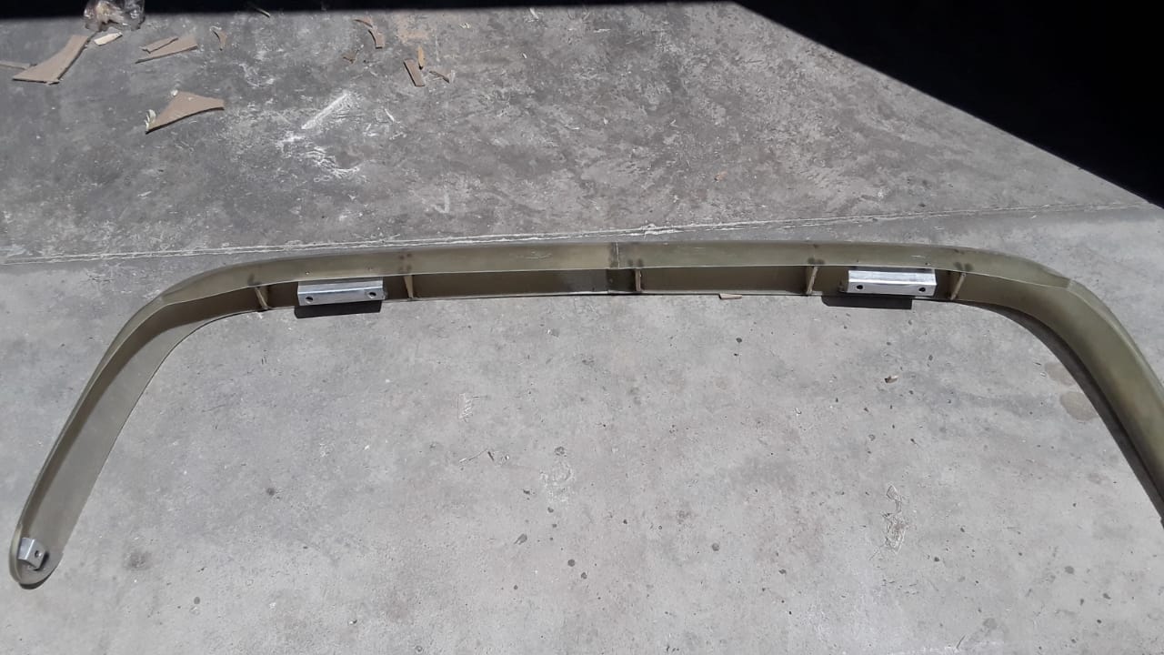

Thank you for the comments!

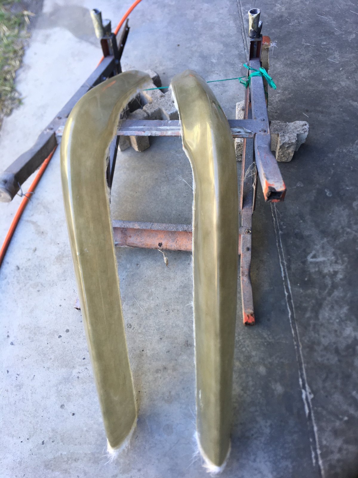

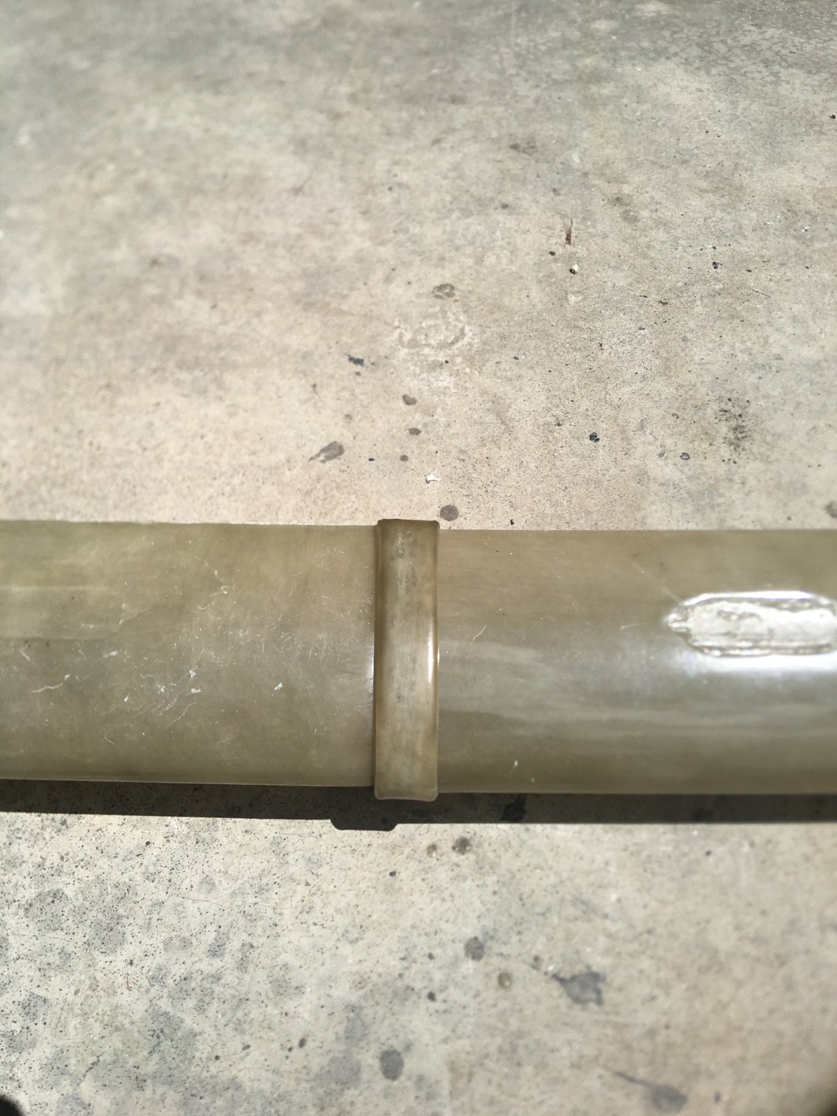

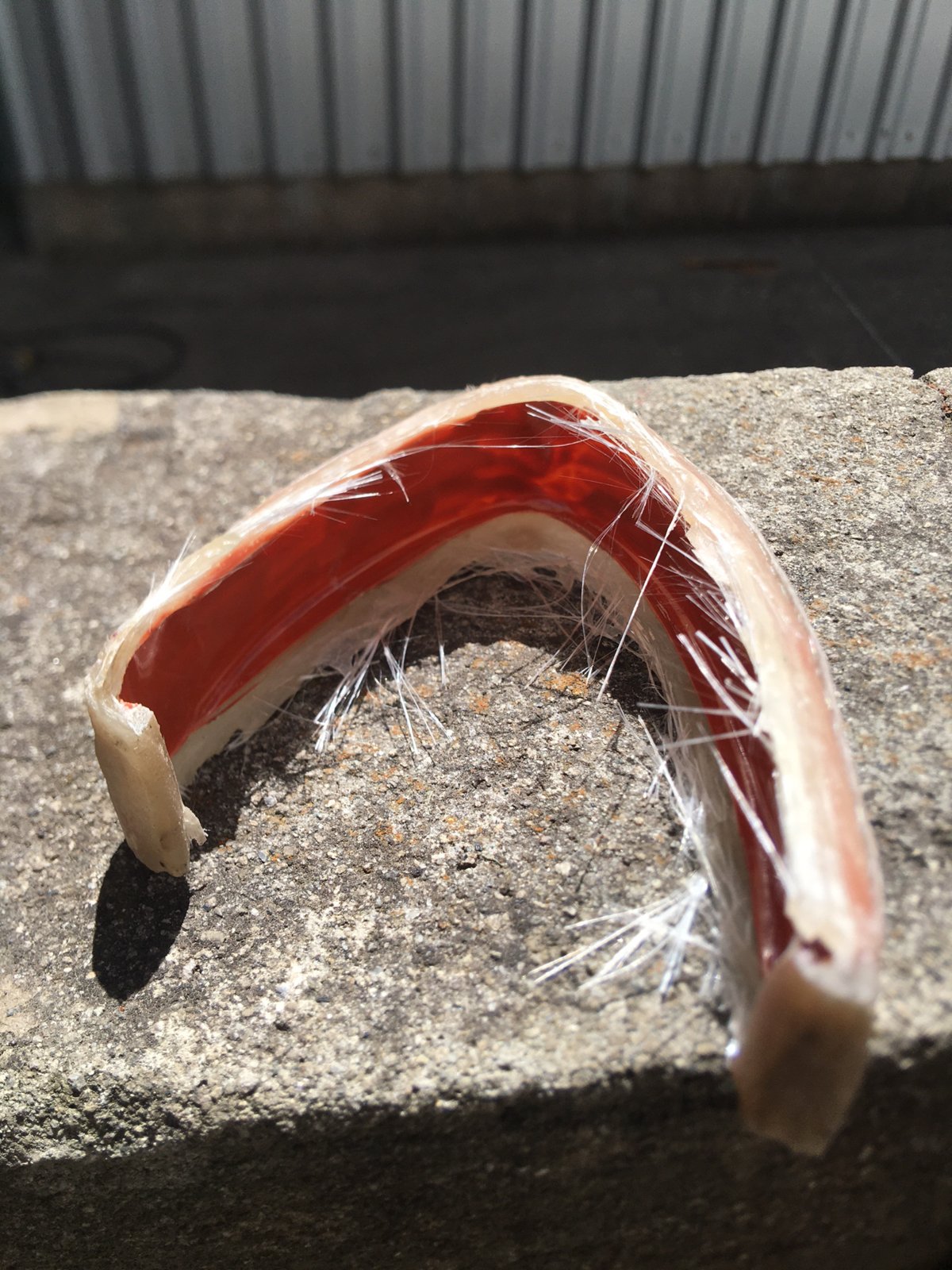

Here is a raw result. 1 lb vs 10 lb, that's including the center section.
Just love the manufacture.
Tomorrow will mount the alloy brackets to the car, then attach the bumper
to them, rivet the whole thing, take off, fibreglass the bases real nice on, then can the rivets.
This way, the fit is guaranteed, no issues.
Paint.
Then, on to the front at almost 30 lbs.
Regards, Alberto
