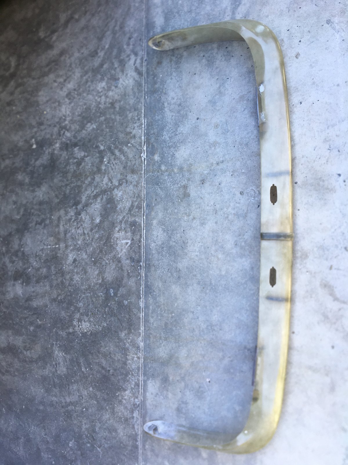

We made the moulds, and that, takes huge time, they need reinforcing as per photos, need waxing,
maintenance, etc.
If you have ever worked 'glass properly, you know. As in everything, you pays for what you gets.
Will post the finished, painted product once finished and installed. I think there may be a demand total of 5 or 6.

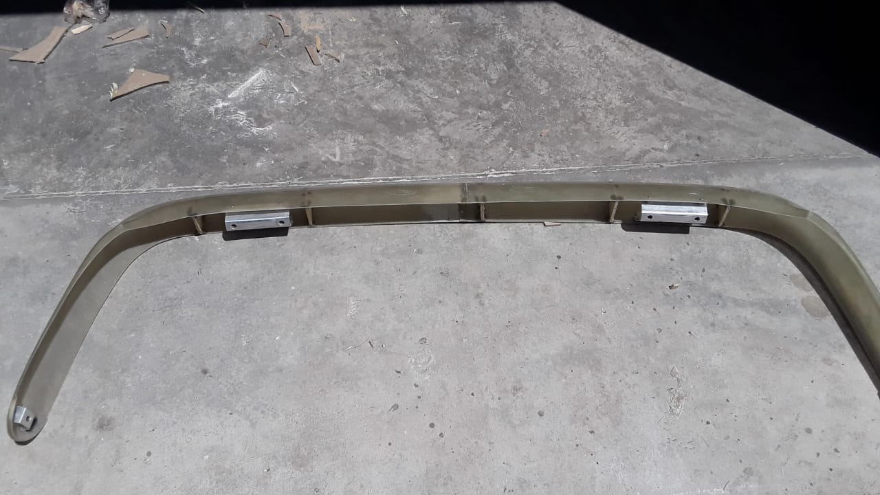

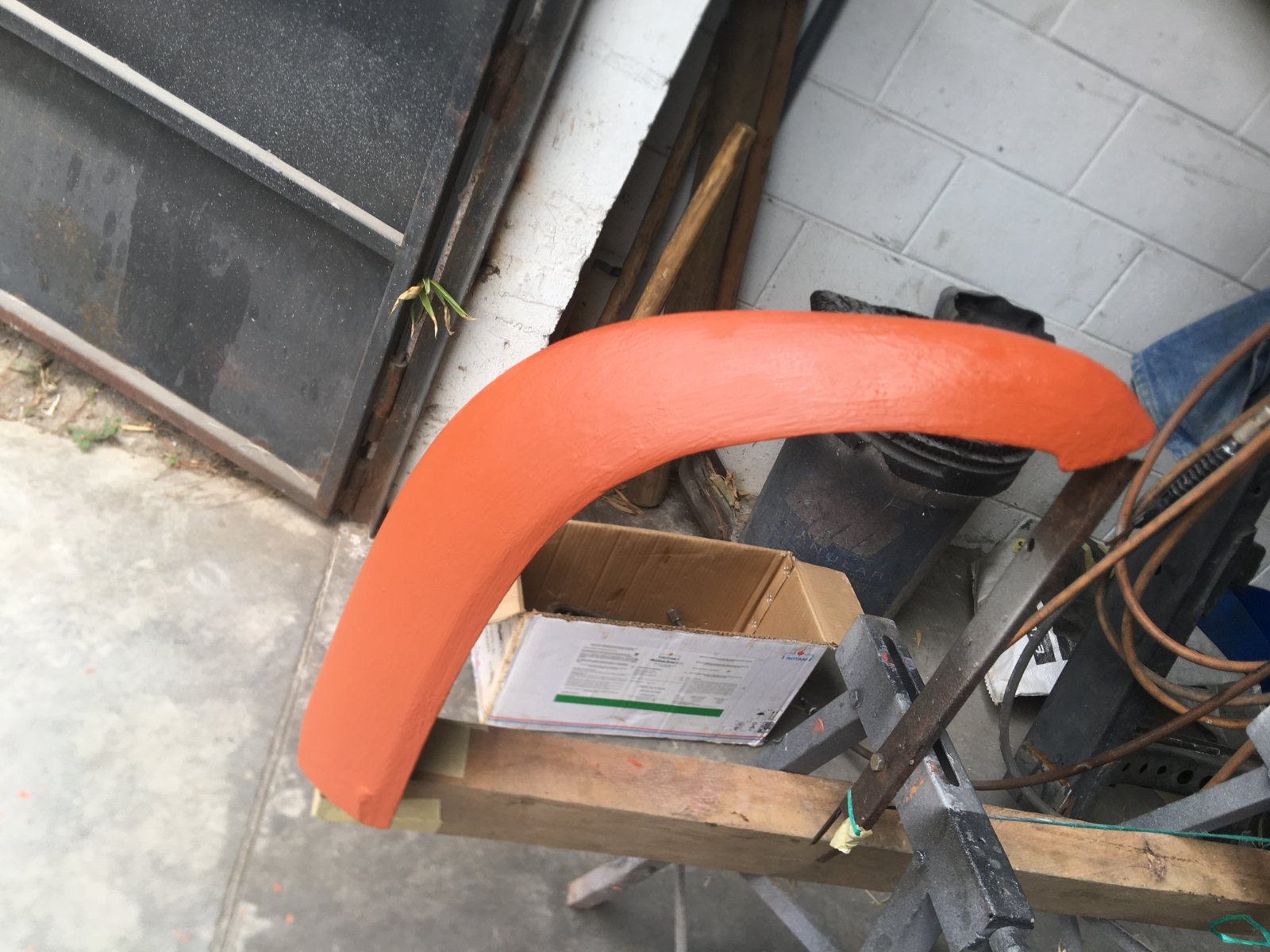

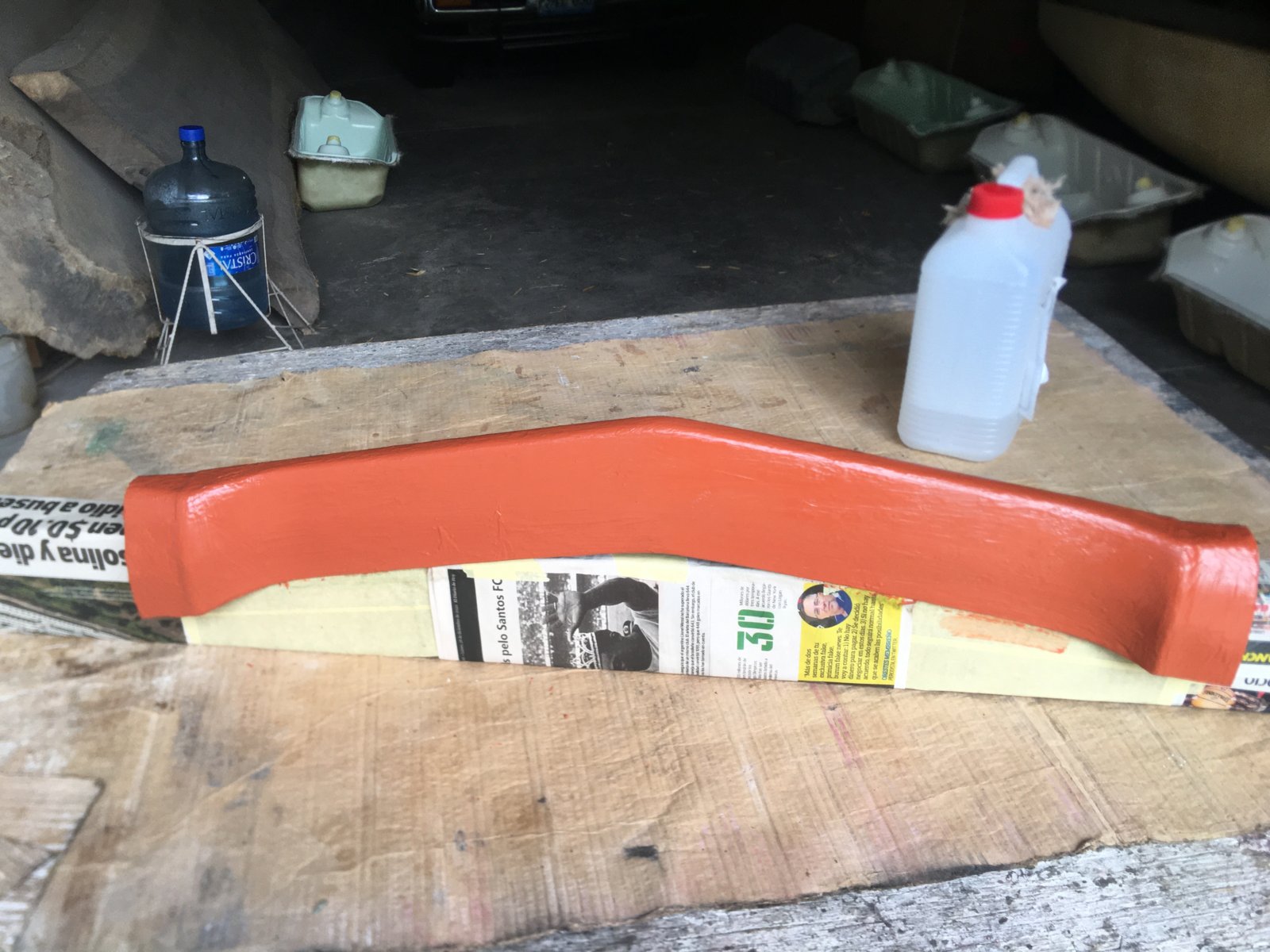

Rear bumper ready for final refinishing, and paint. Glassed in two 1/4" rods (visible)
to maintain rigidity.

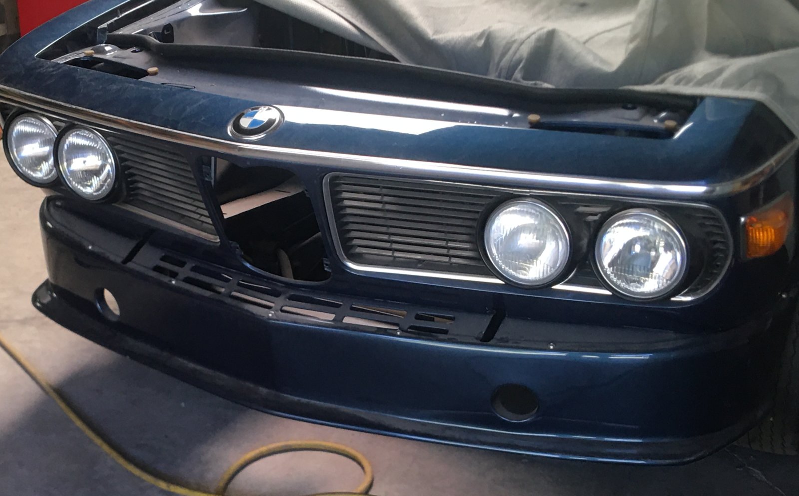

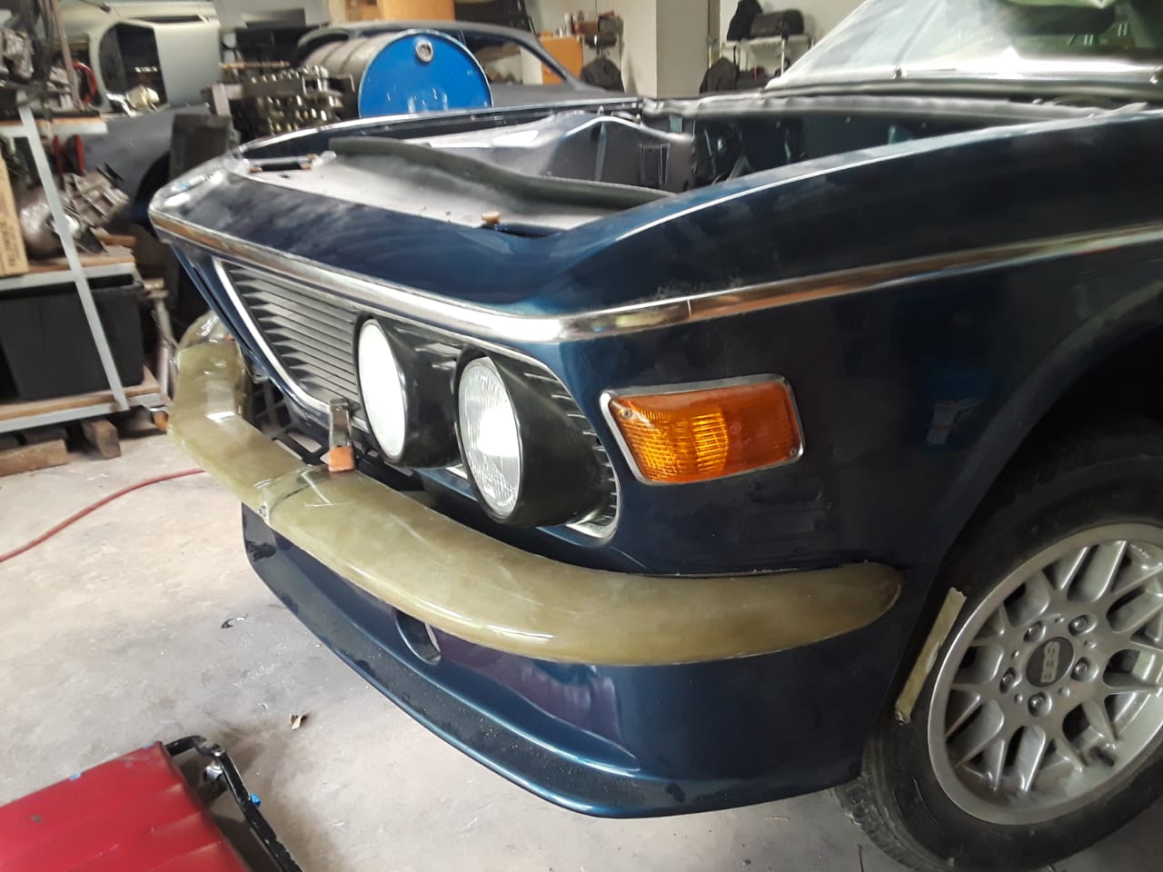

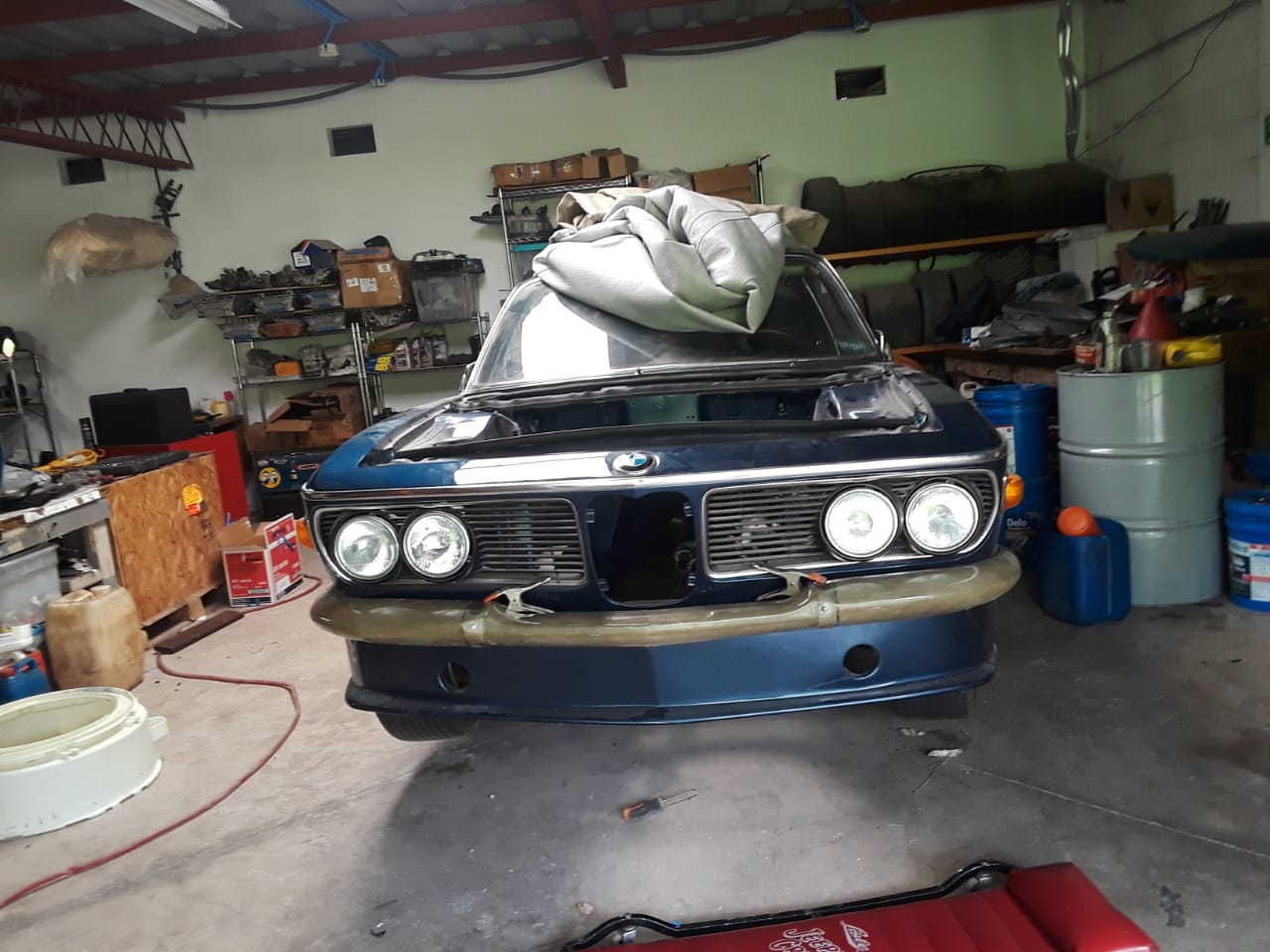

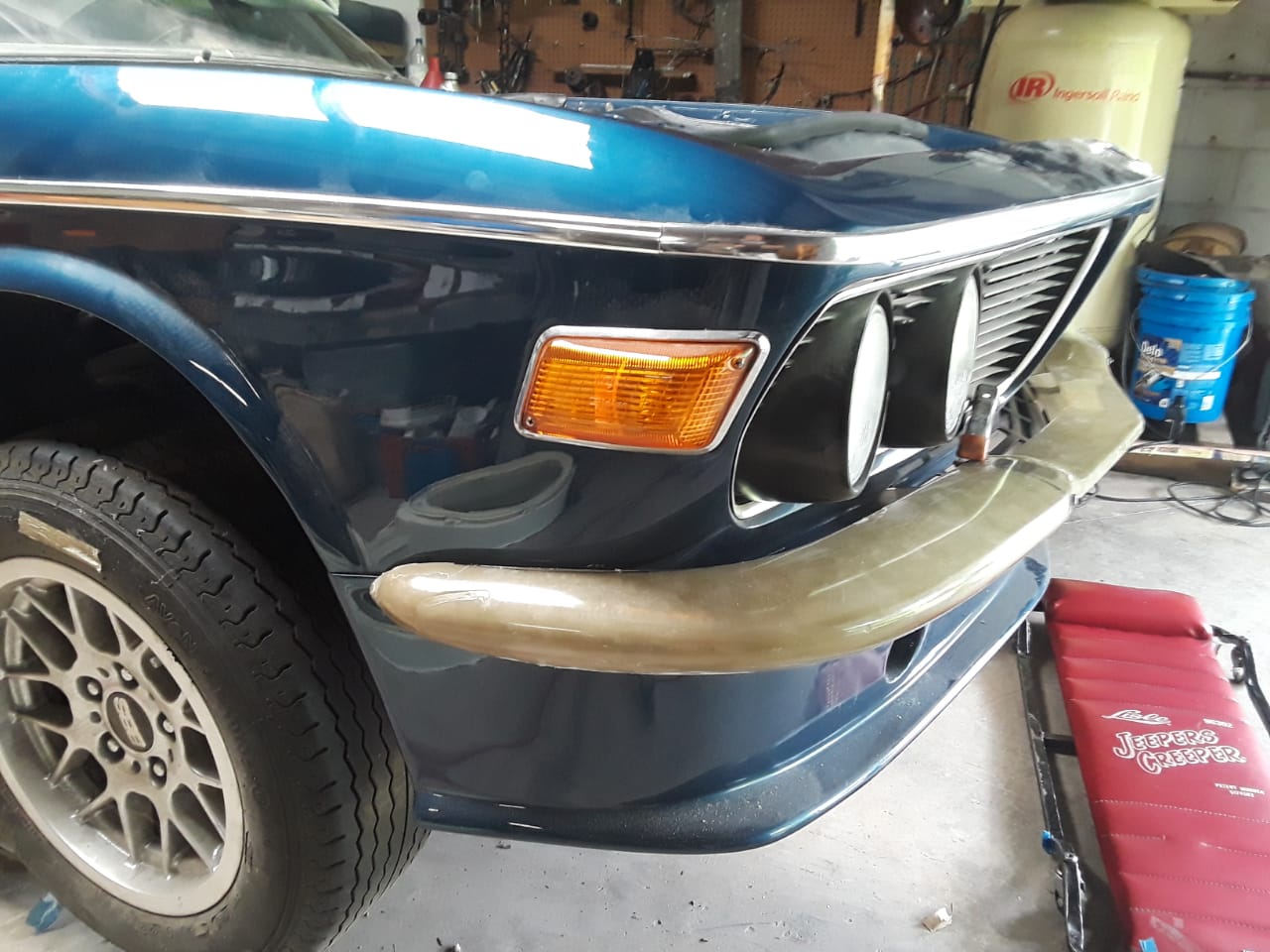

Started on the front bumper. I really like the front indentation, so followed it to a 't'
with the sides as stock, a very nice look.
we are making the front bumper bracket with ally, flat bar stock, super lite.
Anyhow, just for attaching, zero protection.
The airdam we made from a Hartge H5S, original E28 version , cut up some, and made to fit for the CS.
Regards, Alberto

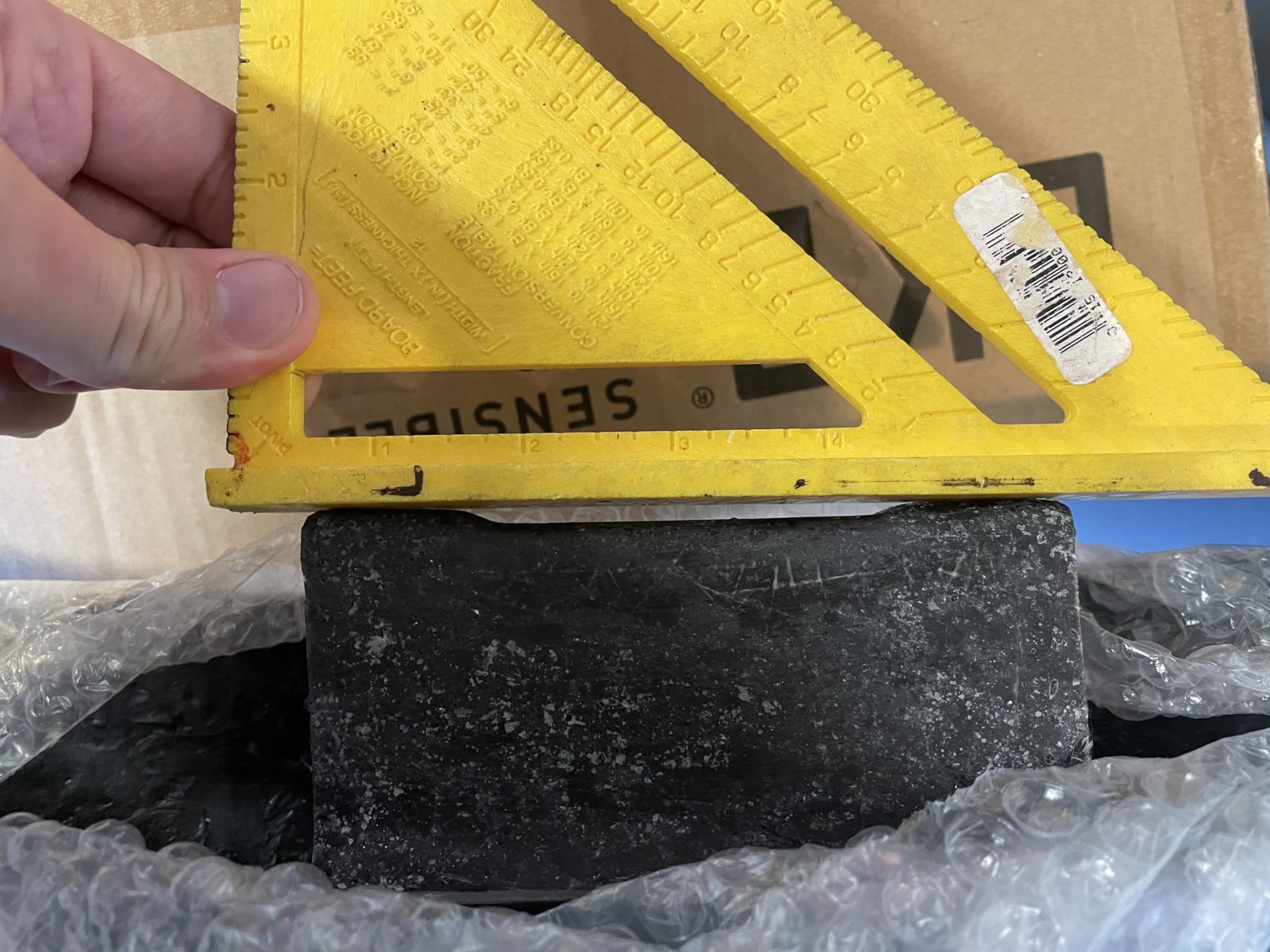

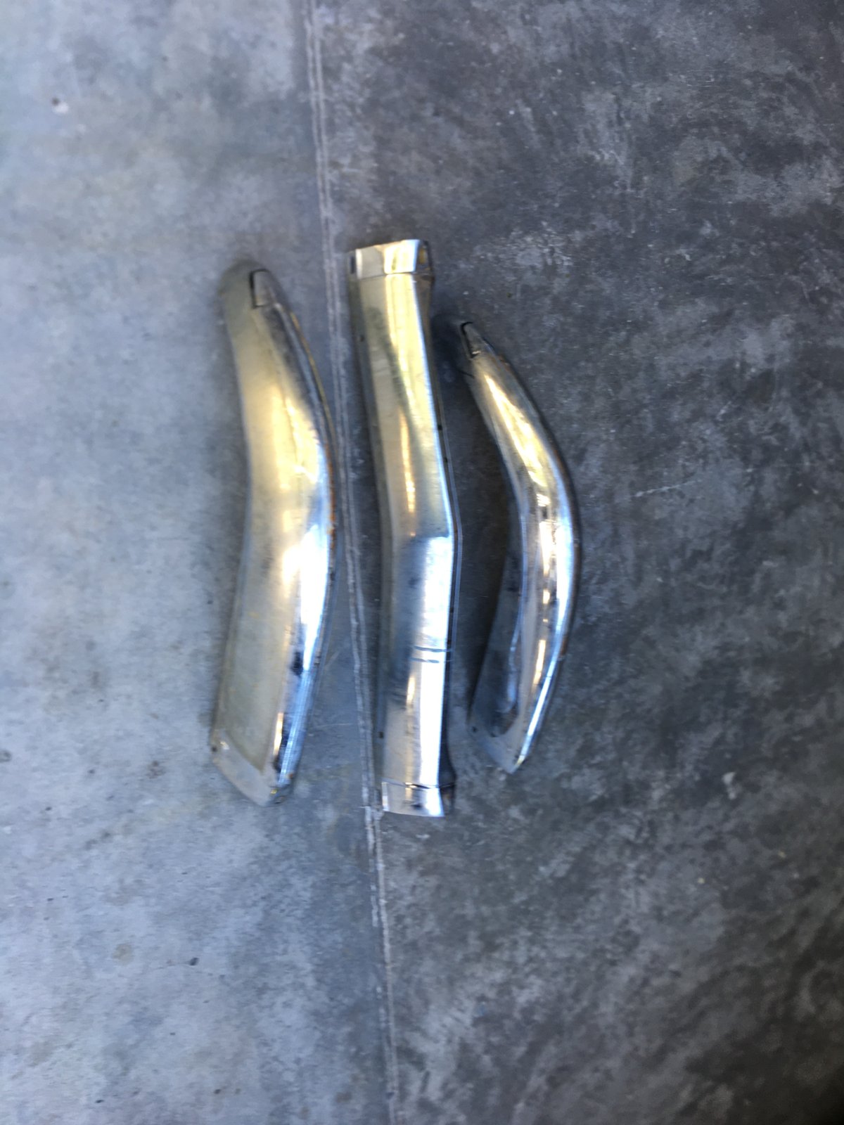

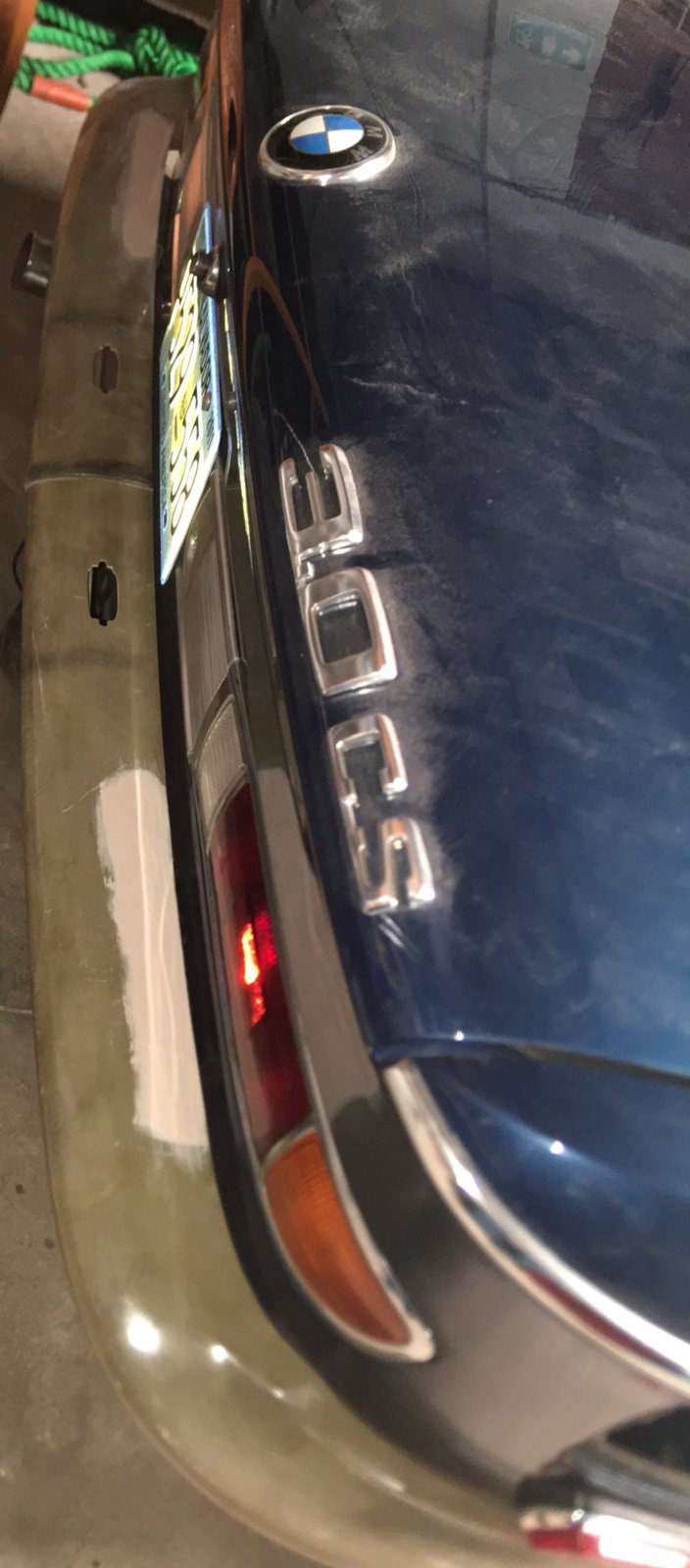

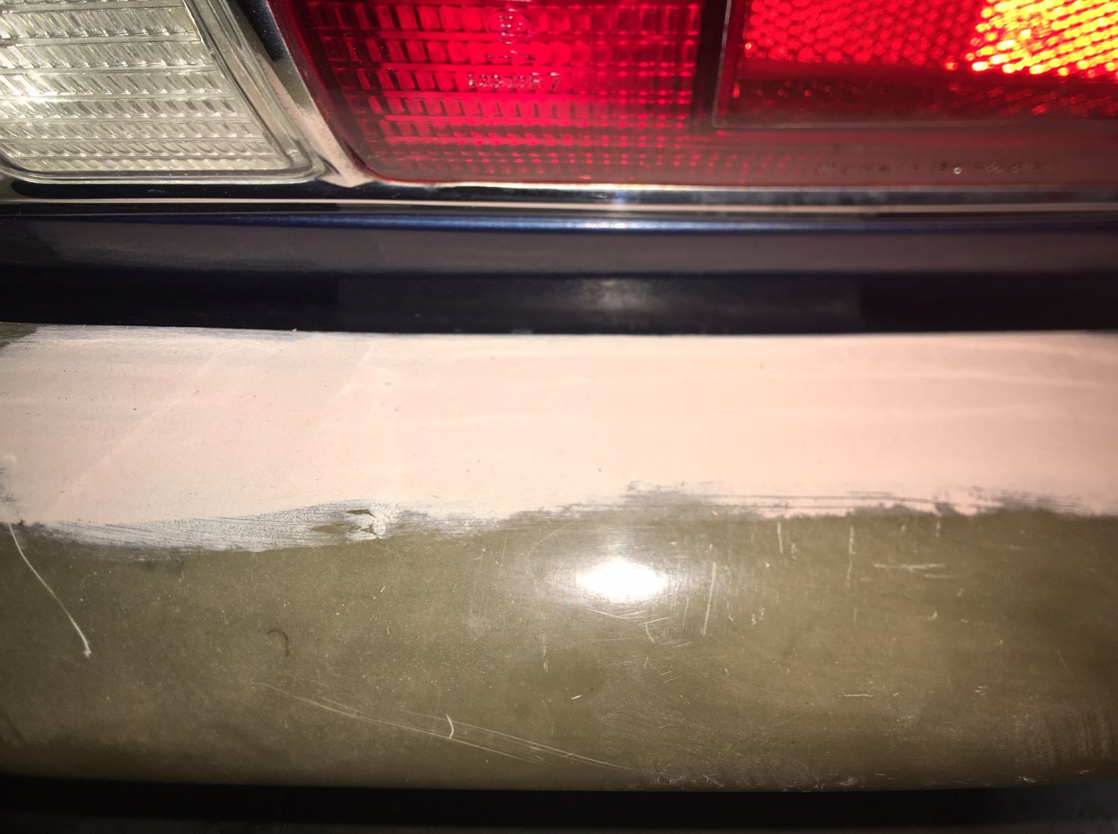

One thing to consider. The factory rear bumper mounts are not for. They are concave to match the contour of the tail panel. Have you fitted your rear bumper?
Yes, I have fitted the bumper, and will post photos of it on the car.
If you have photos of what you mean, I would love to see them.
Innocently, what is on mine, are an exact copy of the original ones from the original bumper.
Does the fibreglass bumper on the CSL fits in the same manner as on a regular CS?
If mine are wrong, we will take a mould of the tail panel, then fit them properly.
Regards, Alberto
Regards, Alberto
I don’t have the original steel bumper anymore but I do recall the shape of the bracket. The tail panel is curved and it looks like you accommodated that fact with the angle of the brackets. I checked my fiberglass bumper, and the mounts looked curved but are indeed straight. I presume that the indentation is just to let water pass through.
False alarm!
Thank you Markos!
Mine are an exact replica on the ones that were on the car, the only allowance being that
they are made out of ally, which I will revert to fibreglass as much easier to glue same materials.
I guess I am OK then.
Regards, Alberto

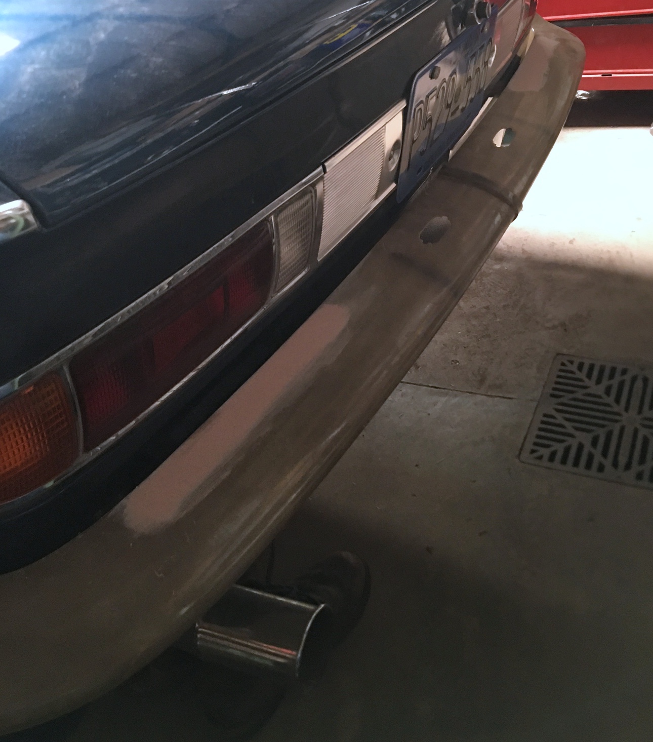

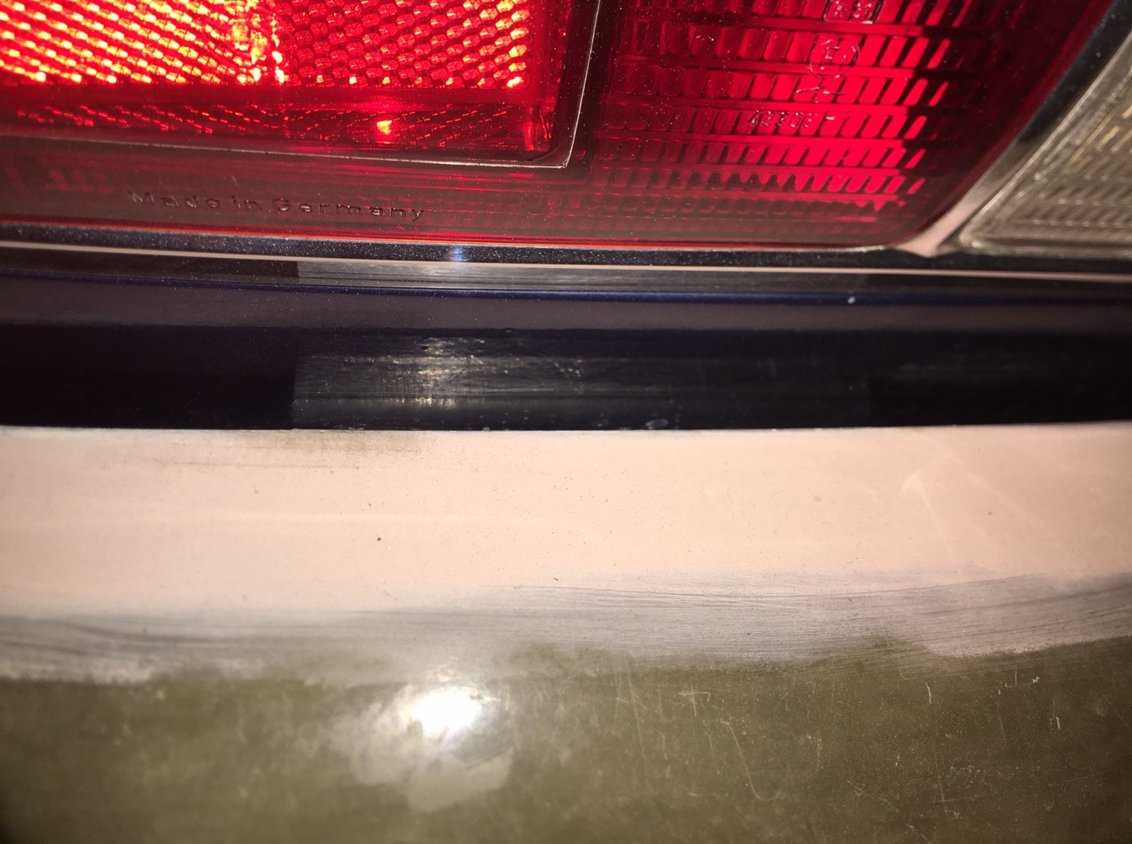

Dry fitting without paint.
Regards, Alberto
