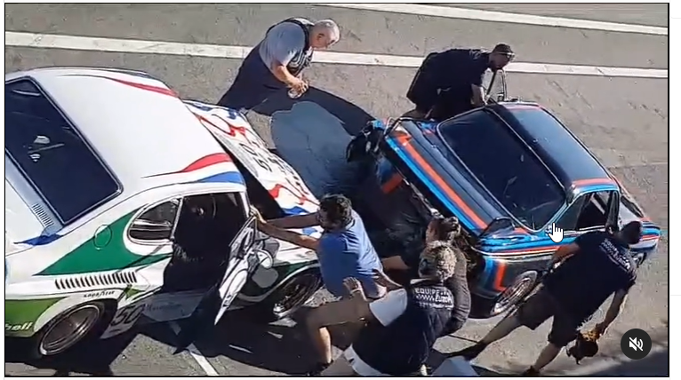

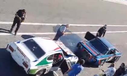

Not sure if this was posted here yet. Another video shows the CSL stopped in the pit lane and the Capri hit it from behind causing the fuel leak.

Looked like the Capri had a fuel leak, was started then shooting fuel forward at the CSL.
Does not look like any kind of collision as neither car looks damaged until the fire starts.

Negative , there is a another Video that shows the incident from a different angle , the capri most likely lost brakes and slams the sitting CSL rupturing a fuel source , large quanaties of fuel pouring on the pavement and fumes eventually hits the capris brakes and boomm Ill see if I can find the other video , its alarming and not just cause of the incident but the whole situation , so many safety violations that would not fly with most race orgs here in the states

You can see the fuel spilling from under the CSL, during a period of 15 seconds, a large pool forms of about 3-4 meters in diameter (12 foot), and this older guys just stands in/on the edge of it, looks down, sees the fuel, and doesn't move for a whole 15 seconds! He then is engulfed in flames and jumps out; he likely doesn't need a hair cut anytime soon.

This isn’t “it’s just racing”
Should get an Oscar nomination for how not to do it. I’d say 3 major inexcusable errors:
(1) Driver error. Fault = Capri:
Capri Crash
Looks like a pretty hard hit on the back of the CSL. Why was the Capri coming into the hot pits so frickin fast? If the brakes were gone, it should have been evident to the driver at pit entrance due to speed limit, and the driver would know not to pull in behind someone. You aren’t racing for a million bucks in Historics so what’s the f*cking rush? I sure hope that Capri owner paid for the repairs to the BMW. Lucky a bystander wasn’t killed.
(2) My historic race cars have tubular metal cages built around my fuel cells, sides and bottom. I see lots of guys hang their cell from the trunk floor, and NOT build a cage around the cell itself (eg totally exposed below the trunk floor). Years ago I had a crash backwards into a barrier at Watkins Glen at a decent clip. The trunk floor of my 1950’s Alfa was buckled up pretty good but the fuel cell was protected perfectly. IDK if this CSL had the same level of protection.
(2) In the video the guy with the FE is in street clothes, and after the gas ignites the heat drives him back so far away that his FE is useless. I think he also backs off to protect his massive exposed beard (WTF!). Where I race, we have a dedicated crew member in a full Nomex getup including a Nomex headsock.
(3) With proper training the fire person should know to lay down some foam on the pool of fuel as an ignition suppressant BEFORE the fire started. BTW, this is why AFFF is better than any other fire retardant in a Motorsport pit area.
In the video, it appears to be general chaos for quite a while before someone gets close enough and applies the right suppressant in the right way.
(4) I think I see someone spraying water, which isn’t very helpful other than to spread the fuel/fire across a larger area. well meaning idiot.
Old Guy: probably an innocent spectator who behaves exactly as you’d expect.
