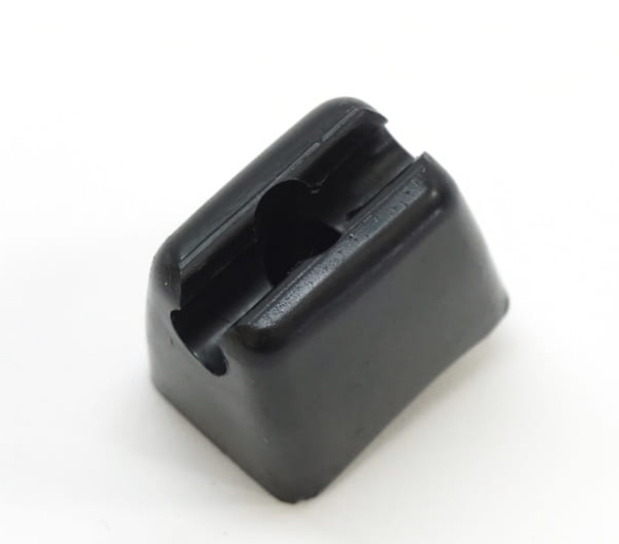

The CSL visors are secured with these on the open end.

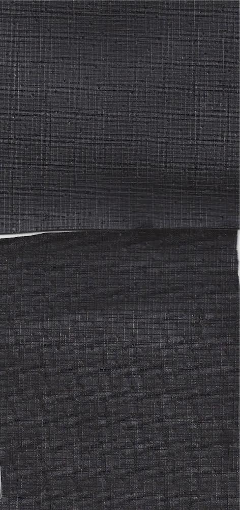

I had this stuff made by SMS auto fabrics in The pattern is not the same as regular CS, so it's not just the color that is different, IIRC.
That is not my recollection but I am definitely curious. I’m one layer away from reaching my BMW parts in my storage pod. I will snap a closeup of both for a comparison. Both the CS (2800) and CSL (RHD) headliners are undoubtedly original.

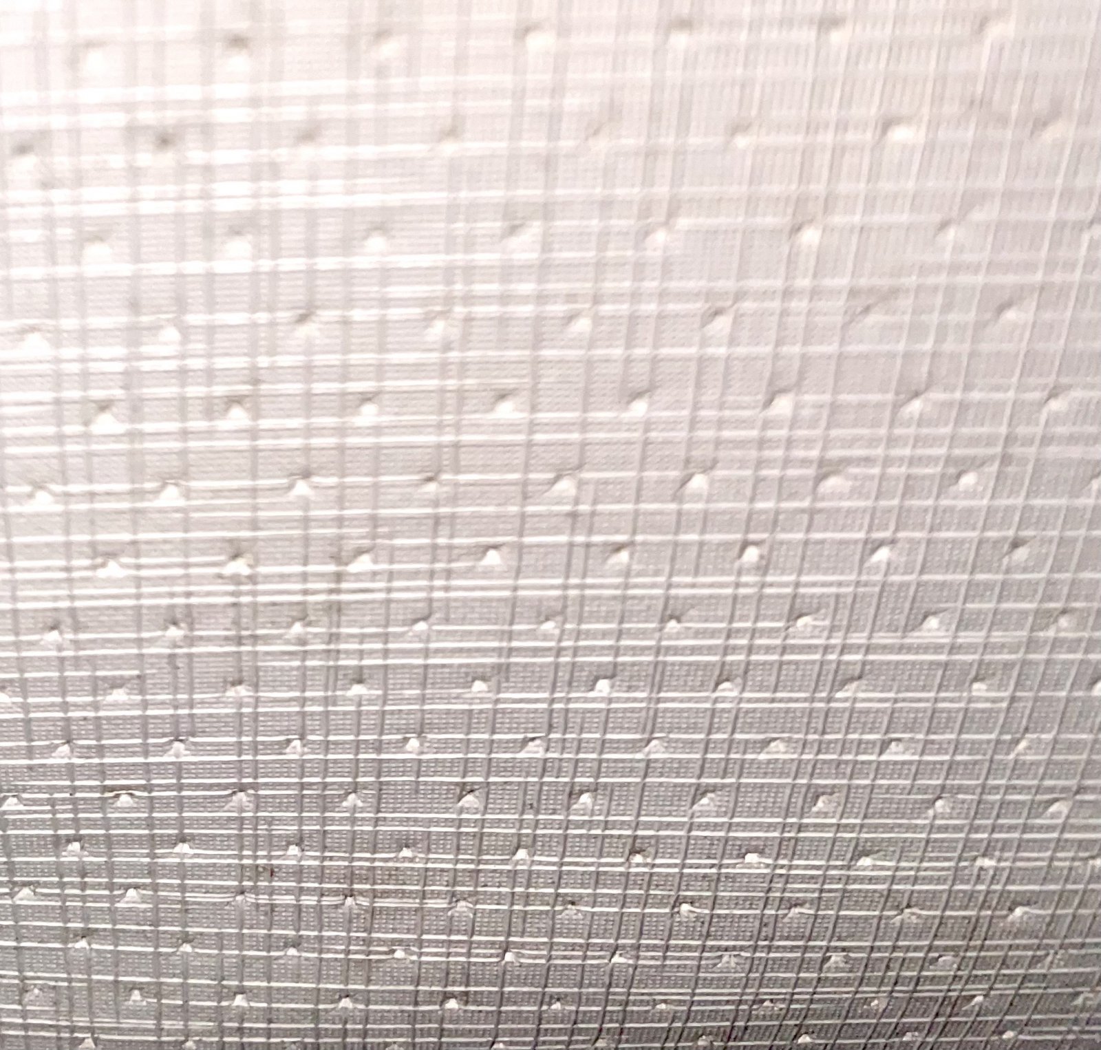

1971 2800CS. Photo credit @Markos:

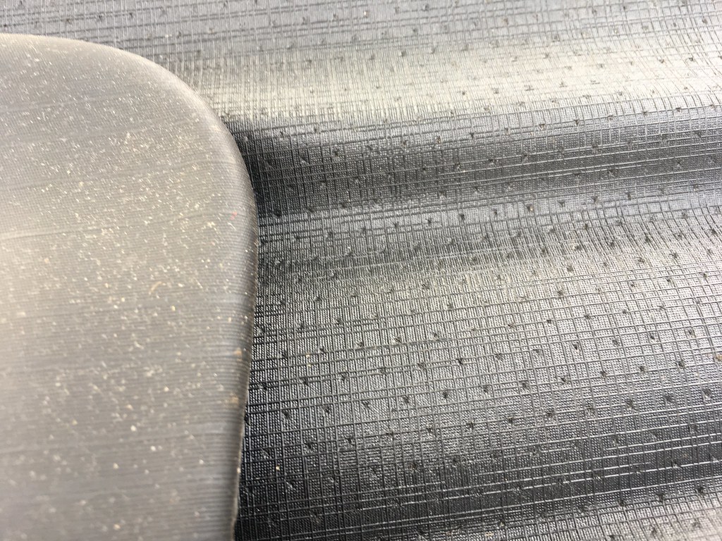

Early 1973 3.0CSL (RHD). Photo credit @Markos:

@Markos, @bavbob, @JamesE30 , the pic that Markos posted is what my original CSL headliner looked like also. And the SMS replica is as close as I have seen. Mario at VSR installed it, and I don't recall any issues with it being too thick, at that time, but maybe they have started using thicker raw material. I am pretty sure they had to machine a roller/embosser out of metal to emboss the fabric, so it takes some money and time. And the embossing is done by hand, IIRC, as the vinyl passes through the machine. It's such a tiny niche market that BMW Classic isn't going to bother.
