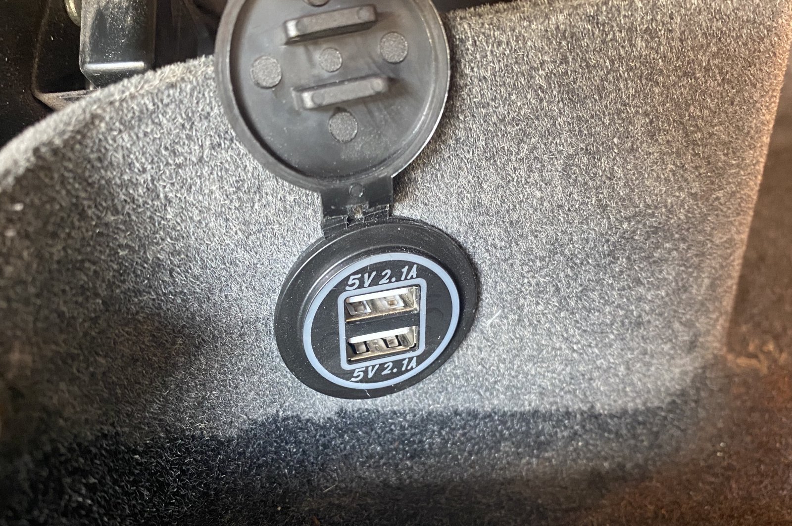

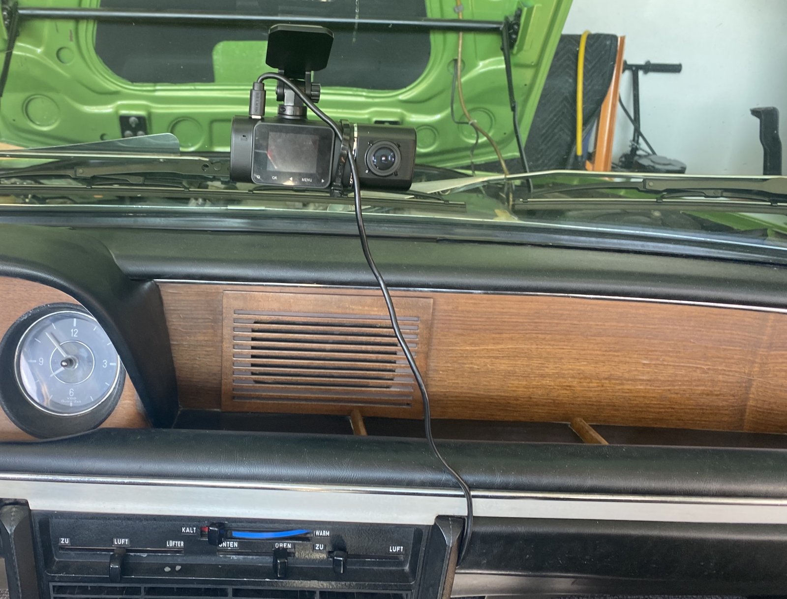

Follow up: I found a dual USB port on Amazon for $10. I'm always hesitant to drill any new holes or change anything from the original, but I chose to install the USB port inside of the glove box due to it's proximity to where the power is needed and where I can draw ignition power from (the radio). Also, the glove box has enough of a gap to fish the camera wire out of.
The hole was easy to drill, the port mounts nice and flush, and fishing the USB wiring harness over to clip into the radio power was simple enough.
I'd rather be able to hide the cabling altogether, but I'll take this solution for now.
