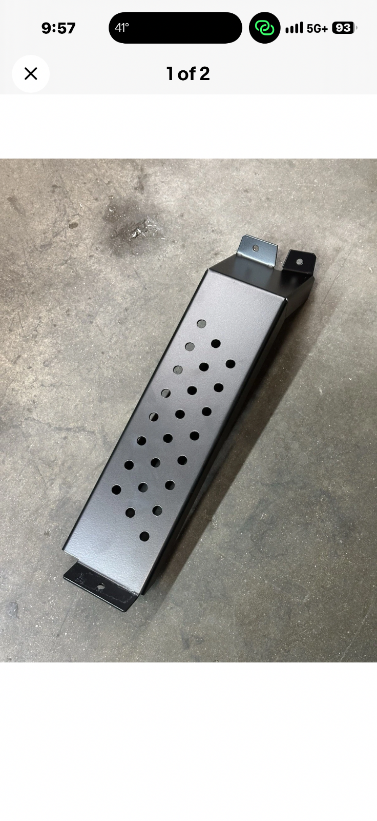

Agree, this looks like a pretty straightforward bent metal part. Especially if the patterning is something simpler - see this eBay listing with a very simple pedal that definitely shouldn’t cost $250
I also have a 3d printer, had borrowed one from local forum member Mark but my daughter loved it so much convinced me we needed one of our own, so can scan it in but same issue - we need to get someone with the part matched up with someone with a printer. The post-scanning work also requires some skill which I am only slowly acquiring.
Although this part is simple enough with primarily flat surfaces that are rectangular in shape without any curves so I agree with Scott that it may be just as quick to mock it up de novo.
I would opt for patterning that matches the current pedals. For my purpose having it match a pre-existing Alpina style wouldn’t be critical, would more want it to match the style of the car.

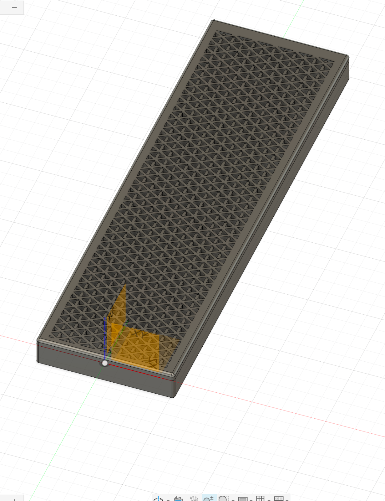

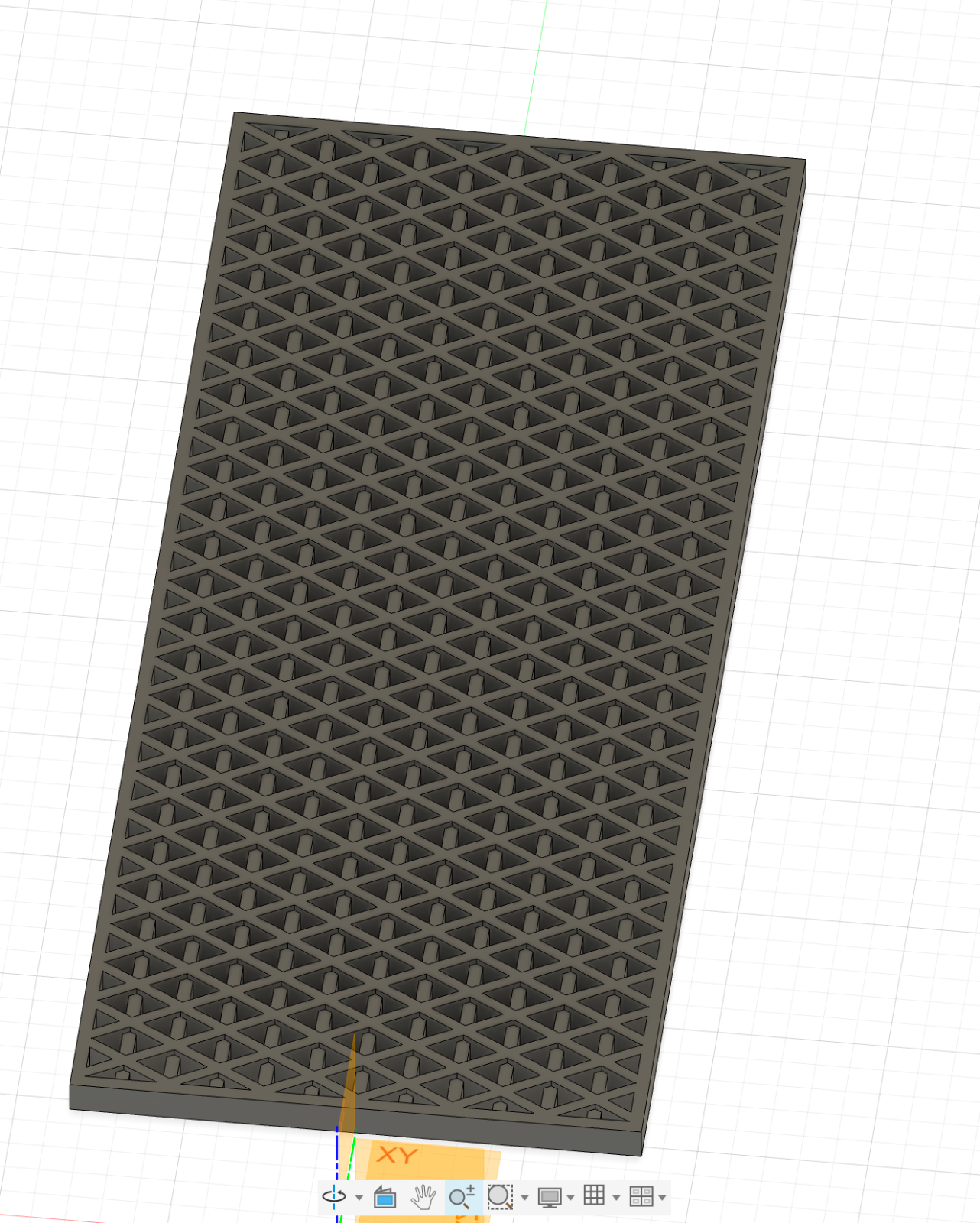

OK, proper size. Need to get the base and upper piece done to get the angle. Thinking maybe the under side should be filled in to make more of a wedge, but that may conflict with the floor contours.. Thoughts?
Start without it and then we can see what it may need added. Once you have it find I can fire off a quick cheapie 3d print at home as bc can see how it sits in there
